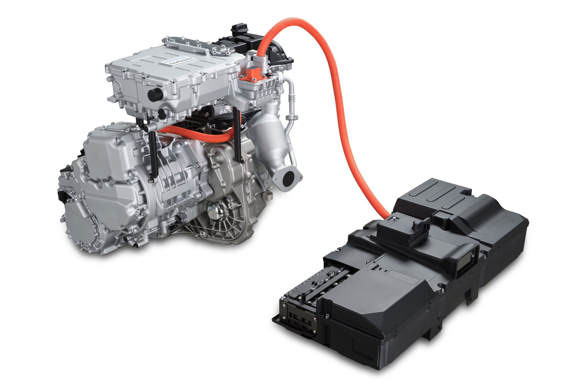

Nissan Motor Co.’s development of hybrid technology represents another approach, particularly with its proprietary e-Power system, which offers an EV-like experience without full battery reliance. Unlike traditional hybrids, which combine electric and combustion engines, it only uses the gasoline engine to generate electricity.
This design is made possible by integrating a high-voltage battery with a power train that includes a high-power motor, an inverter, a gasoline engine and a generator. Nissan views it as a bridge between ICE vehicles and full EVs.
“E-Power is born from EV experience, where most hybrids are [evolved] from an evolution of an internal combustion engine,” says David Moss, regional senior vice president of research and development at Nissan. “It’s about capturing the modern driving feel of an EV, but for customers not ready to fully transition to electric.”
This EV-inspired driving experience was shaped by consumer feedback on the elements of EVs they appreciate most—quietness, smoothness and instantaneous acceleration.

Wheels are driven entirely by an electric motor, while a small onboard gasoline engine powers a generator that produces electricity. It maintains a stable, quiet operation since its speed is independent of the car’s movement, allowing for a more linear, EV-like experience.
By decoupling the engine from the drivetrain, Moss says the system can optimize the start timing and maintain the engine at its most efficient rpm.
“We wanted to create a seamless drive where the engine and electric power interact smoothly, eliminating the noise and gear changes of traditional hybrids,” explains Moss. “It’s about harmony and consistency in the drive.”
Moss believes the e-Power system is critical for markets where EV infrastructure is still developing, allowing the company to introduce electrification benefits without requiring customers to rely solely on charging stations.

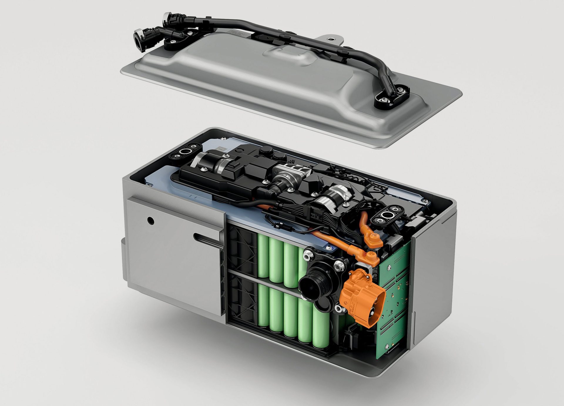

Batteries are an important component in hybrid vehicles. Photo courtesy Porsche AG

Nissan’s proprietary e-Power system provides an EV-like experience without full battery reliance. Photo courtesy Nissan Motor Co.

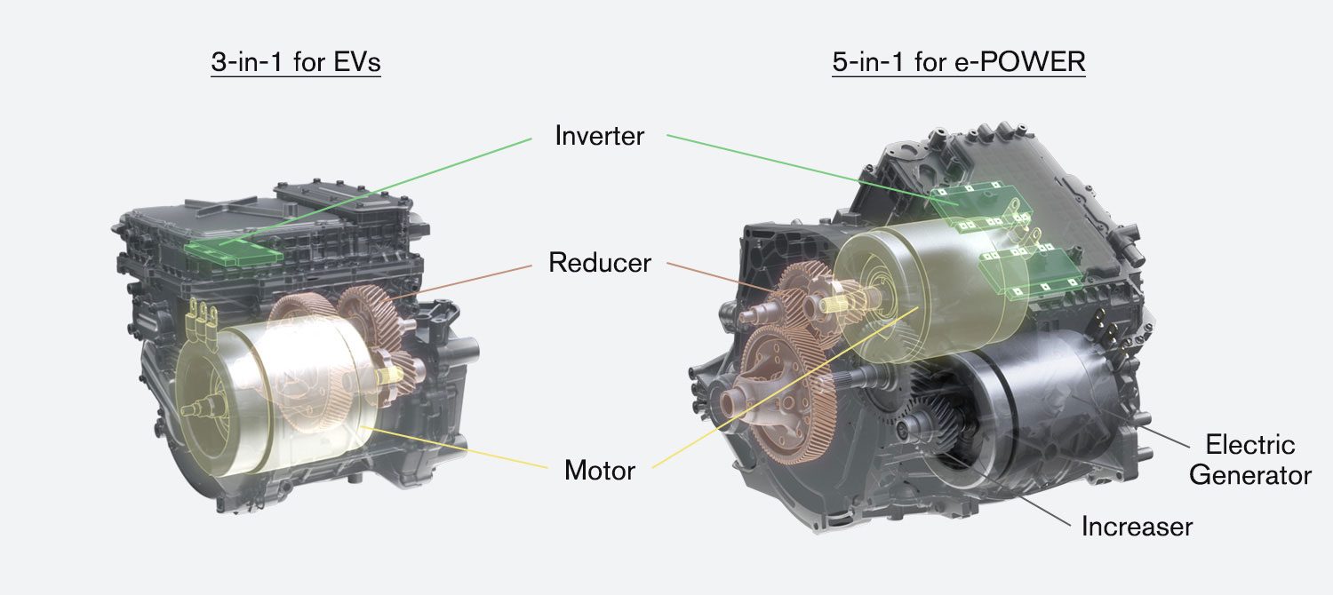

Nissan’s X-in-1 systems modularizes five drivetrain components. Photo courtesy Nissan Motor Co.

Beyond Design
Nissan’s Moss believes that hybrid technology goes beyond design. In fact, it significantly influences the assembly and production process, thanks to advancements in modularization. The automaker recently initiated an assembly process called the “X-in-1” approach, where components are consolidated to streamline production, improve efficiency and reduce costs.
According to Moss, X-in-1 will result in improved performance, reduced weight, smaller size, and better noise and vibration control through integration. Additionally, sharing core components will lead to cost reductions.
“The idea was to modularize core components into one unit to simplify the assembly process,” says Moss. “We achieved a system where, for instance, in e-Power, we combine five components into a single unit.”
This integration reduces complexity on the production line, as the five-in-one unit for e-Power eliminates the need for separate motor and generator set ups. This modularity results in a 30 percent size reduction and cuts production costs by simplifying component connections.
“By making it more compact, we also improve unit stiffness, which benefits noise and vibration performance,” explains Moss. “It becomes easier and faster to assemble vehicles, while improving the customer experience with less noise and smoother performance.”
The ability to standardize parts across both EV and hybrid models has allowed Nissan to scale production efficiently, enabling it to meet growing global demand for more sustainable yet versatile vehicles.
“In the next generation of e-Power, we’ll see even more integration, reducing costs further and aligning more closely with the standards of EV technology,” predicts Moss. “The [goal of these advancements is] to help achieve economies of scale that make hybrid technology more accessible and appealing.”
