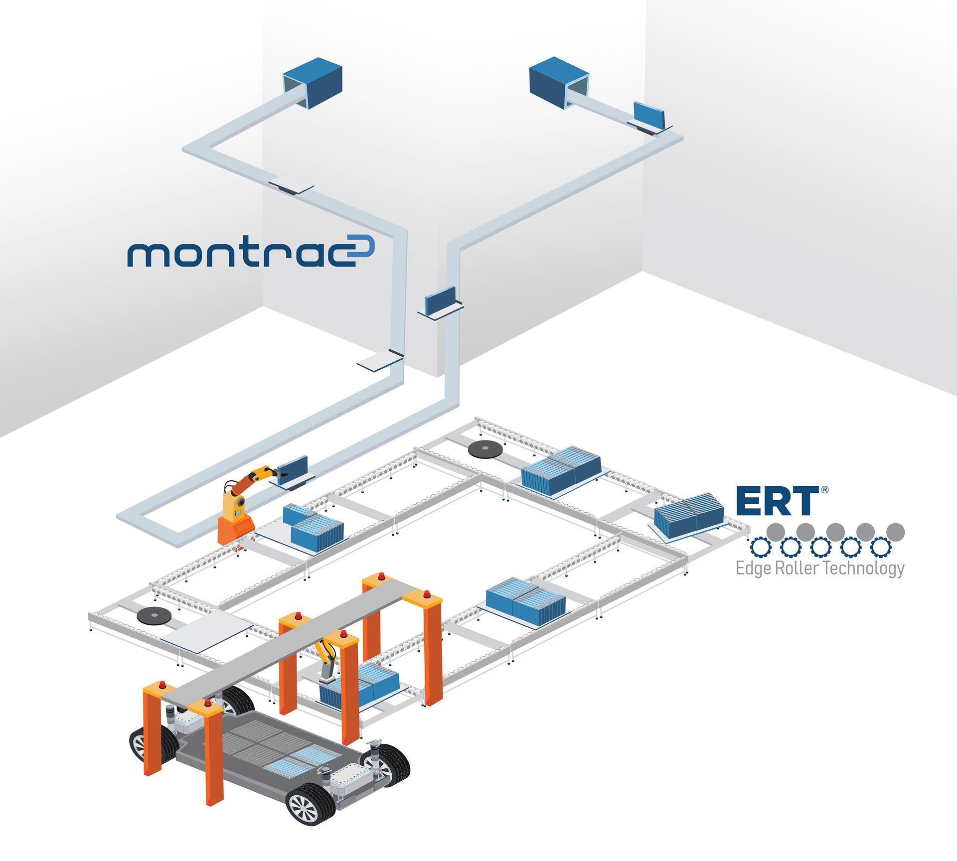

A variety of conveyors are required to assemble EV battery cells, modules and packs. Illustration courtesy Dorner Manufacturing Corp.

However, part of the challenge of adding conveyors to a battery assembly line is the required conditions for operation. Some steps in the production process take place in a clean or dry room. If a conveyor is used to transport components to that room, it must be made with materials compliant with the environment.
A conveyor system is almost never made up of one single type. Battery assembly plants require a variety of products that can run at different speeds, support different weights and move products as needed at each phase of production.

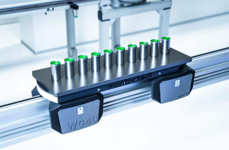

Pallet systems are an ideal fit for a number of operations because of the ability to run with the highly sensitive battery mounted to the pallet. These systems also offer a precise way for battery cells, modules and packs to interact with other steps in the operation. In addition, pallets can be placed in the right place and the right time to interact with assembly robots.
Pallet systems include timing belt, flexible chain and edge roller technology designs. Each system offers advanced pallet traffic management and is specifically designed to increase efficiency, reduce downtime in automation processes and provide accurate product placement.
Accumulation systems allow battery cells to accumulate before and during the jelly roll insertion process. This ensures that each workstation handles a steady flow of product.
