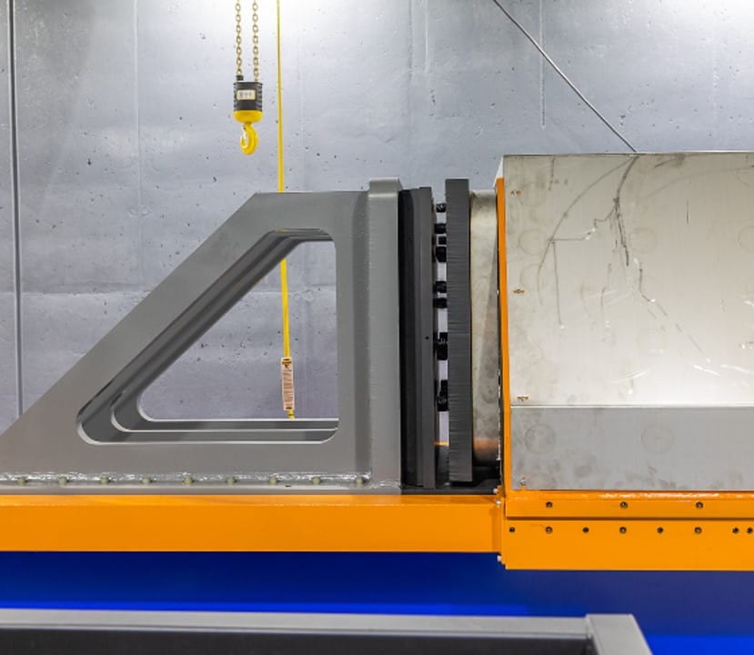

This multi-axis shaker table simulates real-world vibrations. Photo courtesy TÜV SÜD America Inc.

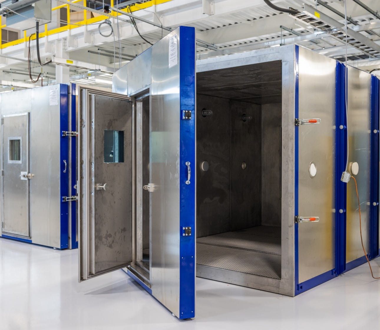

Walk-in environmental chambers subject EV components to high and low temperature extremes. Photo courtesy TÜV SÜD America Inc.

The facility is equipped to handle batteries up to 1,200 volts. It boasts an electrodynamic vibration table capable of generating forces up to 350 kilonewton, as well as an electrodynamic MAST (multi-axis shaker table) system for six degrees of freedom testing and high-frequency response. Another device can crush EV batteries with forces of up to 1 meganewton.

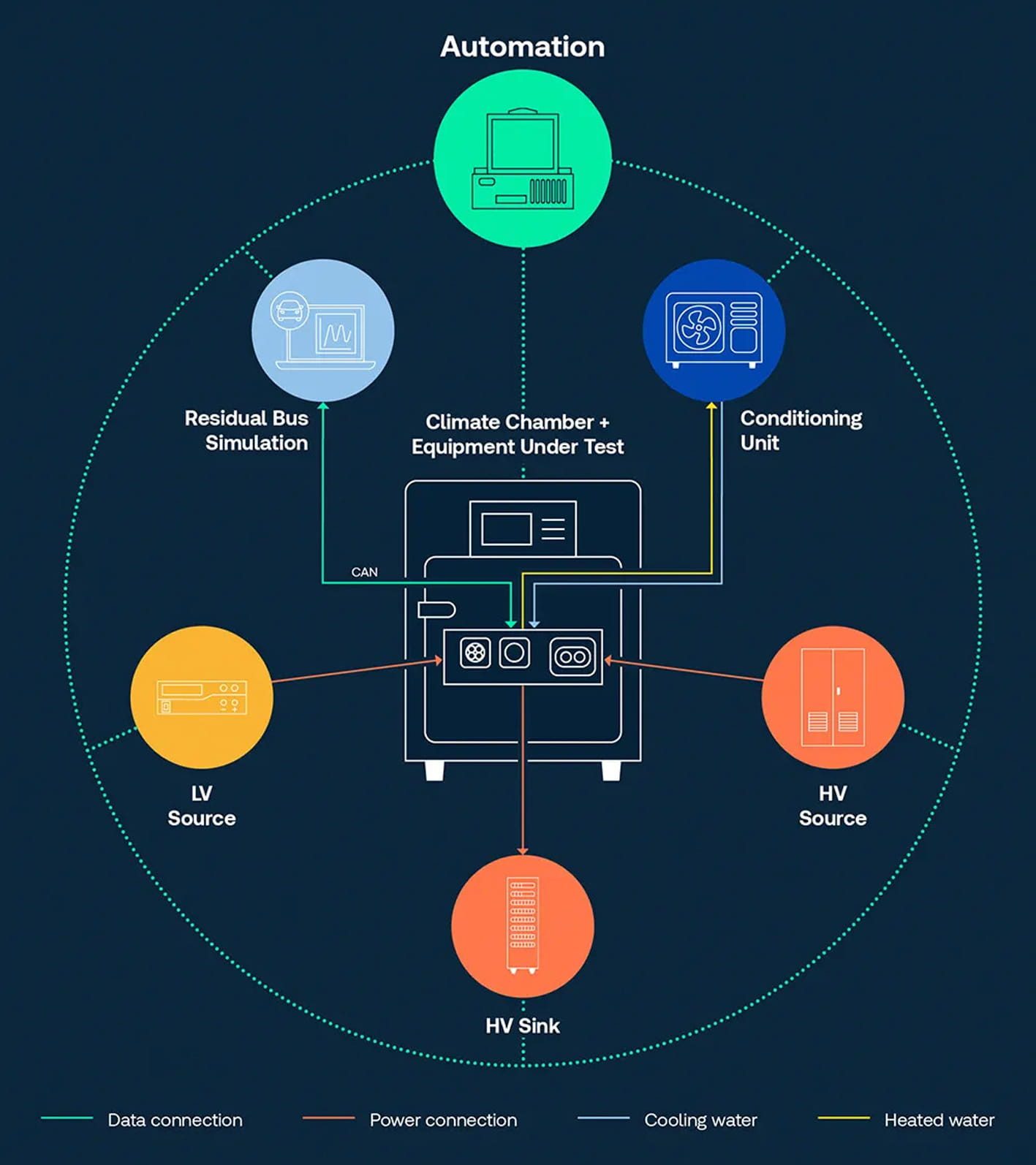

Fully automatic high-voltage tests record data in real time, enabling immediate response to all boundary conditions. Illustration courtesy TÜV SÜD AG

Sommer: High-voltage components present specific challenges that go beyond the requirements of traditional testing. One of the biggest challenges is to operate the test objects with their complex functionality at a wide range of operating points. This requires both highly qualified personnel and modern test facilities. We rely on an automation system that controls and communicates with all test subjects via the CAN protocol. All data is also collected via this dynamic system, which connects the test object itself, climate chambers, and cooling and energy units. This allows us to create individual test procedures for customers to test components under real-world conditions and extreme loads.

Sommer: We test EV components under extreme temperature conditions to ensure their reliability and performance in a wide range of environments. Tests cover temperature ranges from -50 C to 220 C, simulating freezing cold as well as extreme heat, as can occur near high-energy systems or in intense sunlight. These tests also include rapid temperature changes and long-term exposure to simulate real-life operating conditions.

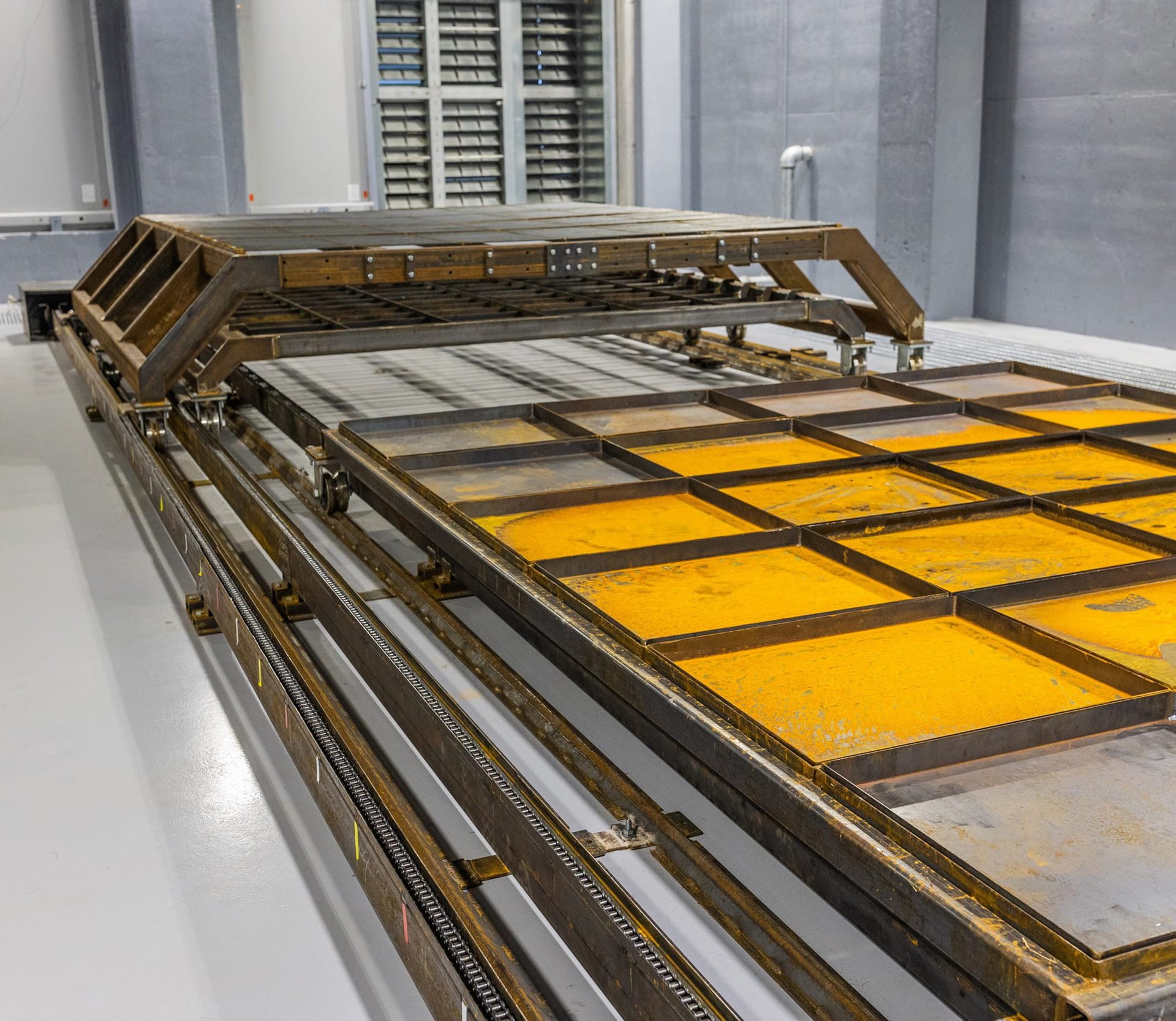

This fire testing rig checks EV batteries for flammability and combustibility. Photo courtesy TÜV SÜD America Inc.

Sommer: Specially developed fixtures, designed for optimal vibration behavior, are used for the tests. Thanks to our extensive equipment, we can supply the unit with power during the test, cool or heat it, as well as carry out measurements and communicate via CAN interfaces, all according to the customer's requirements. These versatile testing options enable a precise evaluation of the resilience and functionality of components under realistic conditions.

Sommer: The centerpiece of our test stands is an automation system that acts as the “brain” of the entire test environment. All test components are integrated into this system and controlled centrally. At the same time, it collects all the data, enabling us to make the test set-up smarter and safer. This digital networking enables more precise and efficient execution of complex tests and contributes significantly to the optimization of our high-voltage processes.
