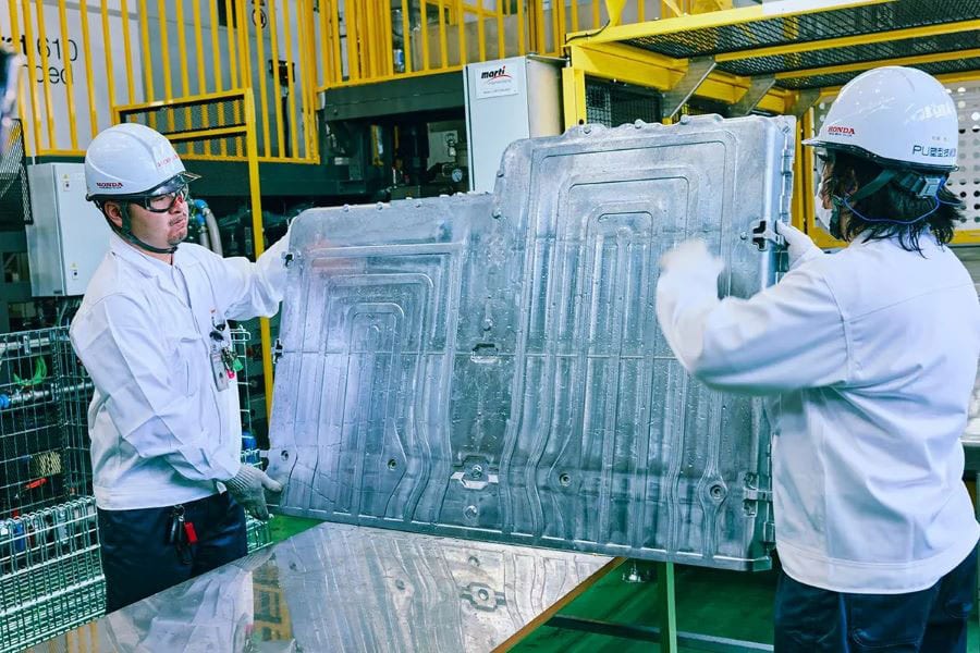

Megacasting involves molding large cast parts such as one-piece battery enclosures that eliminate seams. Photo courtesy Honda Motor Co.
TOKYO—Honda 0 Series is the automaker’s new approach to electric vehicle development, which is focusing on the theme of “thin, light and wise.” The goal of the R&D project is to minimize battery size while providing sufficient cruising range and a nimble driving experience that transcends the existing image of EVs.
Honda engineers are focusing their efforts on four core production technologies, including megacasting and friction stir welding.
Megacasting involves molding large cast parts such as one-piece battery enclosures that eliminate seams. A new battery case, which traditionally consists of more than 60 parts, has been reduced to only five parts, making it possible to produce a high-quality, thin and light enclosure.
3D Friction Stir Welding (FSW) is being applied to two processes in the manufacturing of battery cases. The first is the process of joining parts made by megacasting to form the case enclosure, and the second is the process of joining the water jacket cover, which is necessary to provide the battery with cooling. The technology uses only the frictional heat between the rotating rod-shaped tool and the joint to soften and join the aluminum parts.
“We believe that FSW is an important way to increase the flexibility and productivity of our products,” says Atsushi Yoshida, a Honda engineer working on the project. “As there is less damage to the base material from heat than with conventional welding, joints can easily be maintained at a high quality, making the entire battery case thinner and lighter while ensuring joint strength and airtightness.
“With battery case manufacturing, we focused on shortening the processes,” explains Yoshida. “By setting the joining conditions according to characteristics such as strength that vary by material, and optimizing tool movements and other factors according to the shape of the joints, we were able to stabilize the quality of the joints while minimizing the amount of preprocessing required.”

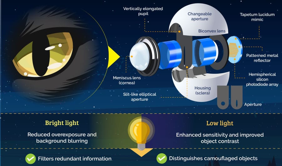

GWANGJU, South Korea—Cats have an uncanny ability to see and detect objects in various lighting conditions, including both bright light and darkness. Their eyes feature a unique shape and reflective surface that reduces glare in bright environments and boosts sensitivity in low-light scenarios.
That distinctive feline trait inspired engineers at the Gwangju Institute of Science and Technology (GIST) to develop a vision system that enhances accuracy in challenging environments. The breakthrough could lead to smarter, more efficient autonomous systems.
Cat eyes are uniquely adapted. During the day, vertical slit-shaped pupils help them focus and reduce glare. At night, their pupils widen to let in more light, and a reflective layer called the tapetum lucidum boosts night vision, giving feline eyes a familiar glow.
Potential applications for the GIST vision system include autonomous vehicles and humanoid robots, which often struggle to "see" well in different environments, such as bright sunlight, low light or when objects blend into complex backgrounds.
“Robotic cameras often struggle to spot objects in busy or camouflaged backgrounds, especially when lighting conditions change,” says Young Min Song, Ph.D., a professor of electrical engineering and computer science at GIST who worked on the project. “Our design solves this by letting robots blur out unnecessary details and focus on important objects.”
The system includes a slit-like aperture that, like a cat’s vertical pupil, helps filter unnecessary light and focus on key objects. It also uses a special reflective layer similar to the one found in cat eyes that improves visibility in low-light conditions.
“The advanced vision system promises to elevate the precision of drones, security robots and self-driving vehicles, enabling them to adeptly navigate intricate environments and execute tasks with unparalleled accuracy,” explains Song. “From search-and-rescue operations to industrial monitoring, these cutting-edge robotic eyes stand ready to complement or even replace human efforts in a variety of critical scenarios.”

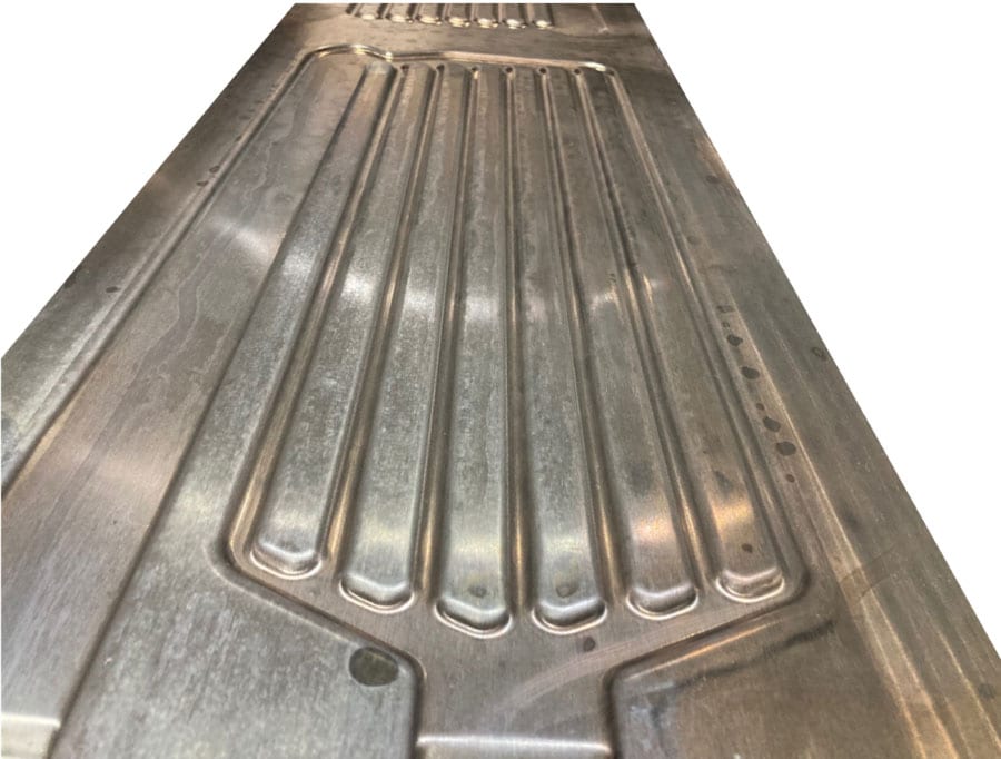

CHEMNITZ, Germany—A European research project called COOLBat is developing next-generation battery enclosures for electric vehicles. The goal of the initiative is to improve charging power and range, while lowering environmental impact.
Engineers at the Fraunhofer Institute for Machine Tools and Forming Technology (IWU) are examining new ways to make battery enclosures lighter and cut carbon dioxide emissions by 15 percent. They aim to achieve this by combining individual systems, packing more functions into a smaller installation space, and using new heat-conductive materials and bio-based flame retardant coatings.
“Integrating new lightweight construction methods and more functions in a smaller installation space with fewer interfaces makes it possible to reduce weight while also cutting carbon emissions,” says Rico Schmerler, an engineer in the battery systems department at Fraunhofer IWU who is working on the project. “Reducing mass lets us increase energy density, and thus range, even as the number of battery cells stays the same. By making the enclosure lid out of a fiber composite material, we were able to reduce the mass by more than 60 percent compared to the reference out of steel.”
Another option for reducing weight is combining individual systems in the enclosure that previously performed thermal and mechanical functions separately. For example, cooling channels cast at the Fraunhofer Institute for Manufacturing Technology and Advanced Materials are incorporated directly into load-bearing structures such as cross beams.
The cooling unit function is combined with underride protection in a single component, the base plate. Aluminum foam inside the base plate absorbs the energy from stone impacts and accidents. Combined with a phase-change material, a kind of wax that can be used to store and later release a wealth of thermal and cooling energy, the aluminum foam also lowers the amount of energy needed to cool EV batteries.
According to Schmerler, this configuration protects battery cells from mechanical loads and overheating at once. A fluid flows through the channels, cooling the cells not only from below but also from the sides. This reduces the electricity needed to cool the cells and eliminates the need for cooling elements elsewhere in the vehicle.
“We’re focusing on functionally integrated structures,” explains Schmerler. “Tasks that used to be handled by different modules inside the battery are being integrated into a single component—the base assembly, in this case—to shrink the installation space and streamline interfaces. These base plates will provide protection from overheating and avert damage to the battery core in case of an accident.”

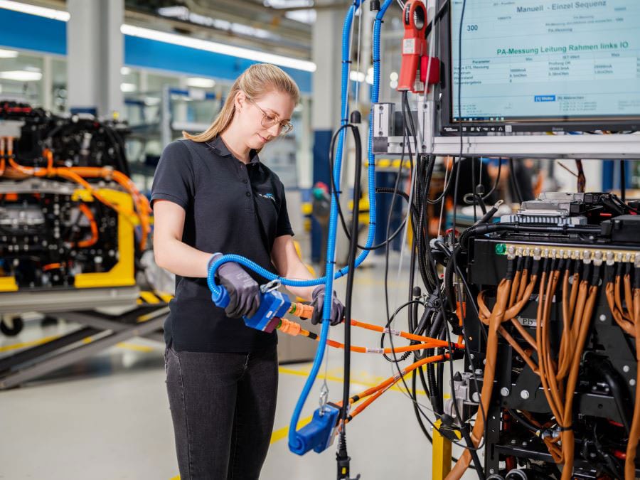

The “front box” is a complex module that contains several control units, high-voltage components and an electric air compressor. Photo courtesy Mercedes-Benz Trucks
MANNHEIM, Germany—Mercedes-Benz Trucks has begun assembling a key component of its new eActros 600 long-haul truck at its factory here. The “front box” is a complex module that contains several control units, high-voltage components and an electric air compressor. It’s located in the space previously occupied by an internal combustion engine.
In contrast to a traditional diesel engine, the front box doesn’t have a specific drive function, but contains a large number of components that are essential for the truck to operate. In total, there are more than 1,000 individual parts.
Packaging this high number of components in a very confined space was a challenge to engineers. They developed a “layered structure” in which the individual components are built up from bottom to top.
“The front box is an assembly-intensive unit for battery-powered vehicles,” says Andreas Moch, plant manager at Mercedes-Benz Mannheim. “After a successful prototype phase, we are now pleased to be able to move into series production.
“Our plant is the competence center for battery technology and high-voltage systems at Daimler Truck,” explains Moch. “With the start of production of the front box, we are already reaching the second milestone this year, after we opened our Battery Technology Center in the summer. We [have transformed the factory] and are making an important contribution to shaping the emission-free mobility of the future.”
Over a one-year period, extensive renovation work was carried out in a building that is more than 100 years old. Among other things, the floor surface, ventilation and lighting system was improved, while the support structure was rebuilt. A state-of-the-art assembly line with a logistics zone was then installed. “It offers a high degree of flexibility for different quantities, product variants and subsequent generations,” says Moch.
The front box assembly line consists of four consecutive production sections. Each contains various assembly stations, with the corresponding material zones and subassembly stations located to the side.
After each workstation, the front box passes through a quality gate, where the correct execution of the assembly process is verified before the next level is built. Once all quality gates have been successfully passed and the assembly quality has been confirmed in an end-of-line inspection, the front box is shipped to Mercedes-Benz’s final assembly line in Wörth.
