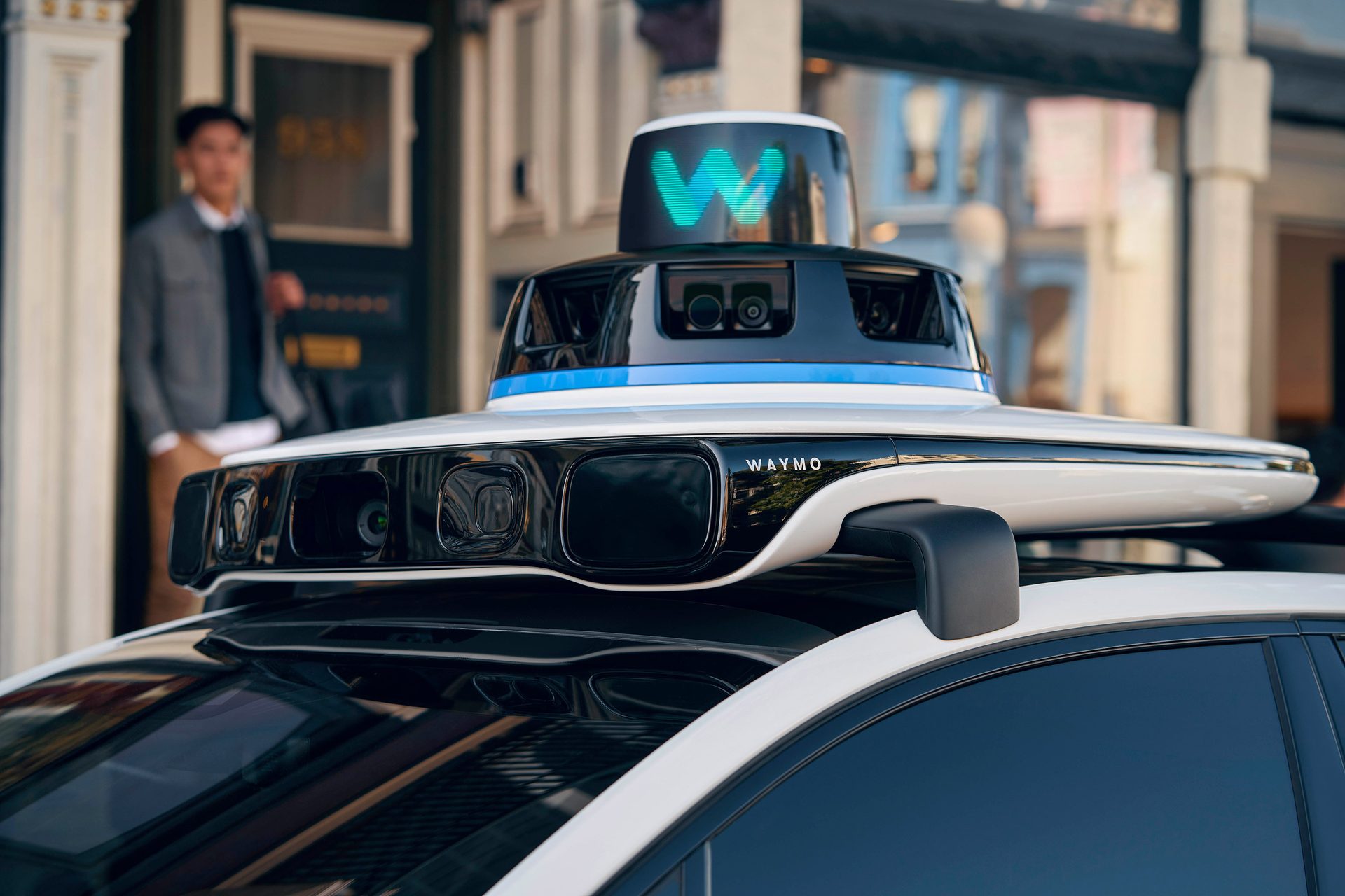

Alphabet subsidiary Waymo, for example, integrates laser scanners and lidar sensors into its autonomous taxis to create a robust three-dimensional view of the surroundings. In its sixth-generation Waymo Driver hardware suite, the company continues to evolve its lidar usage alongside cameras and radar, describing the combined sensor platform as delivering “overlapping fields of view.”

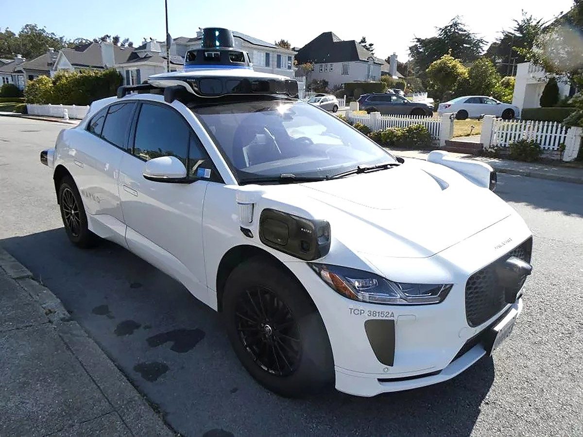

White Waymo self-driving Jaguar I-Pace with roof sensors, parked on a street.
Autonomous vehicles use lidar technology to safely navigate. Photo by Austin Weber

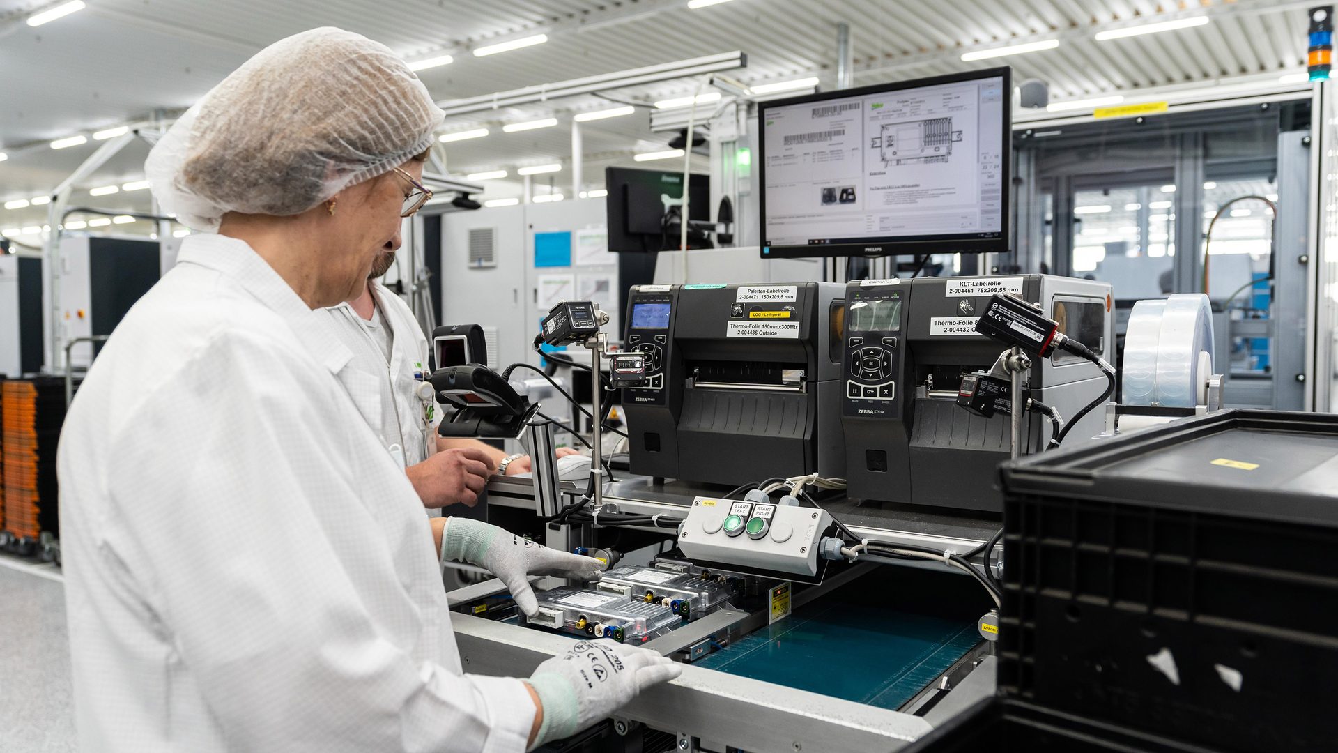

Valeo’s approach to manufacturing combines standard automotive processes with highly specialized steps unique to the technology. Each unit goes through roughly 20 production steps, with components that include laser emitters, lenses, receivers, electronics and housings.
“One very specific element is what we call the end of line,” says Minster. “Lidar is a measurement device [that] needs a reference.
“Even after all the components have been assembled, the device has no value until it has a reference point to ensure that a measurement is correct,” explains Minster. “That validation process involves a complex calibration and simulation system designed to confirm accuracy over long distances.”
The Wemding plant is highly automated, so despite the complexity of assembly, only a small number of operators are needed.

Person in cleanroom attire assembling electronics on an automated line with label printers.
This state-of-the-art factory in Germany mass-produces lidar units that are used by numerous automakers. Photo courtesy Valeo

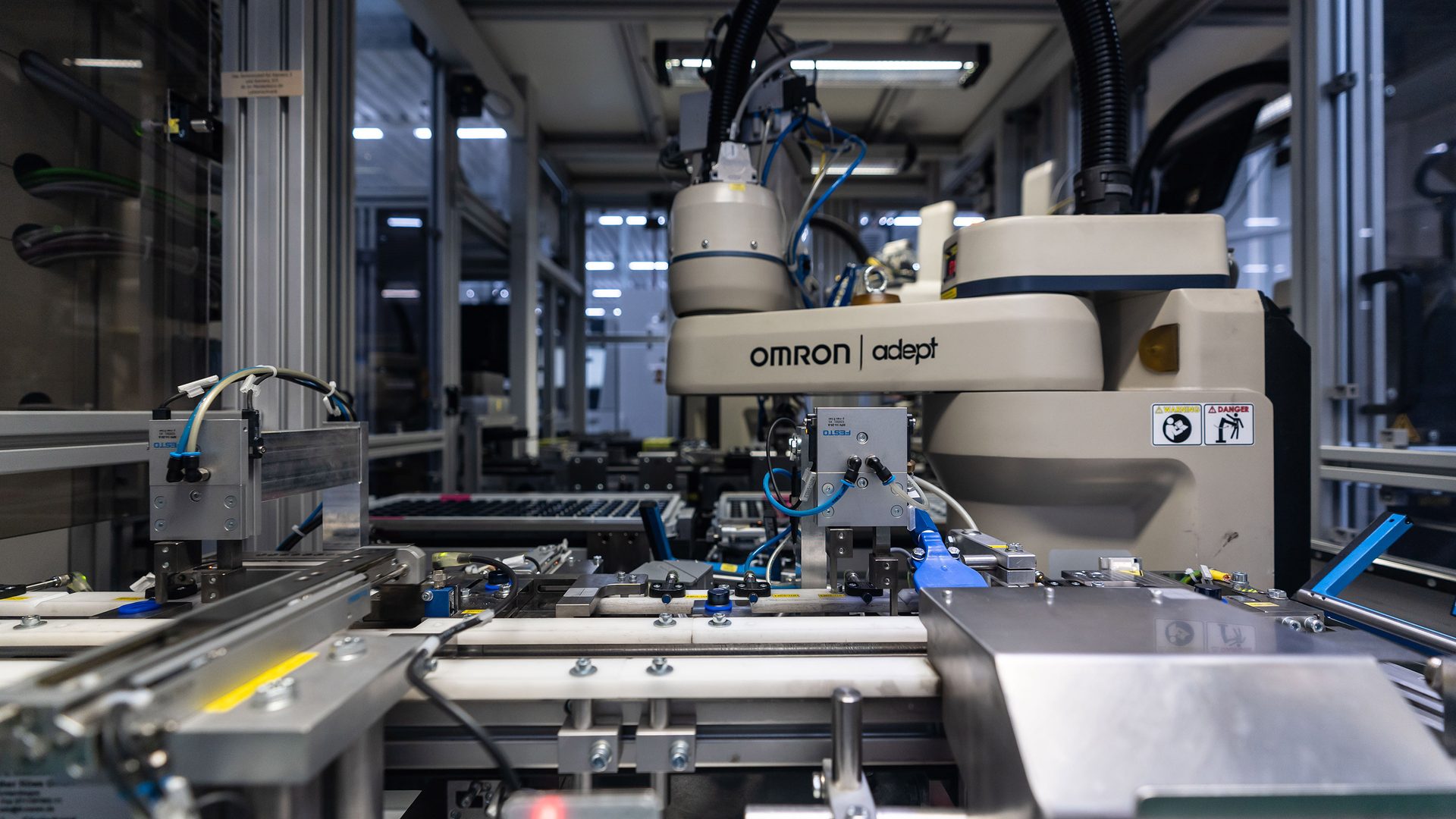

Omron Adept industrial robot on an automated assembly line with precision machinery.
Automation ensures that optical components are precisely aligned. Photo courtesy Valeo
Assembly requires robotic screwdriving and adhesive dispensing, in addition to several steps that require soldering and welding. Work proceeds in parallel across subassembly lines, each focusing on a distinct function. To ensure quality, approximately 70 percent of the assembly line is automated.
Active alignment is a critical step in the production process where the optical parts are precisely positioned. Real-time optical performance feedback enables assemblers to optimize the process with robotics.
Instead of using traditional fixed x-y-z coordinates, the system automatically determines the exact position of the lens in front of the laser that produces the maximum beam power.

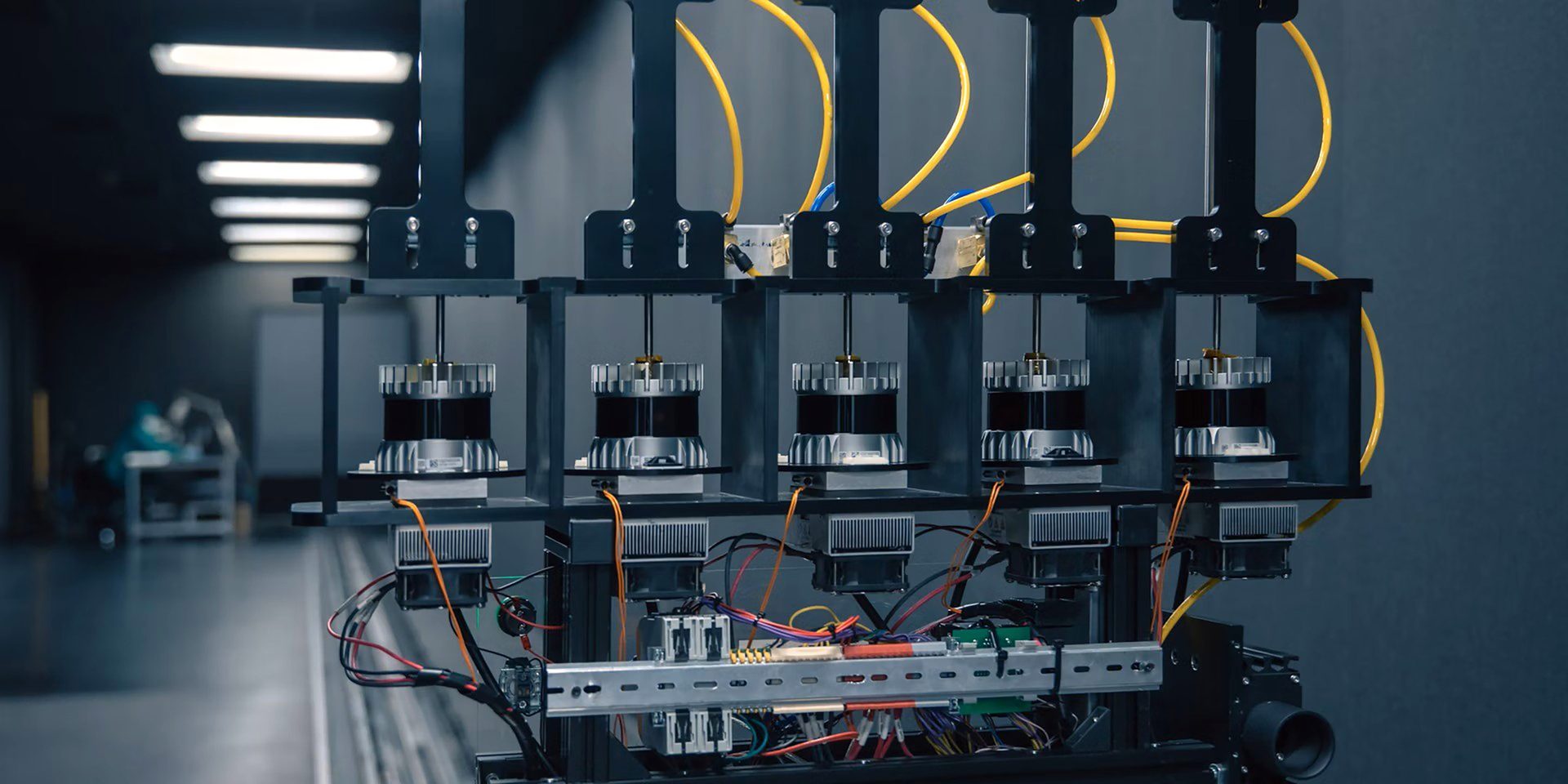

“You put a component in a specific place, and you measure where it is, and you check later in the process that it’s still exactly there,” says Frichtl. “You do that over and over again for lasers, detectors, lenses—everything you’re putting together in the device.”
A row of four identical machines with black frames, silver components, yellow tubes, and visible wiring.
Artificial intelligence and vision system technology ensures that stringent quality standards are met. Photo courtesy Ouster Inc.
This meticulous verification ensures that Ouster’s sensors meet the punishing conditions required for real-world environments, from alfalfa fields to zinc mines.
