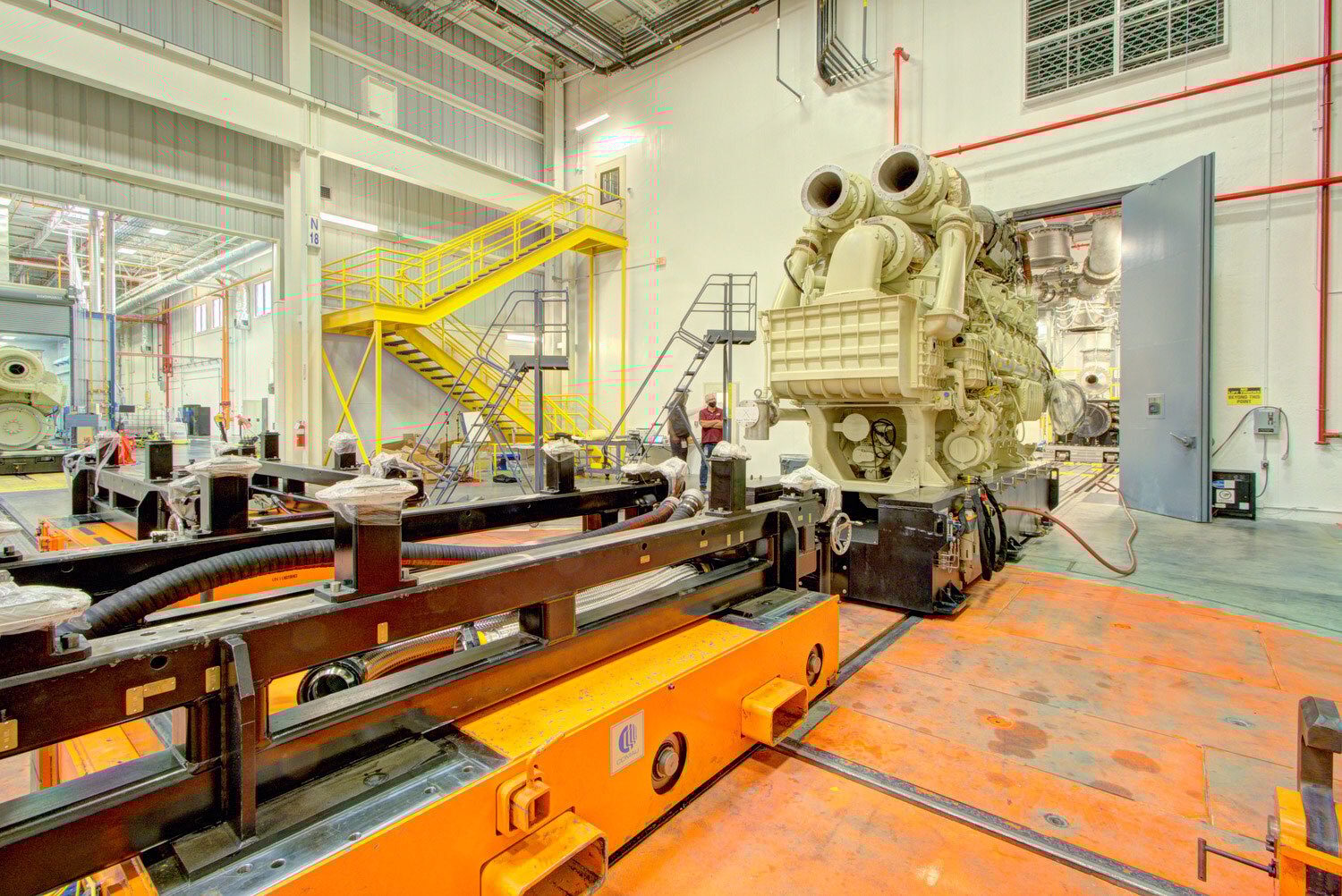

Electrification test facilities require battery simulators and emulators, chassis or power train dynamometers, and high-voltage charging systems. Photo courtesy ACS Inc.

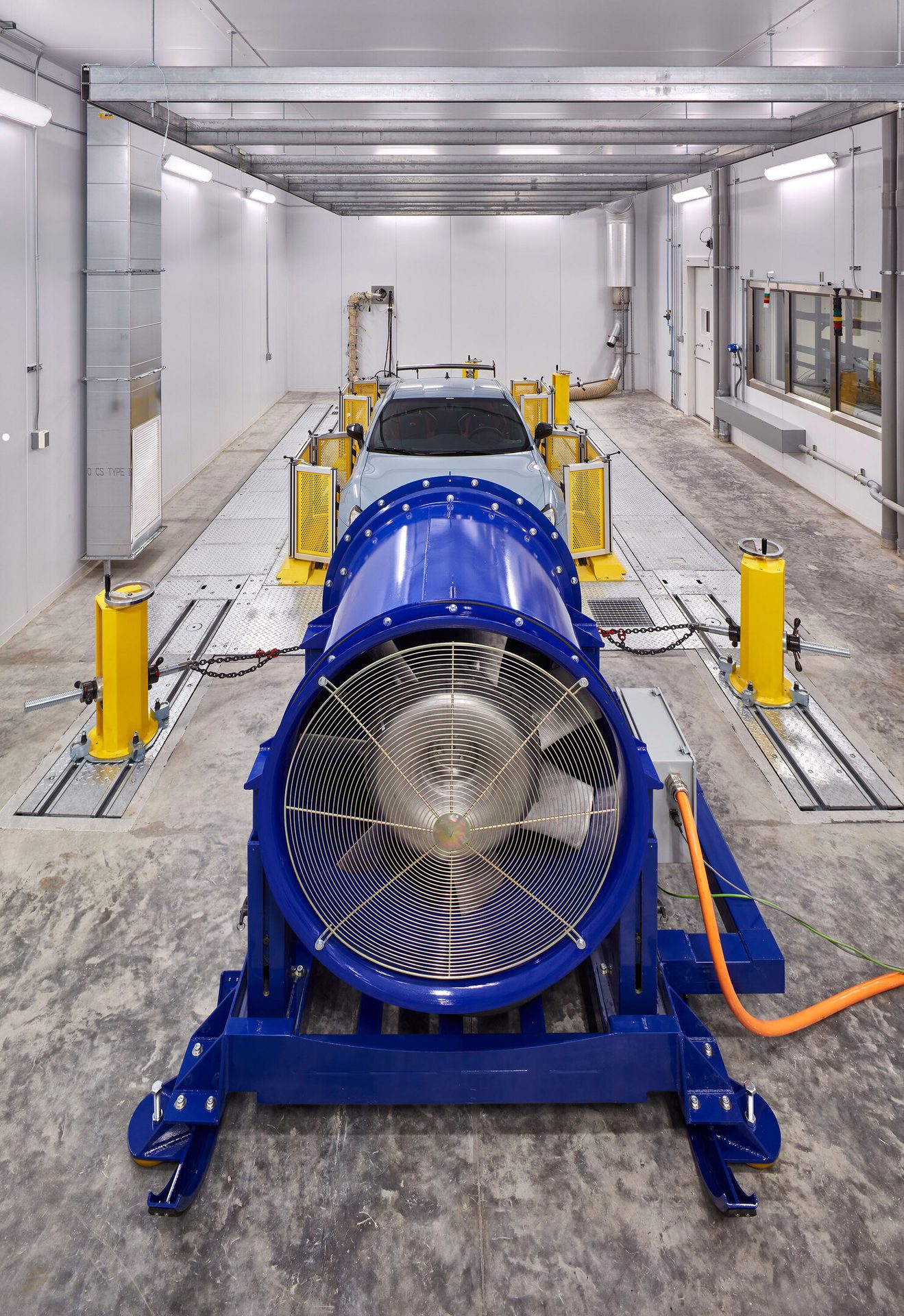

Motor vehicle, Automotive tire, Floor
By leveraging a system integrator’s knowledge, it’s possible to mitigate risks and address future solutions in the planning and design phase. Photo courtesy ACS Inc.

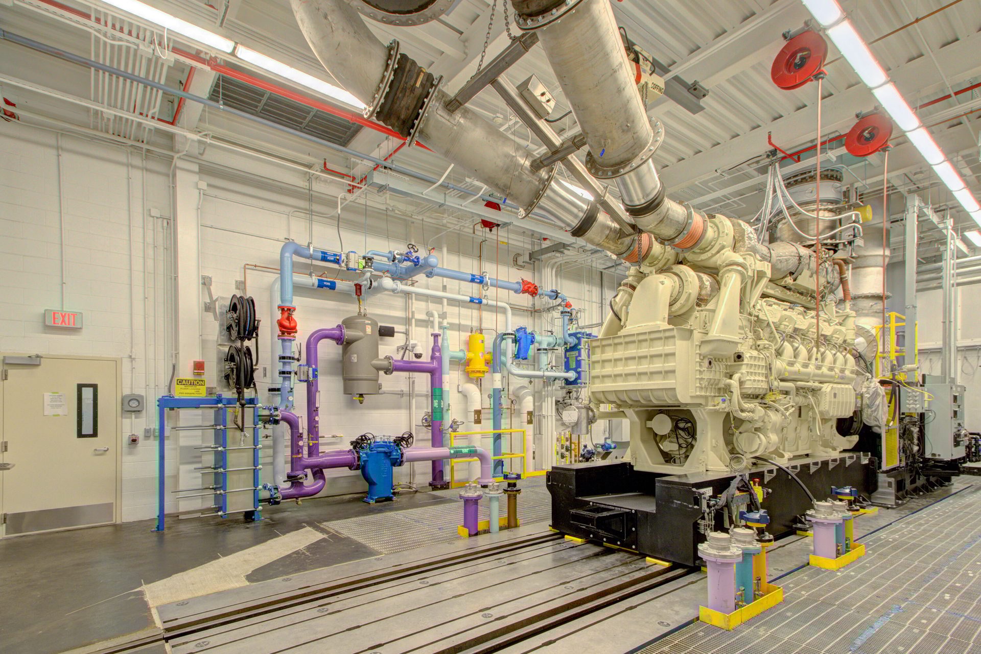

Integrators possess the technical expertise and knowledge necessary to plan, design and construct a cohesive and functional test facility. Photo courtesy ACS Inc.
