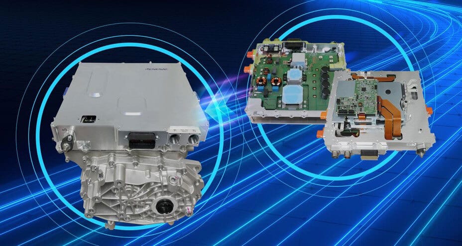

Renesas recently developed a new e-axle system that significantly reduces the number of components, cost and size. Illustration courtesy Renesas Electronics Corp.

Renesas also recently unveiled the world’s first “8-in-1” proof of concept for e-axle systems, which controls eight functions using a single microcontroller. Developed in collaboration with Nidec Corp., it integrates a motor, a gear (reduction gear), an inverter, a DC/DC converter and an on-board battery charger.
Having a single ECU manage an electric power train control unit will help lower the weight and cost of the system, reducing the number of components.

AEM: What is the function of e-axles in electric vehicles?
Tsuda: An e-axle combines a drive motor, a gear and an inverter. By integrating multiple functions, it can reduce system size and weight, simplifying EV design. Packaging makes [our new] unit smaller and lighter, resulting in benefits such as space savings, improved power consumption and lower costs.
Renesas provided key components, including semiconductors and a reference design for the new 8-in-1 e-axle system.
While generally each function of an e-axle requires a dedicated microcontroller unit and a power management IC (PMIC) to control an X-in-1 system, [our] e-axle system can operate with only one MCU and a PMIC to control the entire 8-in-1 system. By systematically integrating these functions with a single MCU, [we] significantly reduced the number of components, cost and size.
