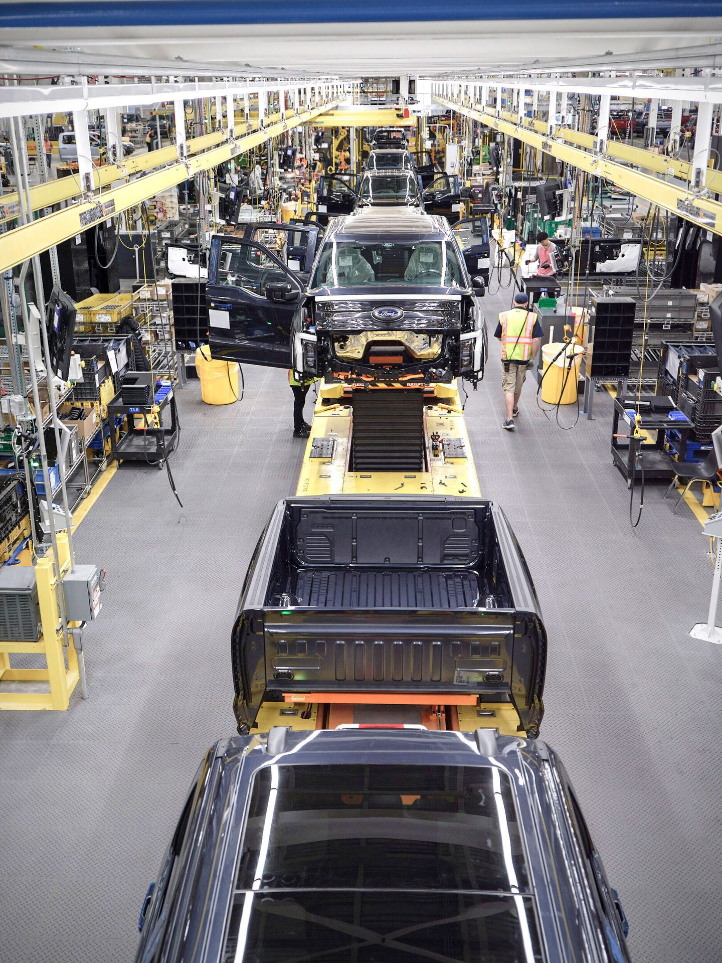

Mass-produced EVs, such as the Ford Lightning, are assembled in large factories that take advantage of economies of scale. Photo courtesy Ford Motor Co.

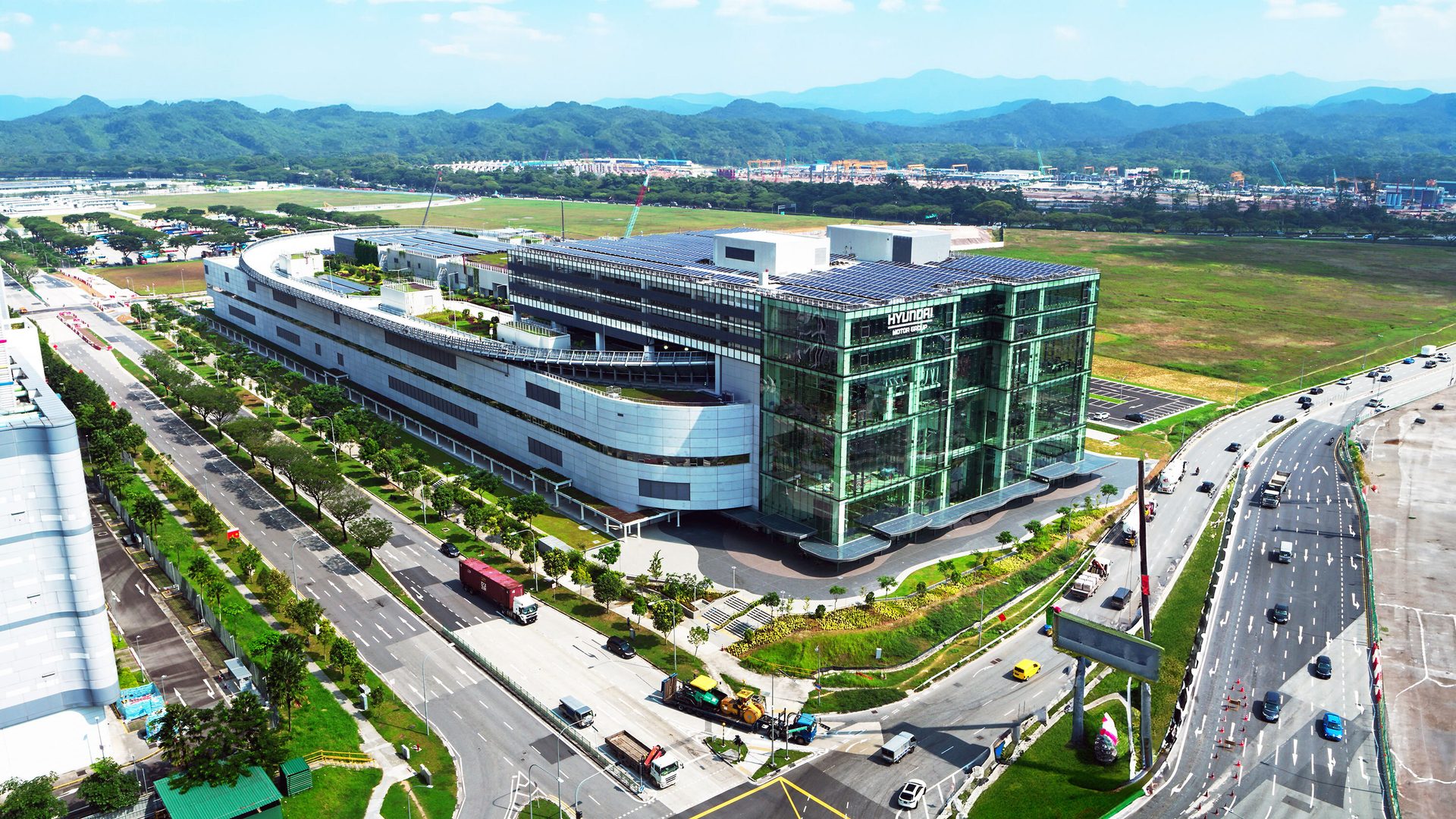

Hyundai’s new microfactory in Singapore is located in the heart of one of the densest cities in the world. Photo courtesy Hyundai Motor Group

Hyundai recently became the first major automaker to use a microfactory to produce electric vehicles. Photo courtesy Hyundai Motor Group

Hyundai’s microfactory features a highly automated flexible production system capable of assembling 30,000 EVs a year. Photo courtesy Hyundai Motor Group

Hyundai recently became the first major automaker to use a microfactory to produce electric vehicles. The Hyundai Motor Group Innovation Center Singapore (HMGICS) is located in the heart of one of the densest cities in the world.
The seven-story facility includes a highly automated flexible production system capable of assembling 30,000 EVs a year. It operates with a much smaller footprint than traditional auto factories.
Vehicles are built in a cell rather than on a long, linear assembly line. Each automated cell attaches different components to a vehicle before it moves to the next cell via an automated guided vehicle.
“By combining our manufacturing expertise and the latest cutting-edge technologies, the result is…a new paradigm of manufacturing,” claims Euisun Chung, executive chairman of Hyundai Motor Group. “HMGICS is an open and connected urban innovation hub that encourages and embraces creativity and collaboration. It seeks to completely redefine the very concept of manufacturing.”
Electric vehicles such as the IONIQ 5 and IONIQ 6 are assembled in “a cell-based production system that leaves behind the traditional conveyor-belt manufacturing approach to achieve unsurpassed standards of flexibility and automation,” says Chung. “Approximately 50 percent of all tasks are carried out by 200 robots, with humans, robotics and AI systems achieving unprecedented levels of collaboration thanks to integration made possible by the digital twin platform.”
“Robots perform assembly, inspection and production facility organization, and take care of more than 60 percent of component process management, ordering and transportation,” adds Alpesh Patel, vice president of HMGICS. “This frees humans from repetitive and laborious tasks to focus on more creative and productive duties.
“With the help of robotics, AI and the Internet of Things, we’ve built a human-centric manufacturing innovation system that can respond to changes in mobility, processes and products with agility and flexibility,” notes Patel. “These innovations are setting new benchmarks for efficiency and customization.”

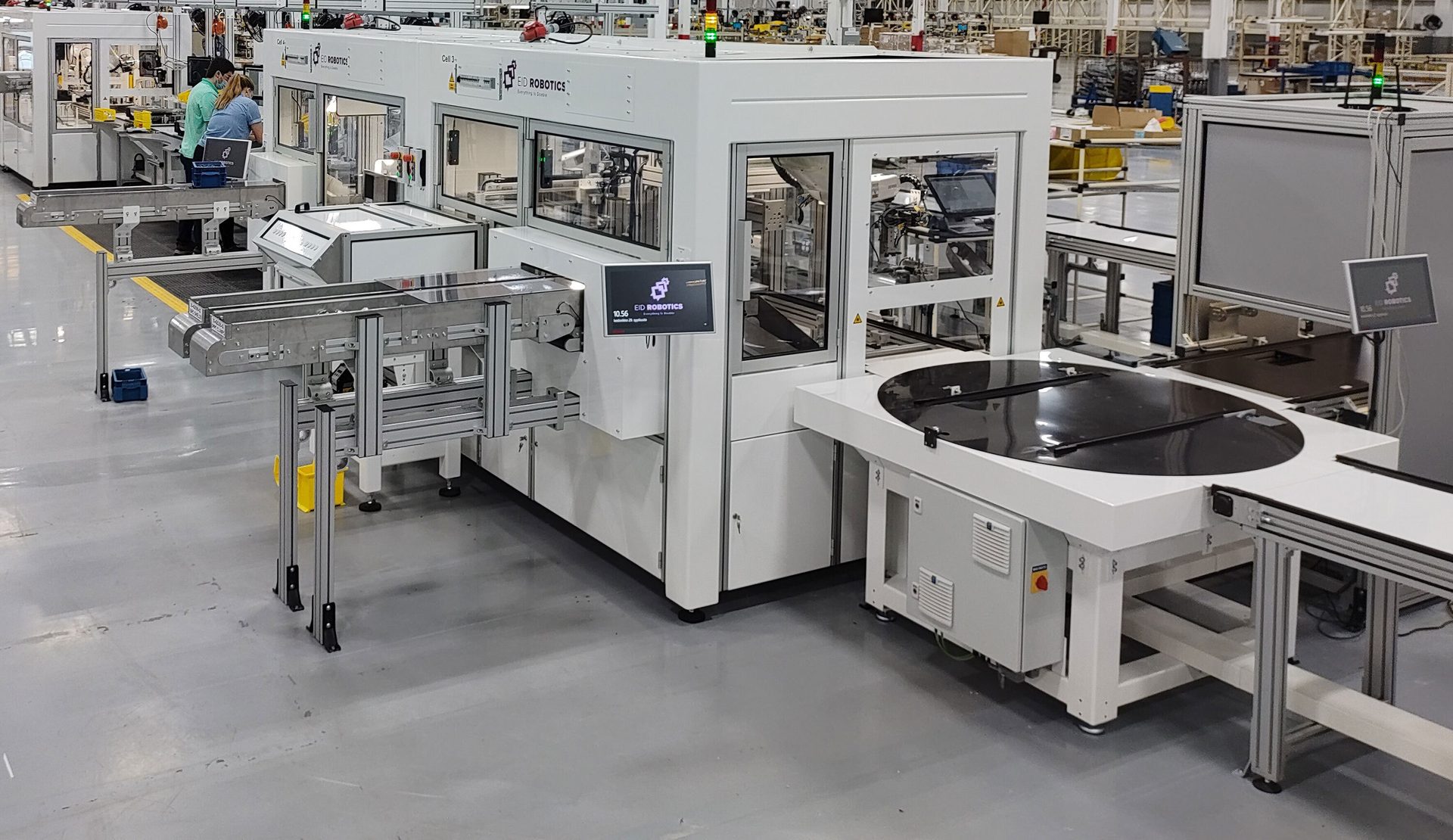

Ample Inc. is using a modular automation system to ramp up production at its microfactory near San Francisco. Photo courtesy EID Robotics Inc.
The automaker invested $81 million to create a facility where no more than six vehicles will be assembled at one time to ensure high levels of quality by a team of operators that GM refers to as “artisans.”

Another company deploying the microfactory concept is Ample Inc., a start-up that specializes in EV battery swapping technology. It is using a modular automation system provided by EID Robotics Inc. to ramp up production at its facility in Brisbane, CA.

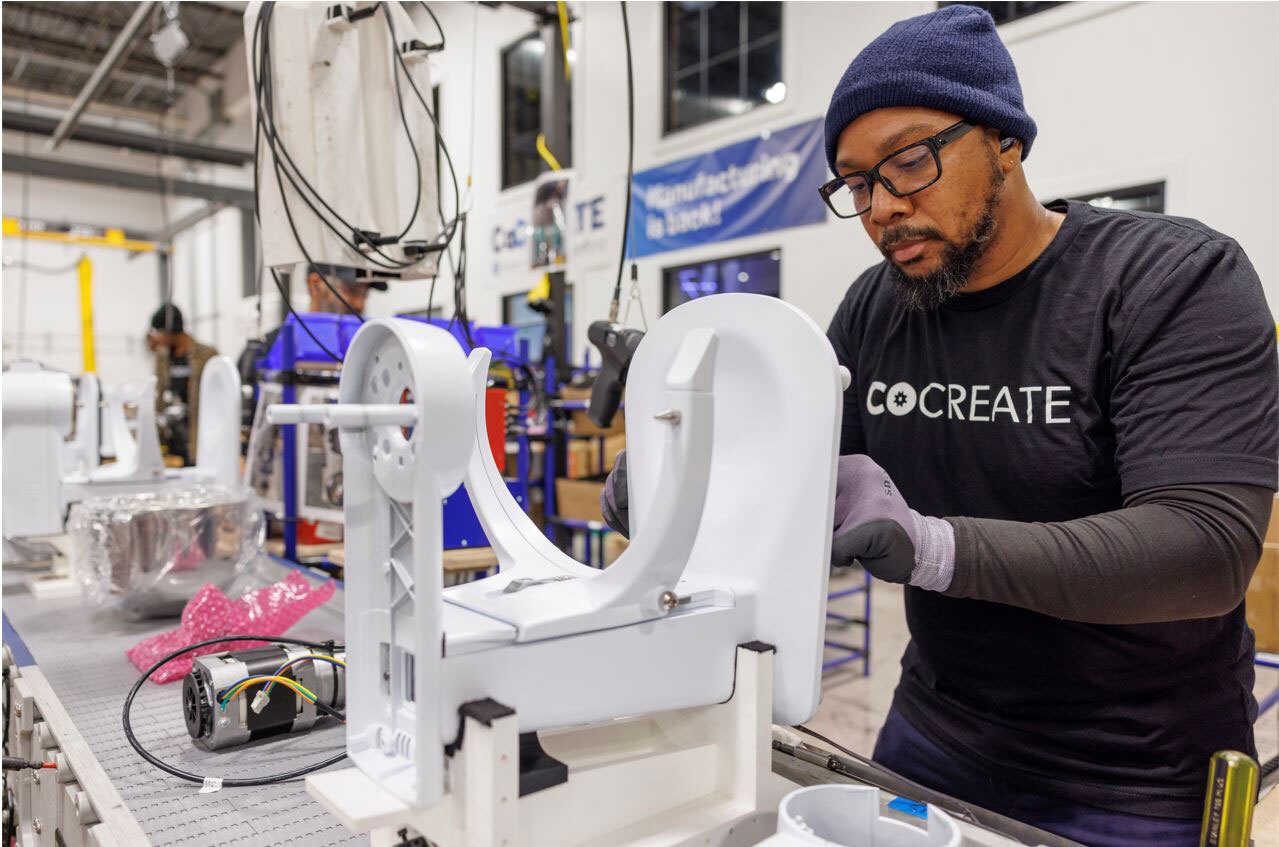

GE Appliances is using a microfactory to produce small-batch products such as mixers. Photo courtesy GE Appliances

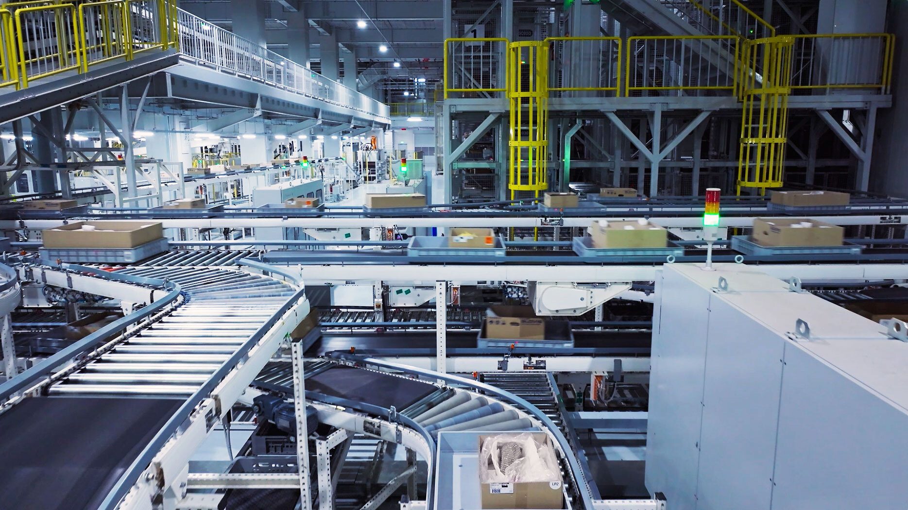

Unlike traditional custom-made manufacturing lines, EID’s ANT Plant is built from standardized robotic assembly cells. It can be configured to assemble and test a variety of electromechanical devices, such as batteries, medical devices or lighting fixtures. ANT Plant's modularity and predesigned cells enable faster design and deployment, and lower cost, than traditional automation options.
“This is a great example of how [microfactories] can help manufacturers build efficient operations at the local level instead of outsourcing production overseas,” says Andy Korhonen, senior vice president of U.S. operations at EID Robotics. “Modularity is an important part of the microfactory concept, because it enables various production cells to click together like Lego blocks. It enables start-ups to scale up production quickly and reduce costs by around 30 percent.”
In addition to electric vehicle manufacturers, companies in other sectors are intrigued by the benefit of microfactories.
“[They] are used in industries such as consumer goods, electronics and white goods, and also as reactor technology for chemical plants or better scalability,” says the International Centre for Industrial Transformation’s Klein. “These industries often benefit from the agility, customization capabilities and reduced overhead costs offered by microfactory production models.”
At FirstBuild in Louisville, KY, GE Appliances is using a microfactory to create new types of cooking products. From these small-batch appliances, the company can scale up to larger-volume production in its traditional factories.
“This new model reduces the cost and risk of product development and enables fast market validation, so products make it to market faster,” says Kevin Nolan, president and CEO of GE Appliances.
The company has recently expanded its microfactory footprint, opening sites in other cities. Last fall, for instance, it opened CoCREATE Stamford to assemble small appliances such as the Monogram Hearth Oven and the GE Profile Smart Mixer. Through partnerships with the University of Connecticut and Connecticut State Colleges & Universities, students work paid, part-time shifts in the factory after classes alongside CoCREATE engineers.
