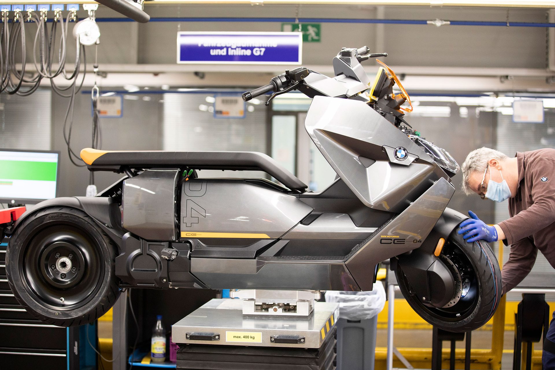

BMW AG has been producing motorcycles for 100 years. And, its Motorrad division has been making electric vehicles for more than 10 years, with a focus on products that address urban mobility needs. The company currently markets CE 02 and CE 04 e-scooters.
Both products are engineered in Germany. The CE 04 is assembled at the flagship BMW Motorrad plant in Berlin, while the eParkourer CE 02 is built under contract in India by the TVS Motor Co. The high-voltage battery and the electric traction motor are manufactured in-house at the Berlin plant.
The housing for the battery is manufactured at the plant’s welding shop and is made of aluminum.
The cell modules are supplied by the BMW Group production network and are inserted into the housing at the Spandau plant. Then, the control unit for the battery is added and the case is sealed. After thoroughly testing the battery, it is transported to the general assembly line.
The CE 04 features a separately excited synchronous motor that operates at 148 volts and delivers 31 kilowatts of power.

“Instead of a fuel tank, a modern energy storage system is used, which supplies the electric motor with the necessary energy, regulated through power electronics,” says Christian Ott, C-Series product manager. “For those who need to charge on the go, an integrated onboard charger allows the battery to be charged up to 80 percent at public stations in just under an hour.
“Thanks to the simple operation without a clutch and gearbox, the technology fades into the background, making it pure fun, even for inexperienced motorcyclists,” explains Ott. “Even maneuvering and parking becomes child’s play with the electric reverse assist at the push of a button.”
Power and torque are transmitted to the rear wheel of the CE 04 via a belt drive. The result is powerful acceleration, taking just 2.5 seconds to go from 0 to 31 miles per hour.
“The complexity of the components can be rated lower than that of a comparable vehicle with a combustion engine,” explains Ott. “The biggest challenge is to design the drive components—especially regarding weight and range—and to integrate them aesthetically into the vehicle package.”

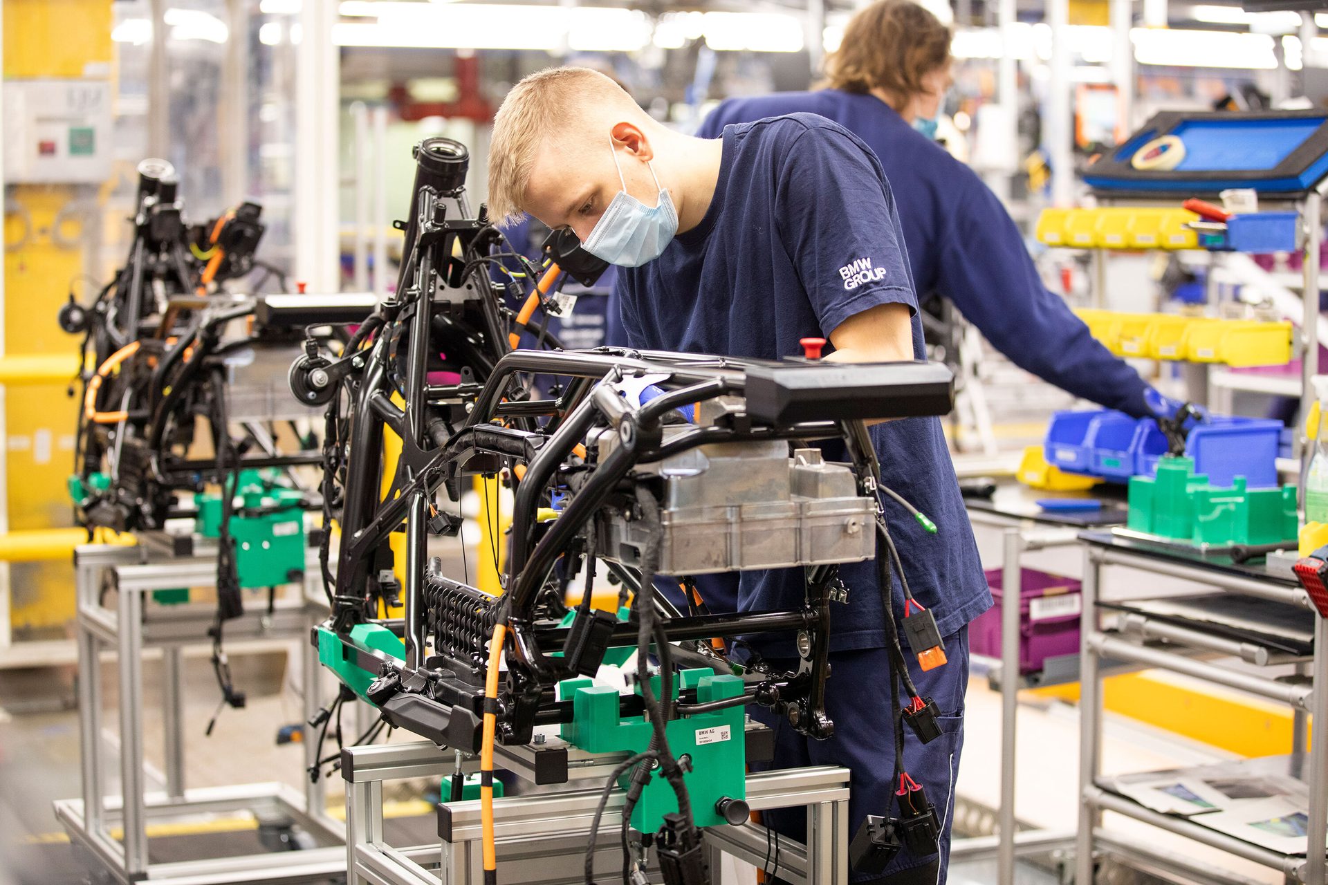

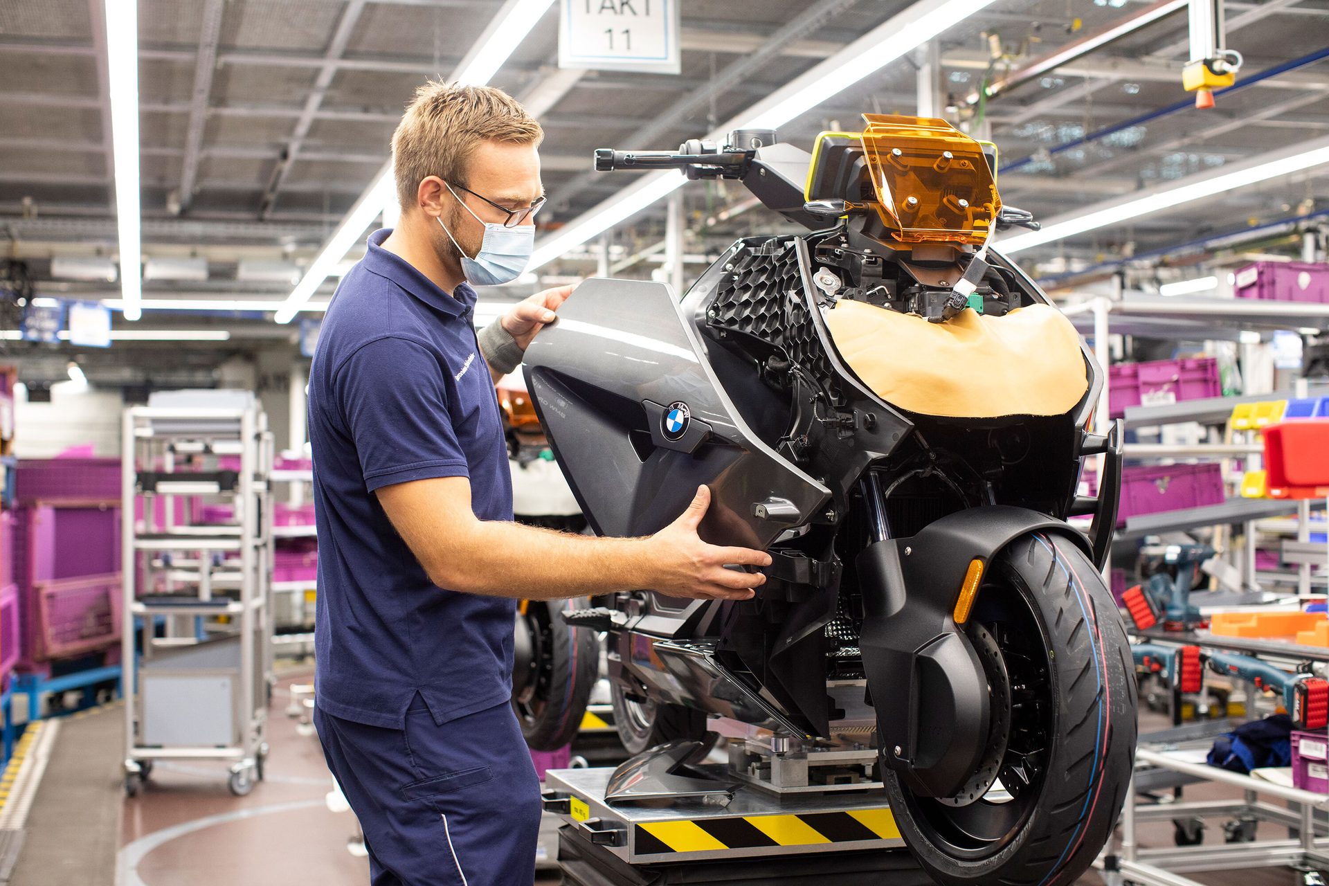

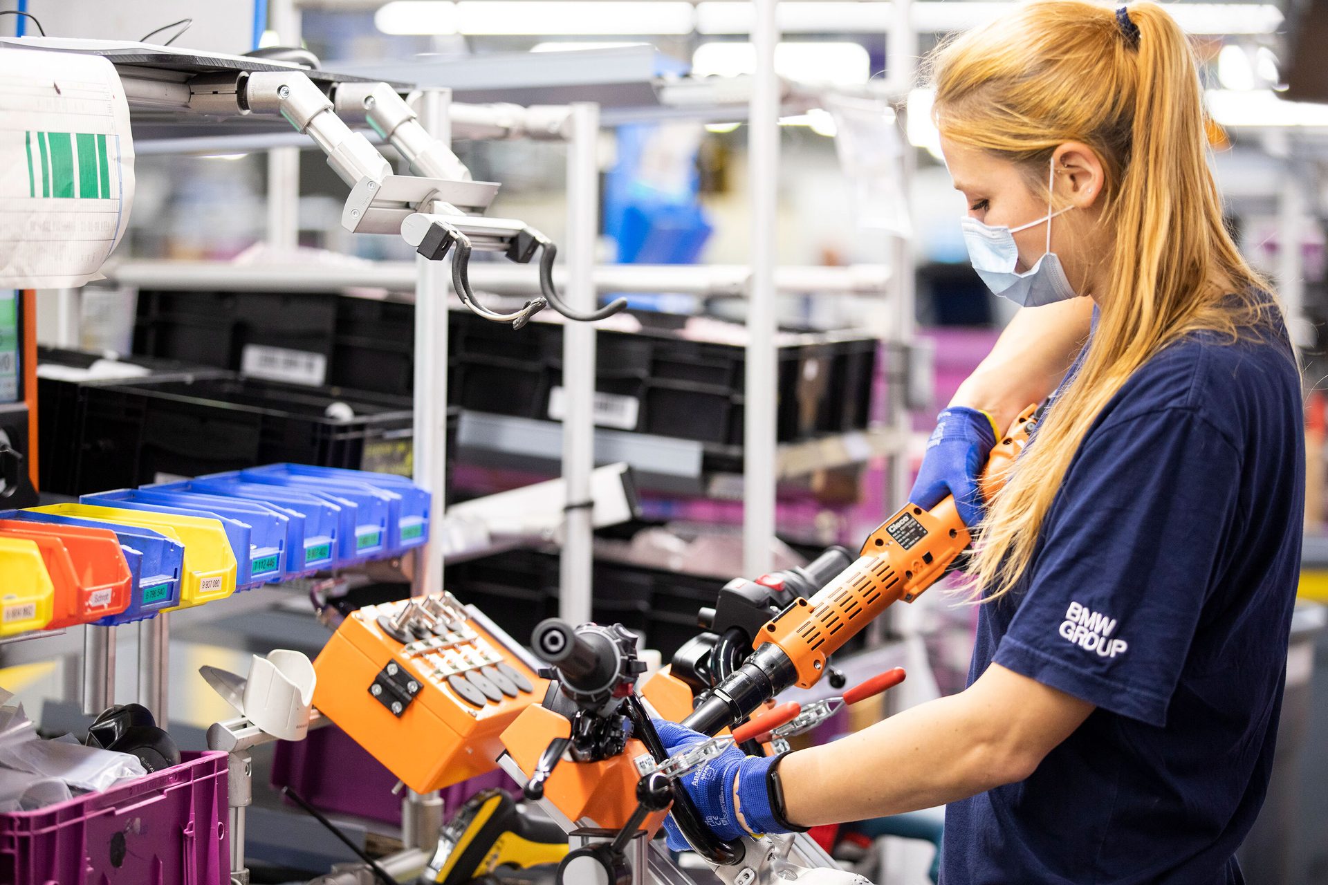

The CE 04 is produced on a dedicated assembly line. The first step is to attach the battery and traction motor to the frame, then connect the wiring harness. Next, various chassis parts are attached, followed by the body fairings, which are finished at the company’s in-house paint shop.
The last step on the assembly line is an overall inspection and quality check. After that, the electric scooter enters the media filling station, where brake fluid is added. Finally, the e-scooters take a test drive on a dyno where all functions are carefully checked and calibrated.
Automation is used for welding and engine assembly applications. But, most of the final assembly line involves manual processes.

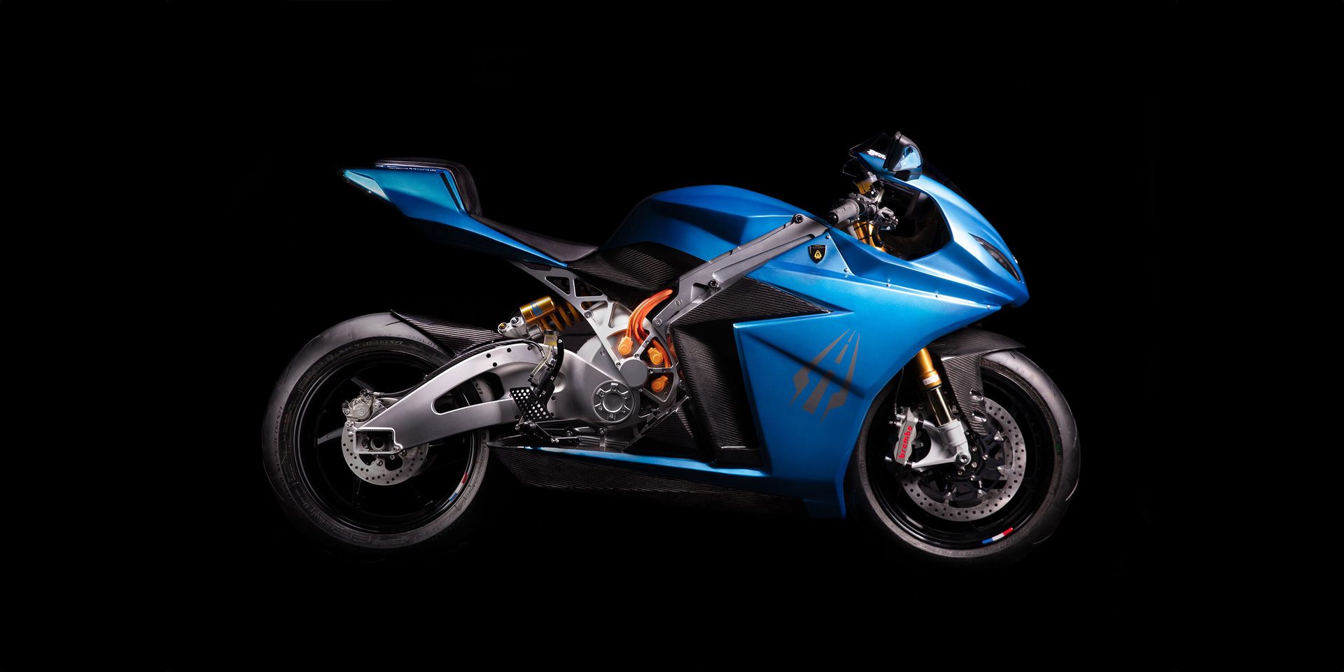

Lightning Motorcycle Corp., founded in 2006, carved out an early reputation in the competitive world of racing. The company built the world’s first lithium-ion battery-powered sport bike, then proved its mettle by competing against—and beating—gas-powered rivals.
After setting speed records on the Bonneville salt flats and claiming victory at the Pikes Peak hill climb in 2013 by defeating the Ducati factory team by more than 10 seconds, Lightning pivoted from racing to production.
However, delivering the world’s fastest electric motorcycles isn’t just about speed for the company. It’s about precision, performance and complete control of the process from concept to final bolt.
“The first customer bike was a street-legal, road-going version of the bike that set the land speed record, won Le Mans and won Pikes Peak,” says Richard Hatfield, CEO of Lightning Motorcycle. “It featured over 240-hp at the rear wheel and 220-ft-lbs of torque at the motor shaft.”
The LS-218, named for its 218 mph top speed at Bonneville, was the company’s first commercial product. The custom machine blurred the lines between track weapon and luxury object. Each bike is made by hand in Hollister, CA.
“We’re making the majority of our components in-house,” says Hatfield. “[However], we buy battery cells, and we have a company that does windings and lamination for our motors.” It also purchases printed circuit boards (PCBs) from suppliers.

“It was a bike that was built to deliver good value,” says Hatfield. That value, he argues, isn’t just in the performance specs—it’s revealed in how the bike is built.

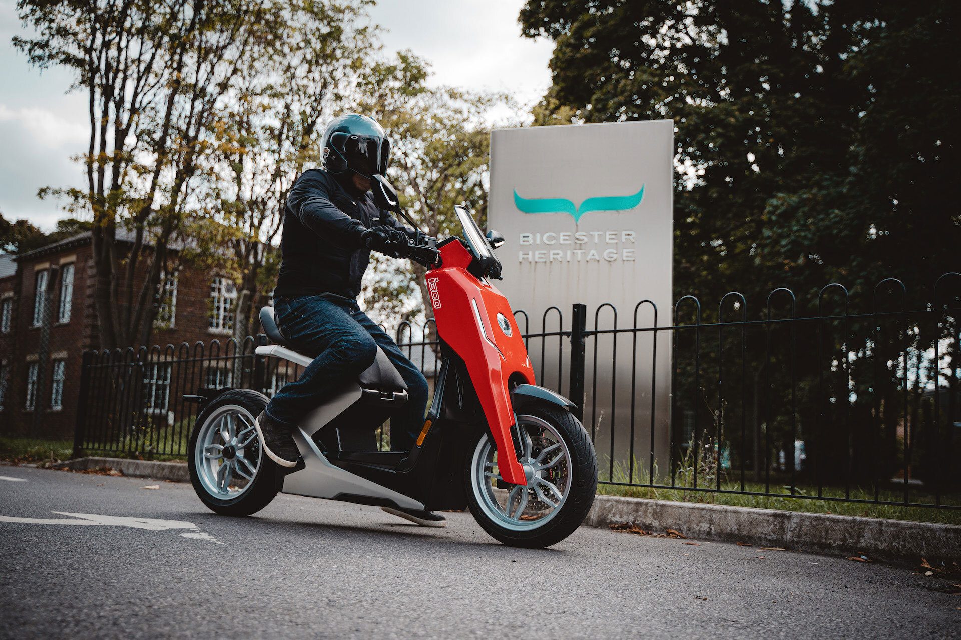

Zapp Takes a Modular Approach
Zapp Electric Vehicles Ltd., a British company based in London, recently started to produce its i300 model. The electric scooter for urban applications is designed to offer motorcycle-level performance within a step-through format.
Assembly takes place at the company’s new facility in the Bangkok Free Trade Zone. Production began in December 2024.
The i300 is road-certified in multiple markets and does not require a motorcycle license in some regions. The 19-hp e-scooter can accelerate from 0 to 30 mph in approximately 2.35 seconds. Its electronically limited top speed is 60 mph. In Eco mode, the estimated travel range is approximately 37 miles per charge.
“We’ve just made our first run of production,” says David MacIntyre, chief operating officer at Zapp. “The assembly facility allows us to build over 20,000 units per year. Our investment is in the hundreds of thousands of dollars, as opposed to hundreds of millions.”
Initial deliveries will begin in Thailand, with plans to expand across other Asian markets and into Europe later in 2025. The facility in Bangkok covers less than 12,000 square feet and follows a modular, scalable, manual production process.
“We call it our reference manufacturing site, and it’s a model that can be replicated in other markets around the world,” claims MacIntyre.
The i300 features an exoskeleton chassis that provides a lower center of gravity and fewer total components. It uses a mid-mounted, air-cooled interior permanent magnet (IPM) electric motor, which is compact and designed for high efficiency.
The power system includes two removable lithium-ion battery packs. Each battery weighs around 13 pounds and is located beneath the rider’s feet to contribute to mass centralization. The i300 can operate with either one or both batteries installed.
The batteries are designed to be charged off the bike using a standard wall outlet. This modular charging capability offers users flexibility for daily urban commuting without relying on dedicated charging infrastructure.

This electric scooter offers motorcycle-level performance. Photo courtesy Zapp Electric Vehicles Ltd
“The IPM motor is the most efficient device that we could find on the market to suit our needs,” says MacIntyre. “It can deliver up to 95 percent efficiency.”
The motor’s compact size and light weight align with Zapp’s overall design philosophy of maintaining a low center of gravity and lightweight construction. To complement the motor, engineers designed a battery system that focuses on volumetric energy density.
“You can leave one battery in the bike while you’re charging the other one,” notes MacIntyre. “You just take out the battery and charge it like a laptop.”

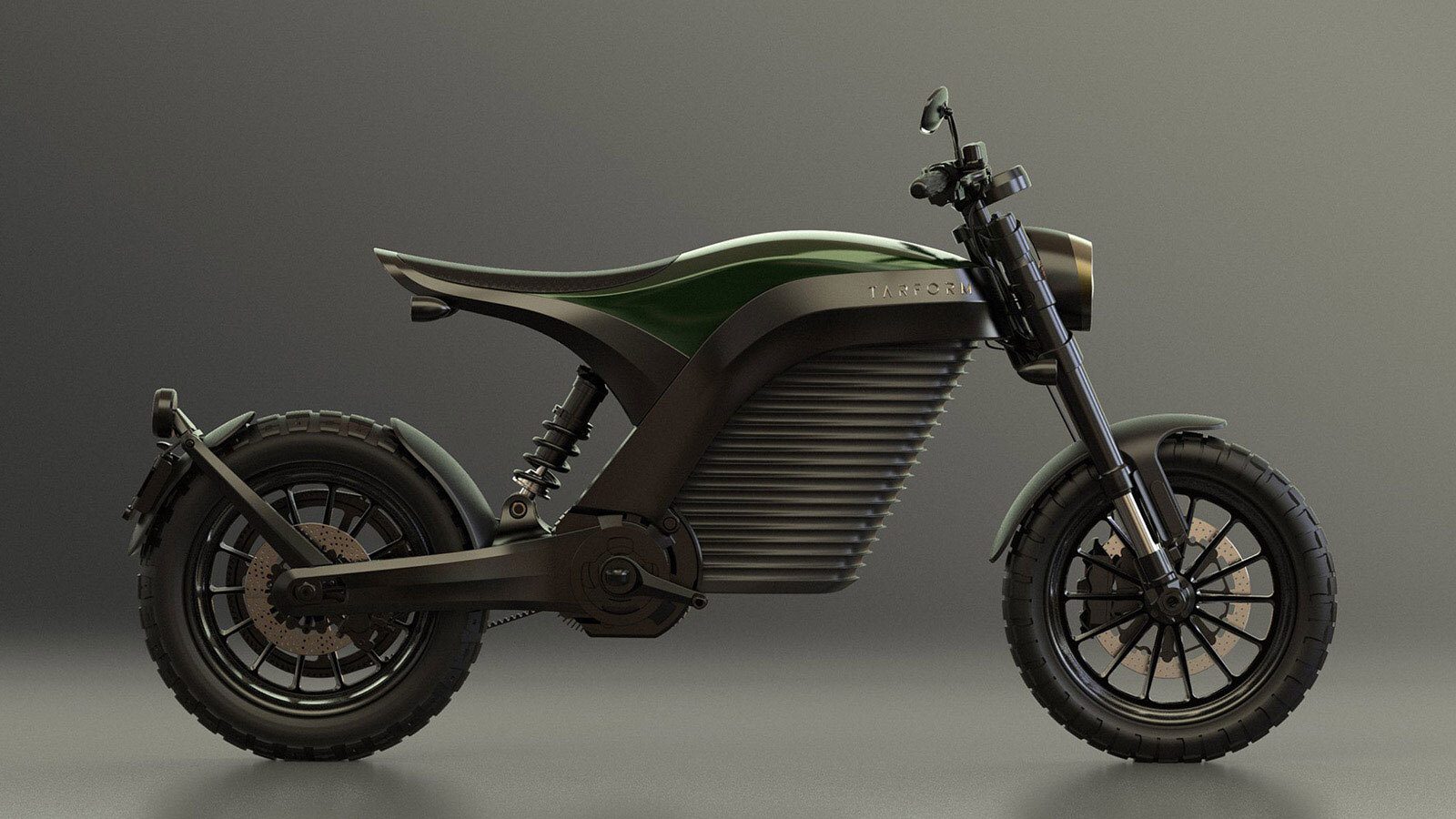

What began as sketches on a napkin a decade ago has grown into an electric motorcycle start-up called Tarform Inc. The company evolved from founder and CEO Taras Kravtchouk’s ambition to blend classic motorcycle aesthetics with the future of electric mobility.
Kravtchouk, whose background is in product design and technology, used to spend his weekdays immersed in screen-based work at his design studio, while his weekends were dedicated to restoring Nortons, Triumphs and other vintage British motorcycles.
By 2017, Kravtchouk began to see a shift in local interest in electric motorcycles. Despite growing conversations around EVs, he felt the available electric bikes lacked the appeal and personality of traditional motorcycles. “No one’s really made anything that is desirable,” claims Kravtchouk.
This observation sparked the idea to build an electric motorcycle that retained the iconic spirit of a vintage café racer while incorporating future-facing design language. Working out of a garage in Brooklyn, Kravtchouk and two collaborators began figuring out what was required to make the concept a reality.
From mechanical engineering to electrical systems, they taught themselves how to build a bike from scratch.
“It took us about a year and a half to build the first two prototypes,” says Kravtchouk. “They were kind of like a vision statement—they were barely running and cobbled together with 3D-printed parts.”
Instead of building everything in-house, the entrepreneurs began reaching out to technology partners, asking if they’d be interested in showcasing their innovations through the prototype bikes. That approach led to a formal launch at New Lab, a Brooklyn, NY-based hardware accelerator located in the old Navy Yard. The prototypes generated interest, leading to early press coverage and an initial round of funding.
That early validation helped transform Tarform from an exploratory design project into a venture-backed start-up aiming to produce electric motorcycles at scale. The company currently has around 30 vehicles on the road, with production time now ranging from one to two weeks per unit.

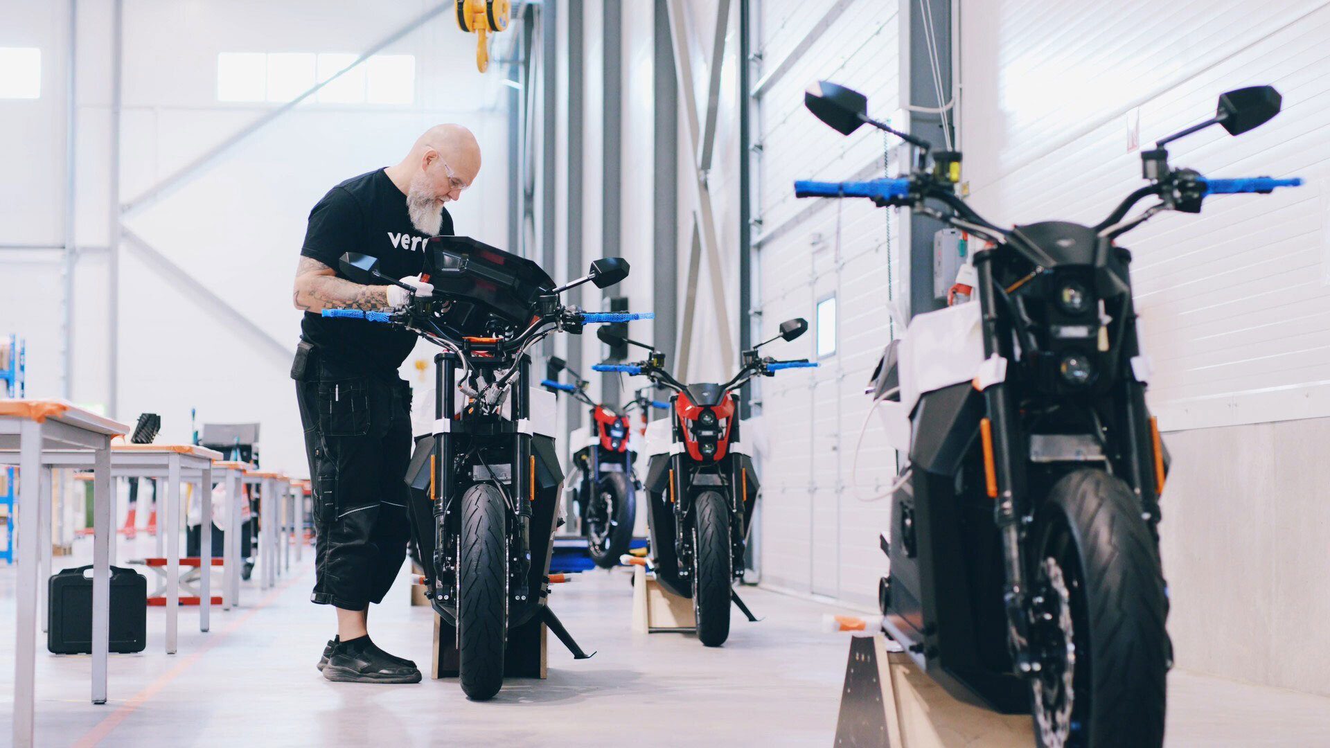

Despite its modest size, Verge’s assembly line features advanced production processes. Photo courtesy Verge Motorcycles
The Luna is a $44,000 luxury model that features a blend of modern electric power train components and classic motorcycle aesthetics. The company’s second model, the Vera, is currently in development and will target a broader market with a lower price point of around $16,000.
Building an electric motorcycle from scratch involved a steep learning curve for Kravtchouk, who began with knowledge of internal combustion engines, but little experience with electric drivetrains. “Most guys who like motorcycles try to avoid electrical stuff because, to a lot of them, it’s just wizardry,” he points out.
Kravtchouk’s early research involved watching YouTube tutorials and home-build videos to better understand electric vehicle architecture. He identified three core components: battery, motor and inverter. Additional features, such as Bluetooth connectivity and vehicle control units, were layered on later.
Designing the Luna began with aesthetics, bucking the traditional approach of starting with internal components. Kravtchouk prioritized visual appeal to bridge the gap between classic motorcycles and futuristic design.
After finalizing the exterior, Kravtchouk collaborated with a French company to develop a 10-kilowatt-hour battery pack that balanced range and performance. A redesigned trellis frame and new battery system followed, resulting in a preproduction model with improved handling, acceleration and range.
“The only thing I think we kept from the first prototype was the motor,” says Kravtchouk. “The development process emphasized performance characteristics like weight distribution and handling.
“A lot of thought and attention went into weight distribution, handling and trying to find a perfect blend between a bike you can take on the highway and something nimble in the city,” explains Kravtchouk.
Sustainability was also a major focus. That’s why the Luna incorporates hand-shaped aluminum tanks, in addition to carbon fiber and bio-based materials.
“How we reduce our waste throughout the whole manufacturing cycle was a major consideration,” claims Kravtchouk. His environmental goals extend beyond producing zero-emission vehicles; they aim to improve the entire lifecycle of the motorcycles.
Tarform produces vehicles in batches of five to 10 at a time, adjusting designs based on customer feedback to refine the power train, improve reliability and reduce overall weight.
Design work begins with 3D modeling software before moving into Fusion 360 or SolidWorks for detailed mechanical design and system integration. Once designs are finalized, parts are either printed in-house for prototyping or sent out to a global network of suppliers across Canada, China, India, Mexico and Sweden.

“We don’t manufacture parts ourselves,” says Kravtchouk. “There are hundreds, all requiring different manufacturing methods. It’s basically like a giant Lego set.”
As production scaled, Tarform hired a production engineer with experience at Aston Martin and McLaren. “He helped us create a blueprint for quality control, inventory management and standard operating procedures,” explains Kravtchouk. “Initially, it felt like wasted time, but we quickly saw the value of proper documentation and workflow tracking.”
By adopting lean manufacturing principles, Tarform was able to streamline its shop for efficiency, create workflows and minimize waste.
Each motorcycle is assembled according to a 120-step build sequence starting with the frame, battery, motor and controller, followed by electrical components and accessories. Once fully assembled, the bike undergoes rigorous testing. Each vehicle is personally test-ridden for several hours by Kravtchouk himself around the Brooklyn Navy Yard for several hours.
As Tarform transitions from its custom-made Luna motorcycle to the more mass-market Vera, the company is rethinking how it approaches production. The lessons learned from building the Luna are shaping the strategic direction of the Vera.
“We learned so much from Luna,” recalls Kravtchouk. “How do we reduce parts? How do we reuse parts we’ve already developed? How do we make things lighter, more efficient and streamline our assembly process?”
The Vera’s design process prioritized simplification and scalability. The focus has shifted toward keeping key components and design elements that define the brand’s visual identity, while eliminating unnecessary complexity to make production more efficient.
The first batch of Vera motorcycles will follow a low-volume production pattern, before scaling up. Between 20 and 50 units will be built in Brooklyn using the company’s refined in-house assembly process, which includes subassemblies, structured build sequences and end-of-line testing. However, to scale up further, Tarform plans to transition to a contract manufacturing model.
“The idea is to outsource to a contract manufacturer somewhere in the United States,” says Kravtchouk. He’s currently evaluating potential partners and locations to establish this next phase of production.

Verge Motorcycles is building its electric future in Estonia, with a manufacturing strategy rooted in autonomy, scalability and precision engineering. Led by CEO Tuomo Lehtimäki, the company produces two models of electric motorcycles—the TS Pro and the TS Ultra—designed to combine high-tech functionality with a European supply chain and a flexible factory model.
The TS Pro model has been in limited production for two years and is currently only available in Europe. However, deliveries to the U.S. are expected to begin by the end of this year. The TS Ultra is already available for reservation, but will enter production in 2026.
Future improvements to the bikes will focus on battery performance and charging speed. “We will have faster charging bikes that go longer distances,” says Lehtimäki. He believes adding battery safety and range are critical to making gas-powered motorcycles obsolete.
The start-up company evolved from a desire to reimagine personal mobility for a new generation of riders seeking powerful, sustainable and low-maintenance alternatives to traditional motorcycles.
Verge’s factory, located outside Tallinn, spans 43,000 square feet and operates with a compact, but carefully integrated layout. The facility was designed to remain flexible, with all equipment intentionally unbolted from the floor.
This portability is central to Verge’s broader manufacturing strategy: treat the factory itself as a flexible product that can be copied and easily deployed in new markets.
“We can have all the same tools and same layout in any empty building,” says Lehtimäki. “If we need a factory in South America, we can buy all the same things we have here. We copy this factory and start locally.”
The Estonian facility currently handles motor assembly, battery pack production and final bike assembly under one roof. Despite its modest size, Verge’s assembly line supports advanced production processes.
“We have 200 suppliers and build the motors in-house, from coil winding to assembly,” explains Lehtimäk. Verge also produces its own frames using a robotic welding cell.
Rather than chasing the lowest price globally, the company has focused on building relationships with reliable suppliers in Estonia, Finland, Germany, Italy and Sweden.
Last year, Verge built 100 vehicles, which is a pace deliberately aimed at ensuring quality and refining processes. “We don’t want to accelerate too quickly,” says Lehtimäki.
The company’s modular, transportable factory model not only provides agility in uncertain global markets, but also aligns with Verge’s values of transparency and local engagement. “We are ready to just copy and paste a similar assembly plant to any country,” claims Lehtimäki.
With an in-house supply chain, a flexible factory model and ambitious expansion plans, Verge is positioning itself as a long-term player in the premium electric motorcycle market. As production scales, its modular approach to manufacturing may allow it to reach new markets without sacrificing its identity or values.
