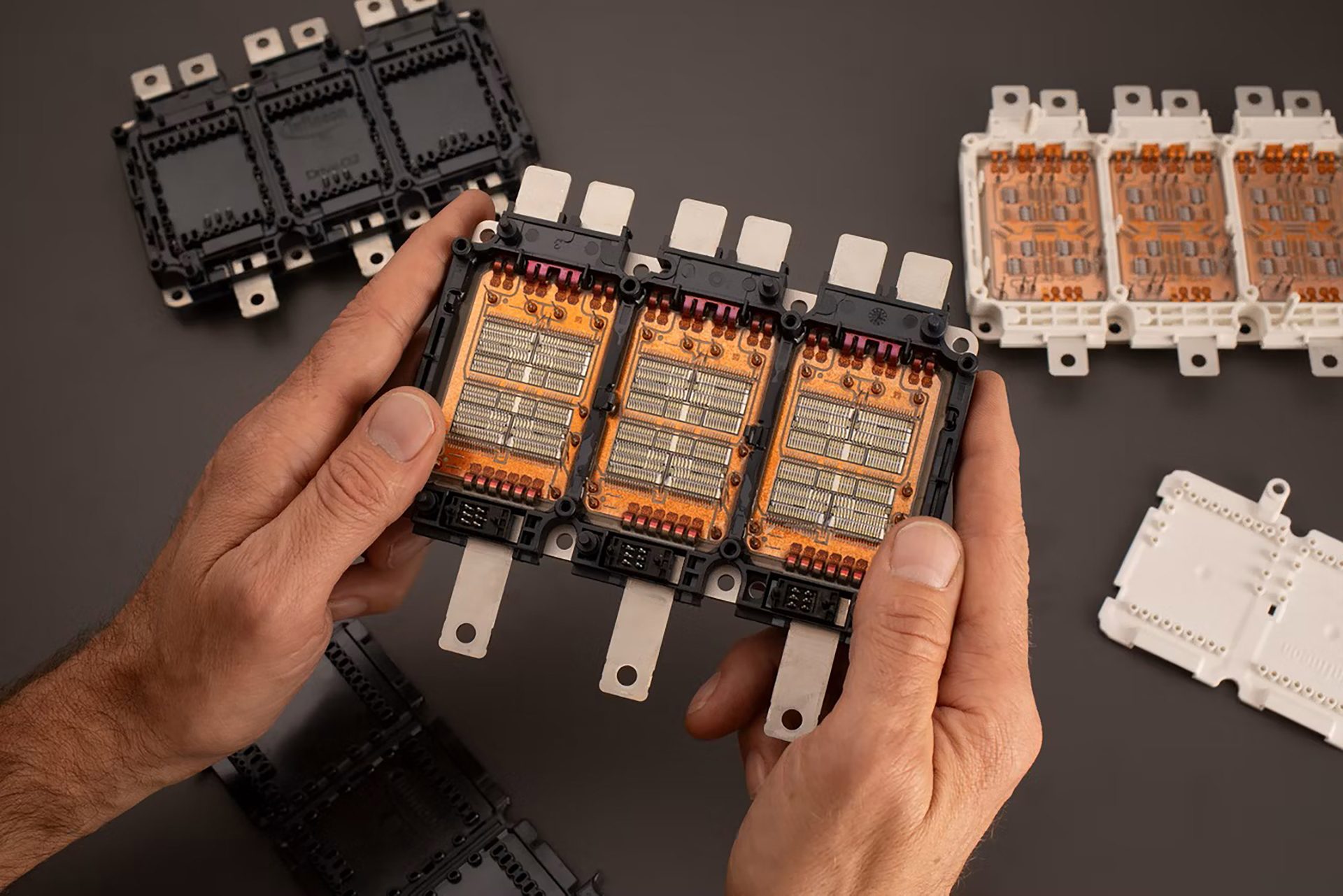

“Power electronics manufacturing differs depending on the material,” explains Fall. “Silicon has historically been the semiconductor material of choice for EV applications at both high and low voltages. With mature, diverse supply chains and decades of manufacturing refinement, silicon is the cheapest semiconductor material for power applications. Silicon carbide is more complex and expensive.”
SiC cannot be grown from melt. The dominant crystal growth method for SiC is physical vapor transport, where SiC powder sublimes and recrystallizes on a seed crystal under tightly controlled temperatures.

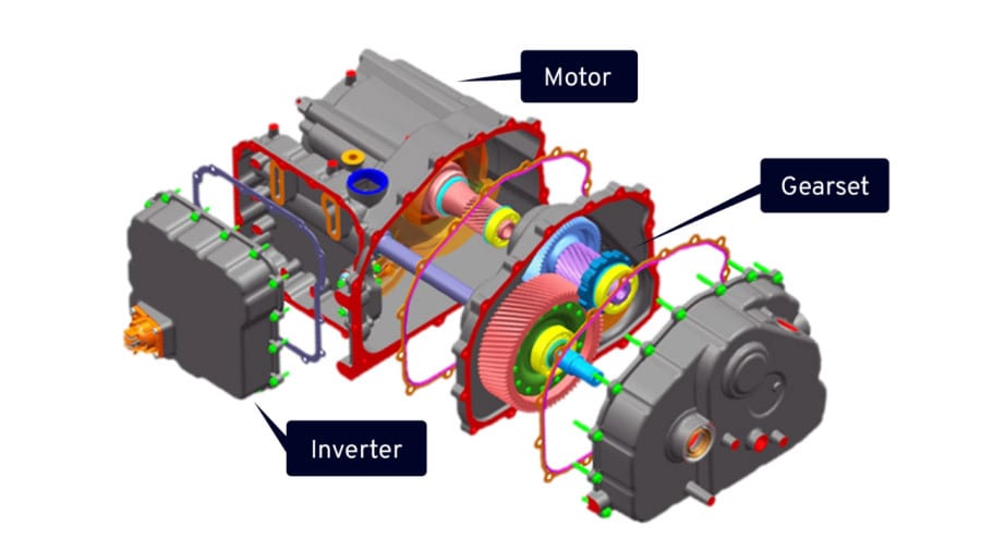

Inverters take DC power stored in an EV battery and turn it into AC power for traction motors. Illustration courtesy General Motors
While 300-millimeter Si wafers are commonplace, SiC wafers are commercially available at only 200-millimeter, which reduces the number of dies available per wafer. However, Wolfspeed Inc. recently announced that it has developed a 300-millimeter SiC monocrystalline wafer.
Thermal and mechanical interfaces between the semiconductor die and substrate are usually achieved with silver sintering. Interconnection is facilitated by wire bonding, using either aluminum or copper. Whether wire or ribbon is used depends on the specific power module, which is encapsulated in epoxy resin and attached to a metal frame for improved thermal management before it’s attached to a printed circuit board (PCB).
According to Fall, there is considerable variability in the materials and processes used in module packaging. This affects device performance, thermal management and the module’s ability to perform in robust automotive environments.
“Components must be tested extensively,” Fall points out. “The power electronics automotive qualification process represents one of the most demanding series of reliability tests in engineering, involving extremes of temperature and mechanical stress, with operational lifetimes measured in decades.”
Qualified power modules are then transformed into complete inverters, onboard battery chargers or DC-DC converters. That process involves module mounting, thermal interface material application, attachment of cold plates, electrical interconnection and system-level testing.

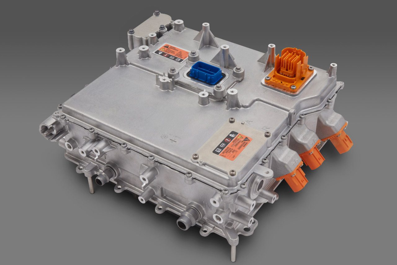

In some cases, GM performs more direct assembly of exposed electronics. Inverter systems, for instance, may be integrated into drive units prior to final installation. These components can be partially open during assembly, requiring additional care in handling and testing.
Despite the technical complexity of these systems, the physical assembly process is relatively straightforward compared to the upstream manufacturing performed by suppliers. Automation is used extensively, but not exclusively.
Operators remain involved in key steps, such as positioning components and initiating assembly sequences, supported by a range of manufacturing controls designed to ensure consistency and traceability.
“It still requires an operator to pick parts up from the pallet and then drop them into the drive unit or the cradle itself,” says Combs.

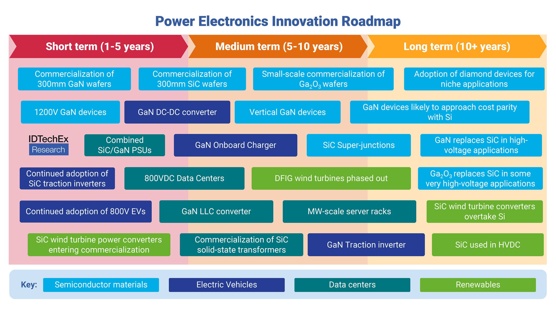

Power electronics will continue to evolve over the next decade. Illustration courtesy IDTechEX
