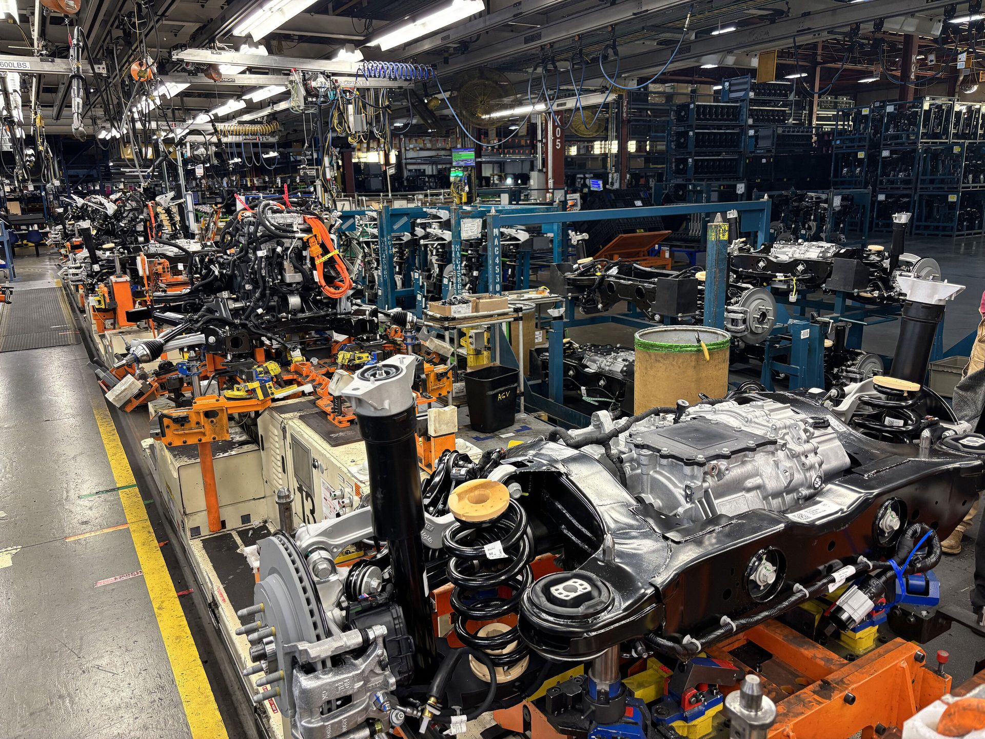

According to Keary, final assembly operations are designed for both flexibility and automation. “We’re really using a modular system of assemblies,” he points out. “If we need to swap in a different gear ratio or motor configuration for a different application, we can do that with minimal rework.”
Each GM drive unit integrates an electric motor, power electronics and gearbox into a compact assembly. Photo courtesy General Motors

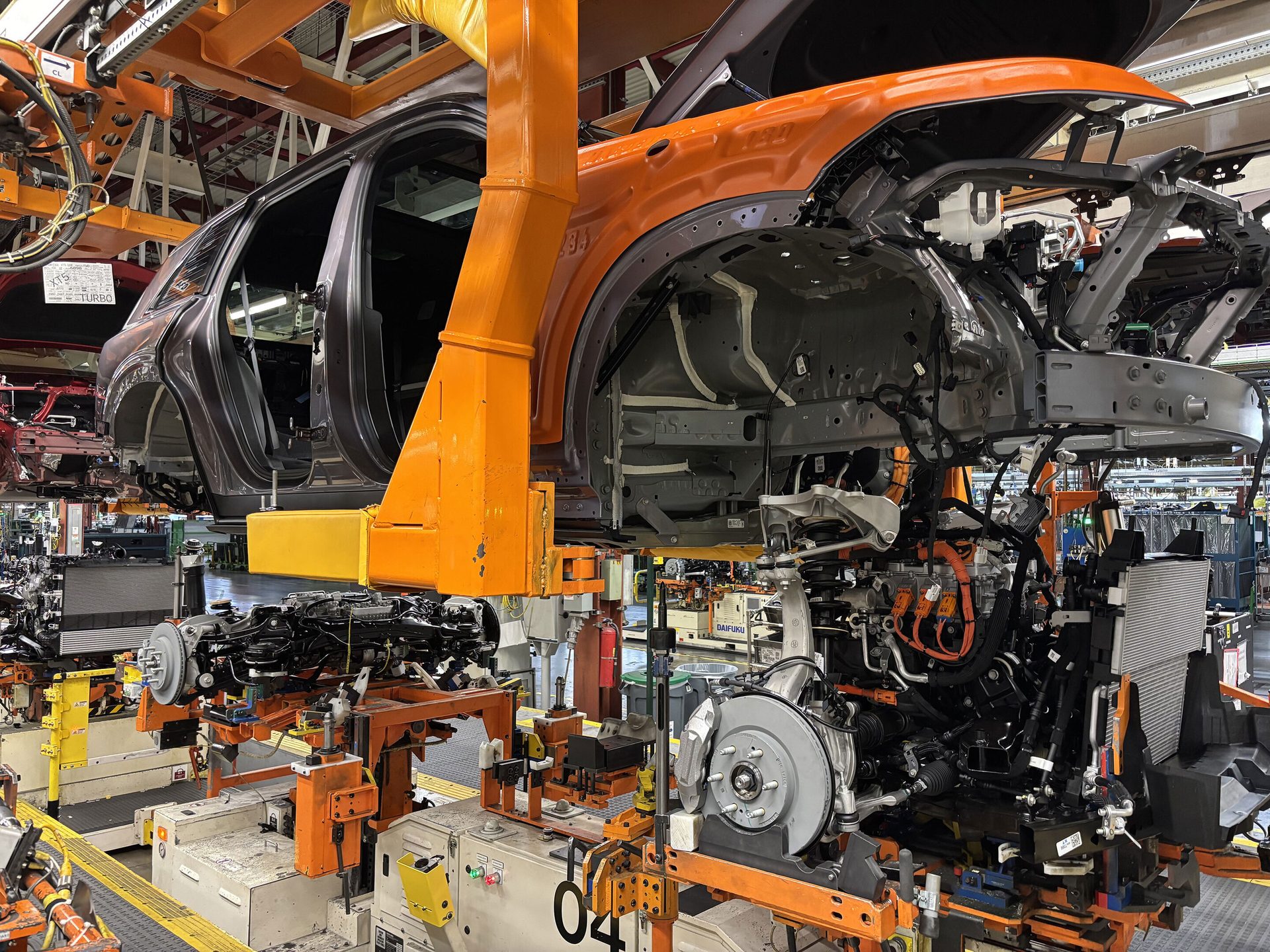

GM’s investment in flexible tooling and automation ensures that each component—from stator winding to final drive unit assembly—can meet volume and quality targets.
“We use automated systems for hairpin insertion, welding and quality checks,” explains Keary. “We’ve worked closely with our manufacturing engineering teams to make sure everything is repeatable and scalable.”

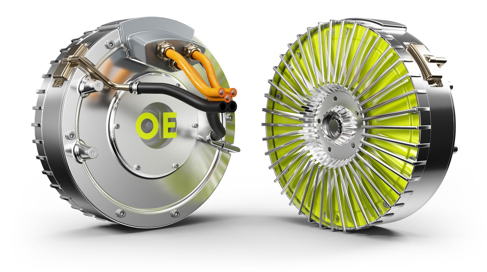

Orbis Electric Wheels Around
Orbis Electric is a start-up company in California that has developed in-wheel axial flux motors that use electric and hybrid power train technology to deliver a slimmer and lighter device. It has several customers that are currently testing the technology in passenger and commercial vehicles.
HaloDrive is designed around a modular four-part architecture with breakthrough innovations like an injection-molded plastic stator and a tunable gearset. This system delivers strong levels of performance, efficiency and configurability, while maintaining high torque and power density with greater thermal stability. It’s designed to reduce vehicle weight and improve range by 20 percent.
“Our vision with HaloDrive is to significantly advance how businesses transition to electrification by removing electric motor barriers such as deployment costs, material and manufacturability risks, and performance limitations,” says Chance Claxton, CEO of Orbis Electric. “With HaloDrive, we offer a high-performance axial flux motor that is not only highly efficient and powerful, but also environmentally sustainable.”
“Our approach with HaloDrive is about creating a motor that not only meets the immediate electrification needs across a range of industries, but is also compact and efficient enough to position businesses for future energy and sustainability standards,” adds Marcus Hays, chief technology officer at Orbis Electric. “We can achieve exceptional performance while also mitigating risks tied to rare-earth materials, ensuring consistent availability and pricing stability.
“Axial flux motors offer significantly greater power and torque density per kilo than other types of permanent magnet motors,” explains Hays. “Our company has been advocating for motors positioned within the wheel openings.”
In-wheel motors are visually distinguishable by a pancake-like form factor, which, due to their exceptionally thin profiles, offer numerous mounting locations.
“Despite these performance advantages, the inherently complex electromechanical internal architecture of axial flux motors requires a significant price premium, which until now has limited their broad adoption,” says Hays.
“[We] can deliver in-wheel motors that weigh no more than conventional wheel assemblies that are motor-less,” claims Hays.
“With AI now fully integrated into our computer-operated simulation studies, we are able to analyze thousands and thousands of permutations within a comparatively short period of time,” Hays points out. “This enables us to ensure that every possible decimal point of improvement in material and operational efficiency can be realized prior to production.
“Cooler motors are not only more energy efficient, but demand less of the surrounding equipment, including storage batteries, inverters, radiators and cooling systems,” says Hays.
Seemingly small gains—even a 1 percent improvement in efficiency—compound and lead to significant improvements in range, cost and sustainability. Reducing the volumetric content of metals such as copper and rare-earth magnets is crucial for the company’s long-term goal.
“We use two-thirds less of these materials than our competitors, while delivering two times the power and torque,” notes Hays. “But, there’s more to do.”
These modular in-wheel motors reduce vehicle weight and improve range by 20 percent. Photo courtesy Orbis Electric

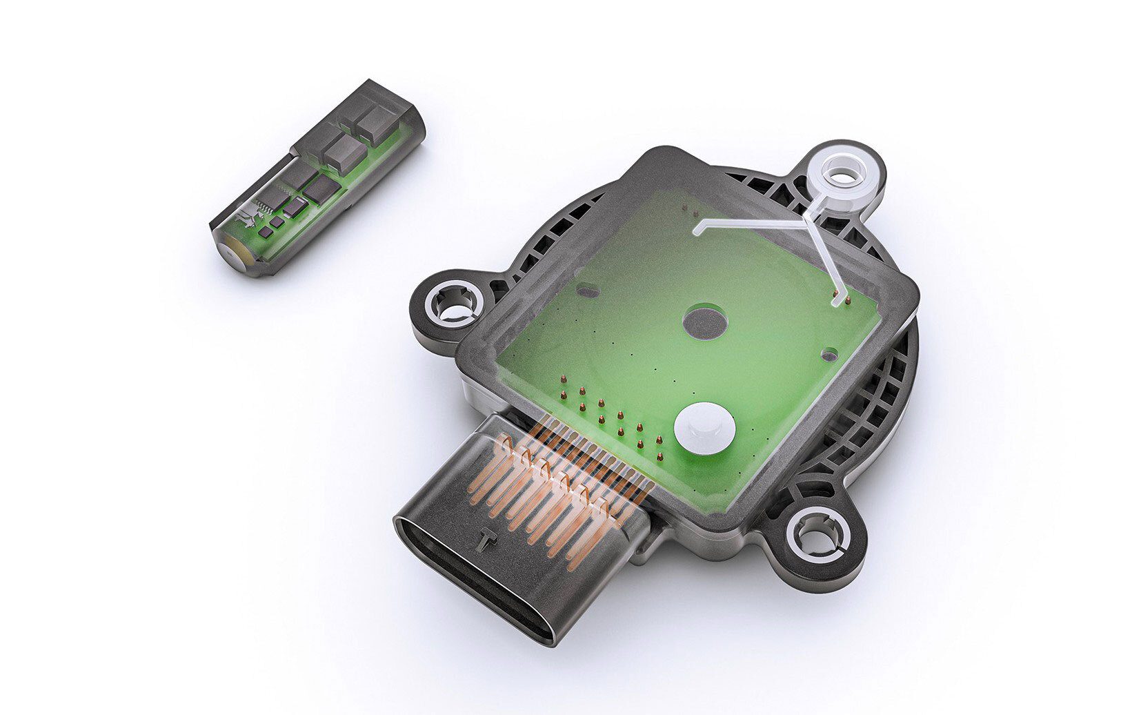

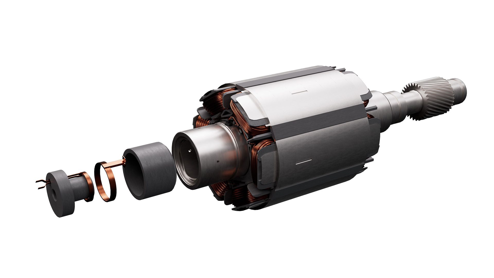

As EV motors and drives evolve, Tier One suppliers are investing in technology to improve performance and reduce costs. For instance, engineers at Continental AG recently developed a rotor temperature sensor (eRTS).
The device enables direct temperature measurement on the rotor, giving e-motors more control over key aspects of power train engineering, potentially unlocking material savings and improved performance. It opens new possibilities for optimizing both magnet configuration and motor cooling.
For PM motors, the ability to measure temperature precisely at the rotor enables engineers to significantly narrow the tolerance range they must design for. That tighter band of uncertainty gives them a choice: either improve performance or reduce the amount of dysprosium required in the magnets.
“In one case, OEMs can reduce the dysprosium content thanks to the smaller tolerance range now needed,” says Franck Nieceron, electronic group leader for development e-mobility sensors at Continental. “This leads to material savings in both cost and environmental impact.”
Alternatively, engineers can maintain their current rare-earth usage and stretch the operating temperature range of the motor, thereby enhancing performance under demanding conditions.
Direct rotor measurement could enable future designs that rely less on aggressive cooling strategies. Illustration courtesy Continental AG
The potential impact on motor cooling is also notable. Direct rotor measurement could enable future designs that rely less on aggressive cooling strategies, although it’s still too early to quantify savings in that area.
“It will potentially allow for reduced cooling requirements, but so far there is no evaluation of savings,” explains Nieceron. “For rotor balancing, integrating the eRTS sensor requires drilling a cavity in the rotor for the sensing unit, a process that could impact existing manufacturing workflows.
“In case an imbalance is an issue that must be handled, it is possible to place a corresponding weight symmetrically opposite or to adjust the rotor mass accordingly to achieve overall balance,” says Nieceron.
While full standardization is not yet feasible, due to the varied nature of electric motor architectures, the core concept of the mote-transducer unit placed on the stator is already defined.
“We have successfully tested the concept and the savings,” Nieceron points out. “We are ready to develop the system with car manufacturers. The standardization and integration will follow once serial production comes closer.”
Given the diversity in EV motor designs, including differences in shape, operating speeds and thermal environments, Continental doesn’t expect to deliver a one-size-fits-all solution.
Instead, Nieceron says the goal is to adapt the eRTS architecture with only minor modifications to suit different customer requirements and inverter protocols.
Beyond integration mechanics, the eRTS system also offers strategic implications for sourcing materials.
By reducing the rotor temperature tolerance range from 59 F to 37 F, the sensor enables tighter performance control and allows OEMs to use less dysprosium.
“The reduction of dysprosium will permit us to reduce dependency on rare-earth elements and secure the sourcing of magnets,” says Nieceron. “Even a few grams of savings per magnet could lead to substantial cost reductions, given current market prices and projected demand from accelerating global electromobility trends. The resulting savings significantly exceed the cost of the sensor.”
Looking ahead, Continental also sees opportunities to combine the eRTS with the existing eRPS (electric rotor position sensor) to streamline EV drive unit design.
By fusing temperature sensing and rotor position tracking into a single product, the company hopes to simplify integration, reduce parts count and shorten assembly time.
According to Nieceron, the dual-function approach supports both cost optimization and vehicle performance enhancements. “This goes in the direction of improving car performance and reducing cost,” he explains. “Combining these two functionalities into one product will help improve costs and reduce the number of components, which in turn simplifies integration.”
This rotor sensor enables direct temperature measurement. Illustration courtesy Continental AG

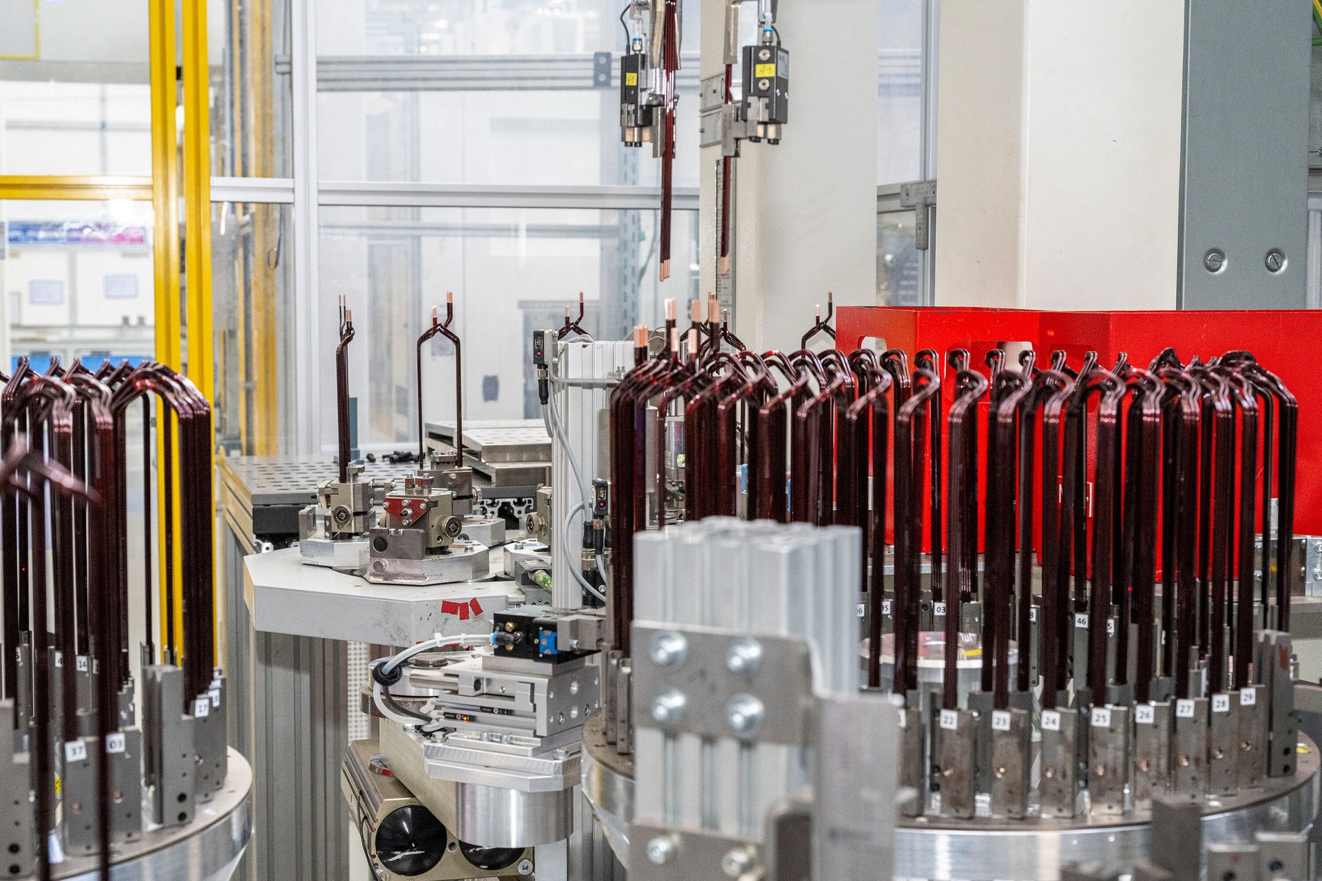

Insulated copper hairpins are inserted into stator slots, shaped and positioned using automated equipment. Photo courtesy Volkswagen AG
According to Krick, a full EV drive system, including motor, inverter and gearbox, can be assembled from approximately 150 components vs. up to 1,500 individual parts for a traditional internal combustion engine (ICE) power train.
“Electric drives are much simpler than ICE power trains, but it is the key component responsible for efficiency,” says Krick, adding that a high degree of automation is essential to achieve stringent quality goals.
Volkswagen uses a highly automated process to mass-produce motors. The most complex element, the stator, begins with a laminated steel core made from 0.2-millimeter thick sheets, which are stamped and prepared with slot insulation to electrically isolate the copper hairpins inserted in the next stages.
The insulated copper hairpins are inserted into the stator slots, shaped and positioned into a configuration referred to internally as a “basket.” That is joined with the stator core, followed by a series of fully automated steps, including widening, twisting and laser welding, to form all electrical connections.
To stabilize and secure the stator windings for a lifetime of operation, the assembly undergoes a “dipping and trickling” process, where a liquid resin is applied and then hardened through controlled heating and cooling.
“This ensures the hairpins are fixed in place,” explains Krick. “Otherwise, movement during operation could lead to insulation issues and electrical failures.”

Separately excited synchronous motor technology eliminates rare-earth dependency. Illustration courtesy ZF

To address this issue, ZF engineers have developed a separately excited synchronous motor (SESM). It transmits energy for the magnetic field via an inductive exciter inside the rotor shaft. This makes the motor compact, with maximum power and torque density.
Compared to traditional SESM systems, the inductive exciter can reduce losses for the energy transmission into the rotor by 15 percent. In addition, the CO2 footprint in production, which arises with PM synchronous e-motors due to magnets that rely on rare-earth materials, can be reduced by up to 50 percent.
Torque density is also significantly increased, because of an innovative rotor design. The space-neutral integration of the exciter into the rotor means that there are no axial space disadvantages. In addition, an increase in power density in the rotor leads to an improvement in performance.
