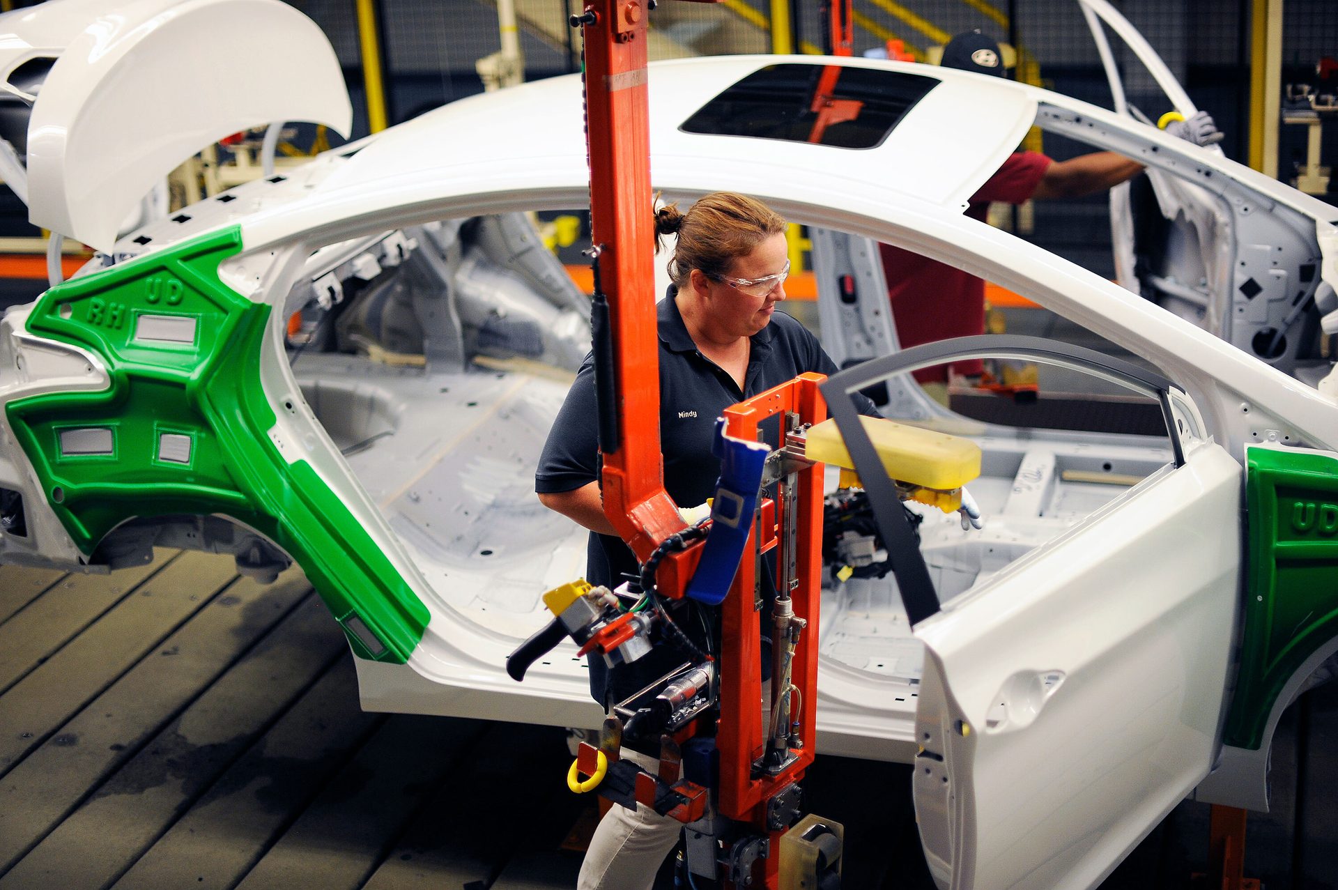

Cost analytics, cost modeling and related methodologies can help automotive engineers drive efficiency and profitability. Photo courtesy Volvo Cars
