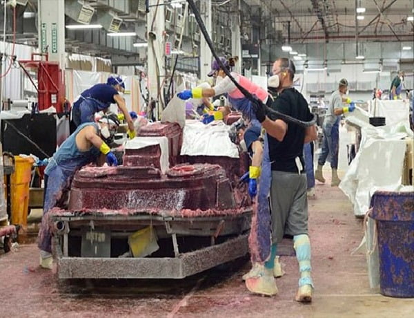

Another Patriot system, the Chop/Wet-Out (CWO), allows manufacturers to apply a resin to products for lamination. MasterCraft has been using the system for the past several years to help assemble a line of large boats.
Vessels of this size require extensive hand lay of fiber reinforcements during composites production and wet-out, which refers to coating individual fiber filaments with resin in a composite sheet. Doing both tasks manually takes nearly 4.5 hours per boat.
To cut process time in half without sacrificing quality, MasterCraft uses the high-volume version of the Patriot CWO. The system’s precision metering ensures consistent porosity and thickness to produce a uniform laminate, while reducing waste caused by overspray and material overuse.
It has a catalyst-to-resin variance of less than 1 percent, and an output capability of seven to 30 pounds per minute.

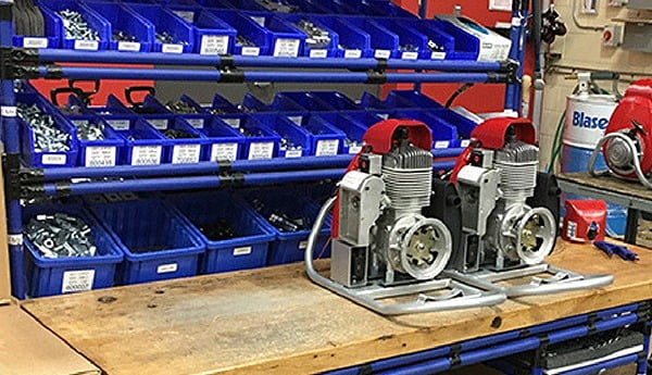

This parts-bin-equipped workstation is part of a material handling system built by Waterax Corp. workers. Photo courtesy Flexpipe Inc.

Several years ago, managers at the Montreal facility were required to implement a new floor layout due to an impending move. They also decided to implement lean manufacturing and a new material handling system to improve assembler ergonomics and increase manufacturing efficiency.
The lean manufacturing program was completed by all plant-floor workers in several training sessions. The material handling system consists of a conveyor, a parts-bin-equipped workstation where performance tests are carried out, and various modular structures—all of which were built in-house using a pipe-and-joint system from Flexpipe Inc.

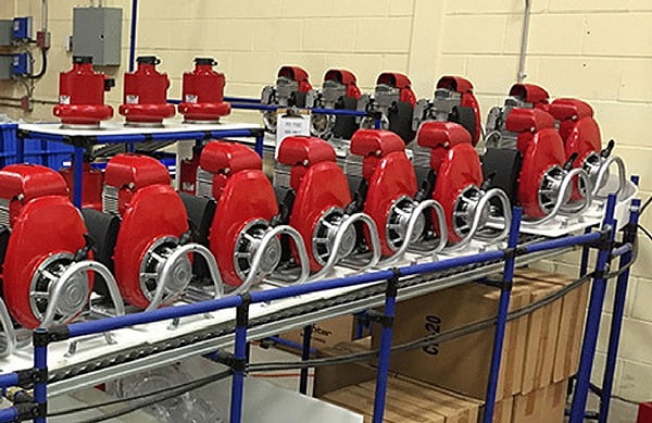

As the primary component for material handling, the conveyor regulates production to reduce the risk of employees getting hurt. It was designed and built by the production engineer. The workstation was assembled by several workers, who paid close attention to workstation height to ensure worker safety.
The main components of the Flexpipe system are 28 millimeter-diameter pipes (with plastic coatings) and metal joints (electroplated black or nickel-plated silver). Various fasteners (M6 and M8 bolts and nuts, and Torx-, countersunk- and square-head screws) are used during assembly. The fasteners are installed with a 5-millimeter Allen wrench or drill bit.
Other structural components include a wide range of conveyor roller tracks, deckings and casters. Many accessories are available, such as leveling shims, pipe extensions, Y-shaped supports, hooks, drawer slides and tow bars.

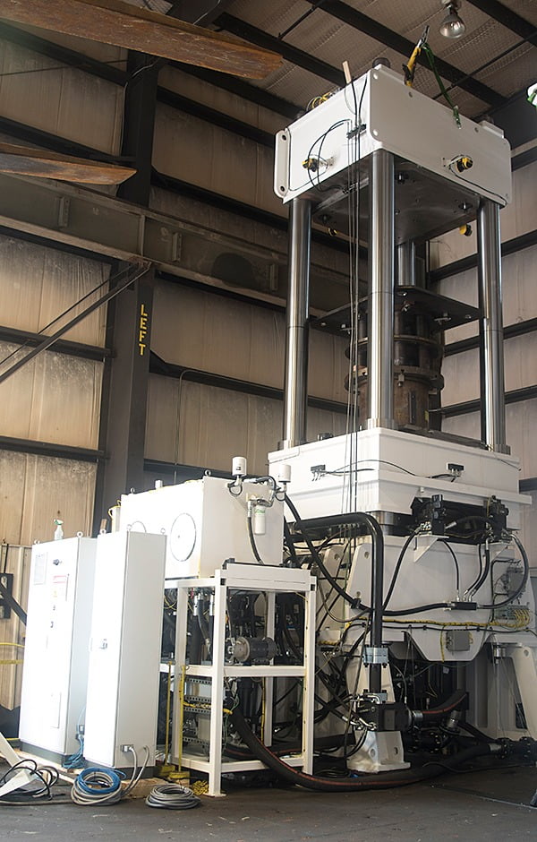

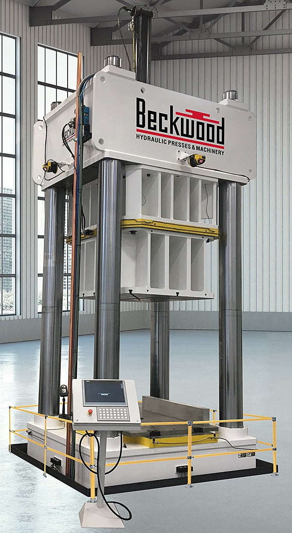

In 2017, a metal-forming company that makes various components for commercial and military aircraft came to Beckwood with a challenge. The company needed a 42-inch-diameter sheet metal hydroforming press with staging table, and two 1,400-ton hydraulic presses with automated quick die-change (QDC) systems to quickly load and unload the presses. Beckwood custom designed and built the machines at its factory prior to shipment and installation at the customer’s facility.
Each press is more than 33 feet high, positioned in a 10-foot-deep pit and has a footprint of approximately 30 square feet. The QDC system has a 15,000-pound load capacity and includes a cart, a rack and a T-table staging device that allows the next die to be prepped and ready to insert upon completion of the previous run cycle.
Beckwood engineers worked closely with those on the customer’s staff to set up and implement automation. The customer was a longtime user of Siemens motion control and HMI products, and specified them for the project, including drives, PLCs, displays and motion controllers.
This 1,400-ton hydraulic press comes with an automated quick die-change system to quickly load and unload the press. Photo courtesy Beckwood Corp.
Yellow, Fixture
It also set up the system logic and data logging. The Beckwood team integrated the QDCs and overall workcell. Both Beckwood and Siemens personnel were active in commissioning the entire system.
During operation, the QDC works in tandem with the two presses and uses four 15-hp motors to drive the leadscrews on the large die-handling system. The screws are electrically geared through the onboard Siemens S7-1515 PLC to move the ram and shuttle.
Additional motors and drives on the feed tables allow the next die to be positioned during press operation. When a press cycle is completed, the air bags on the feed tables lift this die for positioning onto the QDC, then a shuttle inserts the die inside the press.
The robust PLC controller integrates function control, safety and condition display in a single module with Profinet protocol for bus communication. Through Siemens’ TIA Portal and Step 7 software, the end user can remotely customize the operation of the devices, as well as integrate multiple part files and related safety commands.
This “library” feature enables the end user to efficiently run various parts during a shift with only one software package. Safety switches can be programmed through the TIA Portal and allow operators to remain outside the work envelope when the presses are in full-machine process and monitoring mode.
All motor movements on the presses are controlled with Siemens drive technology. According to Dixon, the presses with QDC systems have reduced die setup and changeover from approximately two hours to 10 minutes.
