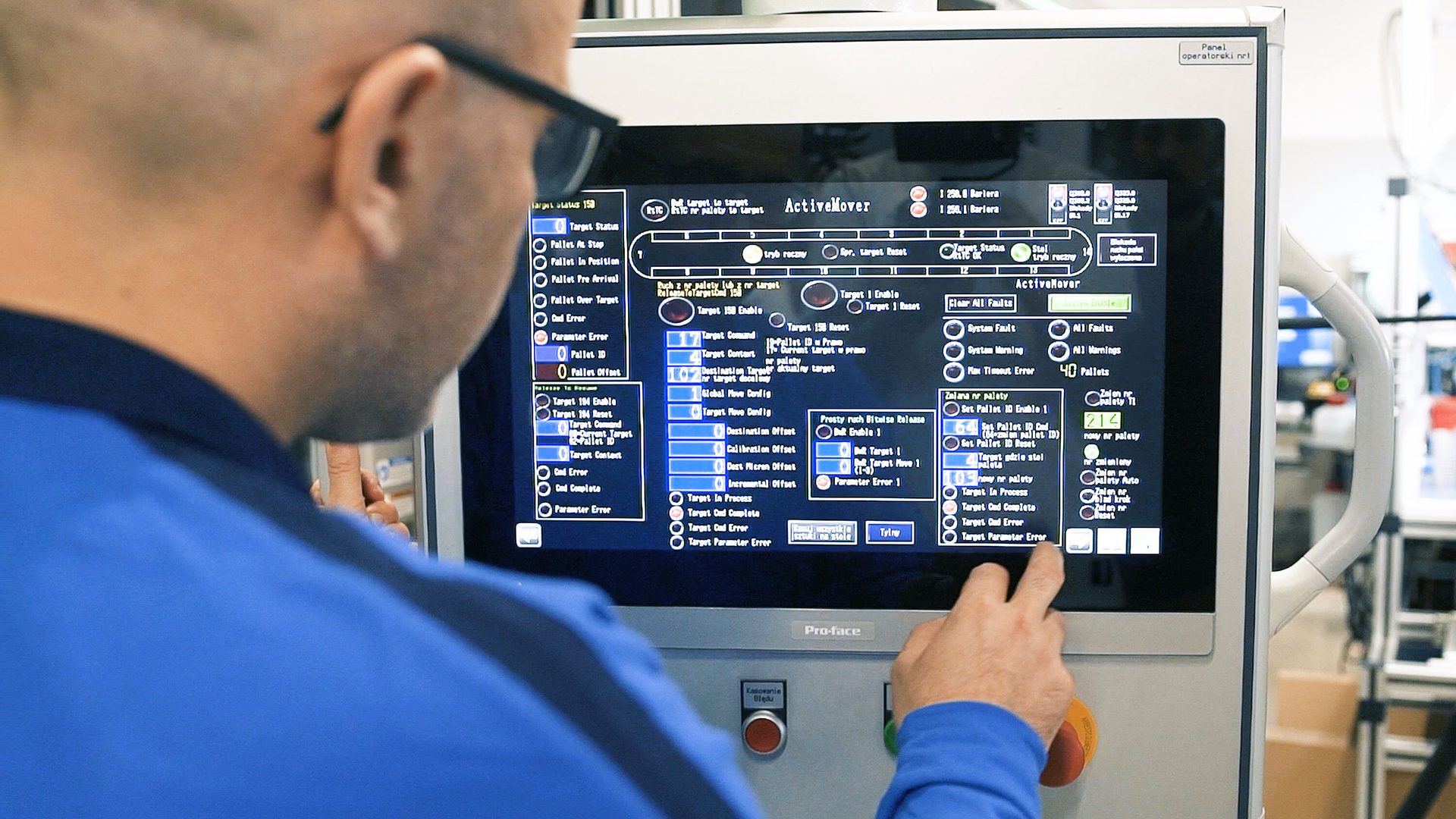

Personal computer, Output device
The new line connects seamlessly with WIKA’s MES system. Photo courtesy Bosch Rexroth Corp.

Another benefit is that the line is compatible with any MES system, says Piotr Krotki, director of automation at WIKA. As a result, information about the production batch to be assembled is loaded via a QR code or bar code.
“The machine is up to 70 to 80 percent self-configuring,” explains Krotki, who is responsible for line design, programming of controllers, and launching production installations.
Depending on the variant to be assembled, freely programmable pallets are placed in different positions at individual stations. This significantly increases overall equipment effectiveness (OEE) and reduces the amount of time-consuming manual work required during setup. At the same time, the line fully documents each automated assembly step, thus meeting increasingly frequent customer traceability requirements.
“Thanks to open interfaces, the motion control technology for the Active Mover system integrates with our installation controller via the Profinet interface,” says Krotki.
