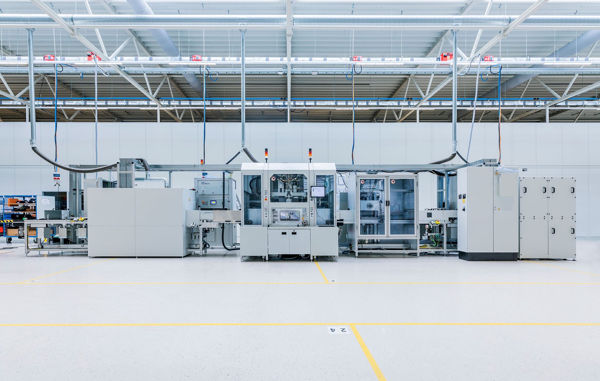

Leak Testing System for Battery Cells
Designed for installation in 19-inch racks, the ELT Vmax tests the tightness of battery cells filled with liquid electrolyte—whether lithium-ion or sodium-ion cells, prismatic, round and button cells with a rigid housing, or pouch cells with a soft, bag-like housing.
The device detects electrolyte leaking from filled cells in a vacuum chamber. The system is designed for flexibility and easy integration into test systems. It was designed specifically for use in mass production lines. For example, the system does not have an integrated vacuum pump, since the use of particularly powerful external pumps is recommended for testing batteries during mass production. However, the system is just as accurate and sensitive. It can identify leak rates as low as 5 x 10-7 millibar-liter per second.
Thanks to its 19-inch housing and its serial and fieldbus interfaces, the instrument is easy to install in any test system. If required, it is also available with a separate control panel, including display. The system is also approved for use in dry rooms.
Because it quickly detects gross leaks, the device ensures that electrolyte does not contaminate the test system, so it is immediately ready for the next measurement. A carrier gas mode also ensures a high degree of flexibility: The carrier gas flow can be variably adjusted, whereby leaked gaseous electrolyte is transported to the sensor by an air flow at the desired speed. For example, a carrier gas flow of 10 standard cubic centimeters per minute can reduce the response time to just a fraction. This allows a carrier gas flow to be defined for each test requirement that represents an optimum compromise between response time and sensitivity.
For mass production, it is advisable to regularly check that the test system is working properly. For this purpose, Inficon offers fully automatic calibration with a calibration leak called E-Check 2.0. This calibration leak, which is 100 percent filled with DMC electrolyte solvent, is integrated into the vacuum chamber and always ready for operation. This also enables automatic test measurements at preset intervals.
The system also works in test stations with several vacuum chambers, so there are no waiting times for the device during evacuation and ventilation. The system is constantly in measuring mode.
