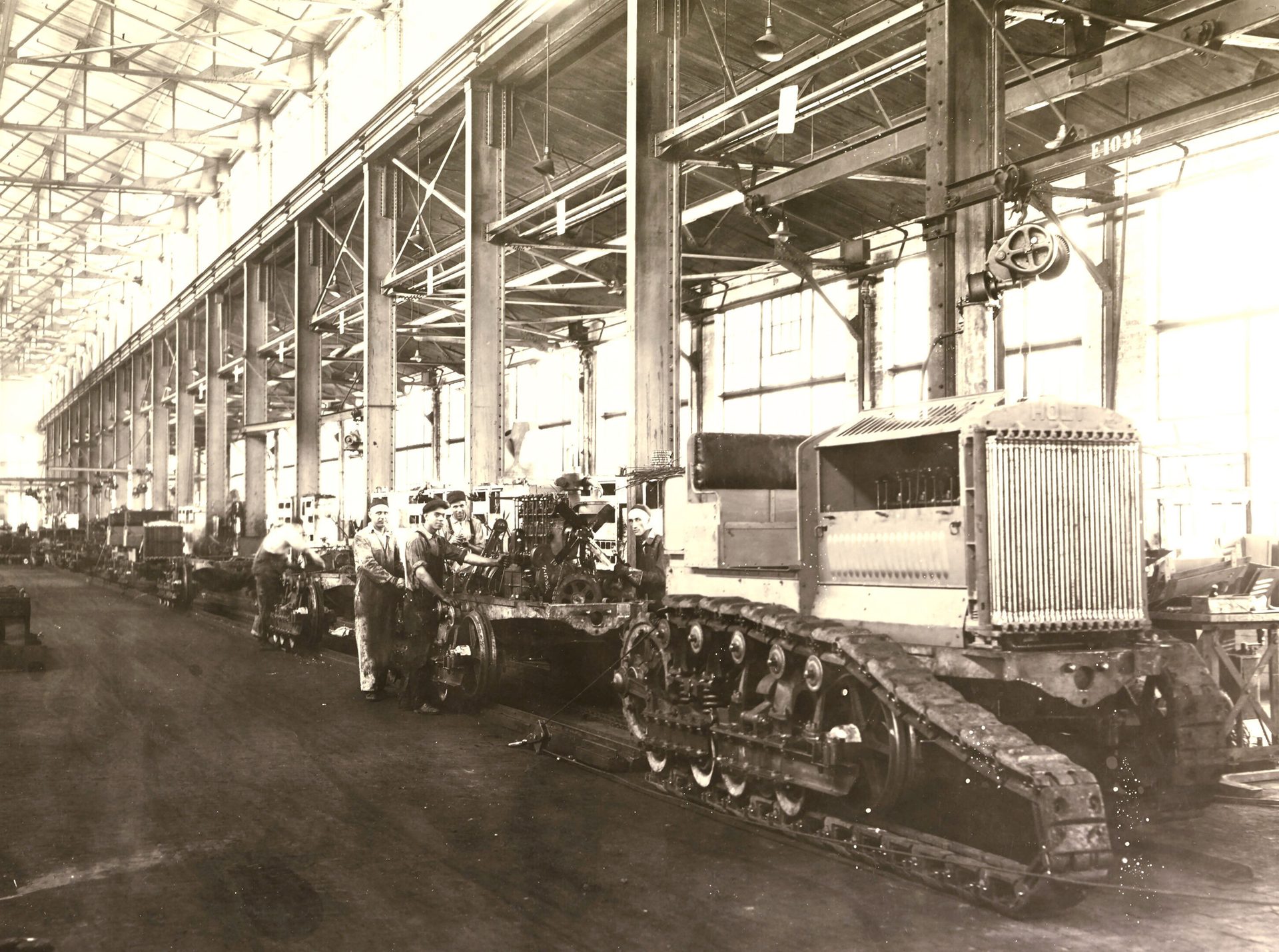

This view from 1923 shows the Holt assembly line in East Peoria, IL. Photo courtesy Caterpillar Inc.

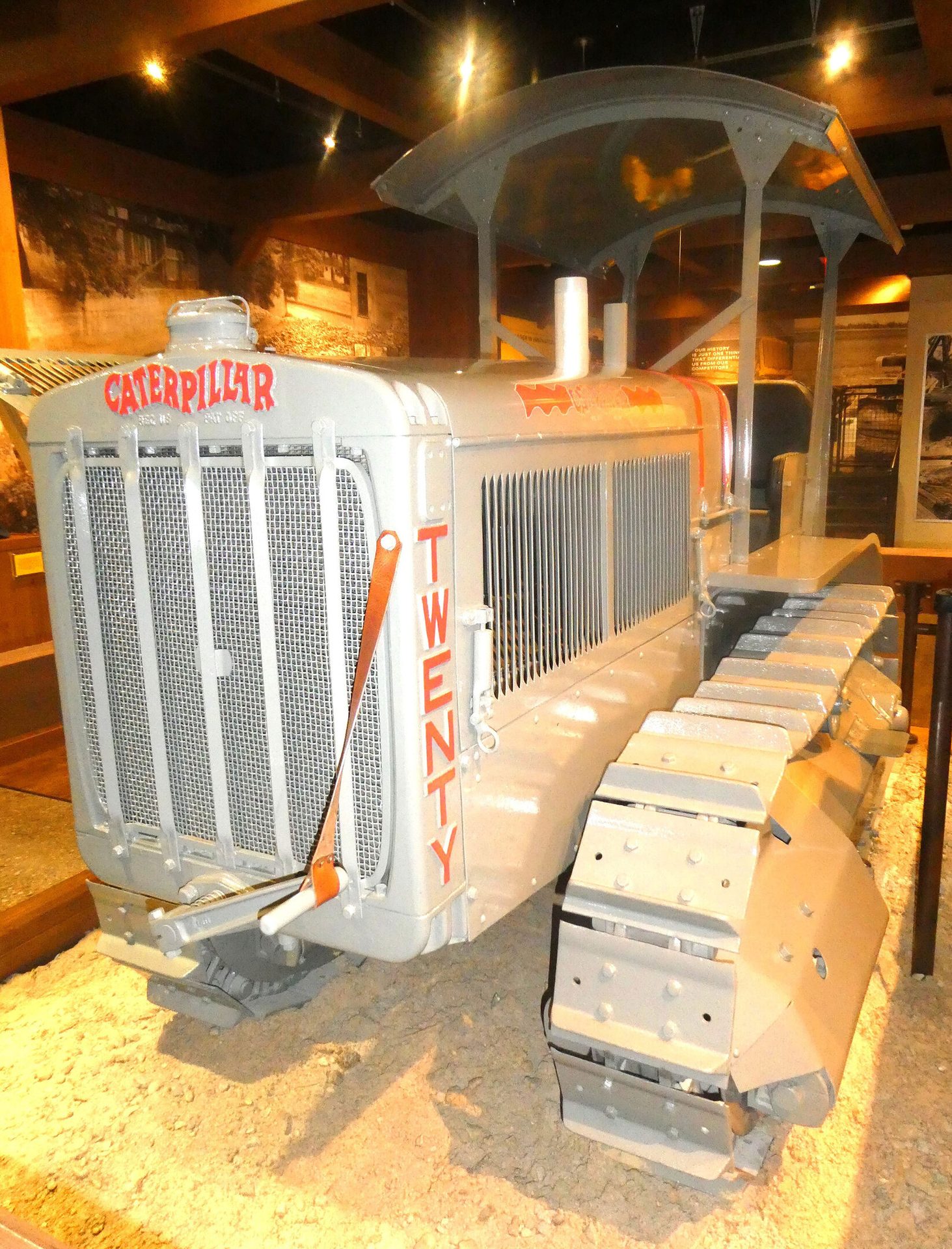

The Model 20, which debuted in 1928, was the first machine produced by the Caterpillar Tractor Co. At the time, all machines were painted gray, with a wavy red logo. Photo by Austin Weber

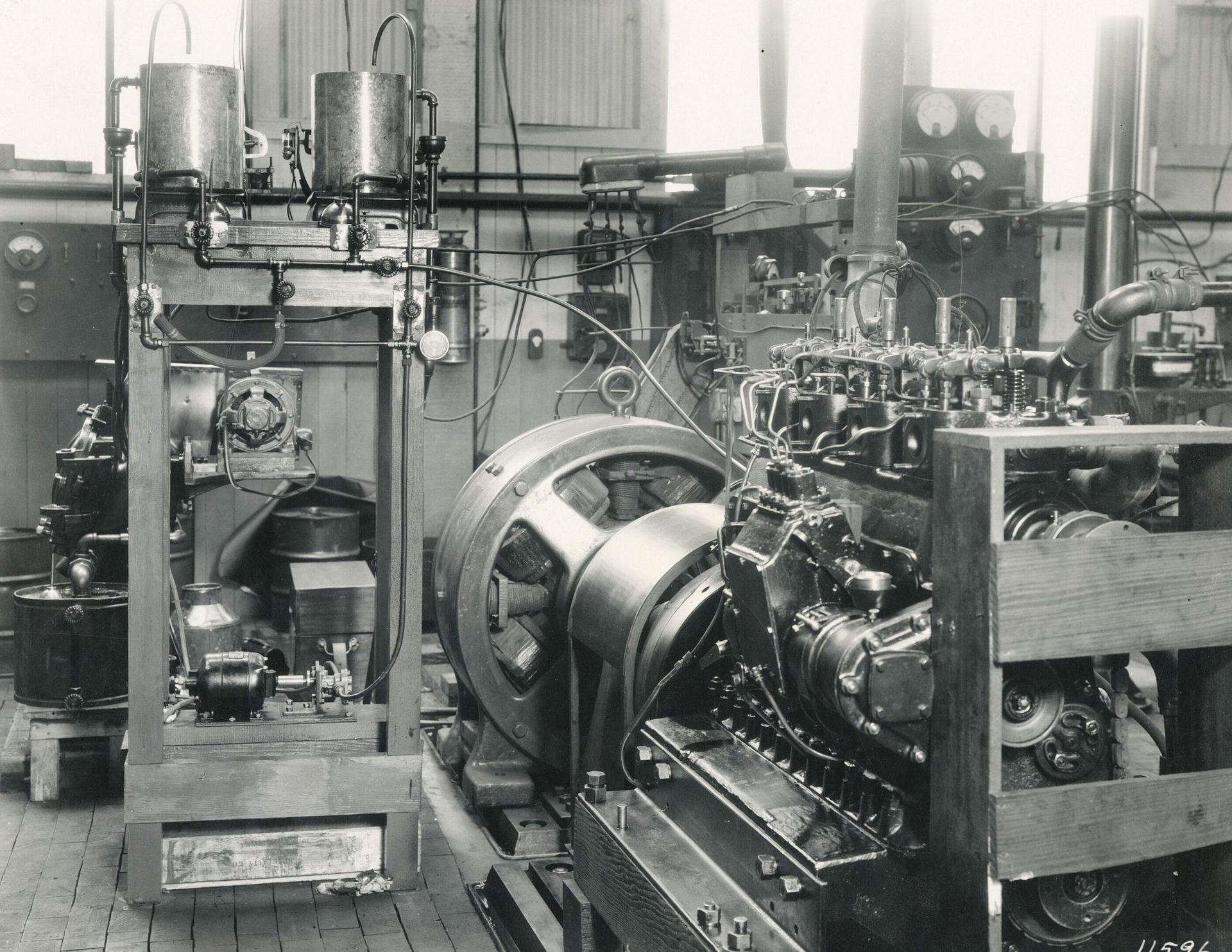

“Not only did Rosen and his staff work on designing the engine, but they also had to design the testing equipment,” says Ed Claessen, co-author of Making Tracks: C.L. Best and the Caterpillar Tractor Co. “The search for a suitable fuel-injection and combustion system led to the development of a single-cylinder engine…
“The San Leandro engineering research department designed equipment capable of measuring the pressure and temperature within the cylinder, the amount of fuel consumed during the test, the amount of air being inducted and the temperature of the exhaust gases.”
Rosen and his colleagues focused their efforts on a four-cycle, solid-injection engine employing precombustion chambers with individual fuel-injection pumps. The device was started by a small gasoline engine.
The pace of research and development increased, even after the stock market crash and the start of the Great Depression in 1929. “During the period of diminishing profits, the development of the Caterpillar diesel engine never slowed,” notes Claessen. “Clarence Best believed that diesel was the motive power of the future, and he never backed down and never thought about quitting.”
Finally, on June 28, 1930, the first Caterpillar designed and built diesel engine was assembled. The Model D9900 engine, dubbed “Old Betsy,” underwent more than 16 months of intense testing before it was deemed ready for production in late 1931. Today, that historic engine is preserved and housed at the Smithsonian’s National Museum of American History in Washington.

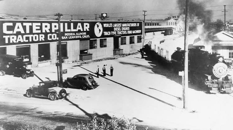

In this mid-1930s scene, a freight train is about to depart the Caterpillar factory in San Leandro, CA. Photo courtesy San Leandro Public Library Historical Photograph Collection/San Leandro Historical Society

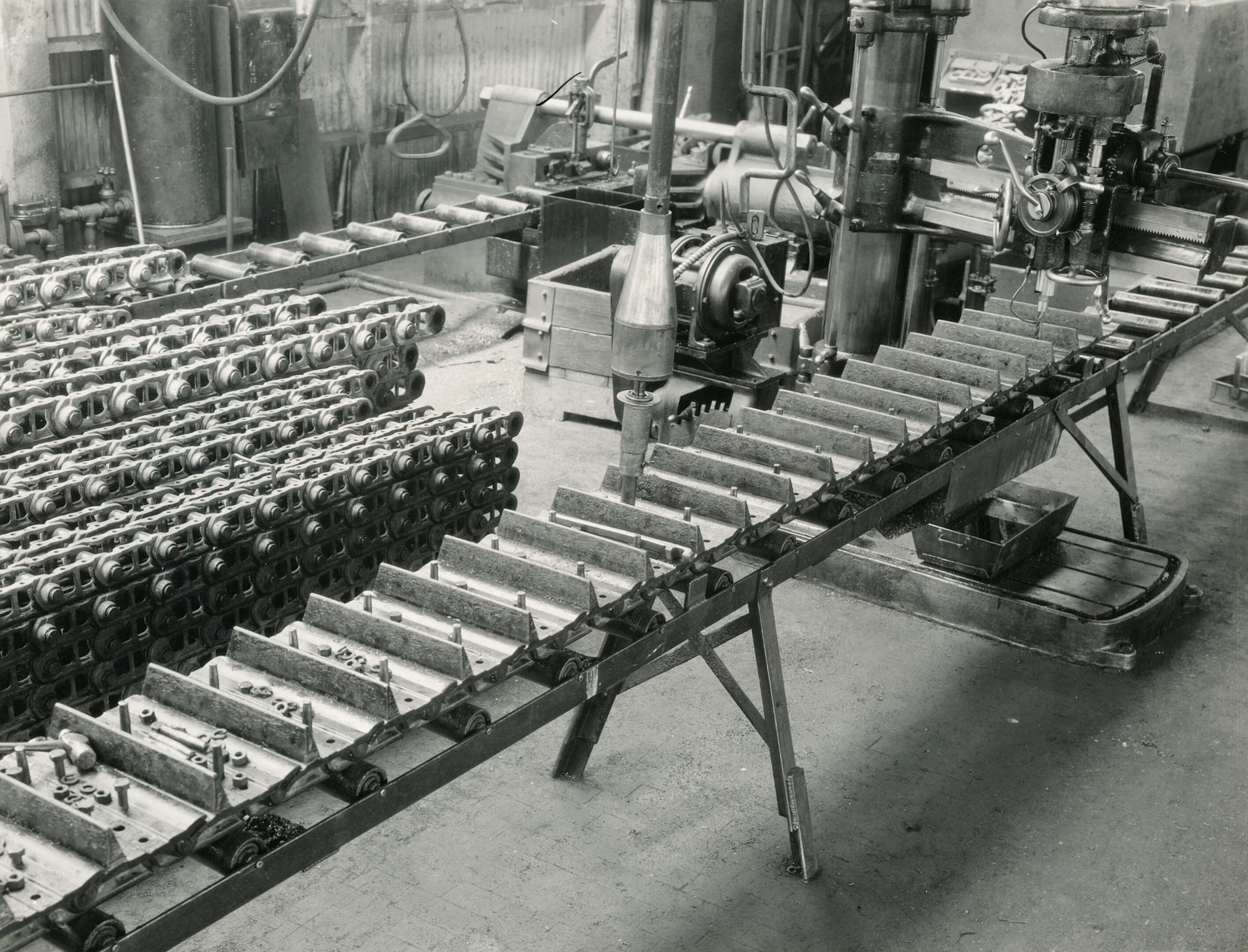

In addition to diesel engine production, one of the most fundamental changes in the history of Caterpillar occurred in March 1929. That’s when the company received a U.S. patent for a “method of providing track shoes.”
“The famous ratchet links that guide the tracks are cast pieces, with a pin run through each to attach the item, which runs along a sprocket system,” says Kurth. “They enable the undercarriage to handle more power and weight.”
In his patent filing, Best stated: “In experimenting with and developing tractors over a long period, I have found that one of the most important features affecting the commercial success of a track-type tractor is the track shoes.”
“His invention called for the track shoes to be made from a metal bar that had been rolled to the width and form of the shoes, but in a long length that allowed multiple shoes to be sheared from it,” explains Claessen. “The holes required for fastening would then be punched into the individual shoes.
“Best claimed that these shoes ‘are of excellent quality primarily due to the rolling process, and are quickly and economically produced,’” adds Claessen. “This rolling process became the industry standard and is still in use today.”
“Track making at the Caterpillar Tractor Co. plant in San Leandro is on the basis of straight line production,” proclaimed an article in the April 14, 1927, issue of Iron Age entitled ‘Method of Assembling Caterpillar Tracks,’ which described how “one small unfinished drop-forged link of 12 inches [grew into a] completed track 22 feet long.
“The link, after seven operations on six single-purpose machines, where rights and lefts are handled together, enters a rotary automatically controlled electric furnace, on leaving which it is given a differential quench….After a draw, the links are assembled, with the track spools and pins, in a special 80-ton press, after which the shoes are attached to the completed track [and] conveyed by trolley to the point of application on the main assembly floor.
“Worthy of note, for assembling the track shoe, is a motor-driven socket wrench which, through the medium of a pneumatic friction clutch, will slip at a predetermined torsional stress and is released entirely, for passing from bolt to bolt, by foot action of the operator. This mechanism assures a uniform setting up of the shoe and also constitutes a physical test of each bolt and nut as it is installed. [An air hose supplies compressed air to the pneumatic friction clutch].”

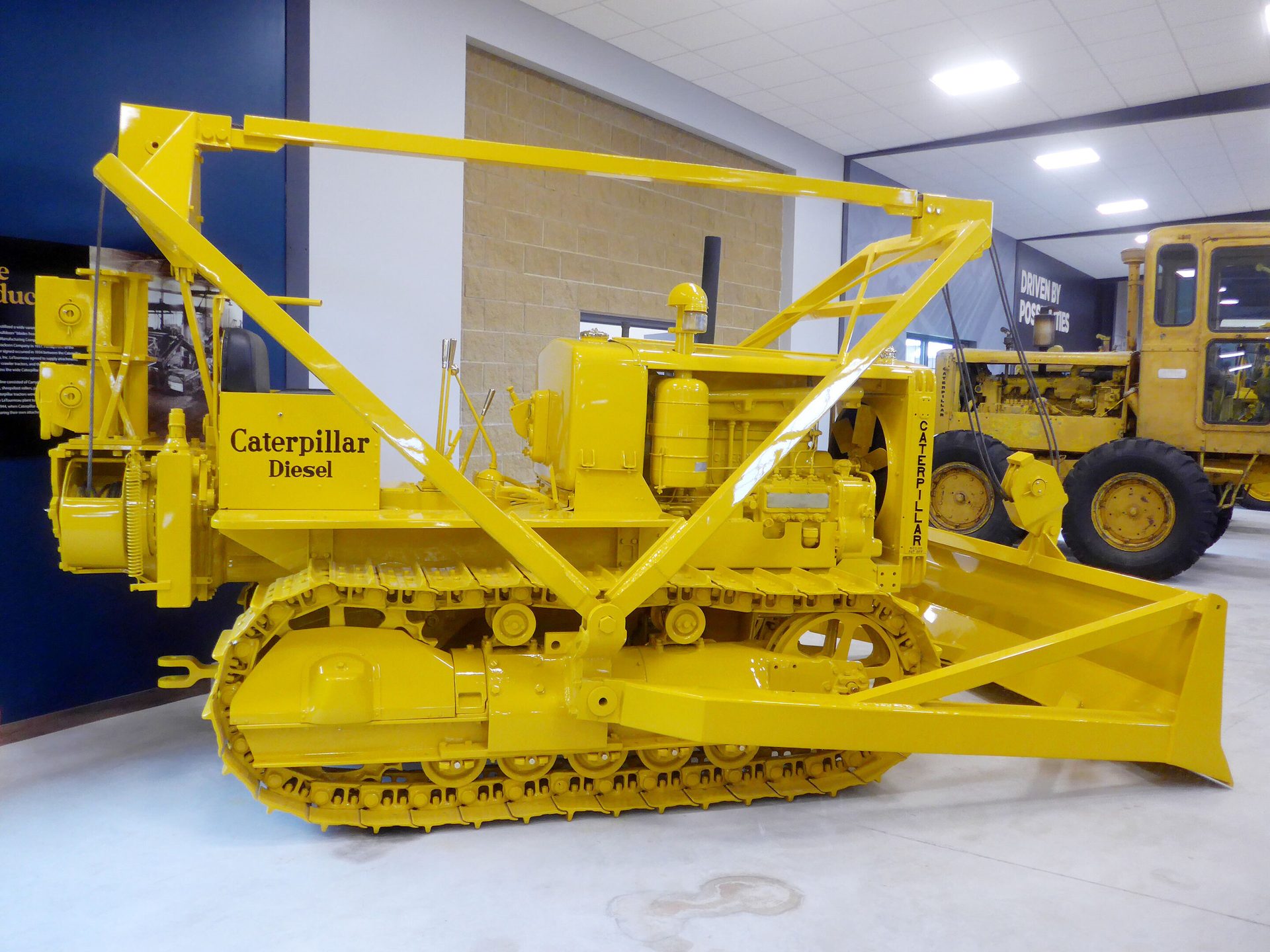

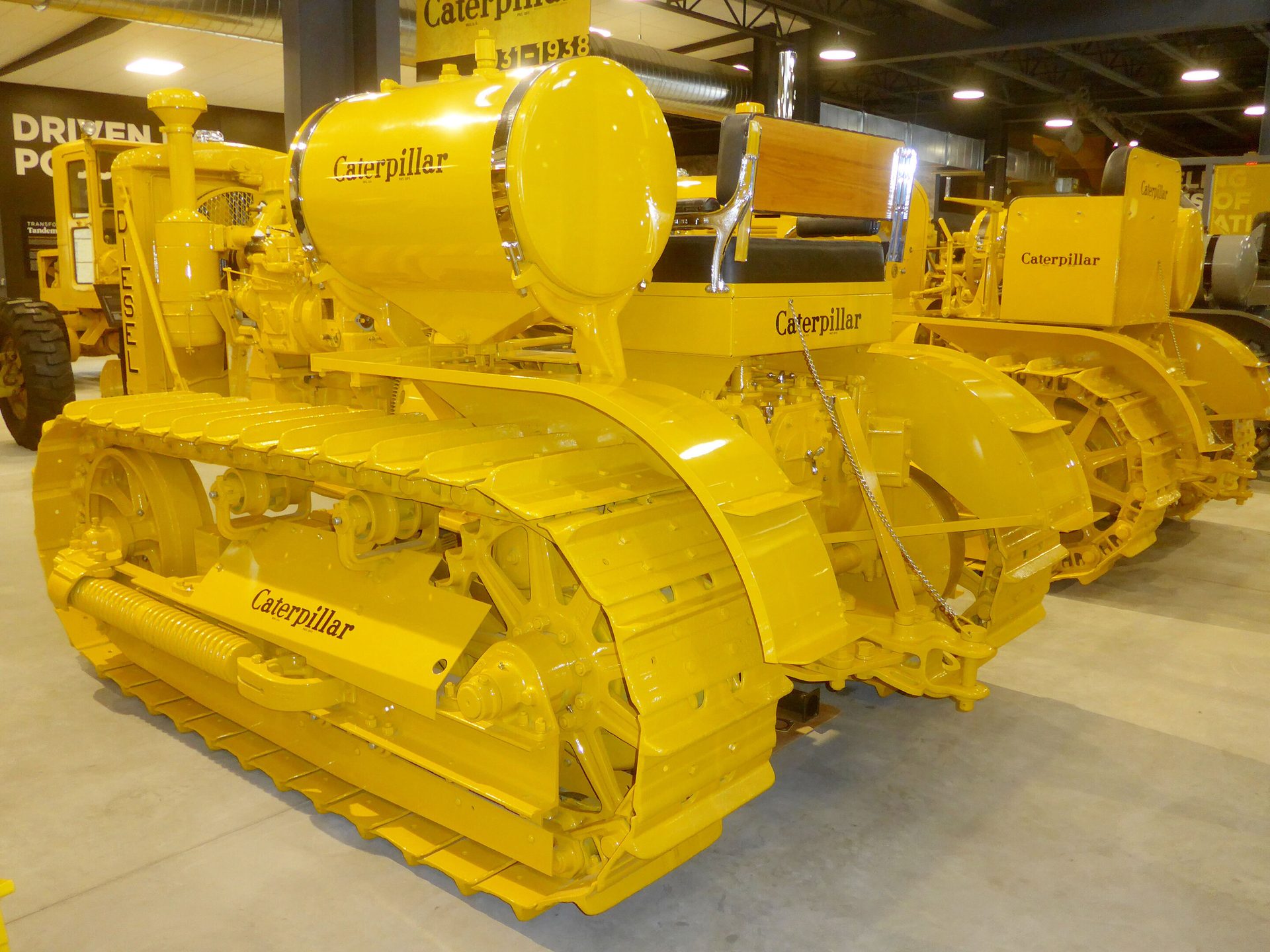

Caterpillar’s first tractor equipped with a diesel engine and a yellow paint scheme debuted in 1931. Photo by Austin Weber
Caterpillar engineers’ expertise at bending, shaping and joining “yellow steel” enabled the young company to eventually move beyond crawler tractors and develop other types of earth moving and road building machinery.

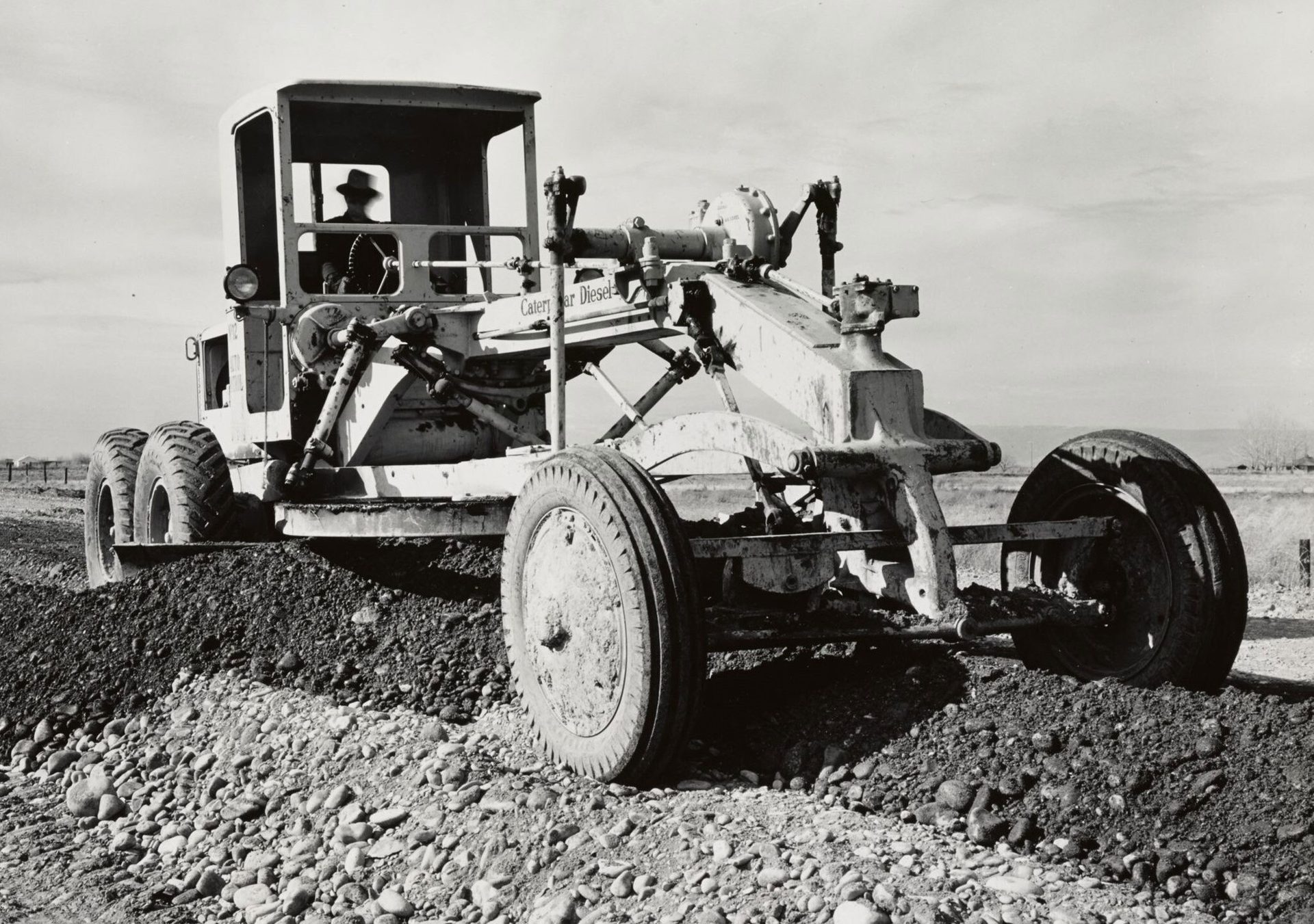

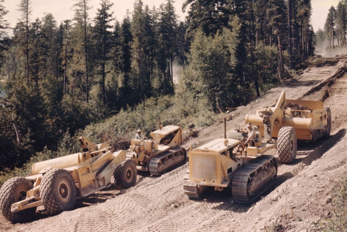

One good example was the Diesel No. 12 Auto Patrol scraper, which was introduced in 1938 (Caterpillar had started dabbling in motor graders when it acquired the Russell Grader Co. a decade earlier). It featured a triple-box-section main frame that was much stronger and more rigid than twin-beam designs used in earlier models of motor graders. The 20,360-pound machine contained a 12-foot blade that was used to build roads and remove snow.
Caterpillar also developed its first rubber-tired tractor in the late 1930s. The DW10 was designed to pull scrapers at higher speeds than crawlers could. However, its introduction in 1941 was overshadowed by war clouds in Europe.

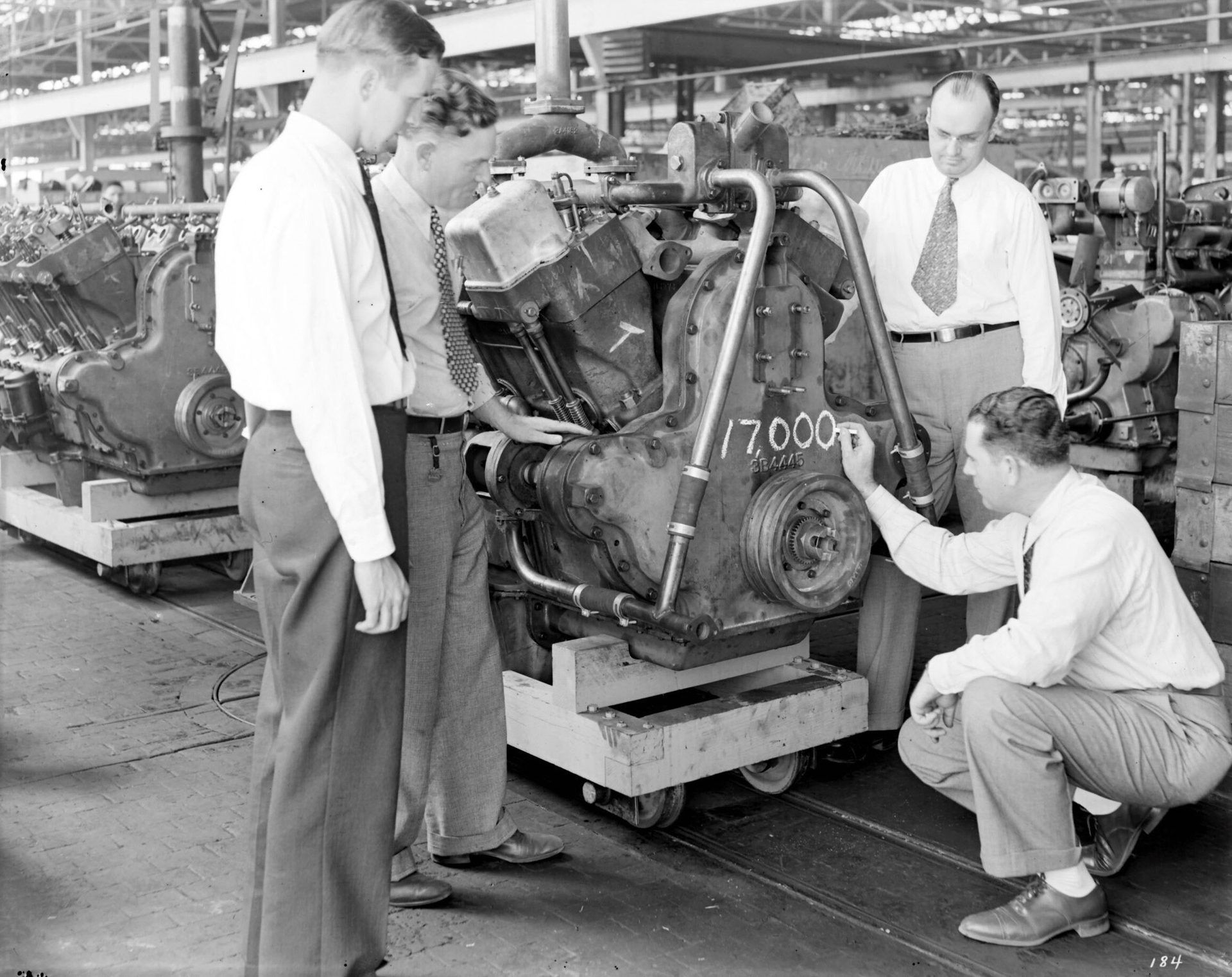

Caterpillar executives examine the company’s 17,000th diesel engine, which rolled off the East Peoria, IL, assembly line in 1936. Photo courtesy Caterpillar Inc.

When a new 925,000-square-foot engine factory opened in East Peoria in 1949, it was the envy of the manufacturing world.
“The plant is modern in construction with a high ceiling and is provided with a forced feed system of fresh filtered air to promote clean, comfortable working conditions,” noted an article in the Feb. 1, 1949, issue of Automotive Industries. “Another interesting feature of the building is a well-designed system of overhead fluorescent light sources which gives an illumination of 30 foot-candles at the working level.
“Fortunately, from the standpoint of plant management, the operation was visualized from scratch for a specific floor plan in keeping with the philosophy established for producing the given number of large diesel engines.
“Having established the desired floor plan, it was then possible to design the building around it. This method of approach is ideal from the standpoint of the manufacturing department, since it avoids the compromises in layout usually necessary if the floor plan must be made to fit the building.
“The plant has been divided into a series of self-contained units running in parallel rows, each one equipped for the complete processing of major parts of the engine, such as crankshafts, cylinder blocks, cylinder heads, connecting rods, pistons and liners. Raw materials are fed in at one end and all operations for each of the lines start at this end. With this arrangement, finished parts of the engine wind up at one major bay in the heart of the building within easy reach of the engine assembly lines.
“When it comes to engine assembly, Caterpillar has created an innovation of more than passing interest. The entire floor area occupied by the three major final assembly lines, engine block testing and industrial engine erection, is completely isolated from the manufacturing area by a solid wall. Except for proximity, the assembly area is a separate plant to all intents and purposes, insulated from the activity and effects of metal cutting.
“Because Caterpillar moves large tonnages of heavy parts rather than a heavy volume of small parts, reliance is placed primarily upon a special arrangement of heavy-duty gravity roller conveyors for each unit. Heavy lifting is done by overhead cranes and hoists.
“Interdepartmental movement of raw materials and finished parts is handled by means of an industrial railroad system within the plant, with long trains of small flat cars hauled by rubber-tired tractors. In other cases, such as the crankshaft drilling lines, the long process machine is fitted with its own table built-in conveyor for moving work from one station to another.
“The plant has 18,000 feet of gravity roller conveyor lines, one metal belt running 80 feet, one fabric belt 80 feet long…and a 750-foot overhead line. In the assembly department, they have three power-driven assembly lines totaling 600 feet, 4,000 feet of gravity roller conveyors and an extensive installation of overhead monorails for electric hoist movement.

This diesel-powered motor grader debuted in 1938. Photo courtesy Caterpillar Inc.

“The unique carousel makes a nonstop trip around the engine test area. Each plate on the 385-foot floor conveyor is crescent-shaped to turn corners. Each plate carries one engine.
“Once on the carousel, an engine moves around the test cell block until one of the cells is open. After testing, the engine is lifted again onto the carousel, and moved on until it reaches the next destination—the adjustment floor or the paint line.
“The overhead monorail system permits an assembler to move engines easily onto the carousel…or from the carousel into a test cell.
“On still another part of the conveyor system is an overhead carousel monorail. This carries engines from the end of the first section to the second section of the assembly line. This line is 450-feet long—half again as long as the normal engine line.
“When engine assembly begins, the engine block is set in a vertical position. This permits quicker and easier installation of the crankshaft, pistons and rods…and reduces the possibility of crankshaft damage.
“In the test area, each of 14 test cells is soundproof and receives a constant supply of fresh air. Controls are located in a dual console outside the cells. One assembler is in charge of two test cells.
“The console reduces the need for the test assembler to work inside the test cell after he has connected the engine to a dynamometer….[This] has made the job of testing engines cleaner, safer and considerably easier on the ears….”
