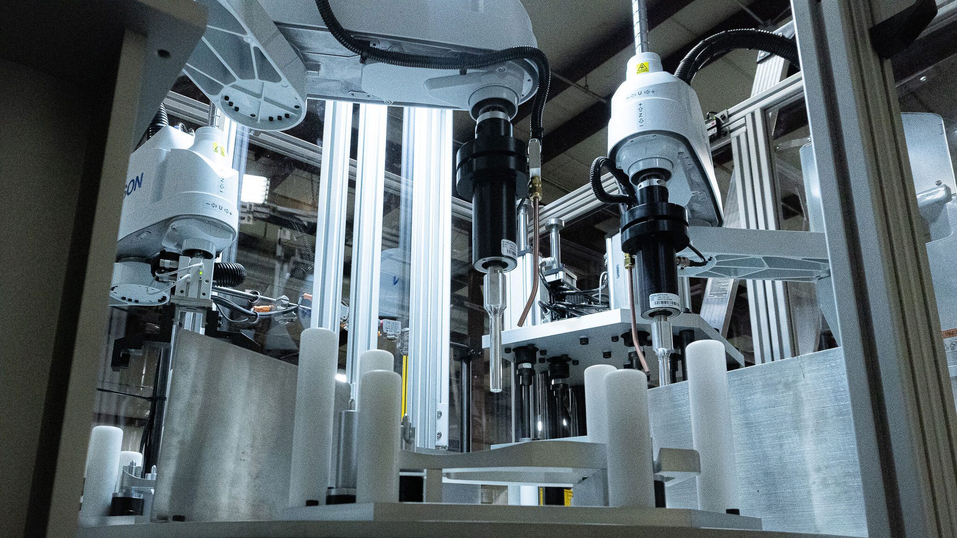

Two SCARA robots weld insulating material to a plastic part. A third SCARA unloads the finished assemblies. Photo courtesy Epson

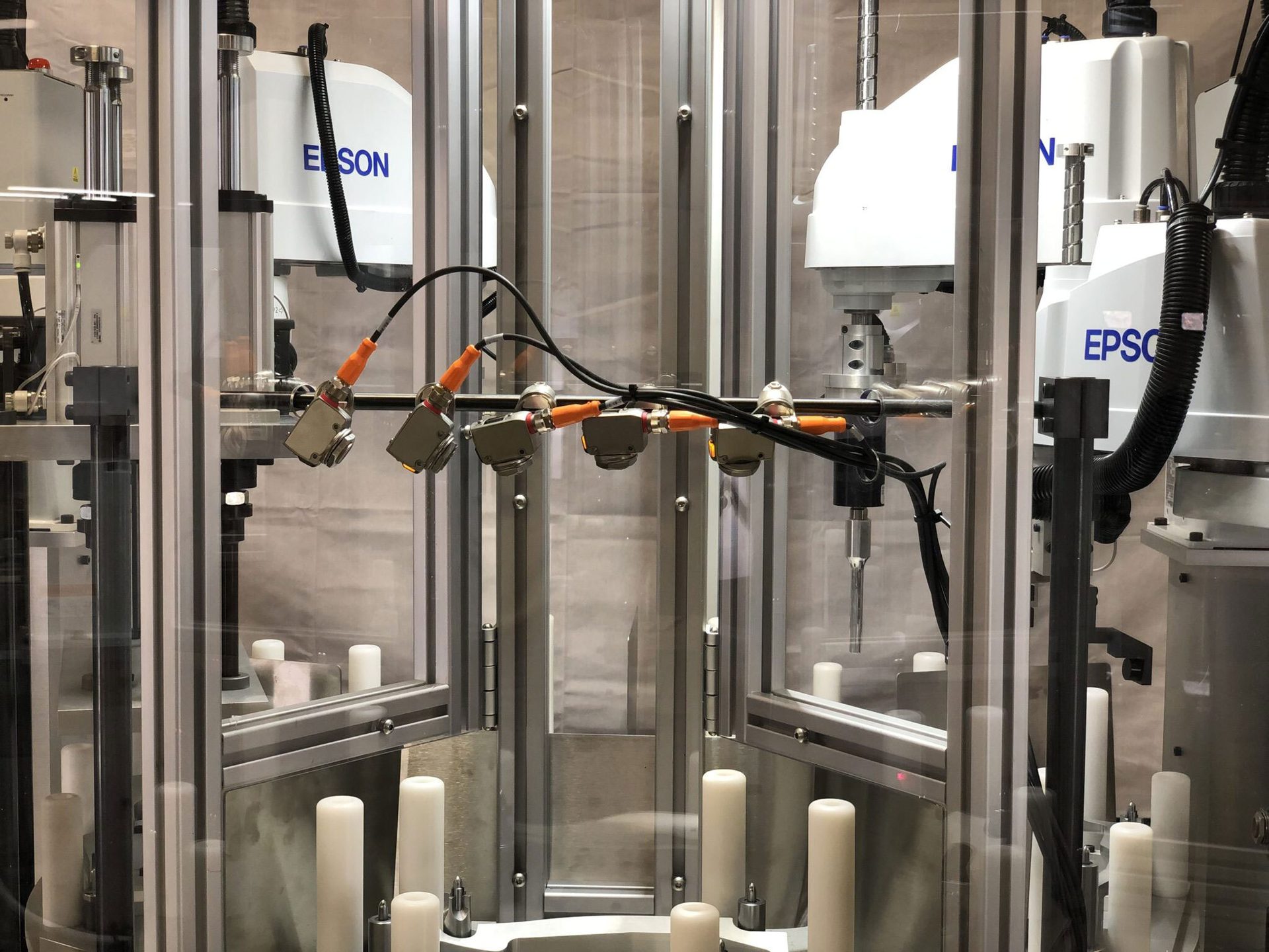

Sensors check the quality of each assembly. Photo courtesy Epson
Although AMS engineers were familiar with ultrasonic welding, integrating the technology with SCARA robots was new to them. Instead of positioning the part manually or using a custom fixture to position it beneath an ultrasonic welder, engineers chose the robots to automate the process for greater speed, lower costs and better results.
Their robot of choice was the T-Series all-in-one SCARA from Epson. This space-saving robot can be deployed quickly since the controller is built into the base of the robot arm. The robot uses the same intuitive software and powerful features found in Epson’s high-end robots.
The T-Series robots are fast, easy to integrate, and take less time to install than gantry systems. With reach distances of 400 and 600 millimeters, the T-Series can handle payloads of 3 or 6 kilograms. Engineers placed a T6 SCARA robot at each of the two stations to perform ultrasonic welding, and they deployed a T3 SCARA at the final station to unload the finished assemblies.
Initially, AMS engineers planned to use a gantry system to unload the assemblies. However, since they were already using two Epson SCARAs to do the welding, employing a third SCARA to unload the machine made more sense. It saved setup and design time, reduced the overall cost of the machine, and increased reliability.
