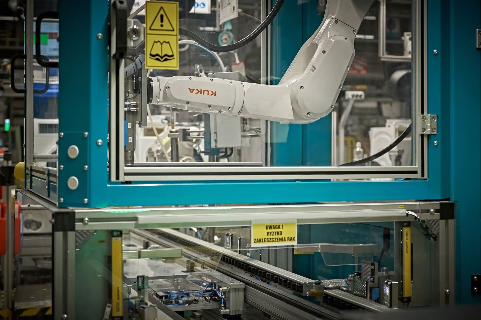

The appliance manufacturer placed a high priority on cycle time. This was quite a challenge during the design phase of the screwdriving project. Qbig engineers considered several options.
One option would be to fixture multiple autofeed screwdriving spindles together and mount them to a linear slide. The door would stop below the screwdriving station; the slide would come down, and all the fasteners would be installed simultaneously. This option was ultimately rejected for its relative lack of flexibility.
Technology, Machine, Metal
For a conveyor-tracking application, a six-axis robot was the best option. Photo courtesy Kuka
Another option would be to mount a single autofeed screwdriver to a robot. The door would stop at the screwdriving station, and the robot would install each screw one at a time. This option was more flexible, but stopping the door meant the station couldn’t meet the cycle time requirement.
It was then that Qbig engineers came up with a unique way to shave a few seconds off the cycle time: screwdriving “on the fly.” The door would still stop at the station, at least initially. However, as the last fastener is being driven, the door begins moving out of the station, freeing up space and allowing the next door to enter, stop and position itself, so the robot can begin installing screws immediately, without having to wait.

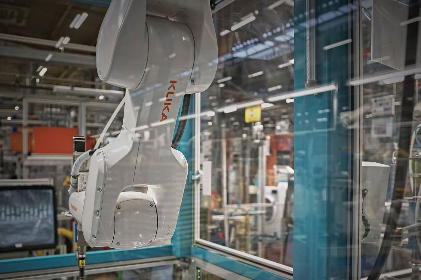

For this design, a six-axis robot was the best option. Qbig engineers chose the KR Agilus robot from Kuka to do the job. The KR Agilus is a compact six-axis robot for particularly high working speeds. Maximum payload ranges from 6 to 11 kilograms, and maximum reach ranges from 706 to 1,101 millimeters. Positional repeatability ranges from ±0.02 to ±0.03 millimeter.
The robot can be mounted to the floor, ceiling or wall. It is ideal for confined spaces thanks to its integrated energy supply and control technology. Safe robot functionality enables innovative automation concepts. The robot is protected against electrostatic discharge, and variants are available for clean rooms; hygienic or wet environments; and potentially explosive environments.
Thanks to its lifetime lubrication, the robot never needs a change of lubricant in the gear units and has minimal maintenance requirements.
