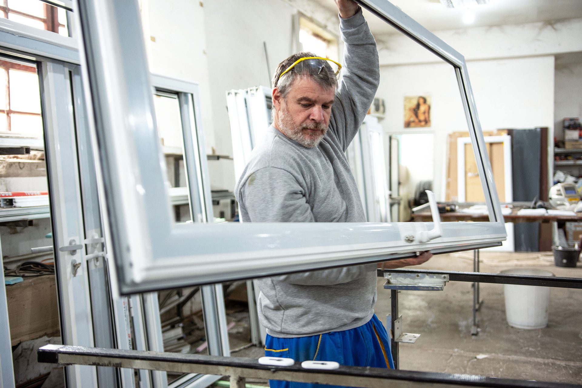

Pushing, pulling, lifting and bending motions are consistently performed as a part of daily job functions. Photo by Gorica Poturak, courtesy Getty Images

At the window manufacturer, chronic pain presented an ongoing problem for the workforce. DORN specialists observed hazards and risk factors in worker technique across all departments. Pushing, pulling, lifting and bending motions were consistently performed as a part of daily job functions, but little training had been offered to educate workers on how to execute those motions without putting themselves at risk of injury.

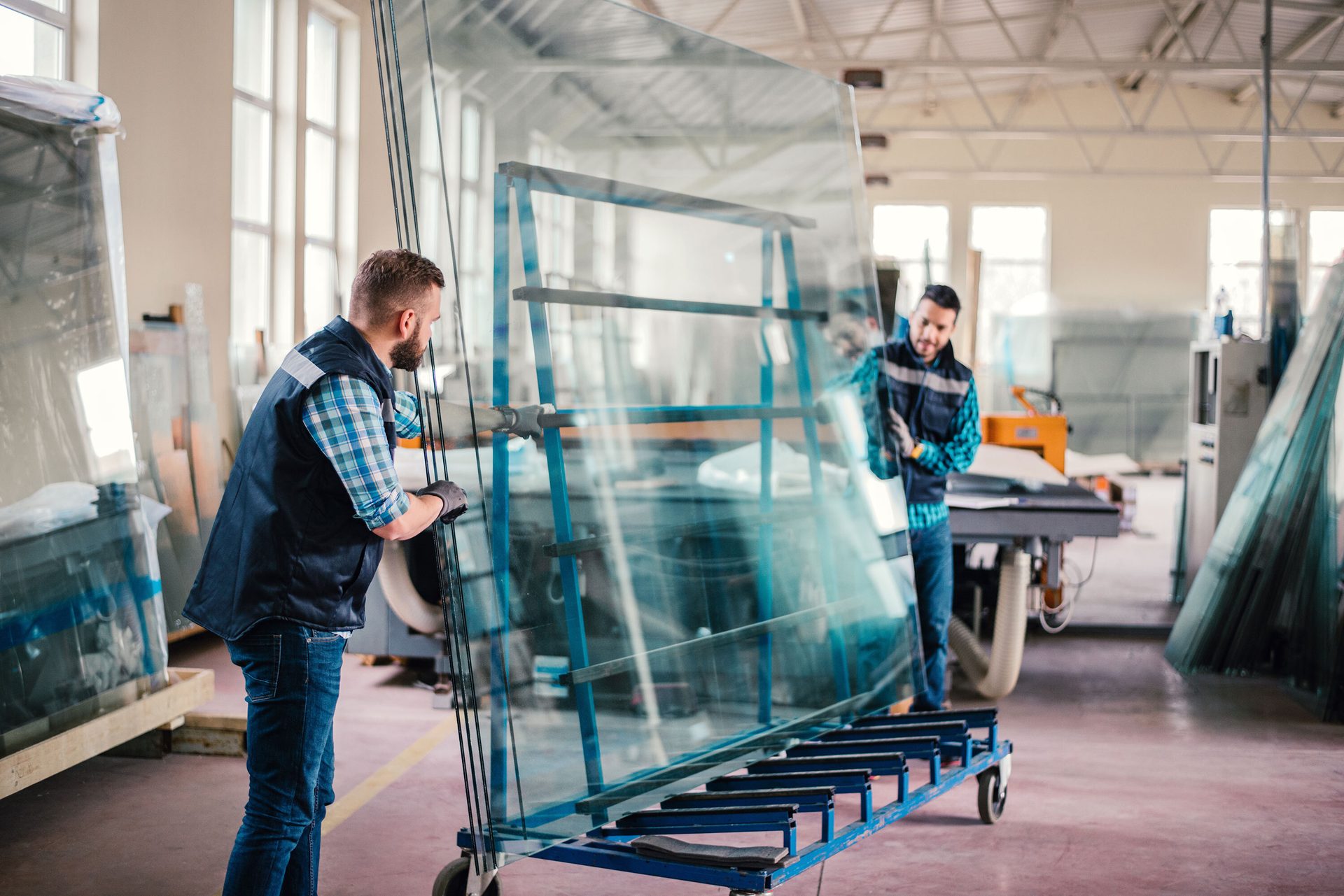

Safely handling large, awkward and heavy sheets of glass is an ergonomic challenge. Photo by Blue Cinema, courtesy Getty Images
