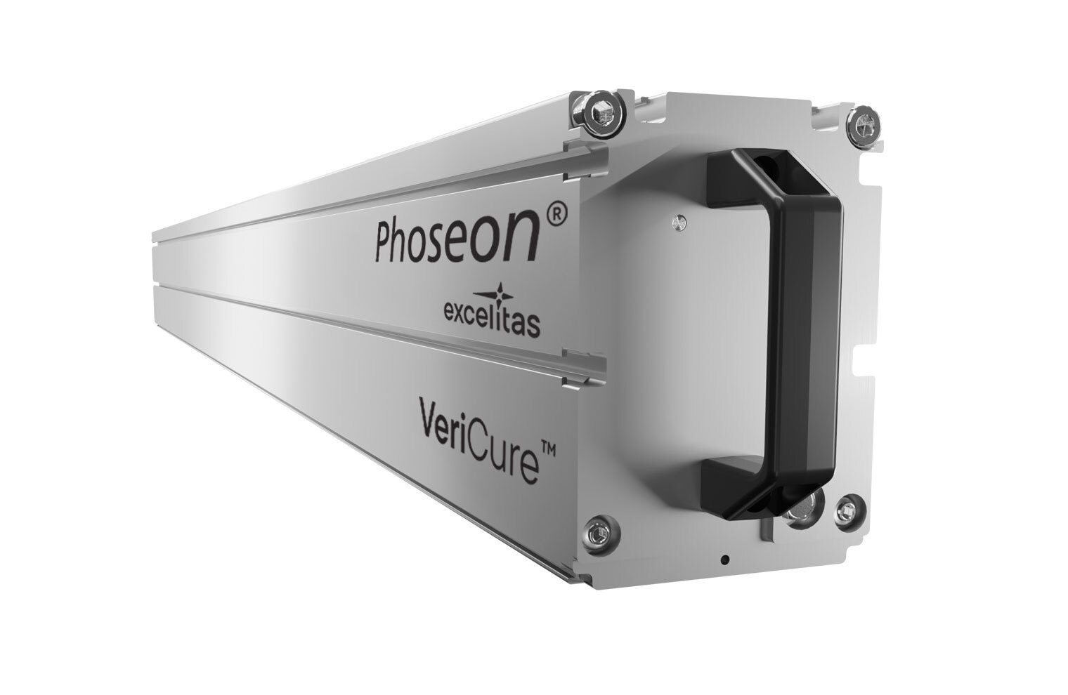

VeriCure is a wide-format, water-cooled UV LED curing system for wood coating applications. It features a patented Semiconductor Light Matrix (SLM) array and a unique high-efficiency cooling system, delivering high optical power and energy for high-speed processing. SLM technology provides optimum uniformity across the irradiation area to ensure peak performance and consistent curing quality. With available wavelengths of 365, 395 and 405 nanometers, the VeriCure system offers versatile integration supported by a comprehensive suite of communication protocols.
The high-efficiency UV LED system consumes 60 percent less energy and reduces maintenance and consumable costs compared to conventional systems. An optional secondary glass assembly protects from volatilized compounds, minimizing downtime and repair costs.
The system does not require warm-up time and offers customizable output levels for better energy efficiency and longer LED lifetimes. The device supports conveyor speeds of up to 50 meters per minute.
See this company at The ASSEMBLY Show Oct. 21-23 in Rosemont, IL.

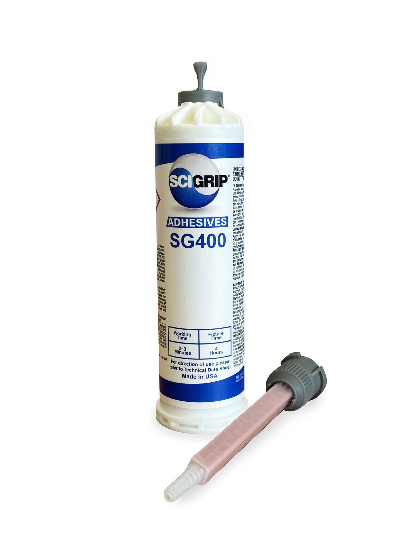

SG400LSE provides strong, reliable bonding on low-surface-energy materials such as polypropylene and polyethylene. The adhesive requires no surface preparation and has low sag, as well as short working and fixture times.
SG400LSE is a two-part translucent, methyl methacrylate adhesive with a 10-to-1 mix ratio. It cross-bonds plastics to metals such as steel and aluminum. The adhesive sets in less than 24 hours, and it bonds well to metal. The adhesive is ideal for bonding large plastic storage tanks, automotive interior fixtures, medical devices, workstations, casework, truck panels, outdoor furniture and signage.
See this company at The ASSEMBLY Show South April 16-17 in Nashville, TN.
