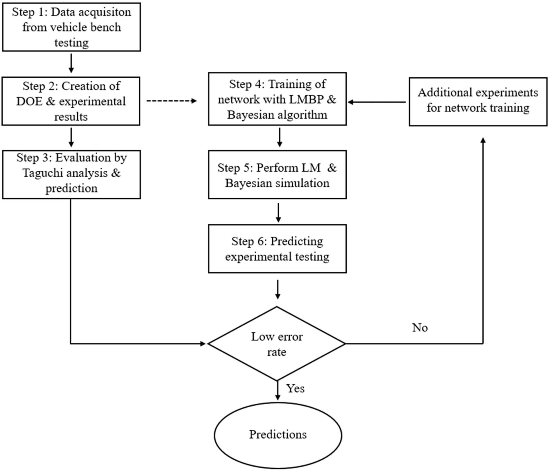

A flowchart detailing data acquisition, DOE, Taguchi analysis, network training, simulation, and error-based prediction loop.
This flow chart illustrates how the researchers developed their AI model for joint loosening. Illustration courtesy TOFAŞ Türk Otomobil Fabrikas AŞ

Our approach consisted of three steps. In the first step, we collected external loading values from mechanical testing of engine suspension joints. In the second step, we performed Taguchi method experiments with actual joint conditions to obtain training and test data for the neural network. In the third step, we created a neural network with the Levenberg-Marquardt (LM) and Bayesian Regularization (BR) algorithms to create a relationship between the controlled factors and the loosening rate. We then collected the mean squared error (MSE) values to evaluate the prediction errors of the neural network.
The results show that our approach can be used to predict the mechanism of self-loosening of bolted joints without additional tests, and it is possible to make predictions with very low error rates using AI. This promises to reduce the costs associated with testing new bolted joint designs.

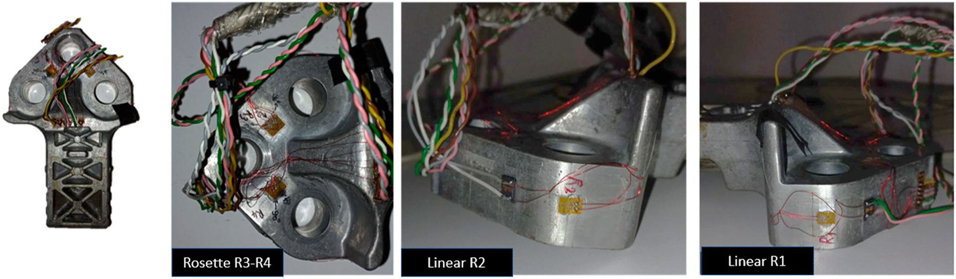

A metal component with strain gauges and wiring, shown from multiple angles for detailed inspection.
To measure radial displacement levels, four strain gauges were applied to the part near the location of the bolted joints. Photo courtesy TOFAŞ Türk Otomobil Fabrikas AŞ

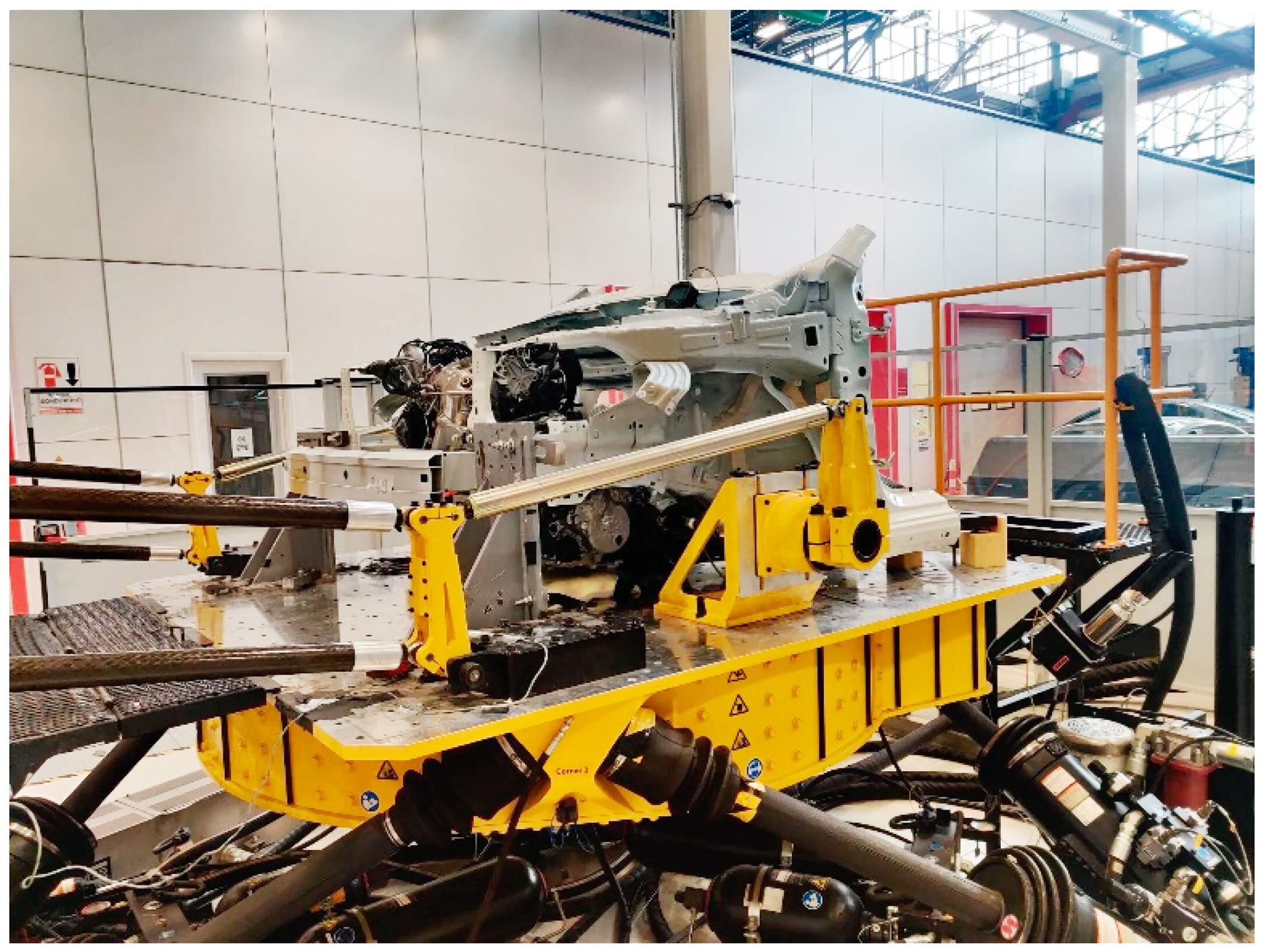

Before we could create a neural network, we first needed data on the vibrations acting on engine suspension joints.
To do that, we subjected a vehicular front-end assembly to simulated driving conditions using a test bench. To measure radial displacement levels, four strain gauges were applied to the cast-aluminum engine mount near the location of the bolted joints. Linear strain tensors were used for measurement, and a quarter bridge was used for analysis. The linear strain gauges were named R1 and R2; the rosette strain gauges were named R3 and R4.

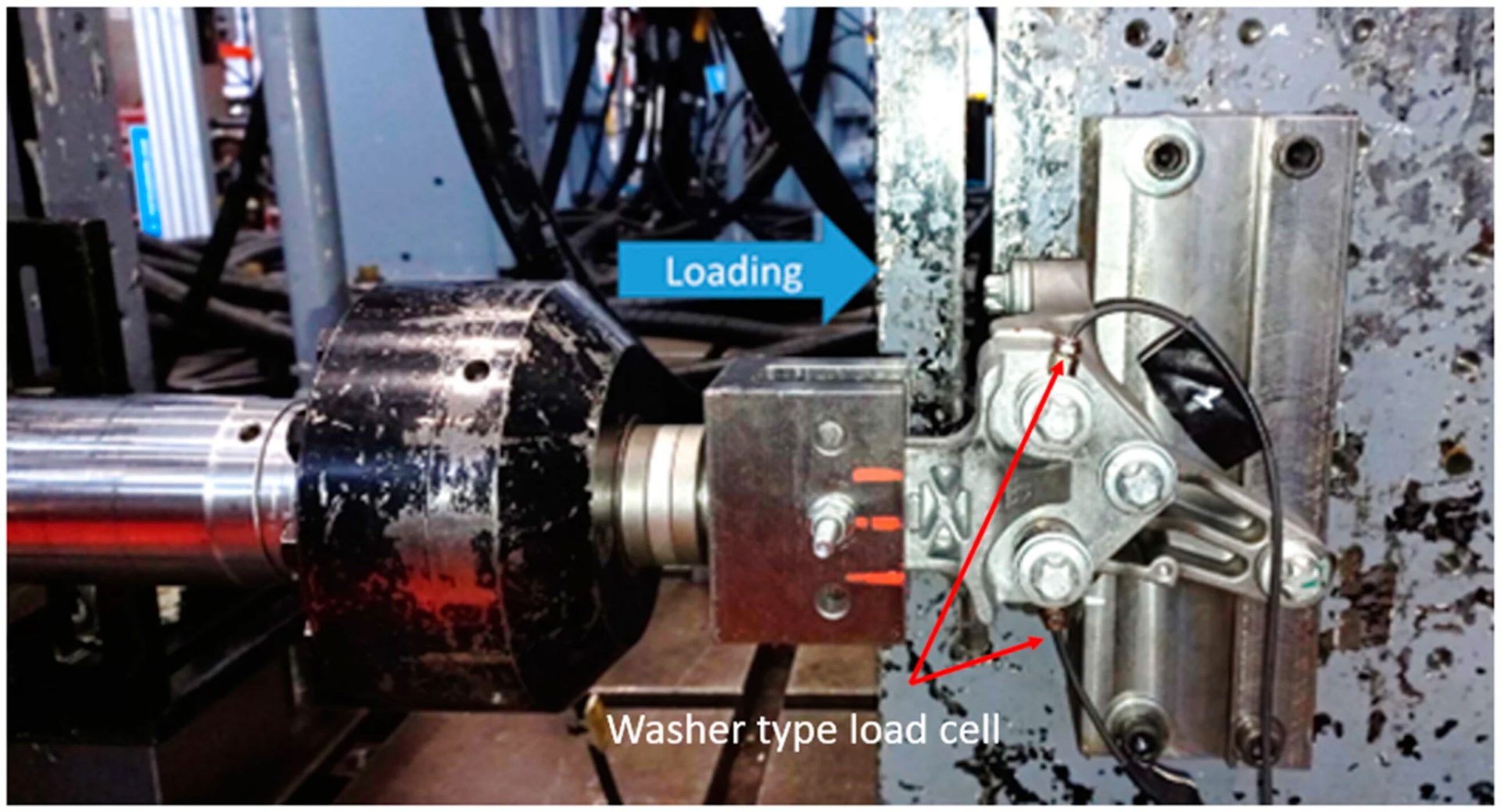

In addition, a 100-kilonewson washer-type load cell was mounted to measure clamp load levels.
We used a multiaxial simulation table (MAST) for our tests. The front end assembly was mounted to the test bench plate, and half shafts were mounted to a torque input fixture to apply real gear-change moments to the assembly. Two servo-hydraulic actuators applied the torque.
In addition, the front end assembly was subjected to simulated road vibrations. The vibrations were applied by six servo-hydraulic actuators. Data to drive the actuators was collected from actual road tests on our proving ground.
The front end and vehicle engine were located on the test bench. The instrumented part was located over the gearbox mounting support bracket.
A gray car chassis is mounted on a yellow test rig with various hoses and equipment in an industrial setting.
We used a multiaxial simulation table (MAST) for our tests. The vehicle front end was mounted to the test bench plate, and half shafts were mounted to a torque input fixture to apply real gear-change moments to the assembly. Photo courtesy TOFAŞ Türk Otomobil Fabrikas AŞ

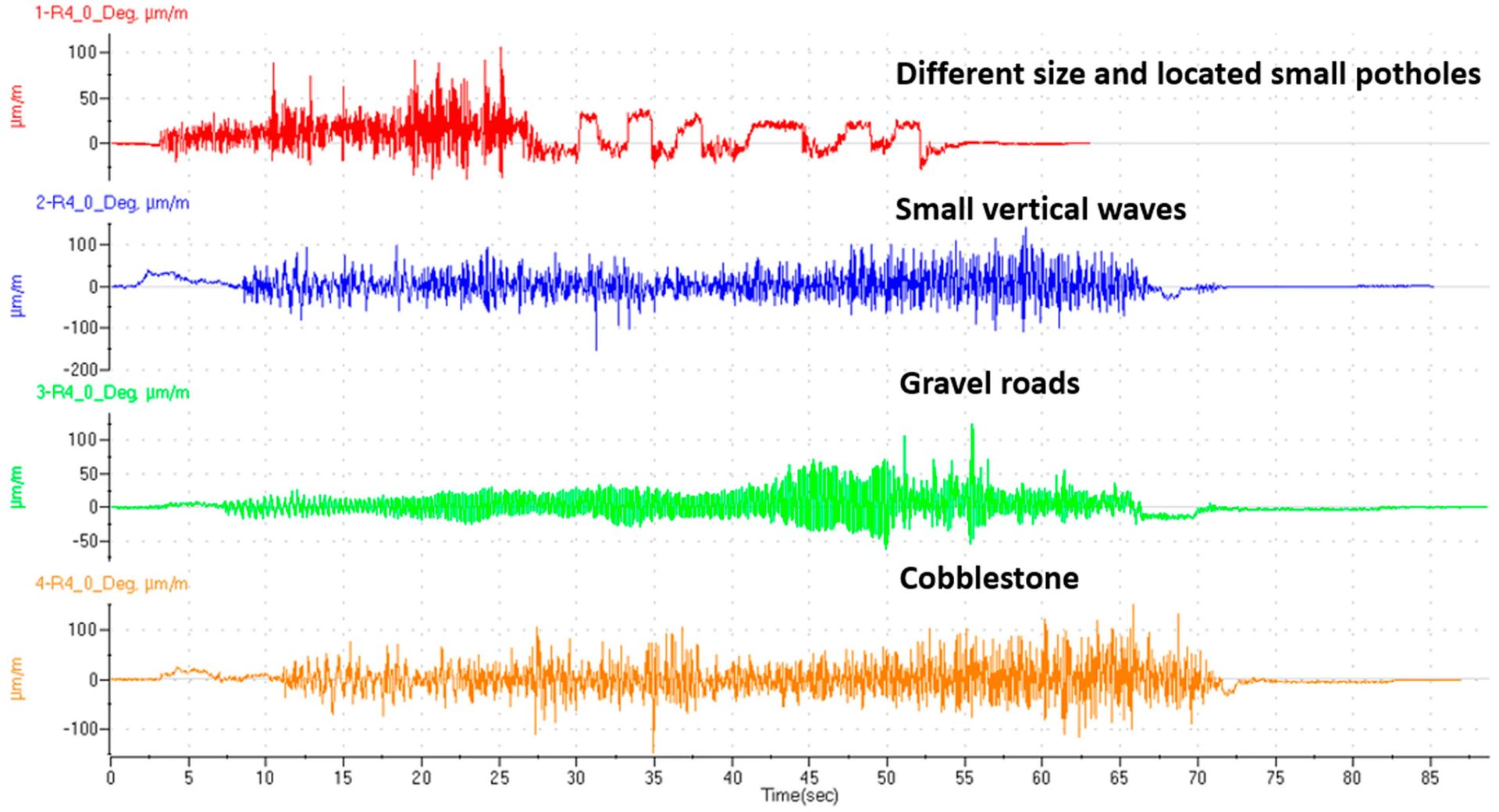

Analog signals were collected from the hydraulic system, and displacement control was implemented by checking feedback from the analog inputs. In short, the system was used as the input to control itself via acceleration.
To check the convergence between the road and bench responses, the main outputs were the engine mount body side, engine mount engine side, and front body rail accelerations, as well as the torque strut load and half shaft torque. To follow the fastener deformation level, the component response was collected by strain gauges.
In the end, the system allowed the movement of test specimens in six degrees of freedom: X, Y and Z relative movements, and roll, pitch and yaw angular movements.
When the data acquisition was completed, each sensor strain level was analyzed. The Y-axis motion and strain results were most severe on channel R4-0-degrees. The highest radial deformation acting on the connection under bench conditions was 150 microstrain.
The minimum radial displacement value of 0.15 millimeter was set in the monoaxial servo-actuator, which obtained similar deformations for the R3-0-degree and F4-0-degree channels.
The maximum level was determined as 1 millimeter to accelerate the loosening rates and to prevent the parts from being subjected to fatigue fracture before loosening. Above 1 millimeter level of displacement from the actuator, some cracks were observed on the parts. The aim was to see the loosening performance of the bolted joints between 0.15 and 1 millimeter radial displacement.

Four line graphs showing vehicle vibration data for different road types: potholes, vertical waves, gravel, and cobblestone.
These graphs show the strain applied to the test assembly from four road profiles. Illustration courtesy TOFAŞ Türk Otomobil Fabrikas AŞ

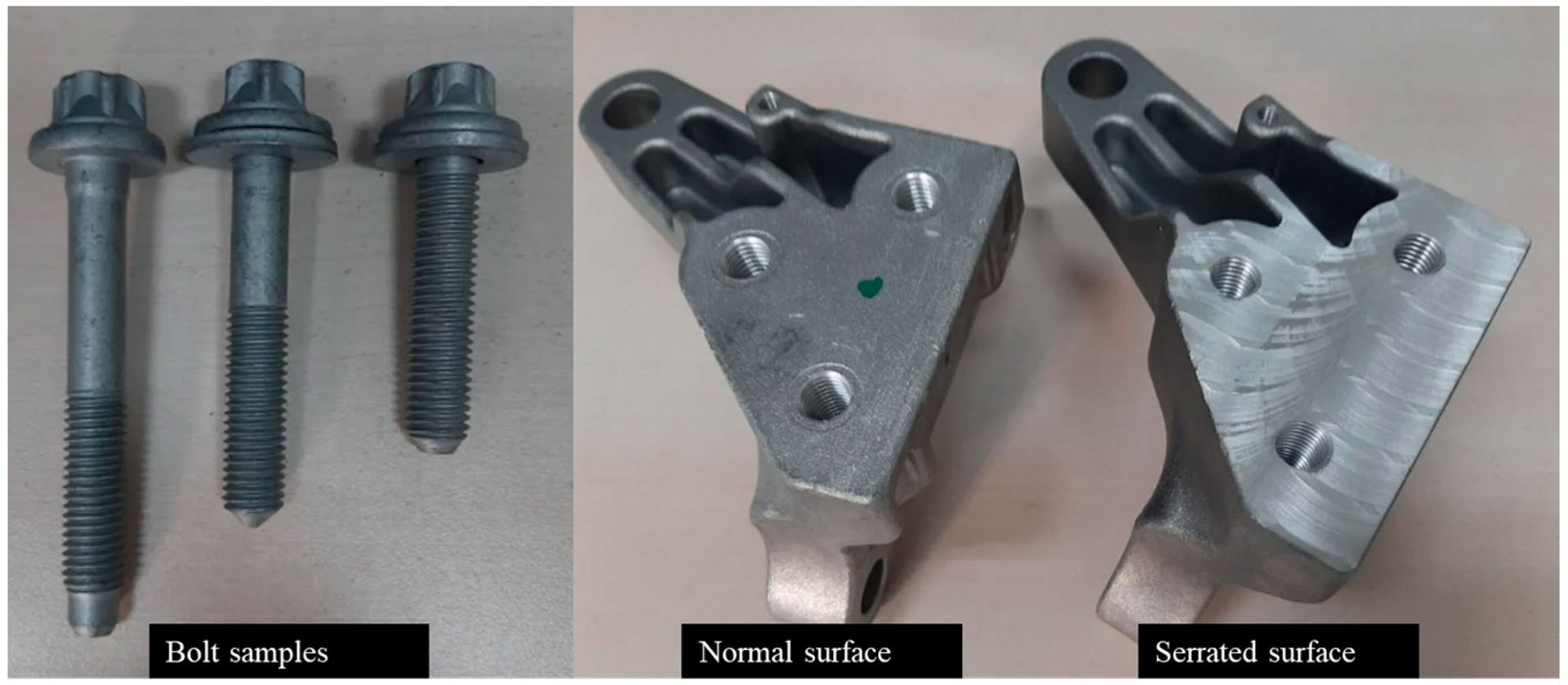

Metal and aluminum washers, serrated lower female thread parts, and connecting parts with the hole diameter and thickness adjusted were produced to provide the Taguchi parameters, such as clamping length, bearing area, joint rigidity, and surface conditions between parts. The serrated surface of the lower female thread part was processed to increase the friction coefficient of the surface. All materials were renewed after each test.

A mechanical testing setup showing a loading mechanism, a washer type load cell, and a metallic fixture.
The monoaxial test was set as the Y-axis. Photo courtesy TOFAŞ Türk Otomobil Fabrikas AŞ

Three bolt samples are shown alongside metal components with normal and serrated surfaces.
This image shows the bolt and female thread specimens used in the experiments. Photo courtesy TOFAŞ Türk Otomobil Fabrikas AŞ

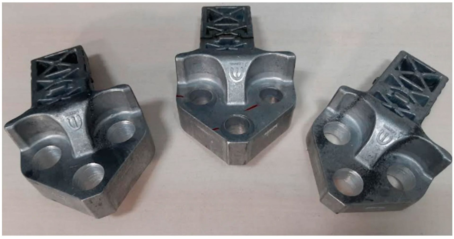

Three identical silver-colored metal industrial components with holes and a latticed structure.
This image shows the connecting parts with different hole diameters and thicknesses. Photo courtesy TOFAŞ Türk Otomobil Fabrikas AŞ

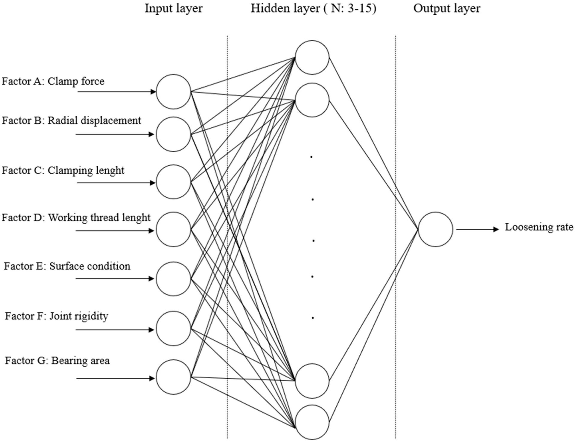

A neural network is an AI technique that is used to establish the relationships between inputs and outputs of black-box processes. Neural networks are widely used to solve complex problems with hidden layers by performing nonlinear matching between inputs and outputs.
In our study, we developed a neural network model to predict loosening rates by creating LM and BR algorithms, depending on the experimental results. The neural network was used as a surrogate model to examine the effects of the variables. Surrogate-based prediction and optimization methods play an important role in prediction and optimization processes, especially when the process model is complex and established using computationally expensive simulations.
Matlab software was used to develop the neural network model, which is composed of three layers. Our model has seven input neurons, 3 to 15 neurons in the hidden layer, and one output neuron. The factors considered by the model were as follows: clamp force, radial displacement, clamping length, surface condition between parts, joint rigidity, working thread length, and bearing area.
MSE values were examined to find the best neural network structure. The model was designed with 30 data points, which were obtained via the design of experiments. A total of 70 percent and 15 percent of these points are used for training and testing.
Cross-validation is a statistical technique to evaluate networks by partitioning the data into subsets of specified ratios. In this study, the leave-one-out method for cross-validation was used by partitioning the data into subsets, which were the data used for the test, validation, and neural network model training.
The reason for choosing MSE and R-value is to prevent overfitting and increase accuracy. R-values were recorded for training and testing. For high accuracy of the model, the R-value should be as close to 1 as possible. All R-values for neural network architectures were calculated between 0.91 and 0.98. The training was realized with Bayesian regularization, and the performance was in terms of the MSE and Pearson coefficient of determination.
A neural network showing 7 input factors, a hidden layer, and 'Loosening rate' as output.
The researchers developed a neural network to predict the loosening of bolted joints. Illustration courtesy TOFAŞ Türk Otomobil Fabrikas AŞ
