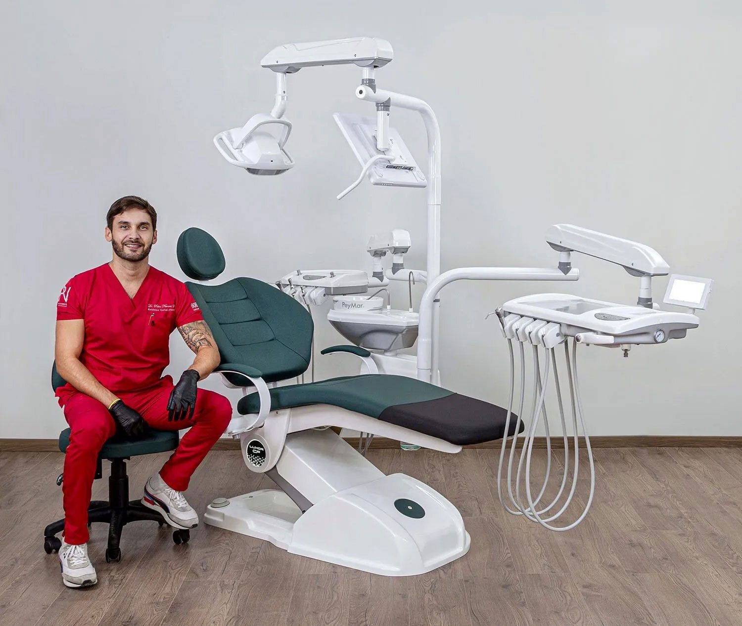

Dentist in red scrubs sitting next to a modern dental chair and equipment in a clean clinic.
Dental chairs must position patients, lighting and instruments so that dentists and hygienists can perform their tasks accurately, efficiently and ergonomically. Photo courtesy PeyMar

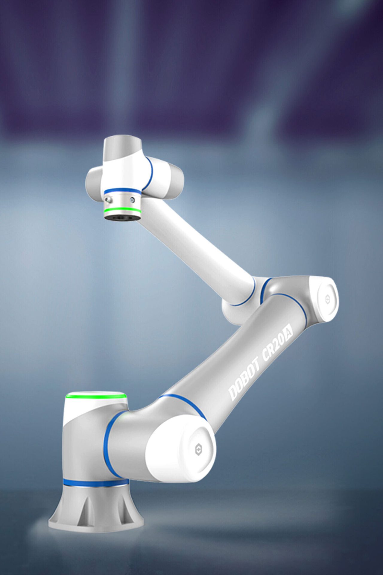

White and gray DOBOT CR20A collaborative robot arm with blue and green accents.
The CR20A cobot can carry a maximum payload of 20 kilograms, and it has a maximum reach of 1,700 millimeters. Photo courtesy Dobot
To address these challenges, engineers developed a custom system that consists of a Dobot CR20A collaborative robot mounted to a linear rail and equipped with a welder from Miller Electric Manufacturing LLC. This configuration enables a single robotic arm to operate across six welding stations continuously, requiring only one employee to manage the process.
Now, the cobot can weld one component while the operator replaces the completed part, minimizing downtime and maximizing output. By using one robot across multiple stations, PeyMar made the most of its limited floor space. It also reduced costs for labor, capital investment and maintenance.
The CR20A can carry a maximum payload of 20 kilograms, and it has a maximum reach of 1,700 millimeters. The CR20A has a dual-channel end-effector design, which can directly connect to multiple end tools. It also features a visual status indicator at the base for intuitive recognition of operating status.
With an advanced motion control algorithm, the CR20A operates more stably, with residual vibrations reduced by 50 percent during high-speed emergency stops.

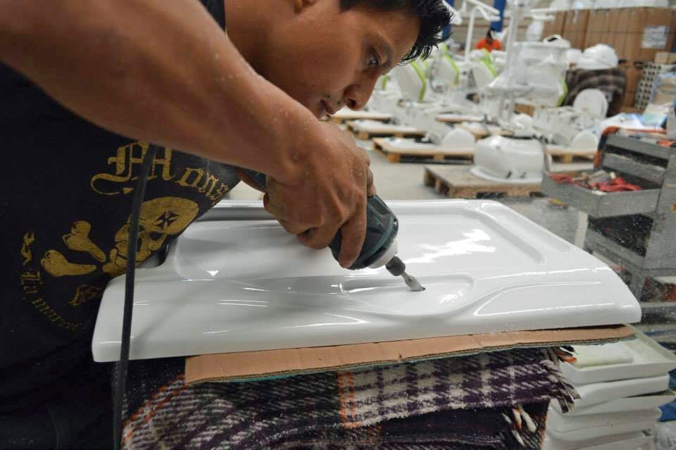

A worker using a drill on a white plastic component in a manufacturing facility, with other parts visible.
PeyMar has been manufacturing dental chairs in Mexico City since 2014. Photo courtesy PeyMar

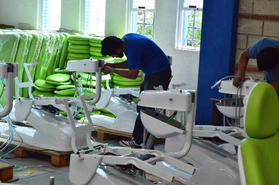

Workers assemble white dental chairs with bright green cushions in a busy factory workshop.
Dental chairs require numerous manual assembly processes. Photo courtesy PeyMar

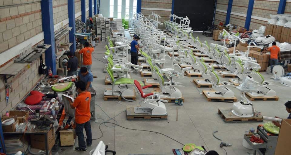

Factory floor where workers assemble dental chairs with green and red upholstery, showing a production line.
PeyMar ships dental chairs worldwide. Photo courtesy PeyMar
