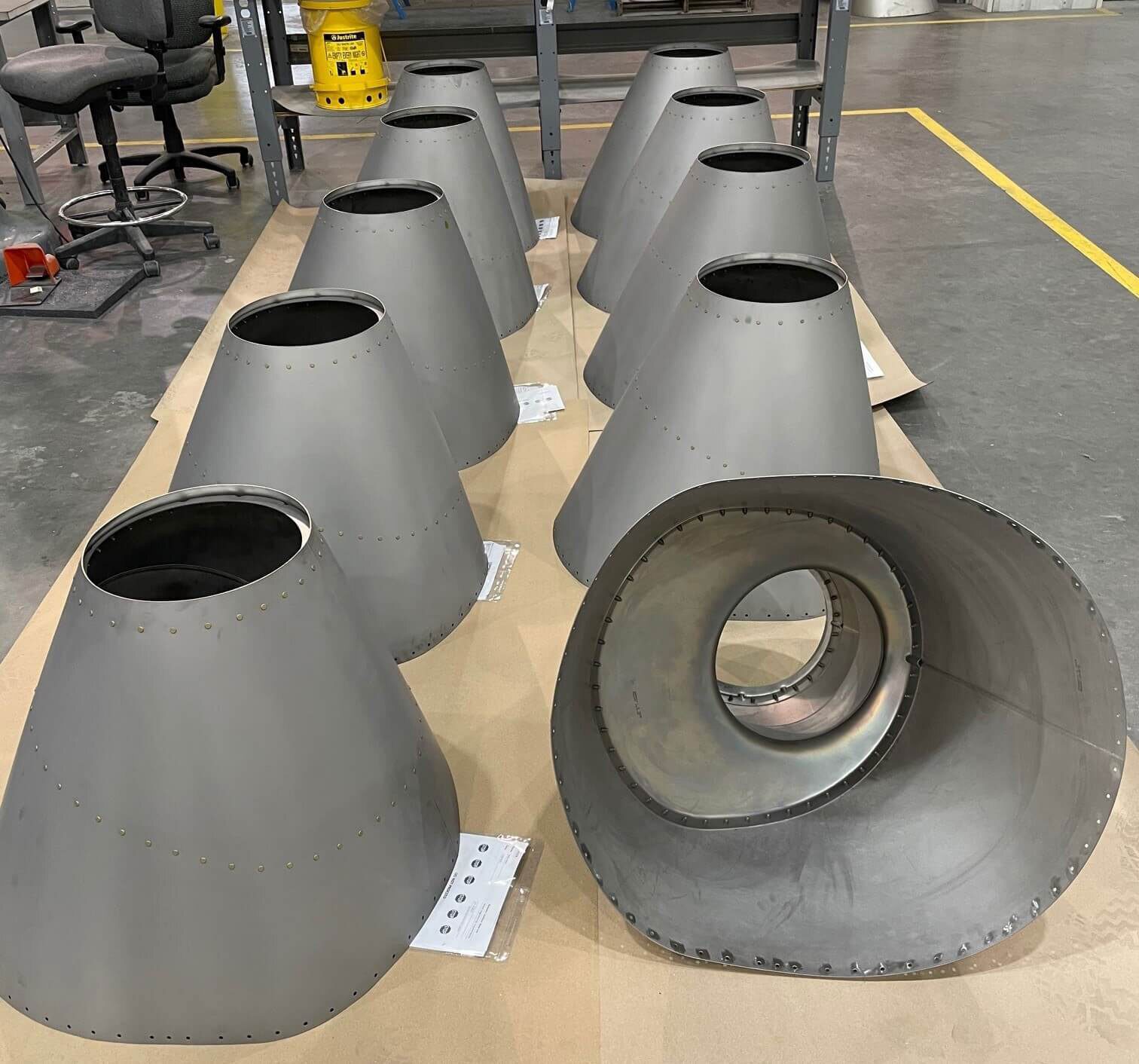

These fairings for auxiliary power units were assembled from hot-formed titanium parts. Photo courtesy Pryer Aerospace
The latter process was added to the company’s arsenal a few years ago, when a major customer made the ability to produce hot-formed titanium parts a condition for winning a large contract.
“We did every other type of metal forming for aerospace, but hot forming was the missing piece of our overall capability,” says Scott Pryer, director of engineering at Pryer Aerospace.
The properties that make titanium great for aerospace components also make it difficult to form. Standard cold-forming techniques can be used to form many titanium alloys. However, spring-back can be an issue, and cracking in curved sections is common.
Adding heat to the process solves these problems. Hot forming is a process that heats titanium and other high-strength alloys to extreme temperatures, which enables them to be formed in the press while in a soft, malleable state. The hot-forming process uses heated platens to heat a cold or slightly warmed blank during the press cycle. The introduction of heat inside the press increases the ability to form complex shapes at lower tonnages without the worry of fracturing, spring-back or residual stress. Because the malleability of the material is increased, hot-forming presses are usually much lower tonnages than cold-forming presses performing the same function.
Cycle time ranges from 10 to 30 minutes. Parts go in cold, come out hot, and end with a similar microstructure as they began.
