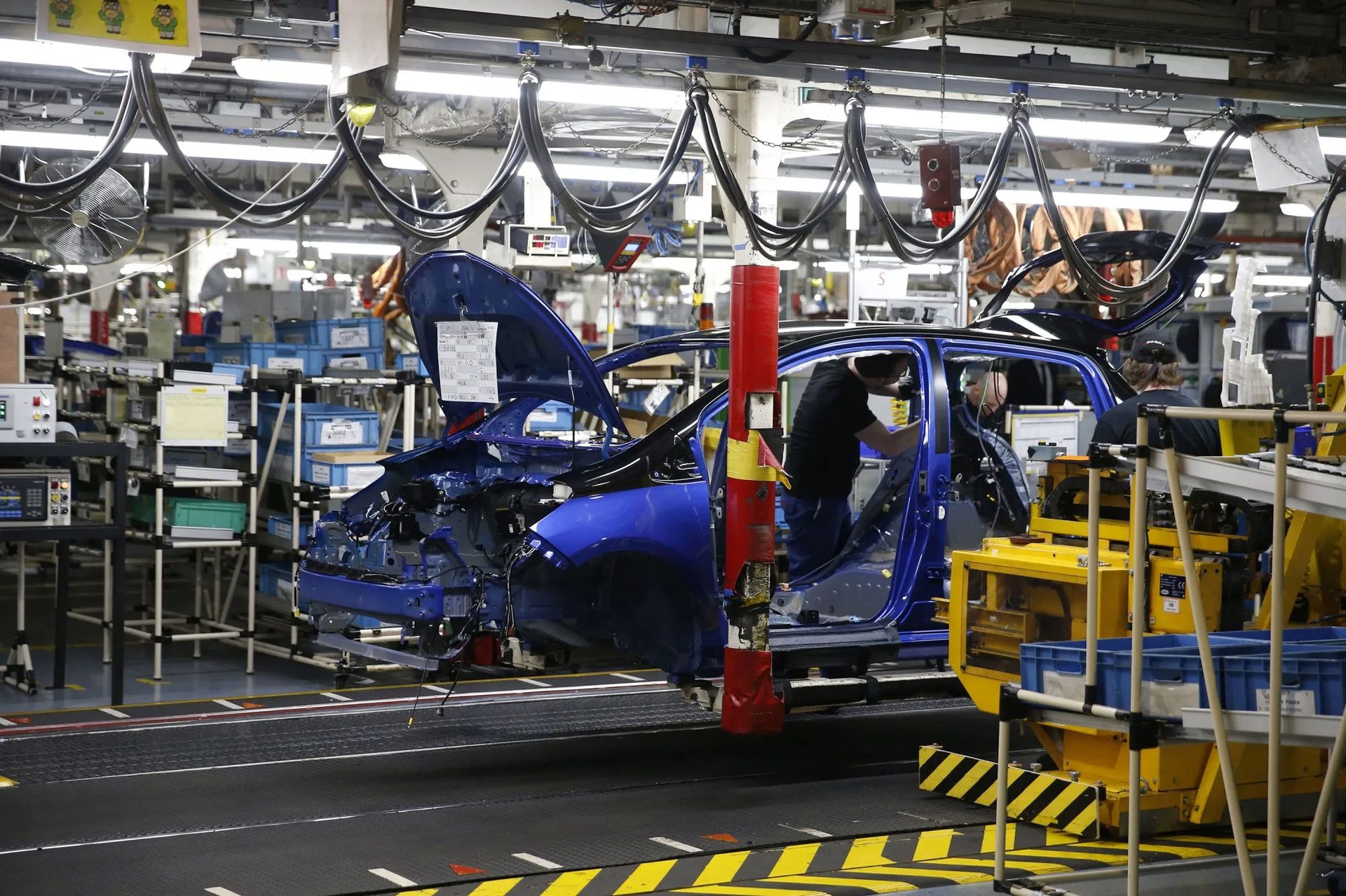

When it arrives at final assembly, the Yaris is just an empty shell, but it will leave as a finished vehicle, complete with wire harnesses, hoses, brakes, engine, windows, bumpers, wheels, seats, steering wheel, and other components. There are around 3,000 components to assemble on each vehicle. The assembly line is equipped with 1,450 screwdrivers that install 1.4 million screws daily.
