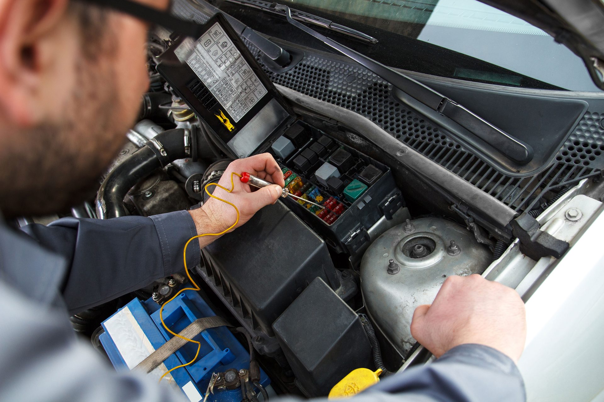

If your EV has been exposed to flood waters, have it inspected by a professional before attempting to drive it. Photo: PointImages / Getty Images

Inspect after exposure. If your EV has been exposed to flood waters, it’s critical to have it inspected by a professional before attempting to drive it. Even if the car appears to function normally, hidden water damage can lead to severe problems later.
