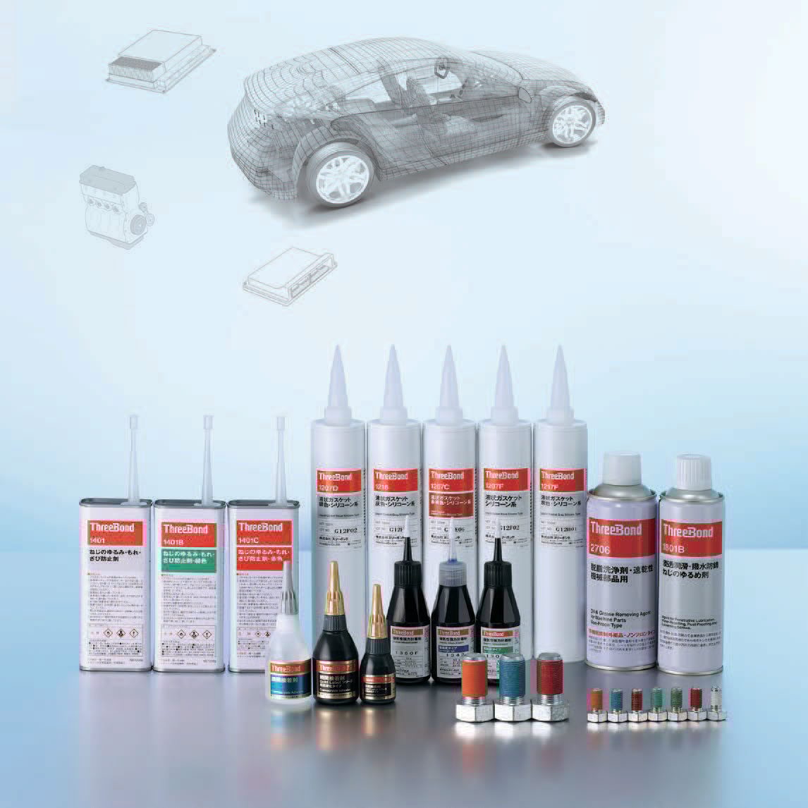

ThreeBond’s offerings include anaerobic adhesives, thread-lockers, cyanoacrylates, epoxies, silicones and UV-cure adhesives.Photo courtesy ThreeBond International Inc.

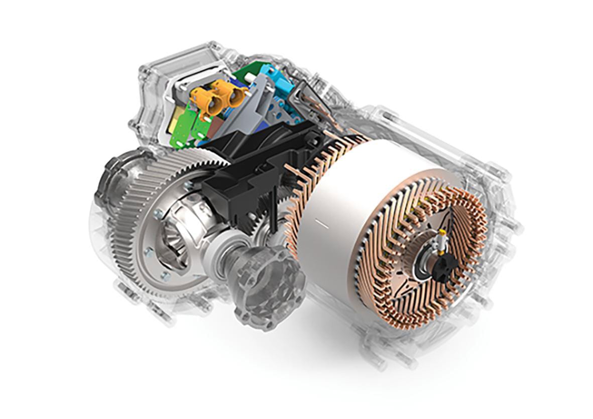

Dissipating heat is critical for the reliability, performance and longevity of EV motors.Photo courtesy Vitesco Technologies
