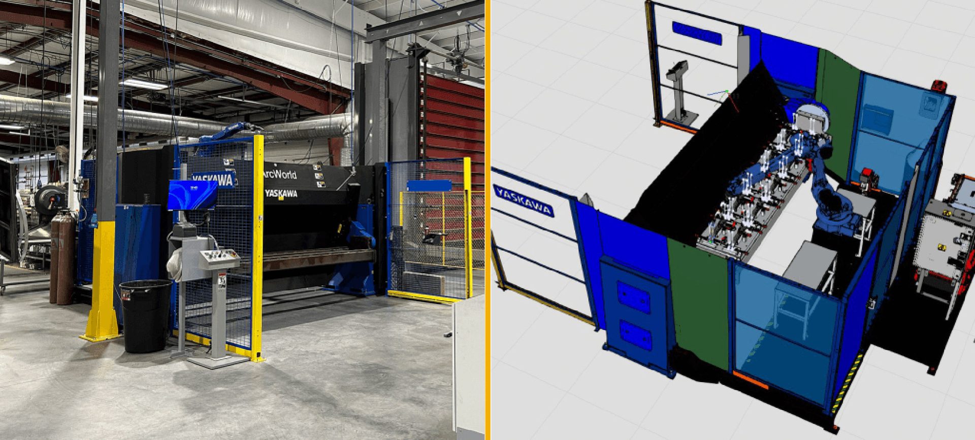

Berlin Gardens relies on robotic cells for welding aluminum fixtures to the bottoms of furniture pieces. However, the time spent programming robots began to conflict with the company’s culture.
“Our lead programmer would spend hours on end in the back of the cell to make sure he had the robot in the right position to program each point,” says Derrick Yoder, the aluminum production manager at Berlin Gardens. “We could spend up to 13 hours on a single program, and a lot of those would be after-hours or on weekends.”
To compound this, the task of positioning the robot at the right angle for a specific weld would put physical strain on the programming team, reducing job satisfaction and increasing costs. “With a welding application, it’s very easy to have a bad part due to the robot being at the wrong angle during the weld,” Yoder explains.

Yaskawa ArcWorld robotic cell: real photo and 3D CAD model comparison.
For one assembly, programming the robot manually required 13 hours. With offline programming, the same task can be completed in under three hours. Photo courtesy Visual Components

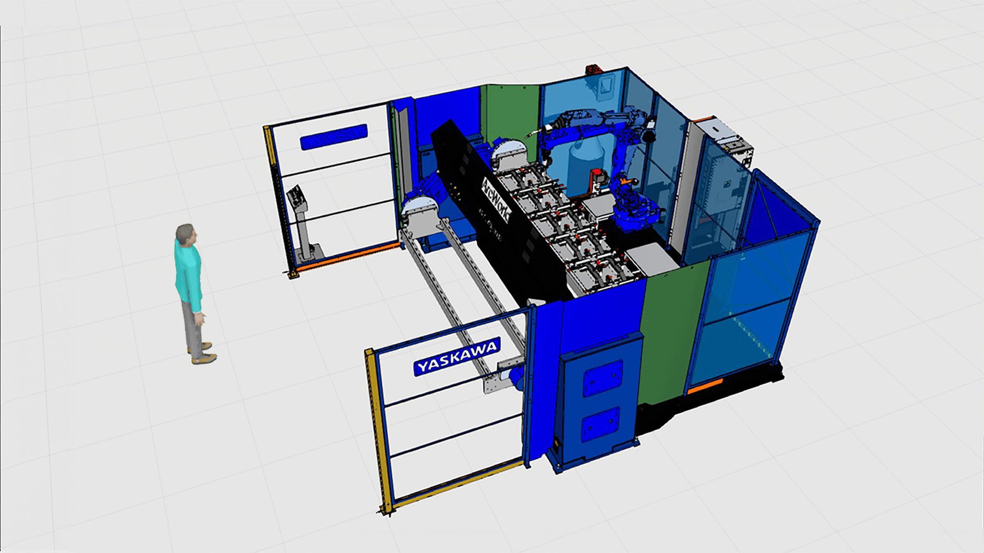

3D render of a Yaskawa robotic welding cell with a human figure nearby.
With just a few clicks, engineers can program multiple robot paths in a welding cell. Photo courtesy Visual Components
Yoder was blown away by the reduction in repetitive work. “The biggest difference was the number of points programmed by simply selecting a joint in the software,” he explains.
When an engineer chooses a single weld in the CAD file, the software automatically generates multiple lines of programming code for the robot. “And it’s not all simple movements,” he continues. “We have different fixtures where it takes a bit of maneuvering to place the welds, but the software handles them just fine with accuracy.”
Additionally, the knowledge could be stored in the software for future robot programmers to reuse or optimize.
While the ease of use and reduction in repetitive work were welcome, the efficiency gains exceeded expectations. For one complex fixture, programming manually had previously required 13 hours to get into production. With offline programming, it could now be completed in under three hours, an 80 percent reduction in programming time. “That gives you a small glimpse into the labor saved,” Yoder says, “not to mention the efficiency of how the program runs.”
