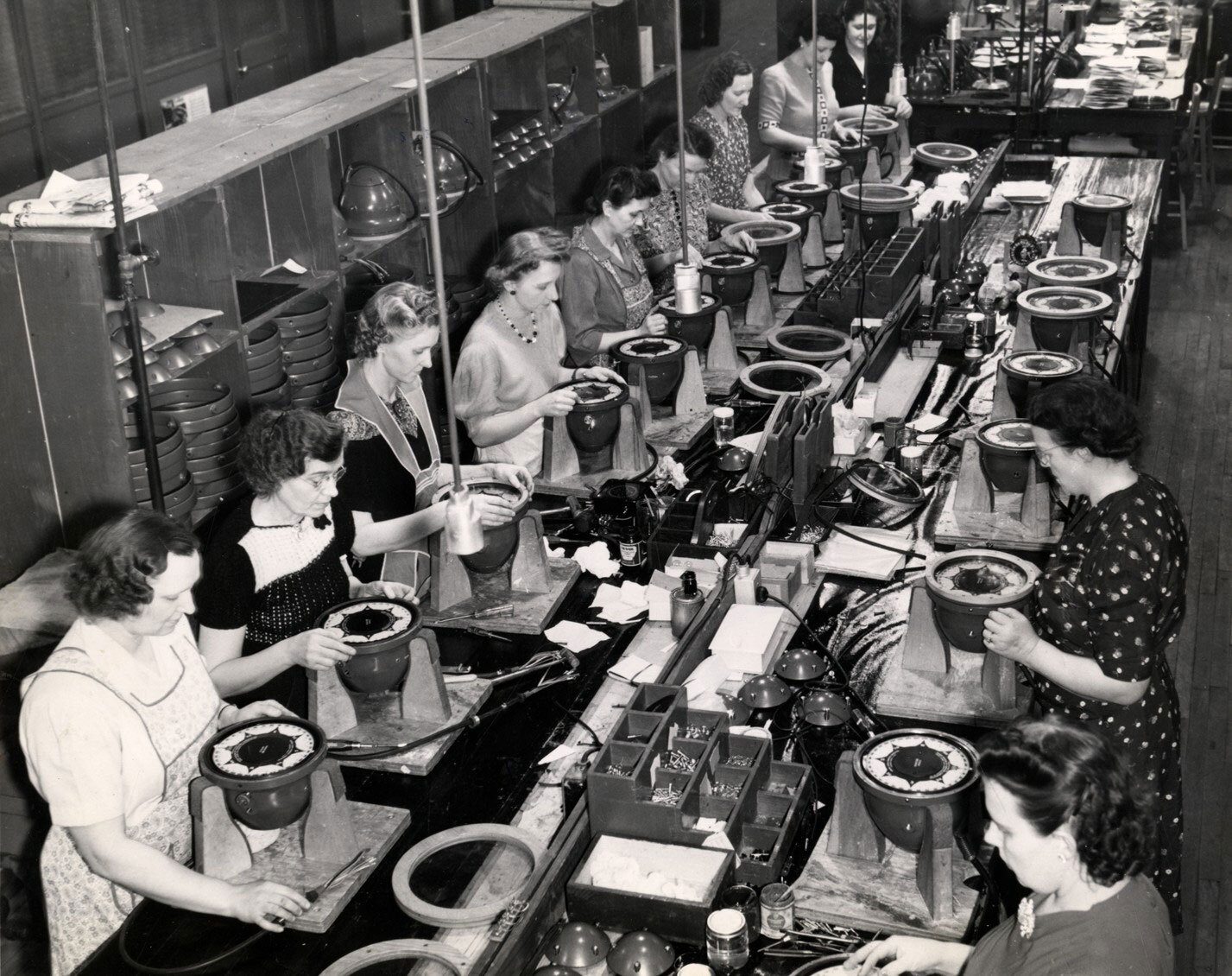

BW photo of women on a factory assembly line, assembling round electrical components.
During World War II, the Dodge Main factory mass-produced gyrocompasses, in addition to other products. This photo from 1942 shows a group of women assembling auxiliary indicators for gyrocompasses used in U.S. Navy ships. Photo courtesy National Automotive History Collection, Detroit Public Library

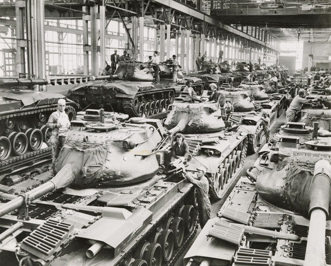

Black and white photo of an early Cold War tank factory with many M47 Patton tanks and workers.
For decades, Chrysler operated a tank arsenal in Warren, MI, that produced thousands of machines such as these M47s. Photo courtesy National Automotive History Collection, Detroit Public Library

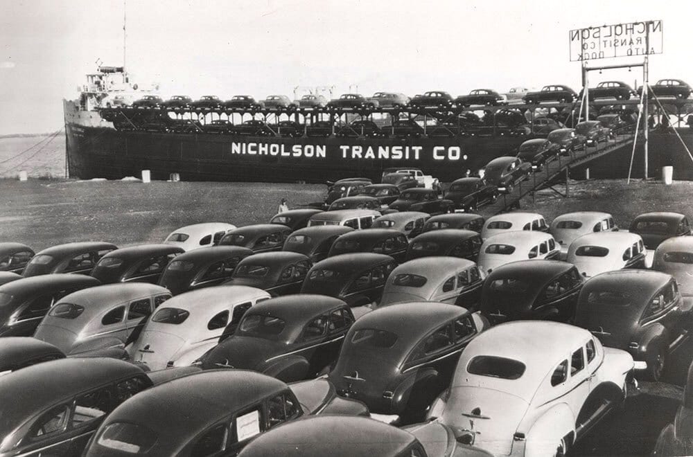

Nicholson Transit Co. ship loaded with cars at dock, more cars parked.
In this view from 1946, a fresh batch of Chrysler, Dodge and Plymouth sedans are ready to be loaded onto a lake freighter in Detroit bound for war-weary consumers in Buffalo and Cleveland. Photo courtesy AACA Library & Research Center

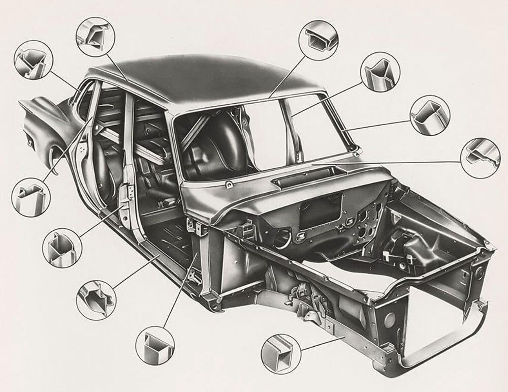

The innovative vehicle also featured a unitized body construction, which eliminated the conventional frame. The unibody provided greater structural strength and interior roominess than was possible with traditional body-on-frame assembly processes.
Box members in the underbody absorbed driving, braking and suspension loads. Structural components such as front fenders and engine-support cross members were bolted on to facilitate servicing and reduce the cost of repairs to damage caused by collisions.
“Resistance to twisting and bending is as much as 150 percent greater than the frame-body designs still used on most other cars,” proclaimed Chrysler in promotional literature. It also pointed out that “the new four-door sedans show a 100 percent improvement over conventional body-and-frame construction in torsional rigidity and a 40 percent increased beam strength.”

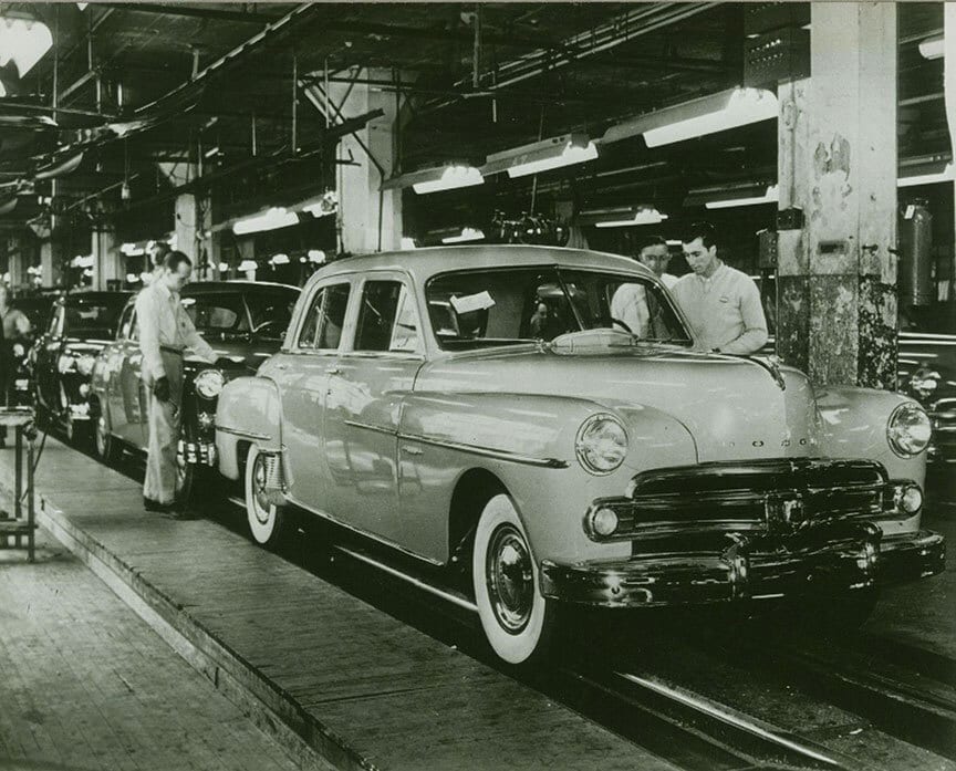

Black and white photo of vintage Dodge cars on an assembly line with workers.
Shiny new sedans are about to roll off the line at the Dodge Main plant in 1950. Photo courtesy AACA Library & Research Center

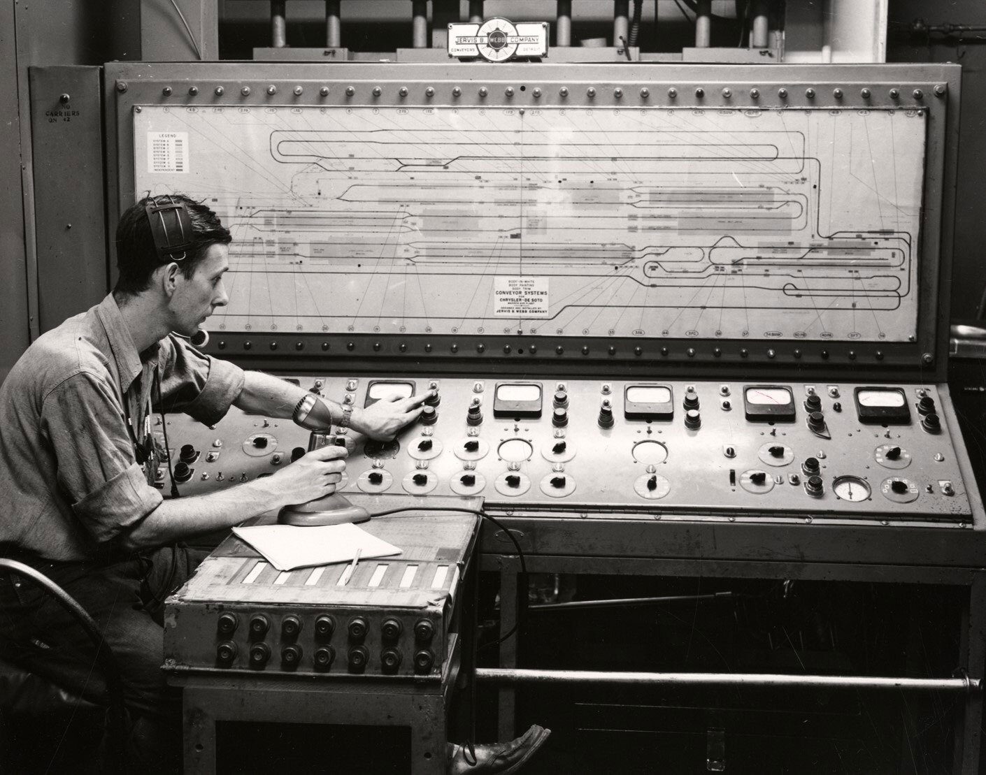

Man in headset operates a vintage control panel displaying a conveyor system diagram.
In the mid-1950s, this electronic control board regulated conveyors at the DeSoto assembly plant in Detroit. By manipulating switches on the state-of-the-art system supplied by the Jervis B. Webb Co., an operator could direct, reverse and redirect every conveyor inside the factory. Photo courtesy National Automotive History Collection, Detroit Public Library

Detailed car body shell with magnified structural cross-sections.
The 1961 Dodge Lancer featured full unibody construction, which provided greater structural strength and more interior roominess than conventional designs. Some structural components, such as front fenders and engine support cross members, were bolted on to facilitate servicing. Illustration courtesy AACA Library & Research Center

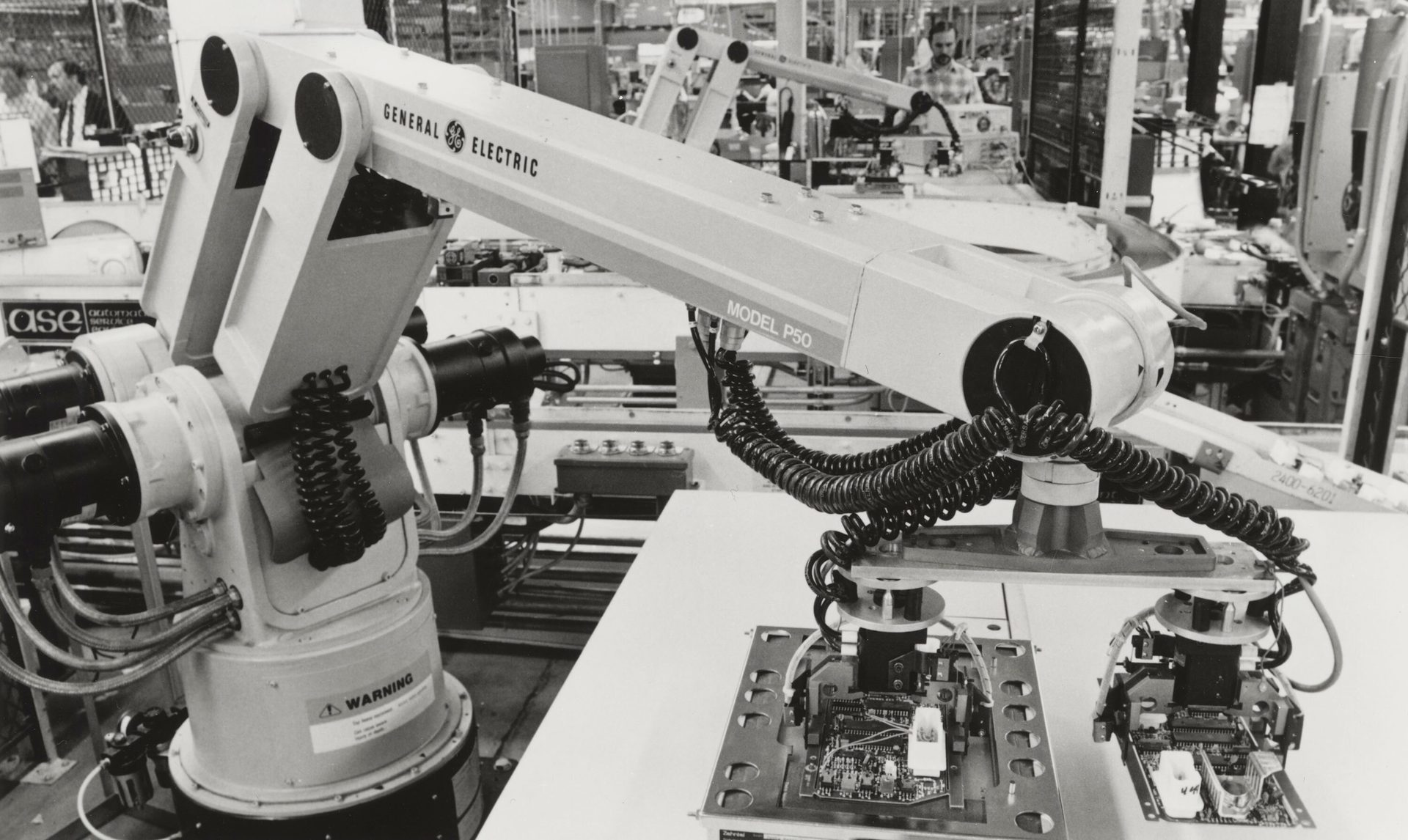

GE Model P50 industrial robot assembling circuit boards in a factory.
This scene from the 1970s shows assembly robots in use at Chrysler’s electronics plant in Huntsville, AL. Photo courtesy AACA Library & Research Center

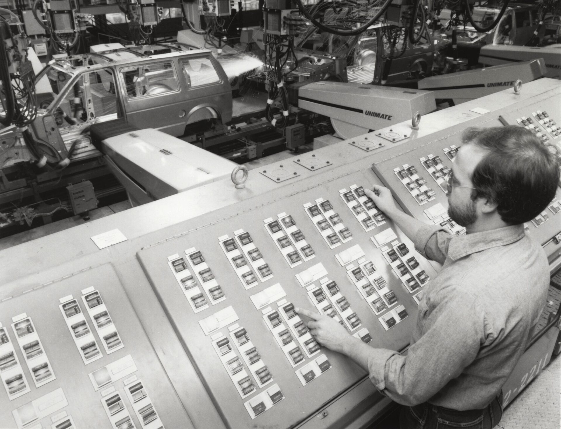

In the late 1970s, Chrysler installed Unimate welding robots at its Lynch Road Assembly Plant in Detroit to produce full-sized New Yorker and Newport sedans. Photo courtesy AACA Library & Research Center
The K-car is credited as the vehicle that quickly and single-handedly brought the company back to health. But, Hyde says it went through a rocky path. For instance, “the factory experienced production glitches with the new robotic welding system.”
“The new robots do not really look like Frankenstein’s monster, or like Artoo Deetoo in ‘Star Wars,’ but rather like a row of giant birds,” noted an article in the Dec. 8, 1980, issue of Time magazine. “They poke their 9-foot-long, rubber-sheathed necks toward the row of automobile frames. From their beaks, a blinding shower of sparks streams forth. The escape of compressed air creates a loud hissing sound.
“This is Chrysler’s sprawling 145-acre Jefferson plant in East Detroit, where the trouble-ridden firm is building the new K-cars—the Plymouth Reliant and Dodge Aries—that it hopes will save its future. Once 200 welders with their masks and welding guns used to work on such an assembly line.
“Here there are no welders in sight; there are only 50 robots craning forward, spitting sparks. They work two shifts, and the assembly line’s output has increased by almost 20 percent since the robots arrived earlier this year.”
Several years later, Chrysler engineers used the latest robotic technology to produce the groundbreaking minivan. The small, front-wheel-drive vehicle that could easily fit inside a garage pioneered an entirely new segment in the auto industry.
The first models of the Dodge Caravan and Plymouth Voyager rolled off the assembly line in Windsor, ON, on Nov. 2, 1983. The minivan proved so popular that it eventually replaced the ubiquitous station wagon in American driveways and became a cultural icon.
“The minivan required an investment of nearly $700 million, including the $400 million Chrysler spent to modernize and automate the Windsor assembly plant that built it,” says Hyde. “Most of the investment in Windsor was tied up in 125 robots and a $110 million paint shop.”

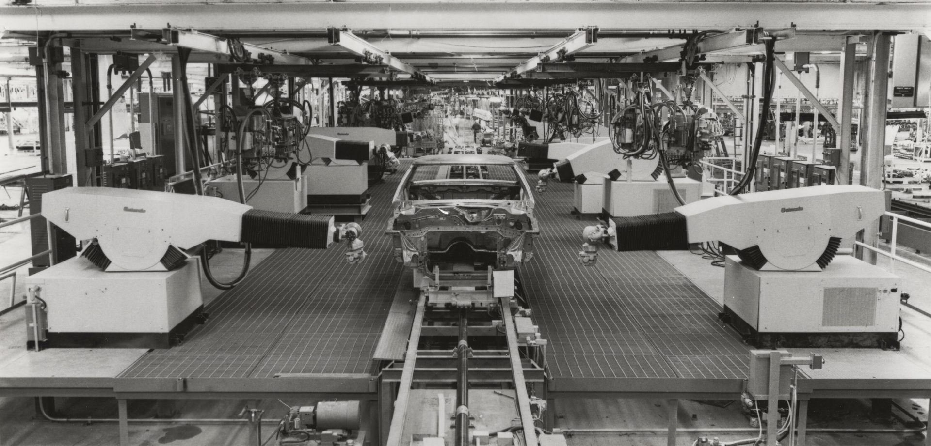

Various welding operations in the plant put 3,800 spot welds on each body. The Windsor Assembly Plant featured 58 robots on its robogate welding line. The high-tech system applied spot welds to 97 percent of each minivan.
An additional 67 robots were used to braze, paint, seal glass and transfer assemblies. The facility also was an early adopter of an optical laser gauging system developed by Perceptron Inc., which was a start-up company at the time. The system used 14 cameras to automatically check the dimensions of all front doors and side body panels. Chrysler claimed that it was the first such application of the technology in the auto industry.

Man operates a control panel for car assembly robots (UNIMATE) in a factory.
