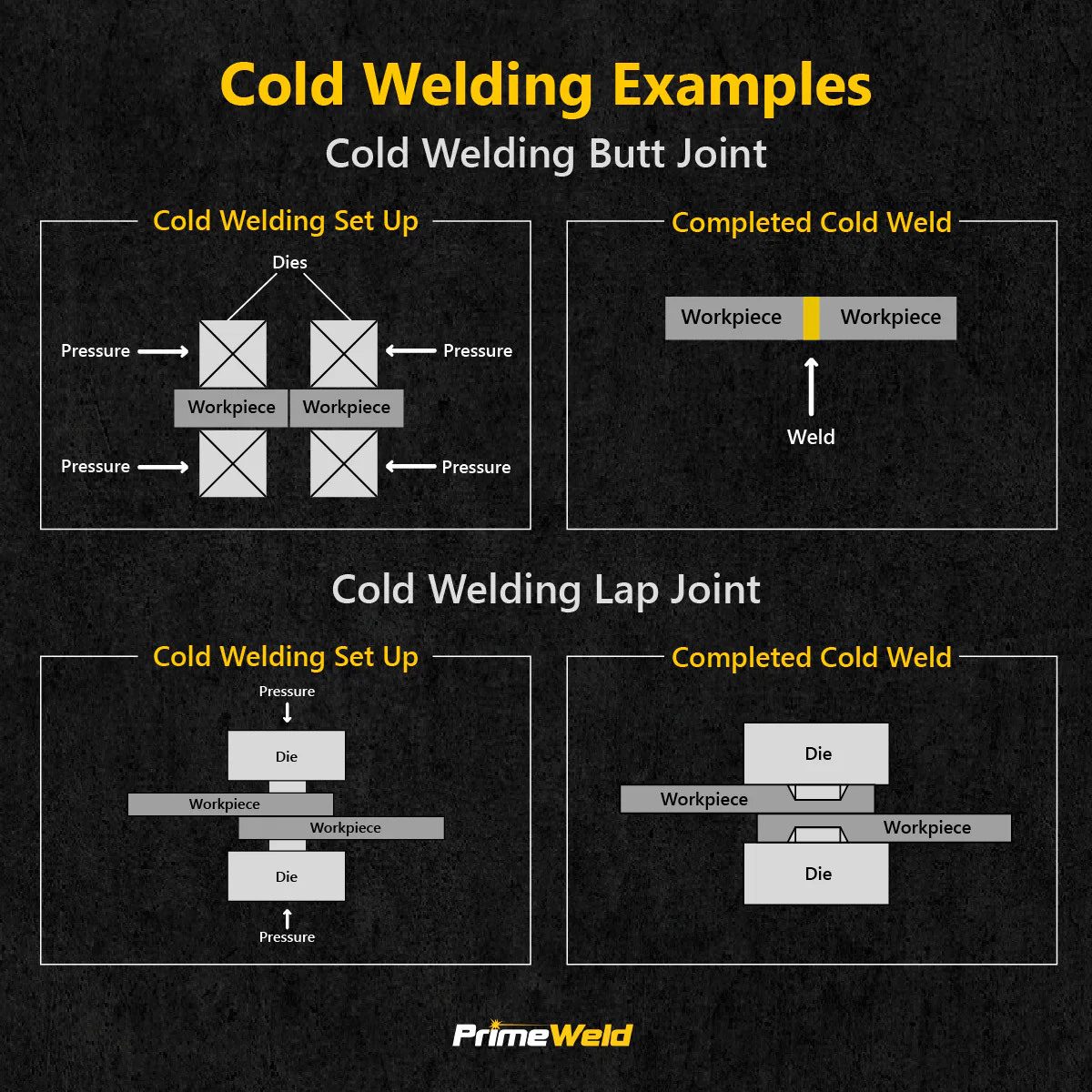

Diagrams illustrating cold welding butt and lap joints, showing setup and completed welds.
Since cold welding presses metals together, it can only be used to create lap joints and simple butt joints. Welding large parts or anything with varying shapes is difficult. Photo courtesy PrimeWeld

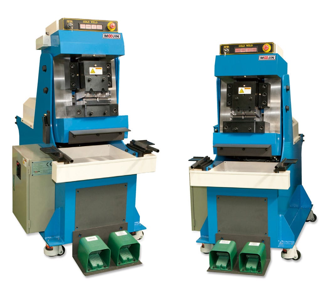

Two blue and grey industrial cold welders with foot pedal controls.
Cold welding is a solid-state process for joining two pieces of metal together with high pressure. The pressure causes the metal atoms to deform, flow and come into intimate contact. The atoms come so close together, in fact, that they form a metallurgical bond. Photo courtesy Moojin Service
On the plus side, cold welding can join dissimilar metals, which is often tricky with conventional welding. Another benefit is that it can be used in clean environments, unlike other welding methods that produce fumes, sparks and debris. And, unlike traditional welding, cold welding doesn’t create a heat-affected zone, therefore avoiding changes to the metallurgical structure of the parts, which can lead to stress and potential failure.

Prepping the joint is crucial in cold welding. The joining surfaces must be perfectly flat and smooth. Any irregularities or gaps can result in a weak or defective bond.
Joint design is another limitation. Since the technique presses metals together, it can only be used to create lap joints and simple butt joints. Welding large parts or anything with varying shapes is tough or impossible.

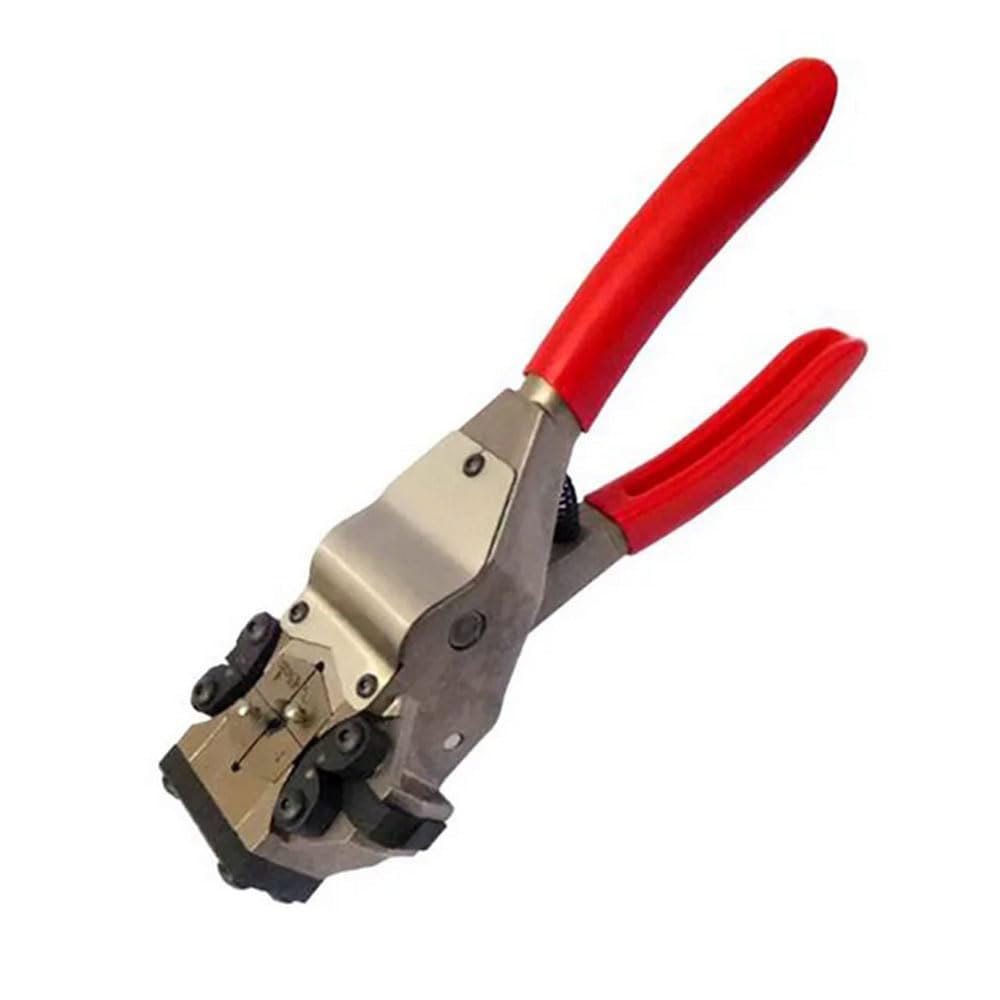

Red-handled crimping tool.
Cold welding does not necessarily require a press. In some cases, a simple hand tool can provide enough pressure to cold weld two metal wires. Photo courtesy Jieotwice

A distinct advantage of cold welding is it doesn’t rely on machines that require large amounts of electricity. Modern cold welding applications use tremendous amounts of pressure applied in a vacuum. The most common usage of cold welding involves a portable, sometimes even handheld, device to join or cold weld copper wire.
Cold welding machines vary depending on the materials to be welded and the size and shape of the parts. For instance, a cold welding machine to join copper wires to aluminum parts may be a handheld device. For cold welding larger parts, a large stationary machine may be necessary. In these instances, the metal parts are placed in a die on one side and pressed tightly against the other piece being joined. Under enough pressure, a tight bond at the atomic level is formed between the two metals.

Next, operate the welder. Parts are typically fed into a welding machine from the sides and placed in a die. The pressure brings the metal together so firmly that any gaps in the connection are effectively pressed out, and the parts are so tightly fused together that there is an almost total fusion bond between the two.
