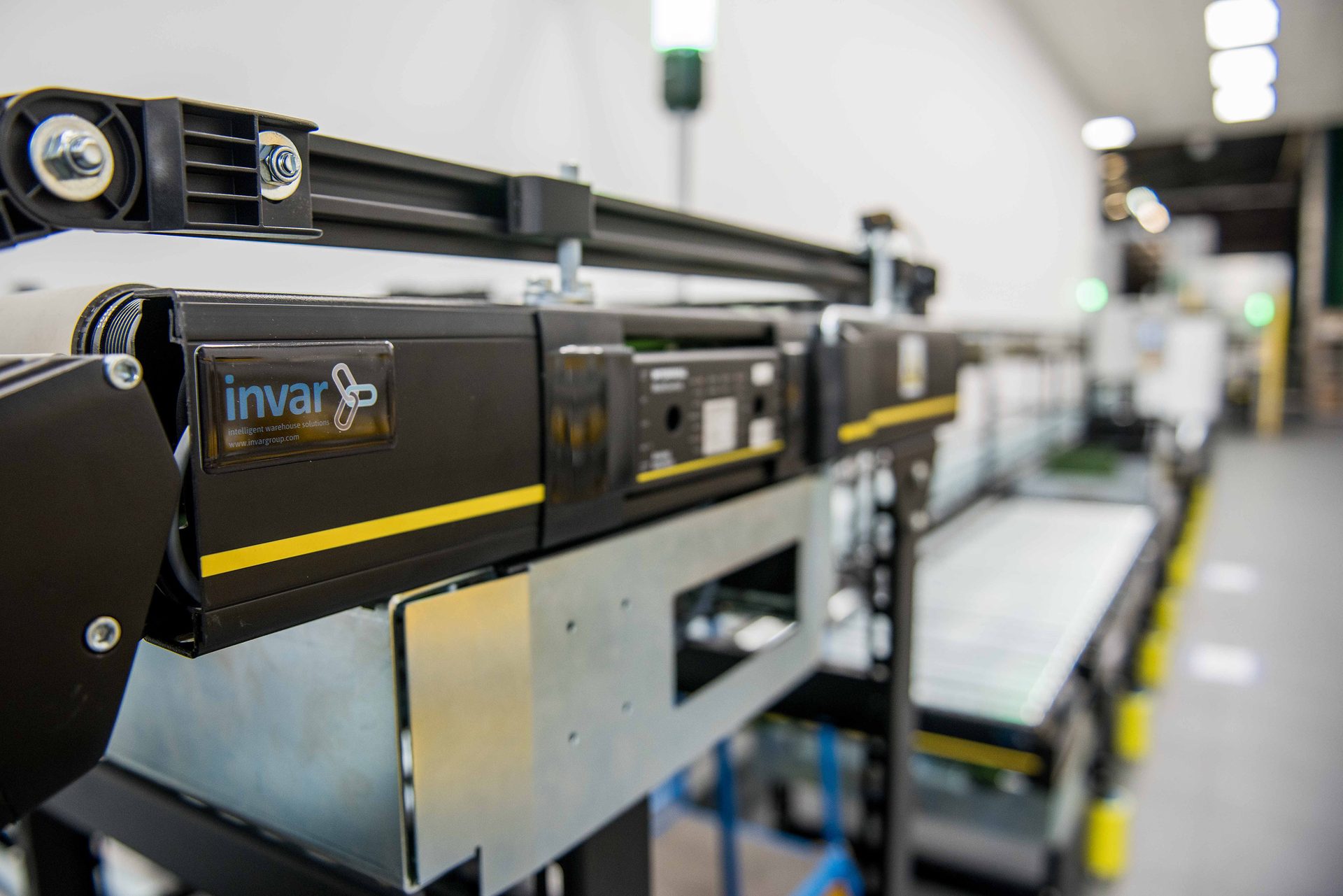

Invar’s tote transportation system consists of approximately 300 meters of powered roller conveyors from Interroll Group and three lifts from Nerak Systems Inc., spread across three buildings. The system in the main assembly area features two tiers for goods coming in and goods going out.
Each tote has its own “license plate number” (LPN), which is scanned at each workstation. Once a worker loads or unloads a tote, it is automatically transported to the next stop, whether it’s another workstation, a storage area, or the assembly line. Workers can also use touch-screens to select the tote’s next destination.
A key aspect of the system is its ability to operate on demand, halting completely between tote loads. This saves energy costs and is expected to achieve a return on investment (ROI) in under a year.

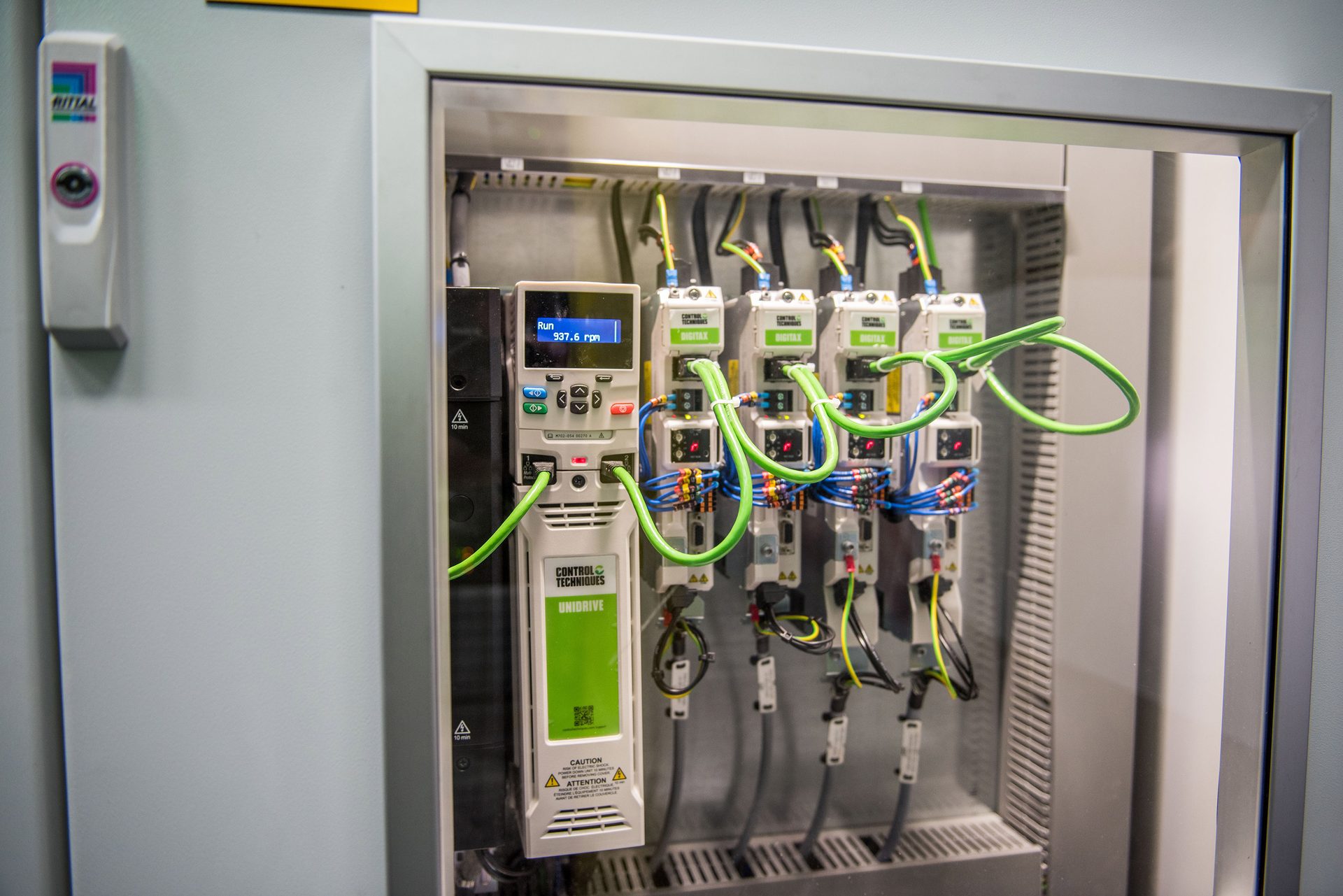

Industrial electrical cabinet with Control Techniques Unidrive and Digitax motor drives and wiring.
Ironically, many of the machines in Invar’s automated system run on the Control Techniques variable speed drives that Nidec assembles at the factory. Photo courtesy Nidec Drives

Nidec’s Control Techniques drives are integral to the efficient stop-start nature of the system. For this project, two types of drives were used: three Unidrive units and eleven Digitax HD M750 units.
The Unidrive was selected for the lifts within the system. Unidrive offers exceptional control stability and bandwidth for all industrial motors. The Unidrive M702 variant features onboard Ethernet and dual STO inputs.
Several optional modules were fitted to the Unidrives. The SI I/O interface module provided additional input and output connections. The SI universal encoder module, which ensures positional accuracy by connecting to a rotary encoder on the motor, was also added. This module checks if the encoder’s value matches that of a second encoder measuring position with a laser; if the values align, the programmable logic controller allows the drive to run; if not, the system’s brakes are applied.
Nidec engineers also specified the PTi210 Easy Motion controller. With this module, there is no need for software development. It was simply plugged into the drive, then connected through PowerTools Studio software, enabling the creation of quick, simple and repeatable routines that the Unidrives in the conveyor execute repeatedly. The PTi210 is compatible with both Unidrive and Digitax HD M750 drives.

The Unidrive was selected for the lifts within the system. Unidrive offers exceptional control stability and bandwidth for all industrial motors. Photo courtesy Nidec Drives
For single-axis motion with complex controls, such as the conveyor, the PTi210 and Power Tools software package is a cost-effective way to provide simple, fast and effective motion control. Users of all skill levels can configure, program, select functions, and set up parameters. This expediates the configuration, management, and long-term maintenance of the conveyor.
Finally, Nidec’s KI keypad was installed, allowing users to adjust drive parameters while displaying key information, such as current draw, speed or faults.
The Control Techniques Digitax HD M750 servo drive series complements the Unidrive range by providing maximum servo performance in a compact package. Digitax HD M750 is optimized for high-dynamic applications, offering flexibility in both stand-alone and modular configurations. This drive delivers full servo control, plus open-loop permanent magnet motor and induction motor control, across four functionality levels: EtherCAT, MCI machine control, Ethernet, and the flexible Base servo drive.
The Digitax HD M750 drives chosen in this project were used for controlling the drum motors along the powered roller conveyors, and on the belt conveyor’s incline and decline sections. This drive was selected due to its compact size, high power density, dual STO, and ability to communicate on the Profinet network.
As a full machine control solution, the Unidrive works in harmony with three Leroy-Somer IMfinity three-phase induction motors; one on each lift of the conveyor. Provided by Nidec ACIM, IMfinity motors reach premium efficiency up to IE4; maximizing energy savings, enhancing performance, and optimizing the productivity of the lifts. The robust design of the IMfinity range of Leroy-Somer motors ensures guaranteed performance and lower maintenance costs. To work seamlessly with the Unidrive, the IMfinity motors have winding protection as standard, thermal reserve for maintaining the rated torque over an extended speed range, and a metal support plate to reduce electromagnetic noise.
Black & yellow Invar intelligent warehouse conveyor system.
Lifts move totes from one level to another. Photo courtesy Nidec Drives
