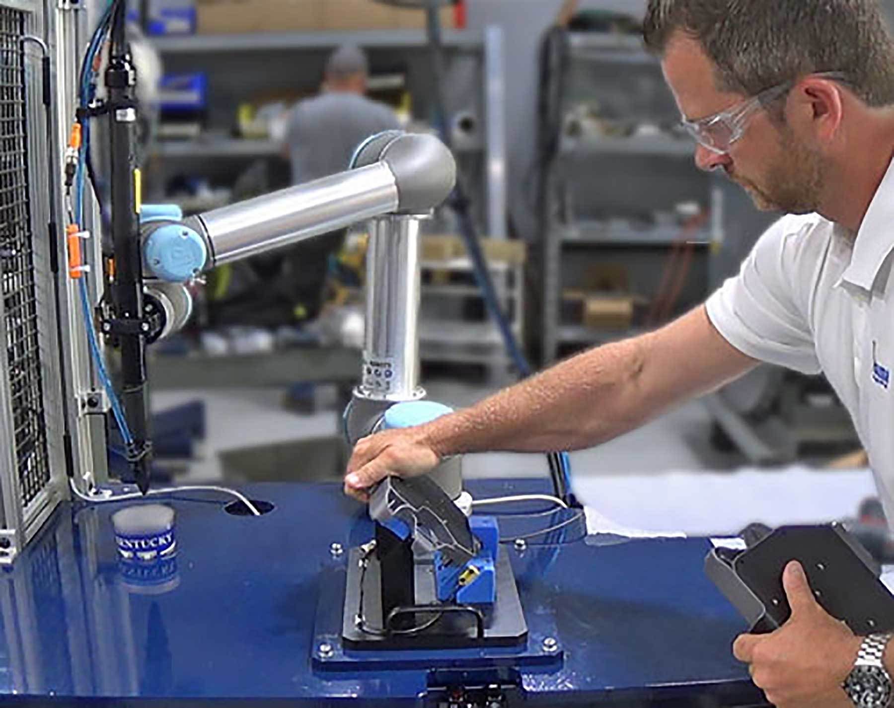

Another company that has developed screwdriver spindles specifically for cobots is OnRobot A/S. Three years ago, it unveiled an out-of-the-box screwdriver and screw feeder that allow small manufacturers to automate a wide range of assembly processes quickly, easily and flexibly. It can be used with ABB, Doosan, Fanuc, UR and Yaskawa robots.
“This provides welcome relief for manufacturers that are eager to automate repetitive, unergonomic and often inconsistent manual screwdriving processes, but who struggle to integrate and program typical piecemeal screwdriving systems,” says Kristian Hulgard, general manager at OnRobot US Inc.
“We’ve designed an automated tool that simplifies a highly complex process for our users, making it cost-effective and easy for manufacturers to see fast results in terms of higher uptime, output, consistency and quality,” explains Hulgard.
“Programming is as easy as entering the appropriate screw length and torque value into the user interface that is integrated into the teach pendant of any leading robot,” claims Hulgard. “With precise torque control and embedded axis, the screwdriver automatically calculates the speed and force required for consistent, accurate screwdriving.”
According to Hulgard, the device can handle a wide range of screw sizes and lengths, from M1.6 to M6, and up to 50 millimeters long. With its easily exchangeable bit system, the screwdriver can be quickly changed over to a different screw size, length or product line in minutes, which minimizes downtime and improves productivity.

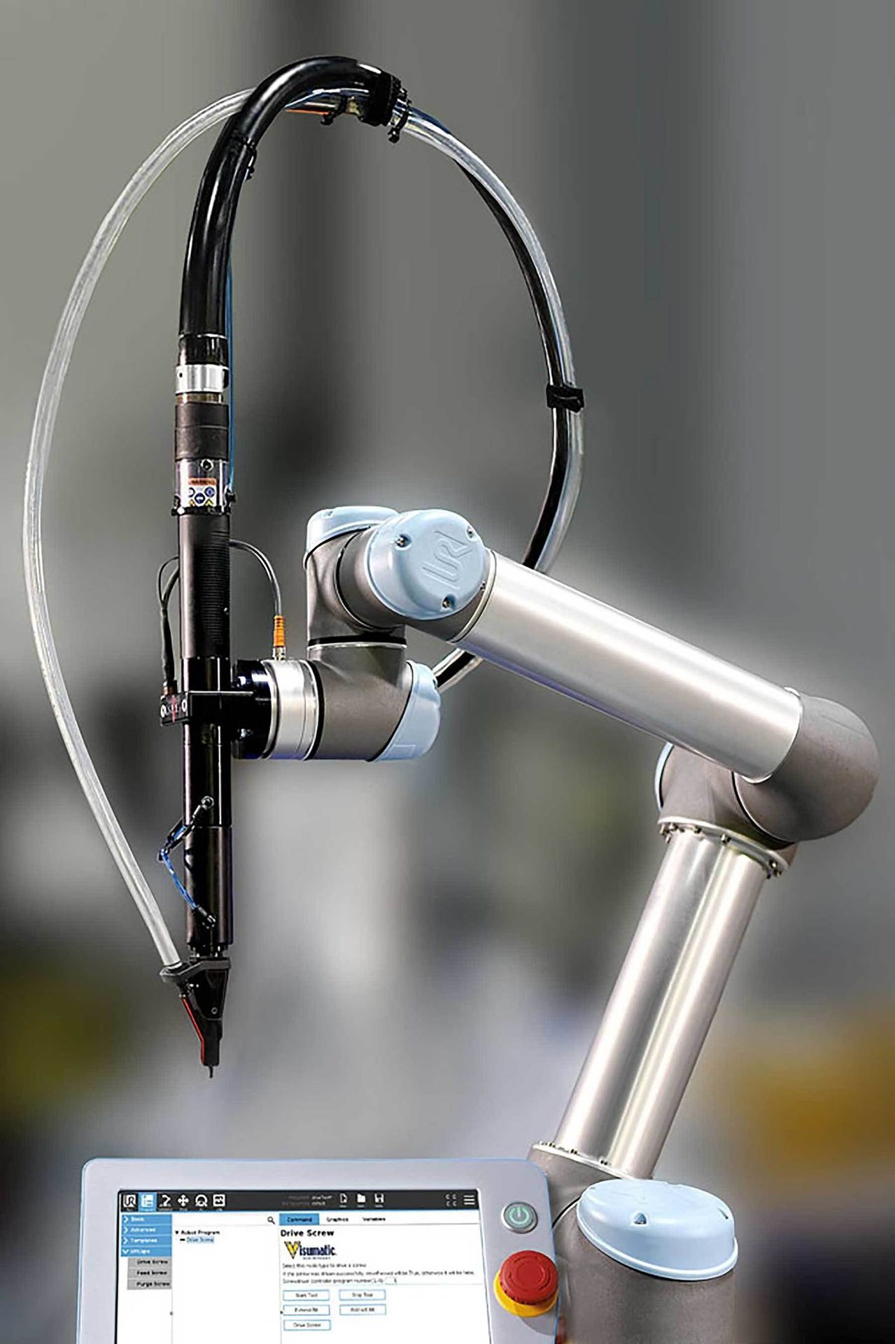

“Screwdriving is a great application for cobots,” says Joe Campbell, senior manager of strategic marketing and applications development at UR, the company that pioneered the technology more than a decade ago. “In fact, it’s one of our most popular applications.
“We currently partner with 12 screwdriver suppliers, ranging from Atlas Copco to Weber,” explains Campbell. “They are part of our UR+ ecosystem, which include software interfaces that seamlessly integrate with our machines.
“All of the programming is done through the UR teach pendant,” Campbell points out. “That has simplified things and removed a lot of risk, especially for smaller manufacturers that may have shied away from automation in the past.”
UR’s entire line of robots are used for screwdriving applications, but most manufacturers prefer either the UR5 or the UR10. In particular, the latter model, which boasts a payload capacity of 27.5 pounds, is popular for driving many sizes and types of screws.
This collaborative system features an automatic screw feeder, drive system and an end-effector that mounts directly to the wrist of a cobot. Photo courtesy Visumatic Industrial Products Inc.

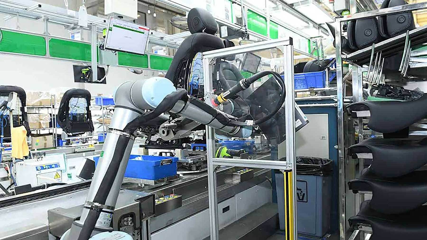

According to Hughes and other observers, automotive final assembly lines will be a growing market for collaborative automation in the near future.
One groundbreaking application involves Stellantis, which has equipped several assembly plants in Europe with cobots that perform various types of nutrunning and screwdriving applications. On one line building electric vehicles, six machines are mounted on a movable fixture. They’re used to automate several assembly tasks that are traditionally performed by humans.
Collaborative screwdriving is currently used by many manufacturers, including Tier One automotive suppliers. Photo courtesy Universal Robots A/S
“It’s an interesting application, because you usually don’t find many robots in this part of the assembly process,” says UR’s Campbell. “We think this is just the beginning of a trend and expect to see more cobots deployed on final trim lines to address various ergonomic issues relating to bending, reaching and awkward postures.
“Because cobots can work in close proximity to humans, workstations often don’t have to be fenced off and totally guarded like in the past,” claims Campbell. “Operators can work side by side with cobots. Humans focus on tasks that are easily accessible, while the machines work on things that are more difficult, such as inserting and driving screws in hard-to-reach areas or confined spaces where fasteners aren’t always visible.”

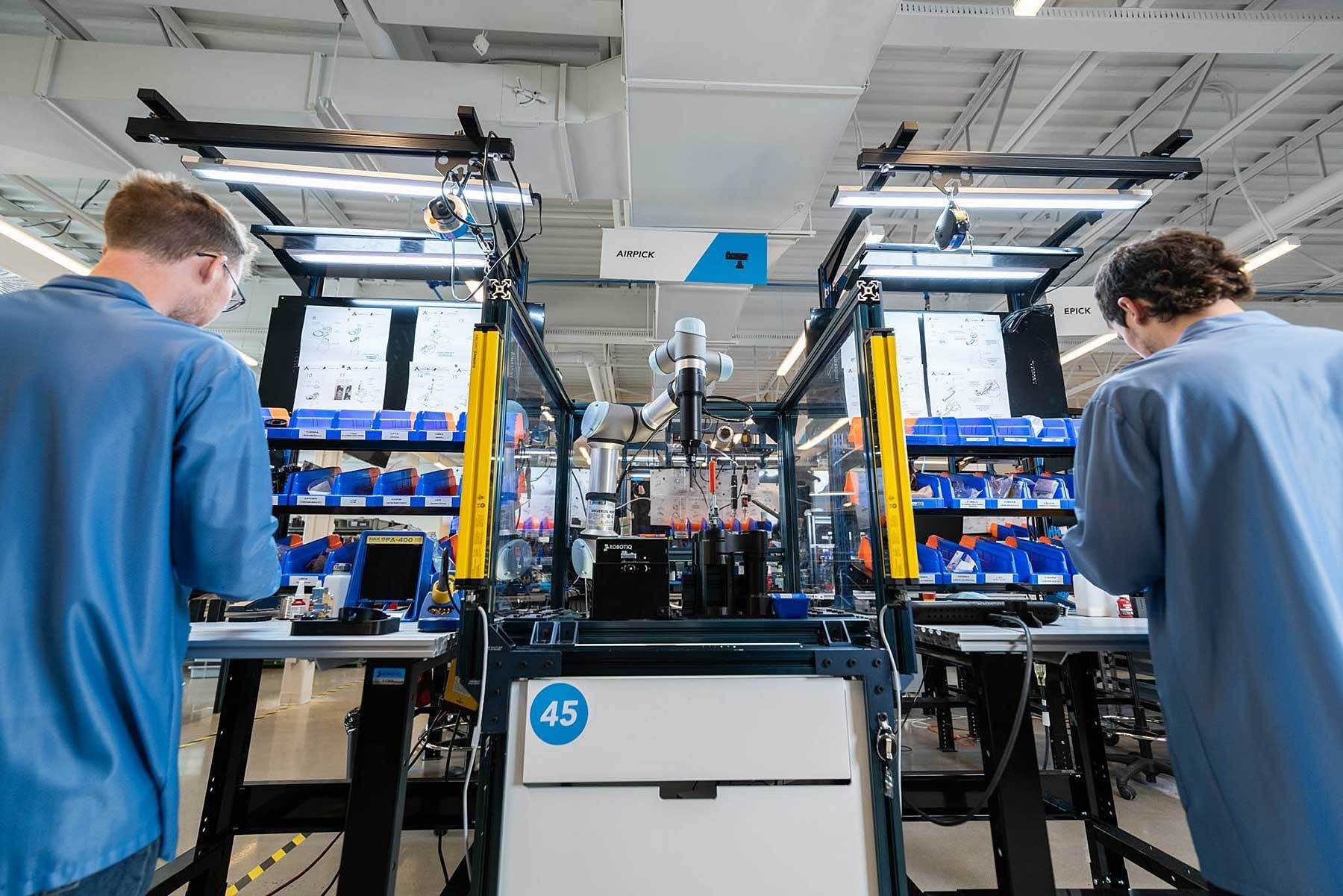

“Most cobot applications currently involve high-mix, low-volume assembly,” adds Don Seay, general manager at ESTIC America Inc. “But, during the rest of this decade, I expect to see more penetration of medium- and high-speed assembly lines.
“In particular, we’ll see a lot more cobots being deployed on automotive assembly lines,” predicts Seay. “In addition to Stallantis, Nissan has been experimenting with the technology in Europe. Torque applications on cobots will be one of the biggest assembly disruptors over the next five years.”
