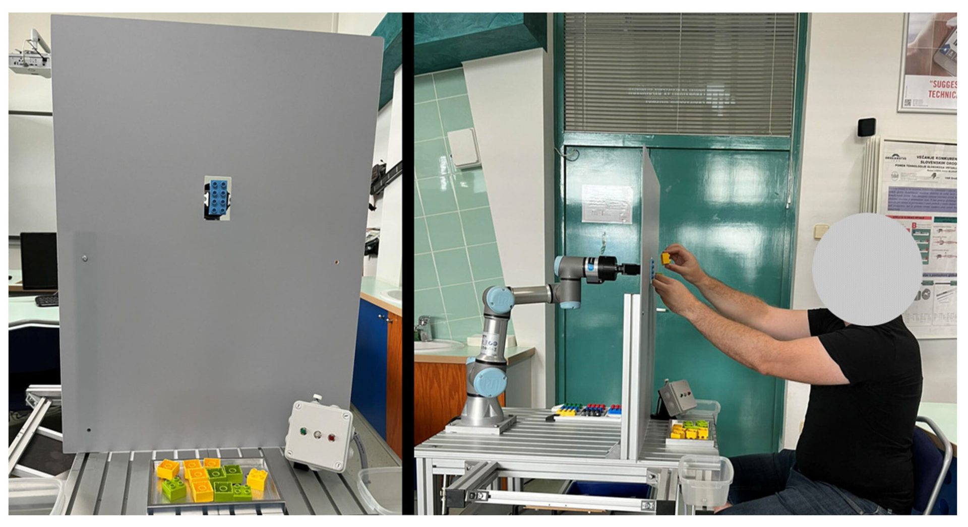

For our study, we created a collaborative workstation in a laboratory environment. The workstation consisted of a UR3e cobot from Universal Robots; a 2F-85 collaborative gripper from Robotiq; a worktable; a switch with green and red signal lights; and a signaling button.
We designed an application in which a person and a cobot work together to assemble a finished product. The finished product consists of two Lego Duplo 2x2 bricks (subassembly 2) and one Lego Duplo 4x2 brick (subassembly 1).

The first scenario consisted of a basic workstation. In the second scenario, we added a barrier to the workstation. The barrier prevented visual contact between the person and the cobot, making it impossible for the person to know the cobot’s movement and speed. By changing the layout and splitting the experiment into two scenarios, we aimed to investigate how the ability to see the movement of the cobot might affect the worker’s efficiency. We defined efficiency as the time needed by a worker to conduct the collaborative assembly operation.

The average assembly time without the barrier was 2.86 seconds. When the barrier was introduced, the average assembly time decreased to 2.74 seconds, a 4.2 percent reduction. From our preliminary results, we can assume that the barrier plays a role in workers’ performance. When workers are unable to track the cobot’s movement and rely less on visual cues, they might focus more intensely on the sound of the cobot’s movements.
The researchers created two experimental scenarios. The first consisted of a basic workstation. In the second, they added a barrier that prevented visual contact between the person and the cobot, making it impossible for the person to know the cobot’s movement and speed. Source: University of Maribor
