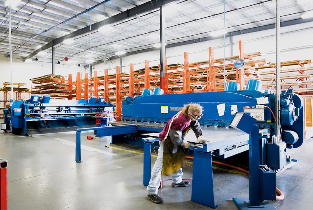

CaptiveAire operates manufacturing plants in North Carolina, Iowa, Oklahoma, California, Pennsylvania and Florida. Photo courtesy CaptiveAire
