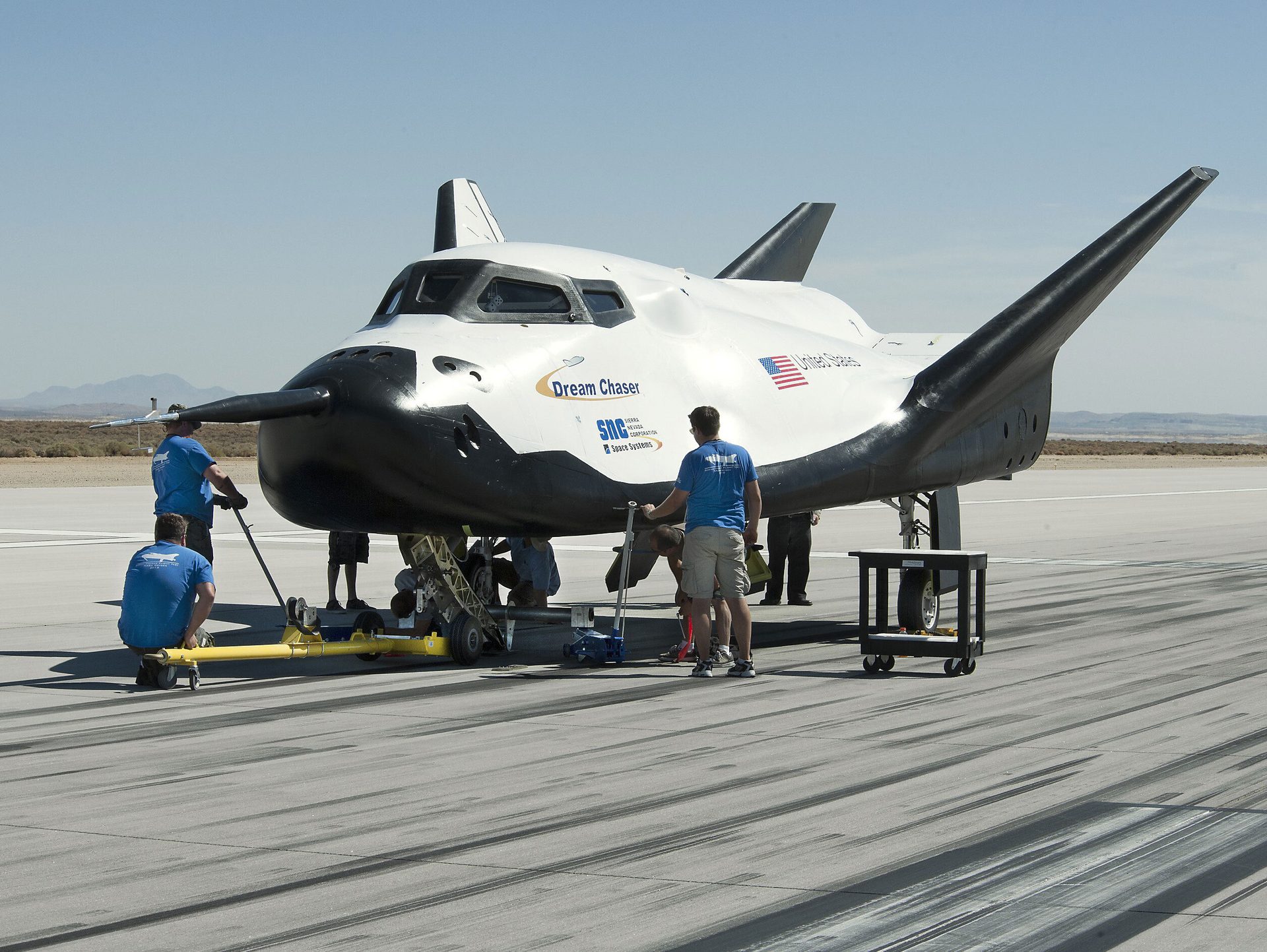

The Dream Chaser is designed deliver up to 5,500 kilograms of cargo to the International Space Station and return safely to Earth. Photo courtesy Sierra Space

Accessing the Dream Chaser
As of Jan. 4, 2024, the International Space Station has been in orbit for 25 years, 1 month and 15 days. The largest space station in history is expected to remain in orbit through January 2031.
Until then, spacecraft from Earth will continue bring cargo and crew to and from the station. One vehicle for doing just that is the Dream Chaser Cargo System under development by Sierra Space, a subsidiary of defense contractor Sierra Nevada Corp. The reusable robotic spacecraft is designed deliver up to 5,500 kilograms of pressurized and unpressurized cargo to the space station—including food, water, supplies and science experiments—and return safely to Earth. (A crewed variant, the Dream Chaser Space System, is set to be produced once the robotic version is operational.)
To build and equip the Dream Chaser, Sierra Space needed custom work platforms that would give technicians unlimited access to the spacecraft, in a restrictive environment, while meeting a host of strict quality and safety requirements. Spika got the job.
The program required a system of platforms to provide access to the cargo module of the Dream Chaser during installation of internal and external details. The platforms had to meet the following requirements:
