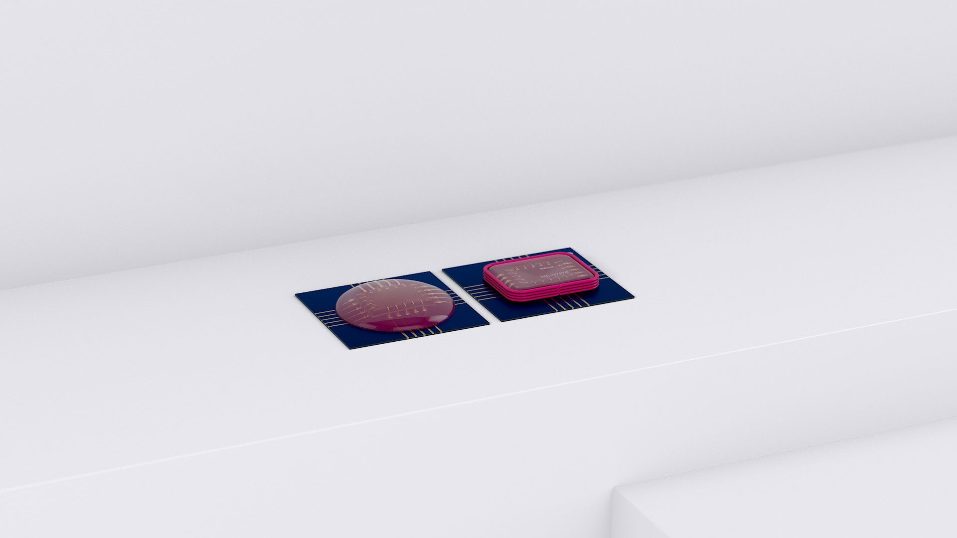

Adhesive bonding plays a crucial role in manufacturing radar sensors. Photo courtesy DELO Industrial Adhesives
Adhesives are crucial for assembling the sensors in advanced driver assistance systems.

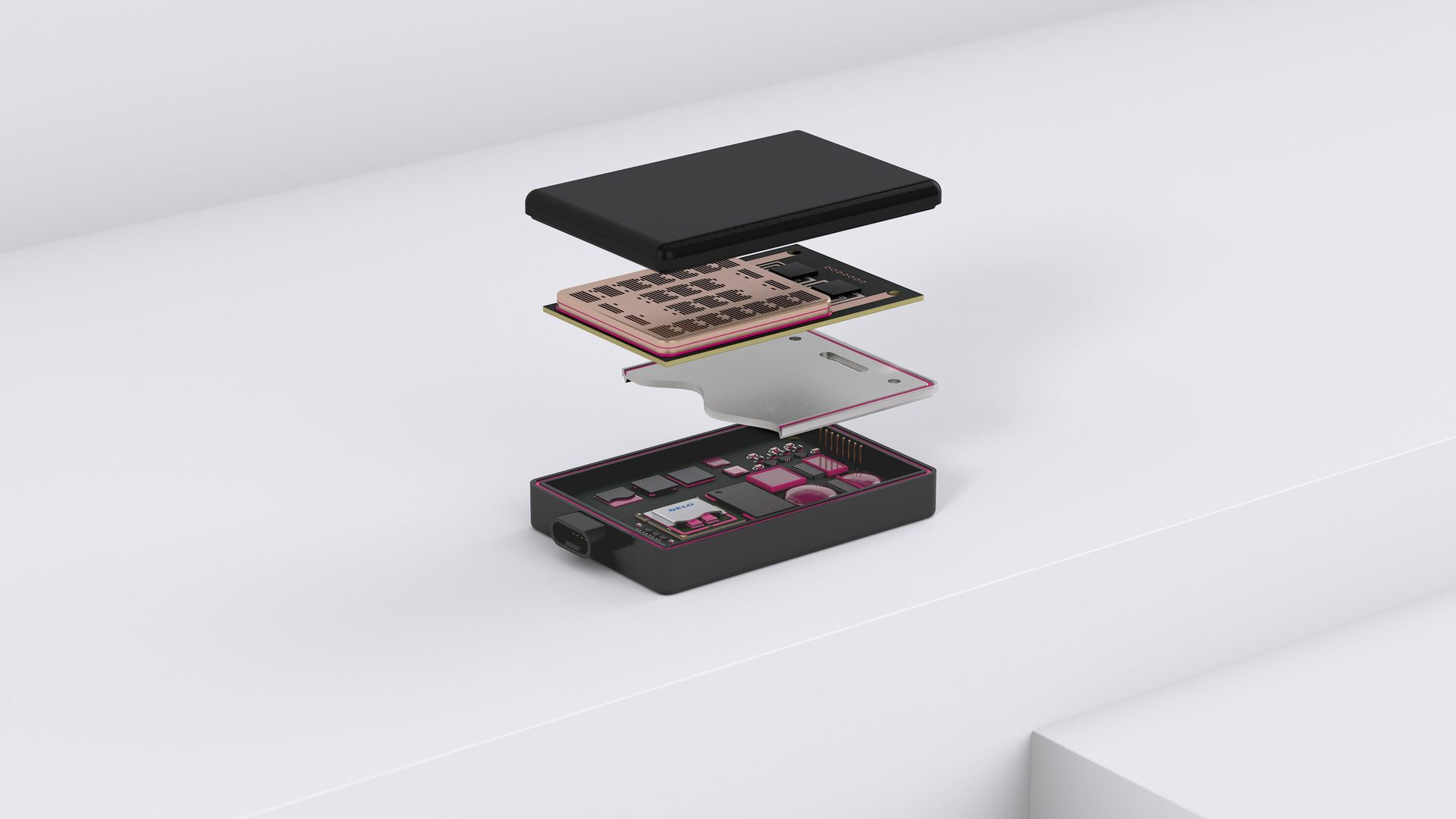

Radar sensors consist of four major parts: the radome, the antenna, the printed circuit board, and the housing. Photo courtesy DELO Industrial Adhesives
Radar sensors consist of four basic components: the radome, the antenna, the printed circuit board (PCB), and the housing. Each of these components often requires more than one bonding process.
Below the radome, antennas are fixed to the PCB with adhesive. Within certain antenna designs, layers can be produced with thin bond lines. These adhesive layers can provide electrical contact or shielding from electromagnetic interference (EMI).
The PCB itself comes with its own functional applications through radar-absorbing or thermally conductive adhesives. Even more bonding tasks come with advanced packaging applications on PCBs, such as encapsulation or pin sealing. The PCB is then bonded inside the housing, and then the housing and radome are bonded to create the final assembly.
Each of these bonding tasks comes with its own adhesive requirements, properties and curing methods for optimal results.
