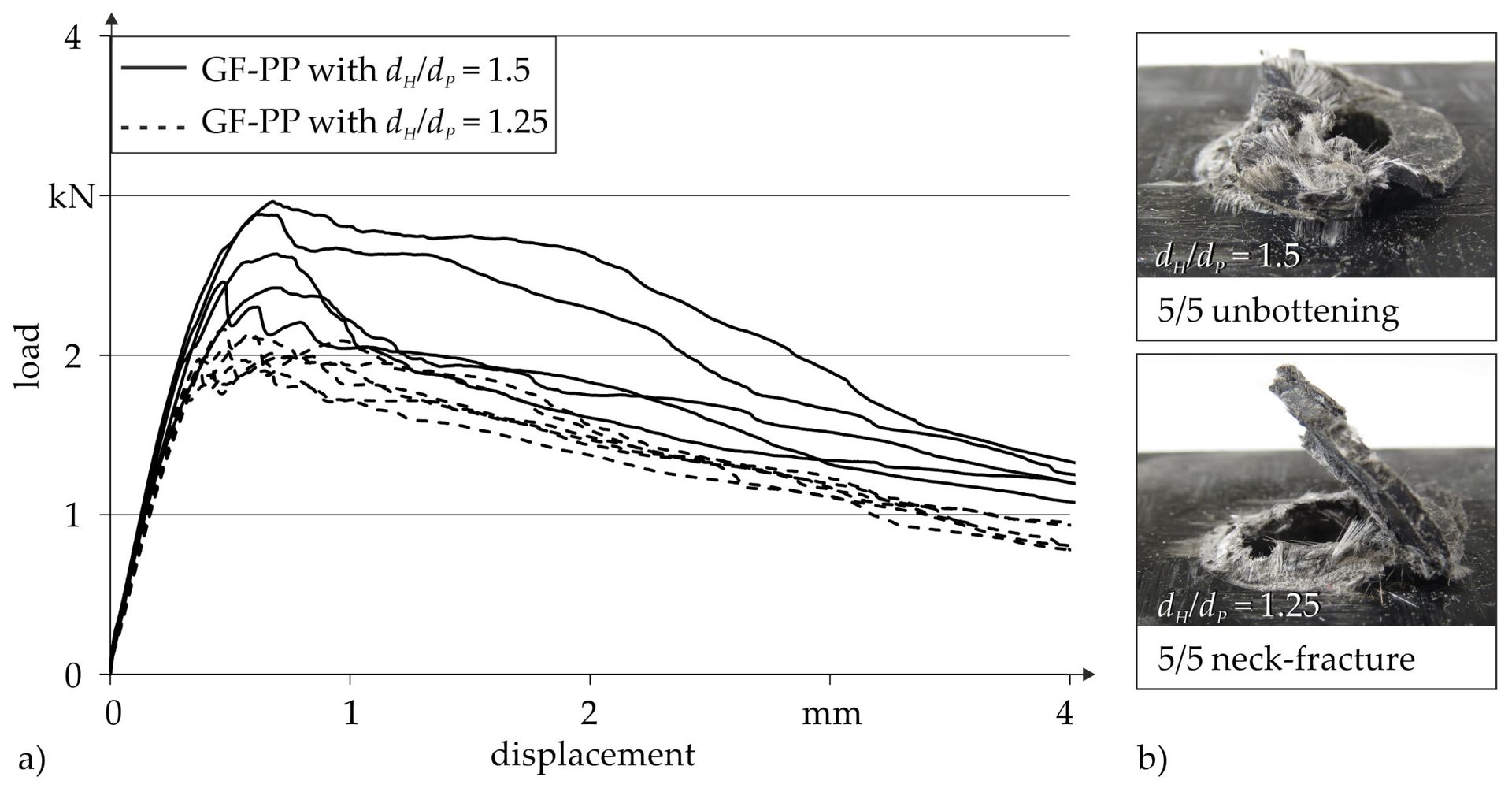

For the thermo-clinching process, the TPC specimens were cut crosswise and heated up to 200 C in the joining zone. The process is performed on a machine specifically for the purpose. The system is equipped with servo-pneumatic force and displacement control and an interchangeable tool set.

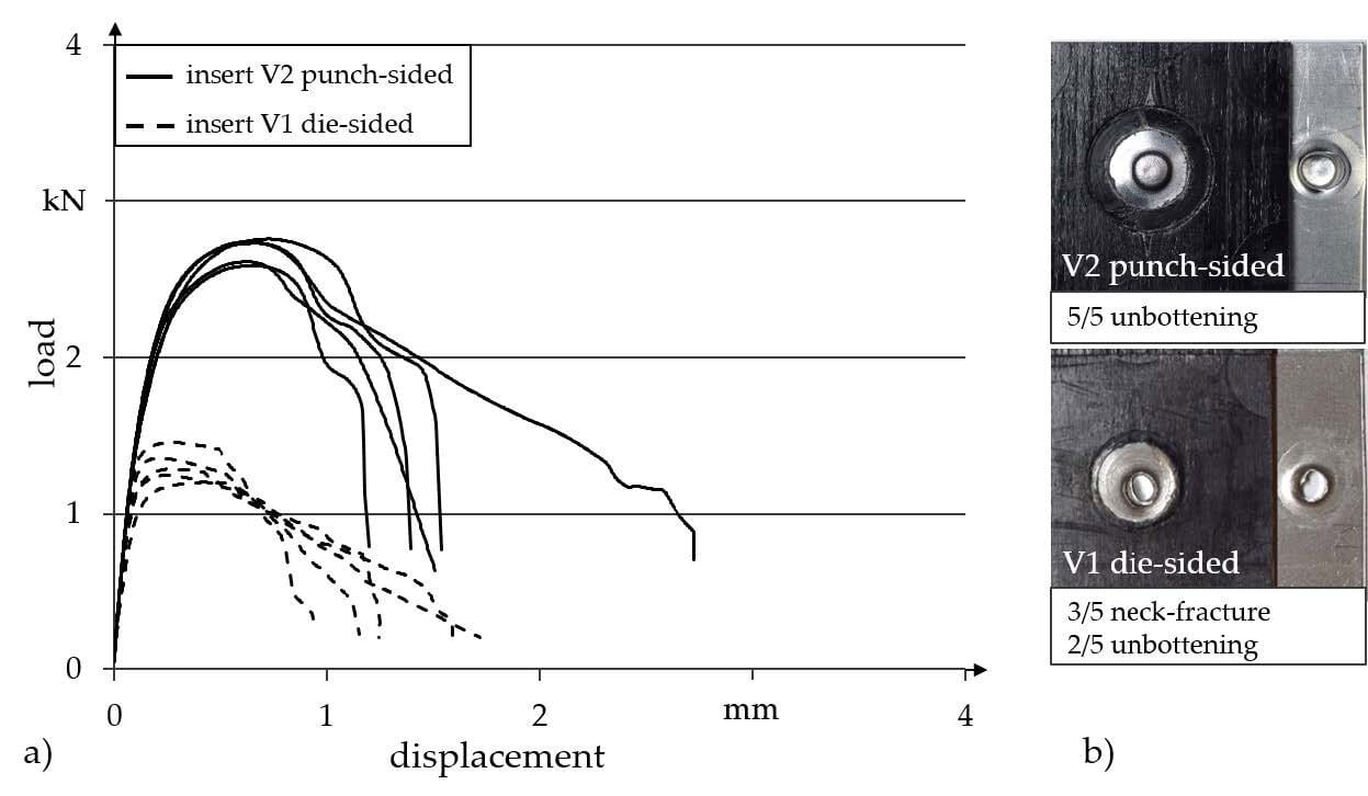

For insert clinching, two types of clinch inserts (V1 and V2) were embedded in the TPC specimens, both rotationally symmetric. The height of the clinch inserts corresponds to the thickness of the TPC. Insert V1 is axially symmetrical, which simplifies feeding. Insert V2 has a larger head diameter on one side, which can be expected to result in higher joint strengths, especially under transverse tensile load.

Micrographic analysis of thermo-clinched joints shows that parts of the textile reinforcement are specifically relocated to the neck and head area of the final joint. This contributes considerably to the load-carrying capacity of the joints.
Through CT analysis, it can be seen that the reorientation of the reinforcing fibers is accompanied by various deformation phenomena. Thus, there is a relocation of the fibers into the form-closed head area, including fiber reorientation both in the thickness direction and the plane direction. As a result, splaying of the roving ends can be observed.
These graphs show the results of single-lap shear tests under quasi-static load for thermo-clinched joints with different pilot hole to pin diameter ratios. Illustration courtesy Technical University of Dresden

For insert clinching, we analyzed the laminate surface of each TPC specimen photographically before clinching. In addition, we did microscopic examinations of cross-sections of clinched joints.
During embedding of the insert, fibers and the plasticized matrix are initially displaced by the pin movement both laterally in the laminate plane and in the thickness direction. The material displaced in the thickness direction is pressed back into the laminate plane afterwards by the counterpunch. A complete filling of the undercut of the clinch insert with reinforcing fibers and matrix can be achieved during the embedding process as a result of the compression by the counterpunch.
This is possible due to the high temperature in the forming process, which leads to high movability of the reinforcing fibers and the thermoplastic matrix. Thus, the embedding process results in a local complex material structure with a homogeneous three-dimensional fiber orientation and locally varying fiber content.

These graphs show the results of single-lap shear tests under quasi-static load for clinch inserts in punch-sided and die-sided orientations. Illustration courtesy Technical University of Dresden

Thermo-clinching can join thick TPC and thin metal sheets. Shear loads of 2.6 kilonewtons for a 1-millimeter thick metal can be achieved. Since the metal part is not deformed in the clinching process, even metals with low ductility, such as ultra-high-strength steels, can be joined.
Since both sheets require local preparation steps, the sheets must be positioned relative to each other with high accuracy.

Insert clinching shows comparatively high shear loads with metal sheets as thick as 1.5 millimeters. The main advantage of this process is the use of conventional clinching tools. This allows the integration of composites into existing assembly lines without modification of the joining tools or process chains. The process is more suitable for thin TPC sheets (less than 3 millimeters, since thicker clinch inserts are difficult to join without extending the tool geometries.
Clinchability is not limited by the properties of the TPC. In principal, all common clinchable metal-to-metal combinations can be joined.
In contrast to the other clinching methods, both joining directions are applicable. Compared to hot-clinching, insert clinching requires greater positioning accuracy with the parts. The TPC sheet and metal sheet do not have to be positioned exactly in relation to each other, but the clinching tool must hit the position of the clinch insert precisely.
