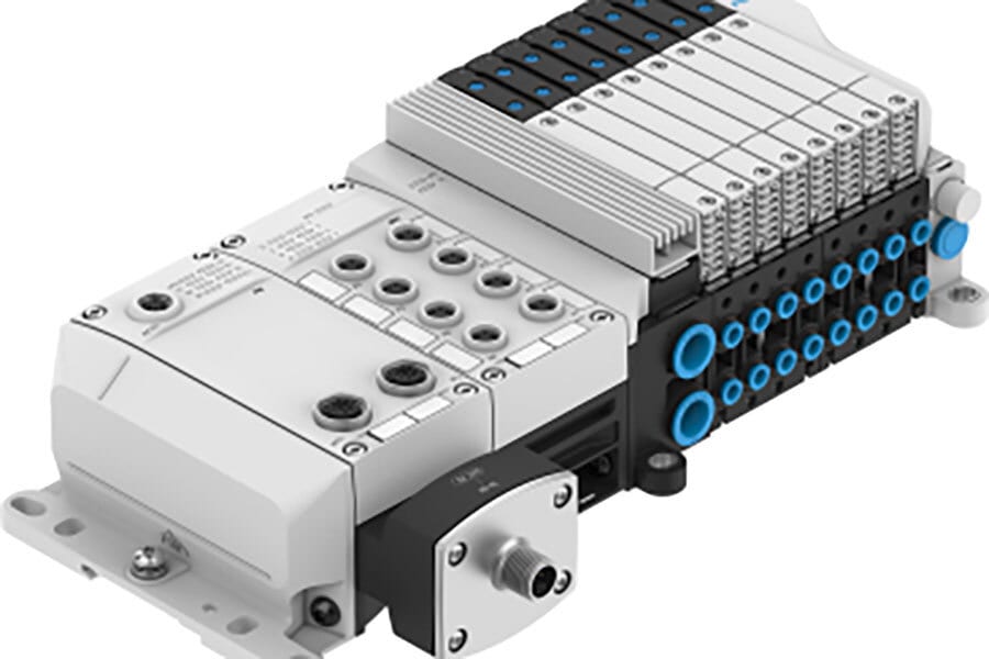

A white and black industrial modular pneumatic manifold with blue ports and electrical connectors.
Modular Pneumatic Valve Platform with AP Communication
TThe VTUX consolidates the advantages and functions of three classic valve terminals into one: the CPV, MPA-L/S and VTUG. In addition, the AP-I and AP-A communication system enables open architectures and the integration of electrical and pneumatic automation. The remote I/O system CPX-AP-A with IP65/67 protection enables real-time communication via Ethernet-based fieldbus. The lightweight design of the VTUX allows it to be used on the front-end unit, a gantry or robot arm. This enables short and efficient compressed air lines.
Festo Corp.
www.festo.com

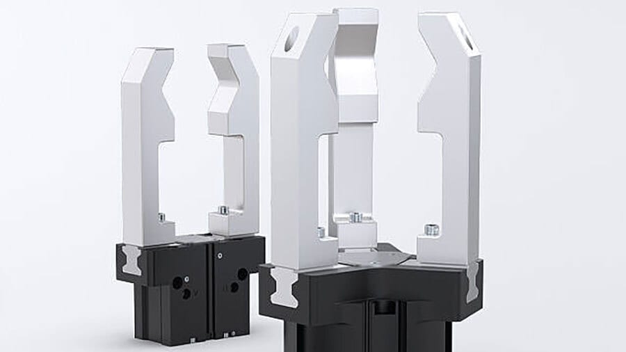

Robotic grippers: one 2-finger, one 3-finger, silver and black.
Compact Pneumatic Grippers with Extended Stroke Options
Zimmer Group has expanded its GPD5000AL and GPP5000AL gripper series with new sizes. The new GPP5025AL size for two-jaw parallel grippers and the new GPD5016AL three-jaw centric gripper fill existing gaps in the size range. These pneumatic grippers use aluminum profile groove guides to provide precise, stable motion with low wear. Long-stroke variants in the GPP5000AL series deliver up to 60 percent greater stroke at the same size, allowing for larger gripping ranges while reducing overall gripper size and weight.
Zimmer Group
www.zimmer-group.com
