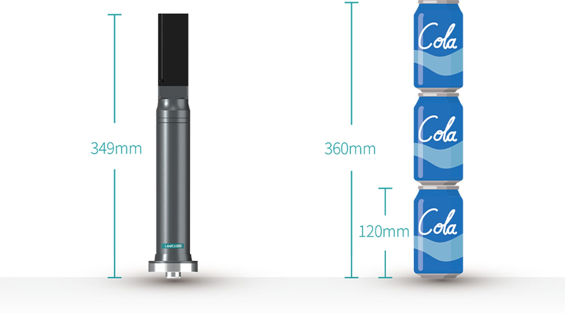

349mm cylindrical object beside three 120mm cola cans, totaling 360mm when stacked.
Small and lightweight, the PLP precision servo press is ideal for integrating with robots. Photo courtesy Leetx

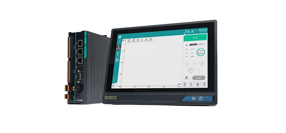

PLC and HMI touch panel display for industrial automation.
The control system for the servo press gives engineers precise control of force, displacement and ram speed. Photo courtesy Leetx

A small, lightweight model, the PLP precision servo press, is ideal for integrating with robots. It can control force to within 0.5 percent of the set value and is suitable for micro-force press-fitting applications. The same height as three cans of soda, the press comes in two versions: one with a maximum force of 200 newtons and a maximum stroke of 100 millimeters, and the other with a maximum force of 500 newtons and a maximum stroke of 200 millimeters. Maximum ram speed is 200 millimeters per second.
