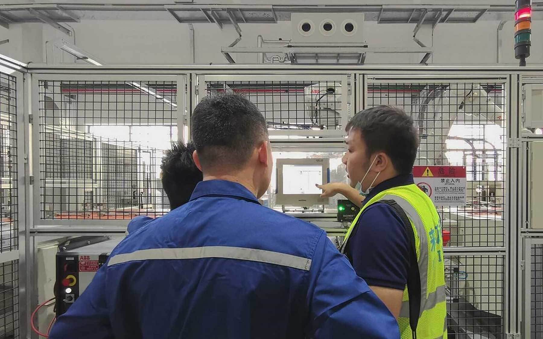

Liu shows his colleagues at Yuchai how to handle the maXYmos NC process monitoring system. Photo courtesy Kistler Instrument Corp.

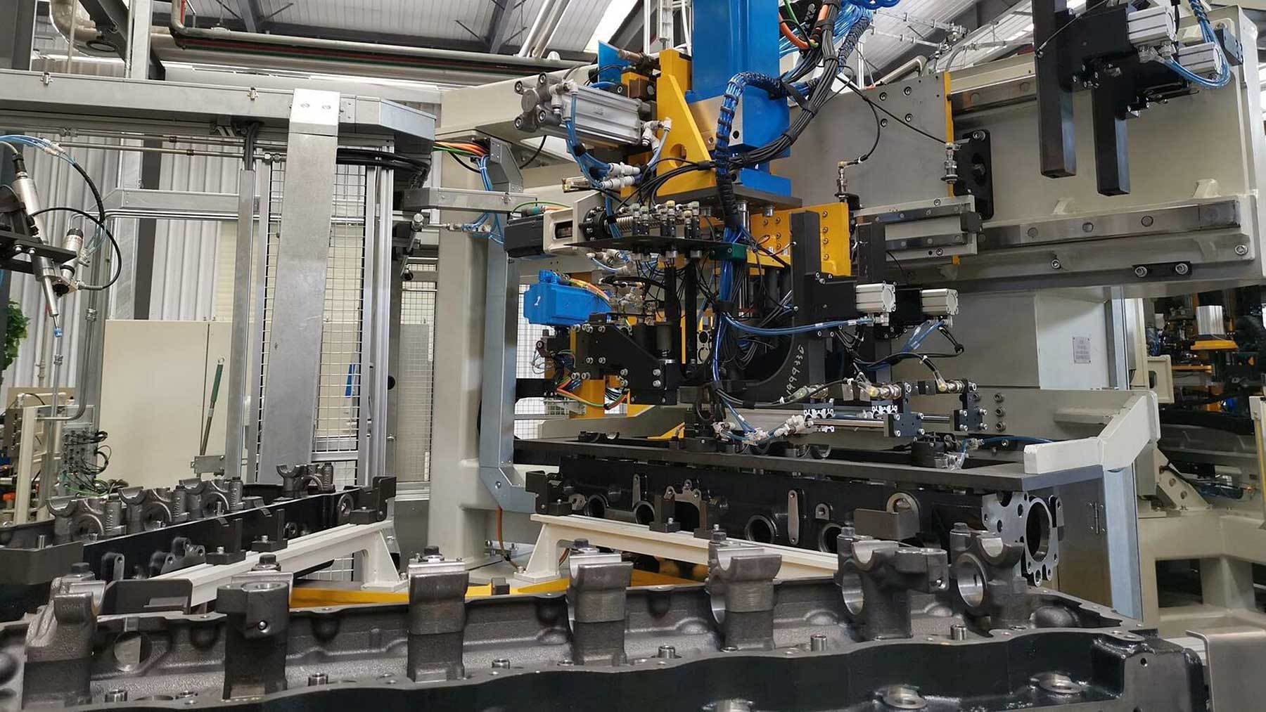

Numerous NCFN and NCFH modules from Kistler are deployed for joining processes at several stations on both lines. They are used to assemble components such as steel balls, valve seats and guides, seals, intake hoppers and outlet openings. Press-fit assembly of engine components is now done entirely with force-displacement monitoring.

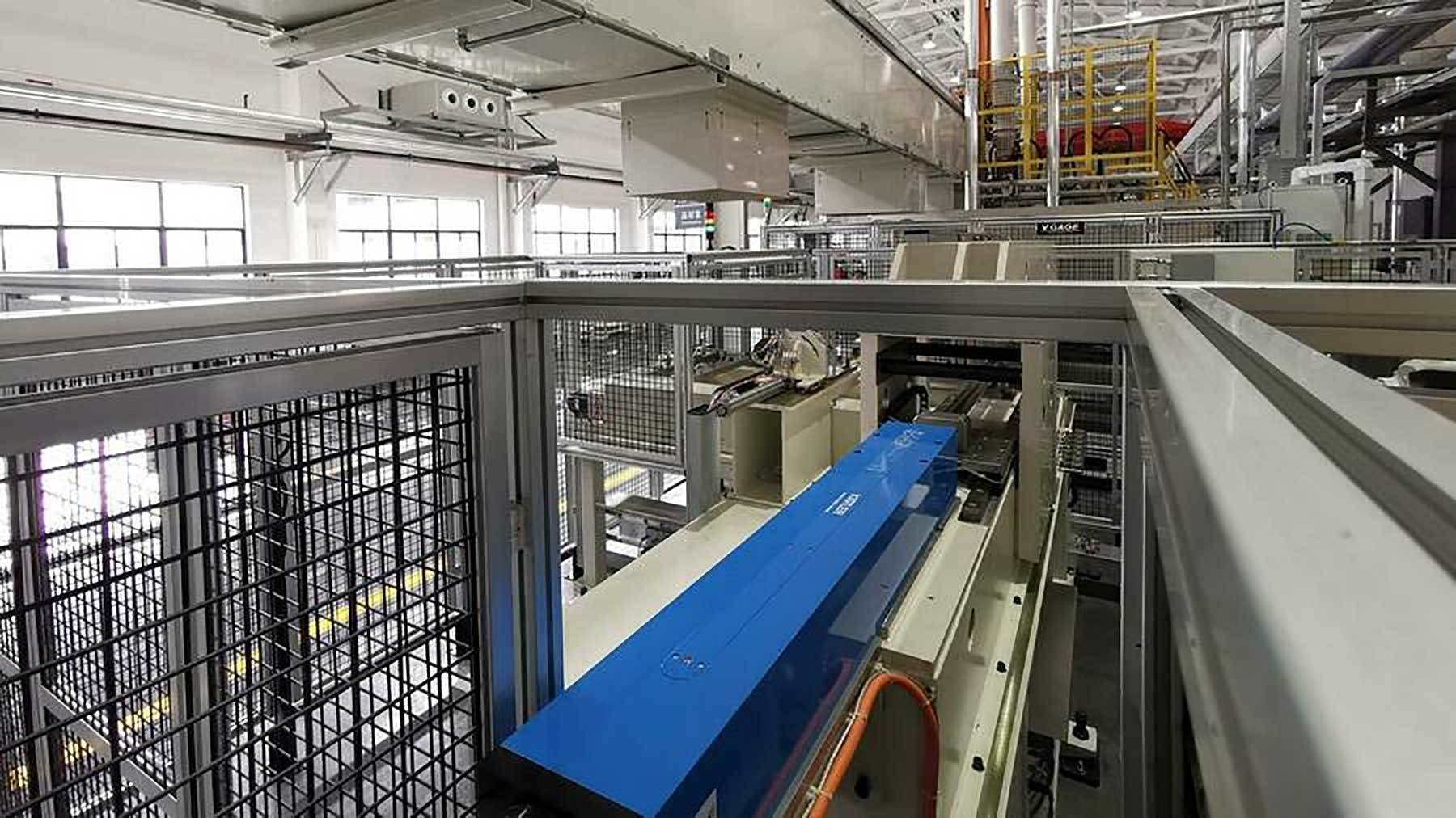

Besides standard press modules, Kistler also supplied Yuchai with a custom joining module that no other Chinese engine manufacturer has. This variant of the NCFN module has an extra-long stroke: 1,000 millimeters vs. the standard length of 400 millimeters.
“Thanks to this tailor-made solution, we’ve been able to sustainably optimize our production,” says Mr. Liu. “Kistler has demonstrated outstanding flexibility and technical understanding throughout the process. Systems from Kistler are simple to operate, and they’re highly reliable.”
