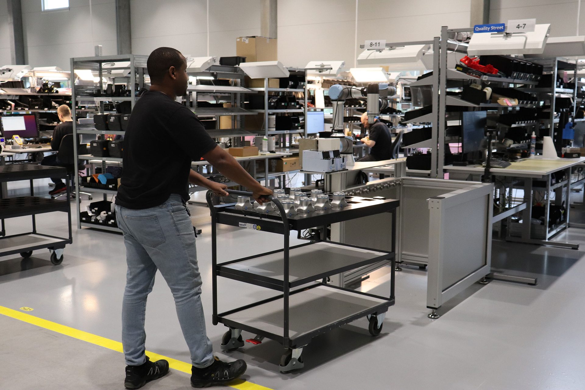

OnRobot incorporated rolling tables into the cell. This allowed the operators to conveniently place products into fixtures and transport them from their workstations to the cobot cell. Photo courtesy OnRobot
The application cell is equipped with an OnRobot screwdriver, two screwfeeders for handling precoated M3 and M6 screws, product fixtures, rolling tables and Universal Robots’ UR5e cobot arm.
Seamlessly integrating this cell into the company’s production line was critical. OnRobot needed a user-friendly cell station that can operate in close proximity to assemblers, ensuring easy and safe interaction. So, OnRobot incorporated rolling tables into the cell, which allowed operators to conveniently place products into fixtures and transport them from their workstations to the cobot cell.
