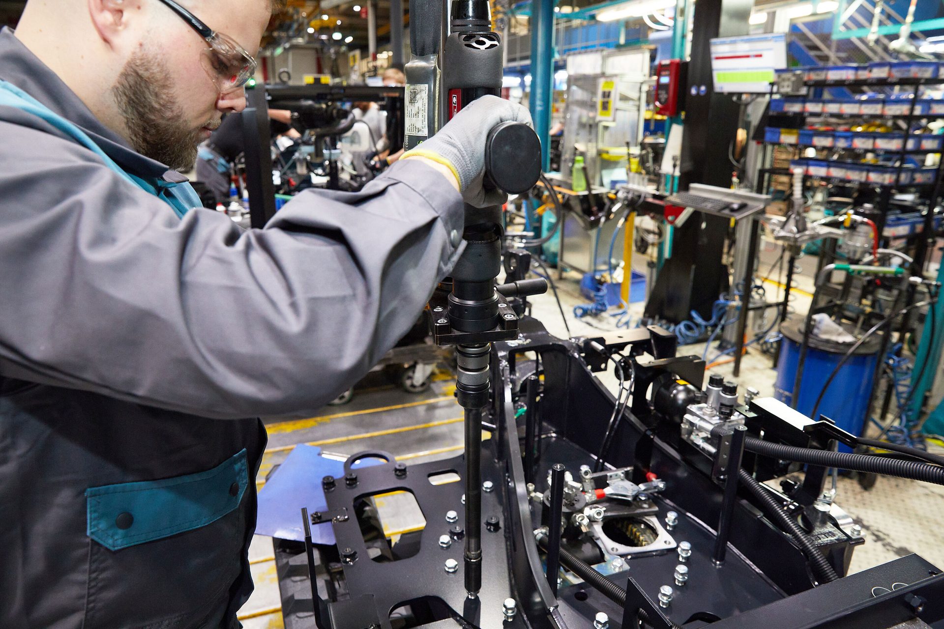

“The most beautiful screwdriving point in our factory is the slewing ring screw connection,” says Weber. “This joint is used to connect the undercarriage and upper carriage.”
An electronically controlled screwdriver from Desoutter Industrial Tools is used to fasten this joint. The tool is attached to a cantilever arm with a radius of more than 3 meters. An assembler installs 20 screws on the slewing ring at a torque of around 300 newton-meters. The “zero-gravity” arm carries the weight of the tool and absorbs the high reaction torque that occurs during screwdriving. The tool is fixed in a holding device and can be easily moved in space despite the large moving masses. The assembler only needs to position the tool at each screwdriving point and press the start switch. The screw connections are ergonomic, safe, reliable and traceable.

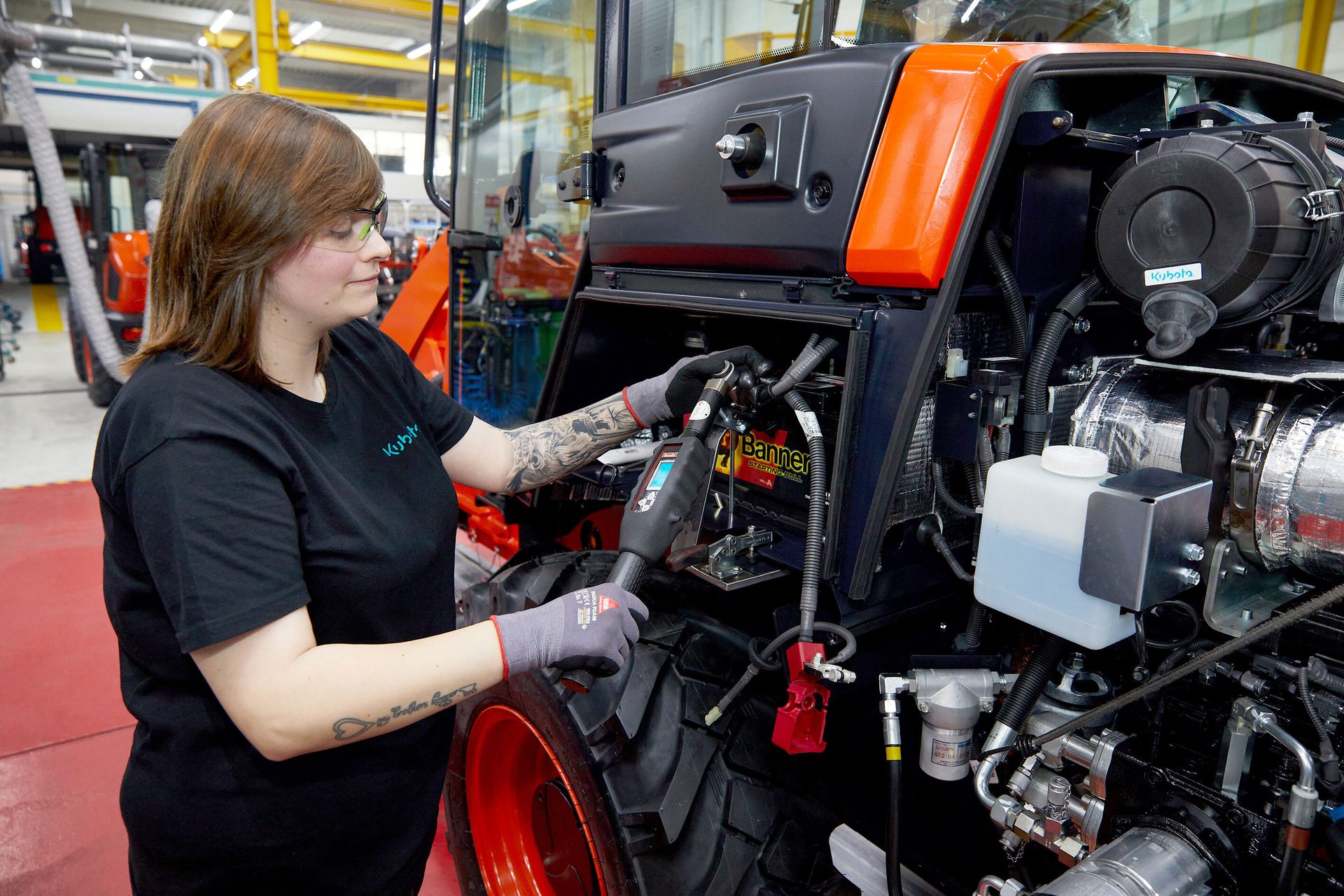

The ground screw on the engine main switch is tightened with a digital torque wrench. Here, the screw must be tightened to 8.8 to 11.8 newton-meters. Photo courtesy Desoutter Industrial Tools

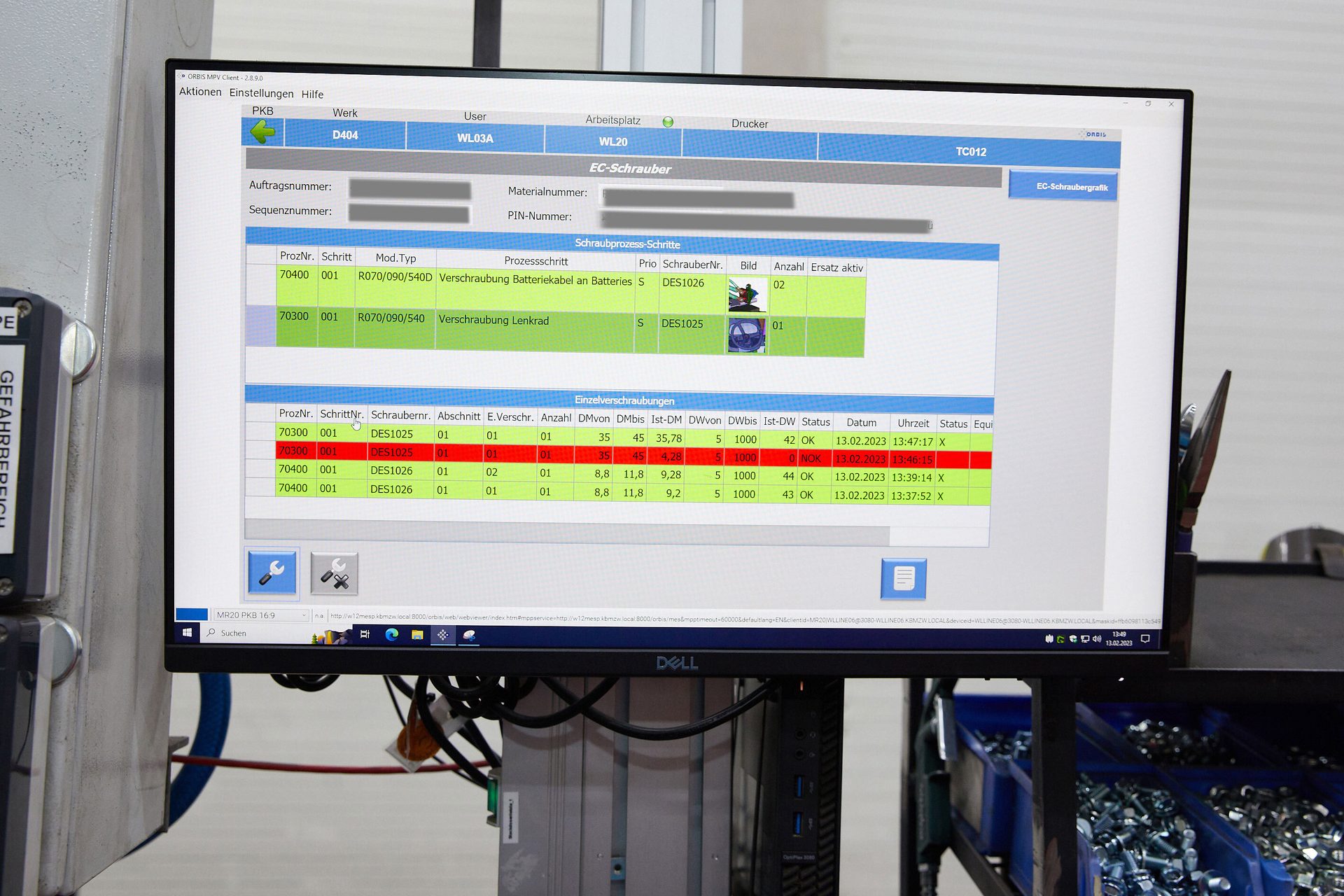

The quality control screen shows employees in real time whether a screw connection was OK (green background) or not (red background). The software immediately detects many errors, such as forgotten or incorrectly placed screws, so that the worker can correct them during the process. If this is not possible, a quality assurance employee is called out to solve the problem. Photo courtesy Desoutter Industrial Tools

Communication between the systems looks like this: At all stations where controlled electric or cordless screwdrivers or torque wrenches are used, the MES client from SAP consulting firm Orbis SE is used. More than two dozen Desoutter tools are included in the system.
The interface and functions were defined by Kubota and programmed by Orbis. Assemblers on the line see a stripped-down MES surface. For each component or task, they scan a bar code on the routing card that comes with the machine. The scanning process triggers a message to the MES system, whose software, in turn, addresses the screwdriver control. It also reports the target values to the screwdriver via Open Protocol and plays the data back to the MES after screwdriving.
The MES software monitors the number of screw connections required for the task. Torque, angle and various tolerance ranges are monitored by the Desoutter controller. All values are displayed on the MES interface of the monitor. The worker receives feedback firstly through the vibration of the Q-Shield torque wrench, secondly via the monitor above his workstation, and thirdly on the key’s display. If everything is OK, a line on the monitor will be highlighted in green. In the event of errors, a red warning message indicates that corrections need to be made.
Only if the screw connection is “OK” will the task be logged off from the MES system. If it wasn’t OK, the employee must call in someone from quality assurance who can initiate a restart or solve the problem in another way.
“We save all screwdriving results in our MES system and document them at machine level in the SAP system,” explains Weber. “Here, they are permanently assigned to the respective screwdriving locations as well as to the individual wheel loaders and excavators.”

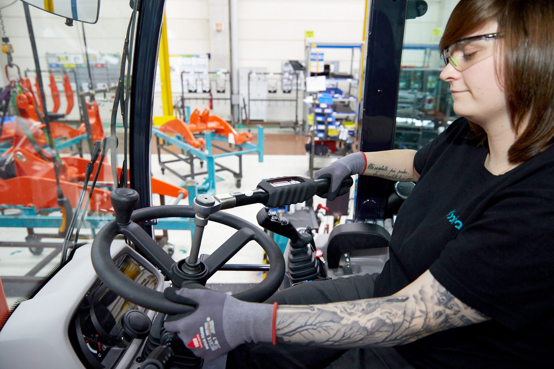

An assembler installs the steering wheel on a wheel loader. Photo courtesy Desoutter Industrial Tools

Another interesting screw connection is the steering wheel nut on the wheel loader. This is tightened to 40 newton-meters (± 5 newton-meters) using a shorter Q-Shield torque wrench. The ground screw connection on the engine main switch, with which the battery can be disconnected, is also made with the torque wrench. Here, the screw must be tightened from 8.8 to 11.8 newton-meters. Both screw connections are safety-relevant, just like numerous hydraulic screw connections on construction machines.
The screws on an excavator’s slewing ring are tightened to a torque of 300 newton-meters. Photo courtesy Desoutter Industrial Tools

In addition, Kubota has four high-torque corded wrenches in operation. They are used to work on the slewing ring and on the underside of the vehicle. The torques at these screw points are between 100 and 300 newton-meters. All tools are electronically controlled. The corded tools exchange their data with the CVI3 control from Desoutter, while the battery-powered tools are connected to a Connect. This small control unit acts as a communication center for the entire data flow and is deliberately located a little further away from the line. No separate screwdriver controls are necessary at the workstations for the wireless tools. Several screwdrivers can be connected to one Connect. However, almost every assembly workstation has a PC with a screen that is also used for other processes.
