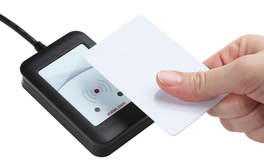

Machine authentication is a cornerstone of endpoint security in the smart factory. Strong authentication technology ensures that only authorized, trained operators can access controls for production machinery and allows companies to track exactly who has accessed each machine and at what times. The right machine authentication solution can also reduce the risk of remote hacking.
Many manufacturers still rely on password or PIN systems for machine access. However, passwords and PINs are often shared or forgotten. They can also be hacked.
Radio-frequency identification (RFID) offers a more secure alternative to a password or PIN for machine authentication. Users present a physical badge or token to unlock access to the machine. This can also be accomplished via a mobile credential on a smartphone using near-field communication (NFC) or Bluetooth low energy (BLE).
An RFID or mobile solution for machine authentication increases machine security in several ways. First, these systems are highly secure and difficult to clone or hack when appropriate encryption is used. Physical badges, tokens or phones are also less likely to be shared than a password or PIN. In addition, the user must be physically present at the machine with the badge, token or device in hand to unlock access, reducing the risk that the machine can be inappropriately accessed via remote hacking or password theft.
For higher security, RFID and mobile access solutions can be implemented as part of a multifactor authentication process using a secondary password or biometric system.
Finally, loss or theft of a physical badge, token or device is likely to be noticed immediately, unlike a compromised password. IT can quickly and easily shut off authorization if a card is lost or stolen or an employee leaves the company.

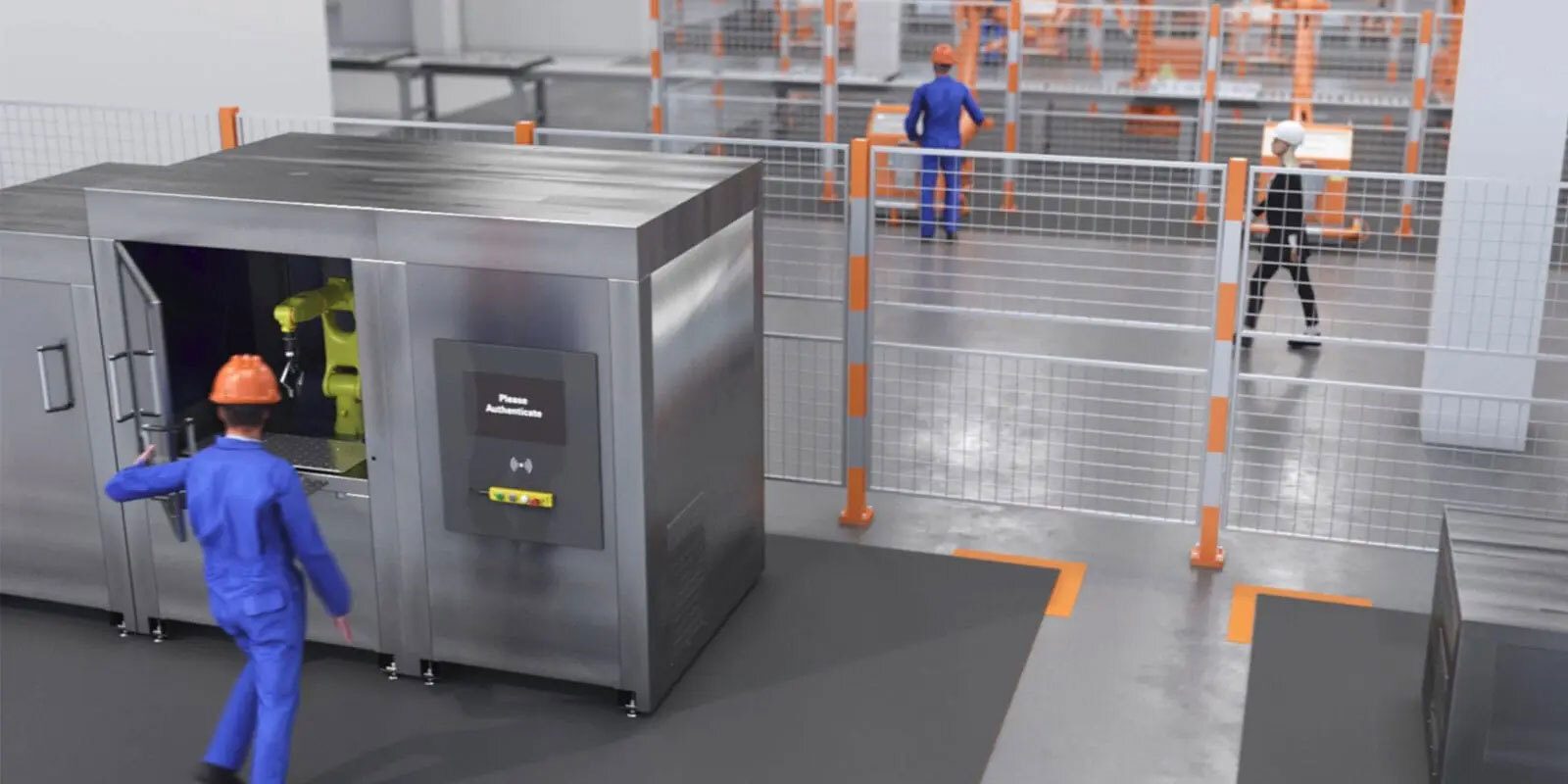

Endpoint security must be considered in the context of the total security concept, including physical security. Physical access control (PAC) enhances endpoint security by limiting who can enter the production floor or have physical access to production lines and machines.
This is important because many industrial espionage cases are inside jobs. Limiting physical access to production areas and machinery prevents bad actors from tampering with or disabling access hardware (such as RFID readers), plugging unauthorized devices into a machine (such as a USB drive carrying a virus), or damaging the machine. The PAC solution should go beyond the front door to enable monitoring of employee movements through production areas. In the case of a security or cybersecurity incident arising from the inside, it can be crucial to know precisely who has been in each production area and accessed each machine and at what times.

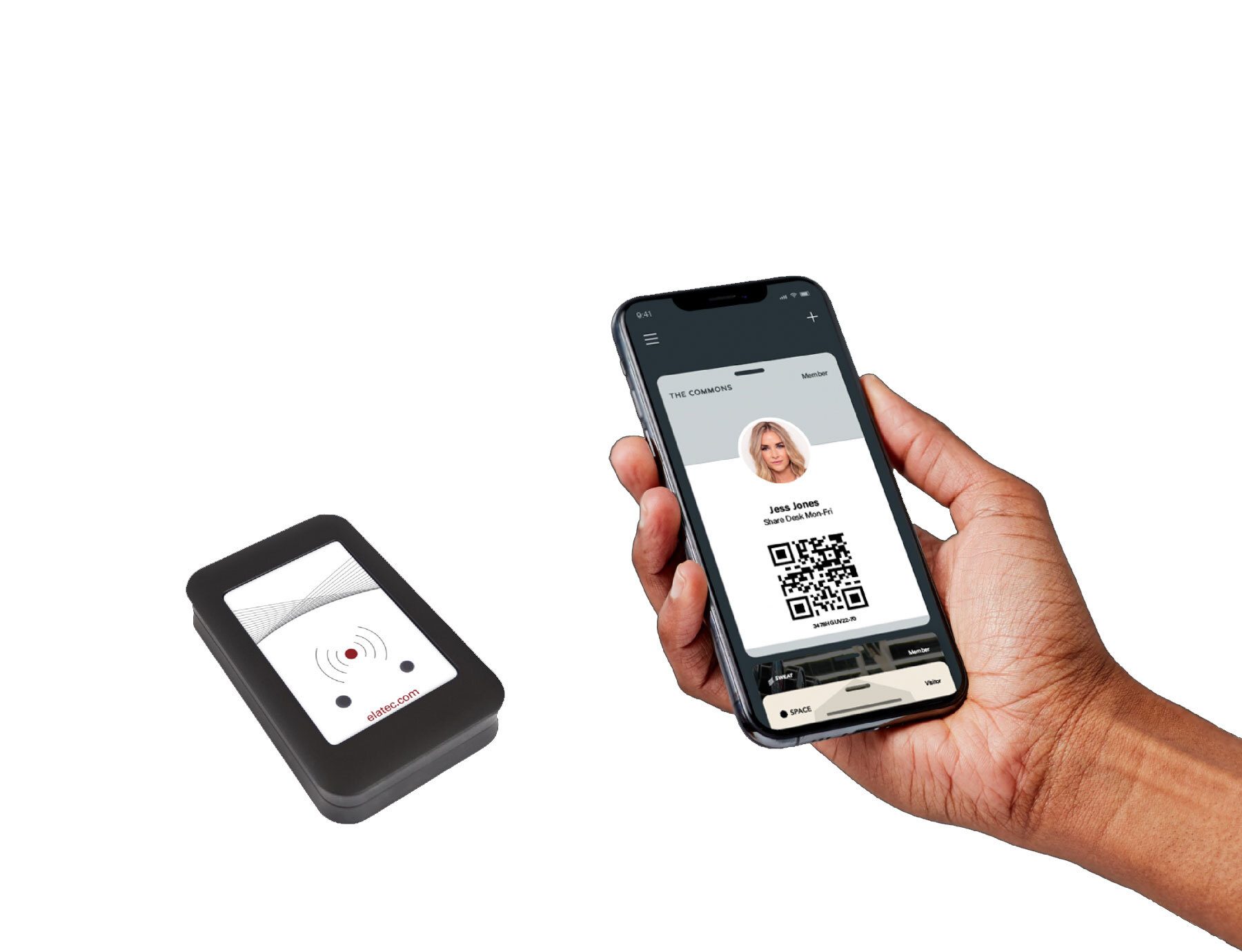

NFC is usually preferred over BLE for facilities supporting smartphone authentication use. NFC credentialing mimics an HF RFID signal on the same 13.56 MHz band. Compared to BLE, NFC has a much shorter read range (a few centimeters vs. up to 100 meters), which ensures users are in close proximity to the machine or device they are unlocking. The short read range prevents others from piggybacking on the proximity of users who are in the vicinity but not actively using the machine. It also reduces signal eavesdropping risks. NFC supports strong encryption, just like HF RFID. A universal reader, such as those available from ELATEC, enables manufacturers to support smartphone credentialing, LF or HF RFID, and even newer interoperable and open standard credentials, such as LEAF or those based on public key infrastructure (PKI), providing maximum flexibility.
For even higher security, consider adding two-factor authentication. This can be accomplished, for example, by requiring both a password and an RFID token to log into the machine. Smartphone credentialing allows for an additional layer of security through the device itself; biometrics (facial or fingerprint recognition) can be turned on for the phone, ensuring that only the phone owner can open the credentialing app.
