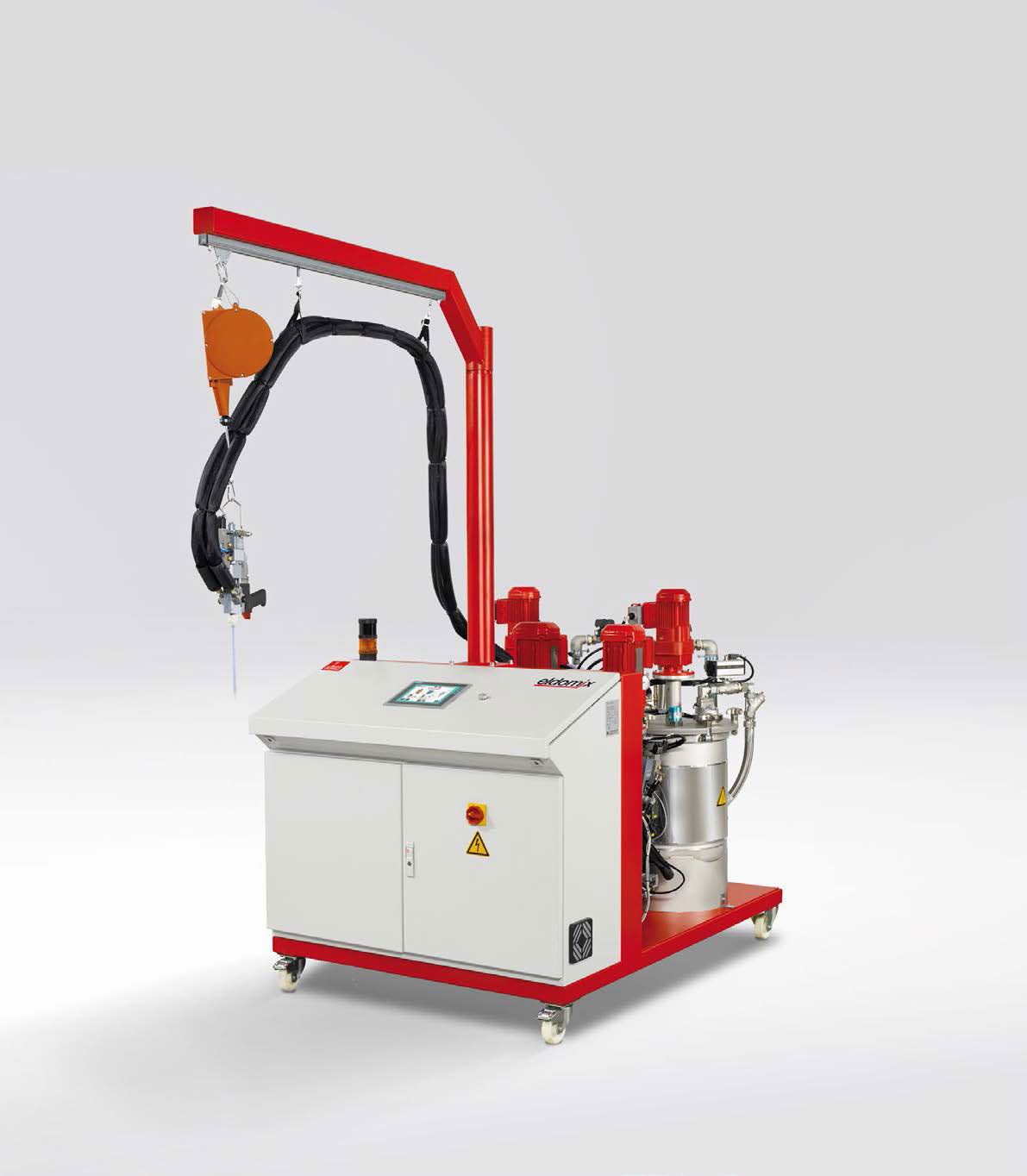

Meter, Mix and Dispense System
Machine
Eldomix is a programmable system for metering, mixing and dispensing two-component adhesives.
Pressure vessels supply the materials to a pair of three-phase, asynchronous, motor-driven gear pumps, where they are proportioned at the preselected ratio. Each gear pump is protected against over-pressure. The machine is fitted with a metering computer with touch-screen terminal and a static mixing system that includes a two-component valve combined with a disposable static mixer.
The mix ratio and output rate are programmable. It can dispense shots or continuous flow.
Eldomix 100 is a benchtop model; Eldomix 600 is a mobile system on castors.
