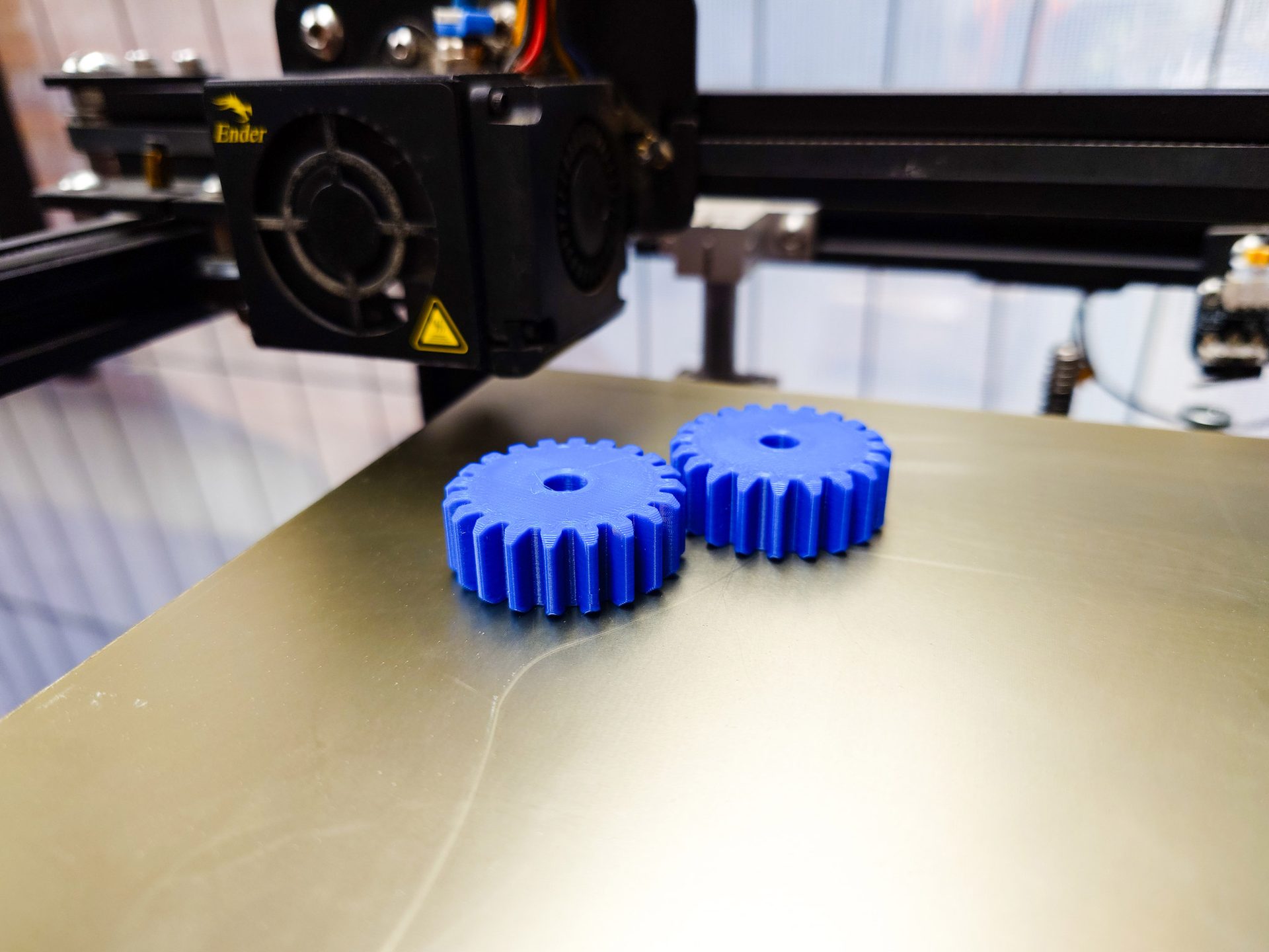

Measuring backlash with precision is essential for diagnosing and correcting issues. Photo courtesy Accu
How to Check if a Gear has Backlash
Determining if a gear has backlash is crucial for maintaining the efficiency and longevity of gear systems. This process identifies the presence of backlash without making precise measurements.
There are numerous ways to check for backlash. First, it can be done via a thorough visual inspection of the gear setup. Engineers should check for signs of spacing between the mating gear teeth when the system is at rest. Although this method doesn’t quantify backlash, visible gaps can indicate its presence, suggesting a closer examination.
Another method is to manually test the gear system by gently rotating or rocking the gear assembly by hand. This method relies on sensing the play or movement between the gears before the opposite teeth make contact. This is a simple way to feel for any looseness or play in the gear train, which is indicative of backlash.
Operational sounds can be a good indicator of backlash too. In a quiet environment, slowly rotate the gears and listen for any clicking or knocking sounds as the gears engage and disengage. Such noises can suggest the presence of too much or too little backlash.
Finally, consult the manufacturer’s guidelines or the design specifications of the gear system. While this won’t directly identify backlash, it does help with understanding the designed-in backlash specifications and determining if a more detailed inspection or measurement is necessary, based on the gear’s operational context and history.
By employing these techniques, it is possible to identify the presence of backlash. Recognizing backlash is the first step towards ensuring gears are operating correctly and within their design specifications, paving the way for further analysis or adjustments to optimize performance and durability.
