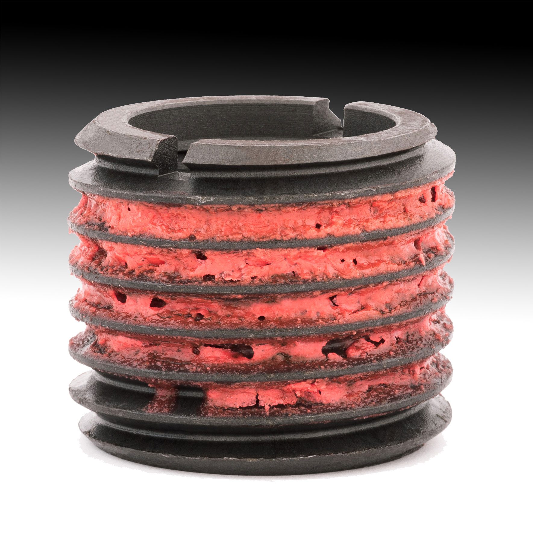

Threaded Inserts for Soft Metal Parts
E-Z LOK solid-wall threaded inserts are ideal for repairing or reinforcing threaded holes in soft metals such as aluminum, magnesium and cast iron. External threads are standard size and pitch, so they can be installed with standard drills and taps. The inserts can be installed with a screwdriver, a bolt-and-jam nut (except IC series), or an optional power drive tool.
These inserts will not back out or vibrate loose. A pre-applied, microencapsulated adhesive begins to set immediately upon installation, and the newly installed insert is fastener-ready in 3 to 5 minutes. Despite their firm hold while in use, the inserts can be removed with a bolt extractor, which overcomes the resistance to torque-out produced by the adhesive. They can also be removed by heating the insert to a temperature above 300 F, at which point the adhesive will release.
The inserts are available in thin-wall, standard-wall, extra-heavy-wall, screw-locking and automotive designs. They are available in carbon steel and stainless steel. Stainless steel threaded inserts are perfect for applications requiring additional corrosion resistance, as well as food, beverage and other clean-critical applications.
