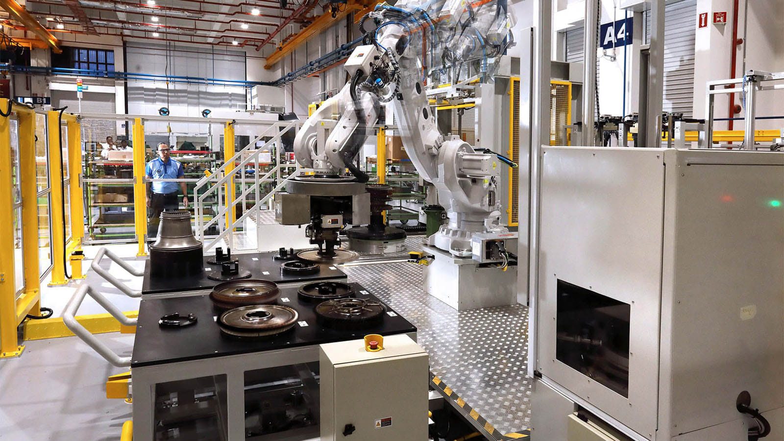

It’s 7:30 a.m. at Pratt & Whitney’s Eagle Services Asia engine center in Singapore, and it’s time for a robot named Alfred to start its daily double shift.
Working within a 26-by-20-foot pen, its job is to prepare rotors, first by placing them in an industrial oven, then waiting for them to cool, and finally transferring them to a hydraulic stacking system that puts them in alignment.
The task, though important, is monotonous. It also requires great precision. For Alfred, however, it’s no big deal.
“Alfred doesn’t mind the pressure. He’s built for it,” says Gilbert Sim, director of aftermarket operations, CORE and technology transformation at Pratt & Whitney, an RTX business.
The robot was made for one purpose: to assemble a high-pressure compressor rotor for the GTF PW1100G-JM jet engine, which powers the Airbus A320neo family of aircraft.

How Alfred Was Born
Alfred came about at the suggestion of a technician who sought to speed up the 14-hour process to assemble an HPC module, the part of the engine that compresses air before combustion.
Using best practices from Pratt’s production facilities, along with RTX’s CORE operating system—a set of methods and tools to improve processes—the team at Eagle Services Asia found that automating the rotor build could cut assembly time in half and freed up three operators to take on more complex tasks, such as rotor balancing.
The benefits were so alluring that the efforts to get Alfred on the factory floor kicked into fast-forward. Working as a cross-functional team, Eagle Services Asia rolled out Alfred in record time.
“We went from a concept in 2021 to design review in 2022, to a fully tested and operational automated cell in 2023,” Sim says. “From start to finish in two and a half years.”

Inside Alfred’s day
The robot’s first shift starts when an operator loads hardware into the cell. With the push of a button, Alfred springs into motion, effortlessly swapping out the tools on the end of its arm just as a person would change gloves, and tackling tasks that, to a human operator, carry the risk of burns and other occupational injuries.
One-by-one, Alfred heats each part, expanding the materials for tighter fits and tolerances during joining, while moving parts concurrently to the hydraulic stacking system to maximize efficiency.
Next, the system presses together the parts: the front hub, eight rotors and a rear hub.
“The process of joining them up is just like a Lego process,” Sim says. “It will stack them, press them, do the necessary heating just to make sure that the temperature increases so that you are able to join the whole eight-stage rotor together.”
Fortunately for Alfred, the hydraulic stacking system does most of the heavy lifting.
As a safety precaution, the cell is equipped with motion detection, a door safety system, and stop button.
“It’s a very robust mistake-proofing system,” Sim says.
The process typically takes about seven hours, or one hour short of a full shift. That means Alfred has a little downtime before starting the next assembly.
