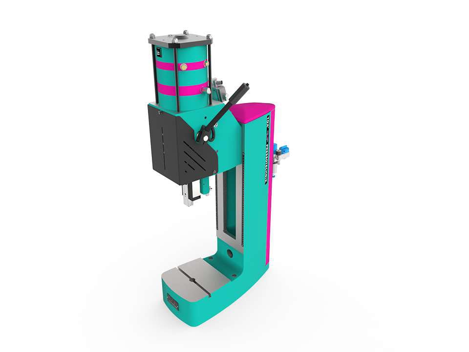

The press ram on this device is moved forward over a toggle mechanism by pulling the hand lever. Photo courtesy TOX Pressotechnik

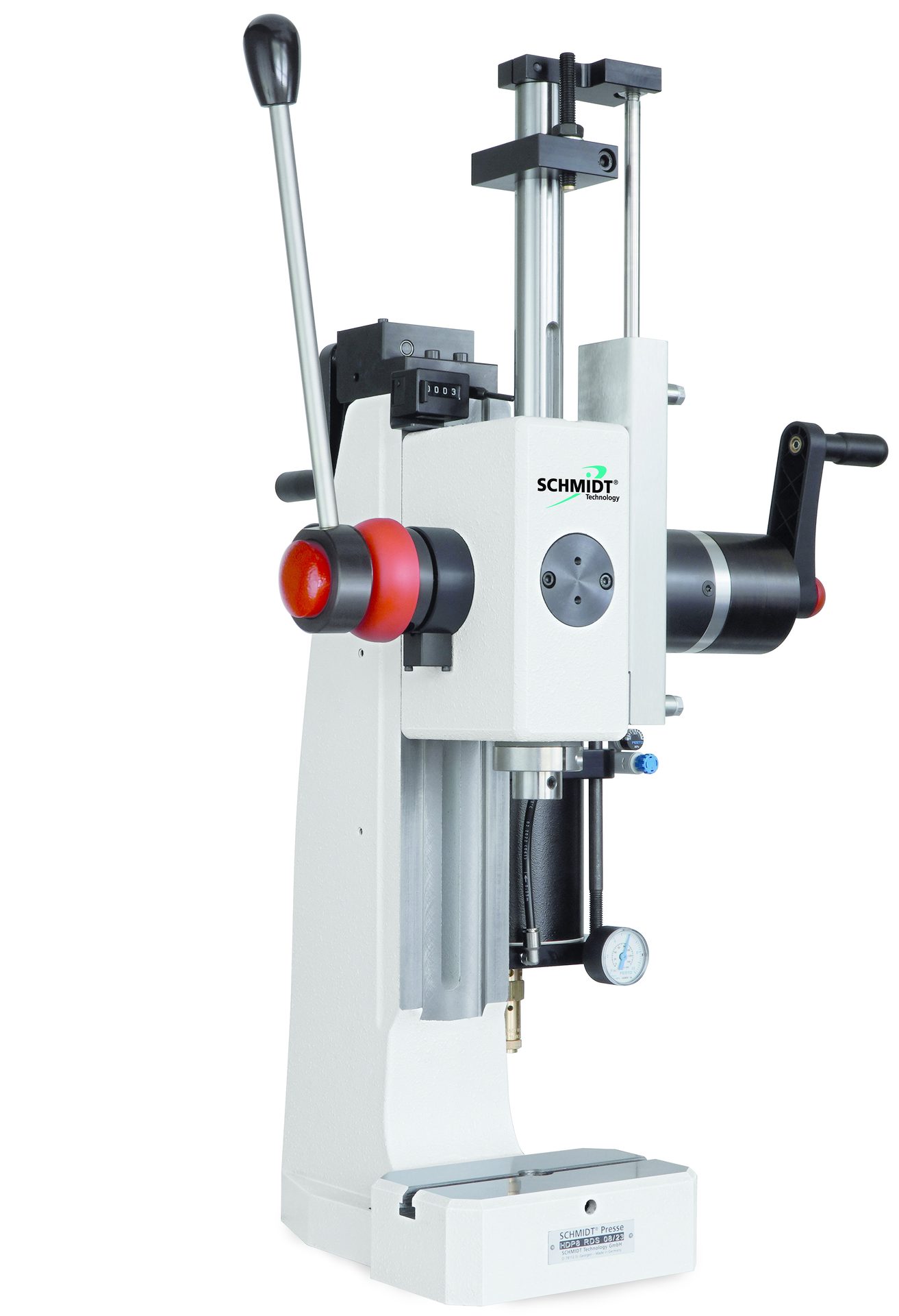

Although Schmidt produces a variety of powered presses, one of its newest products is a two-armed manual press. The DuplexPress 8 press is a rack-and-pinion style device that features a fast approach on the left side and a power stroke on the right.

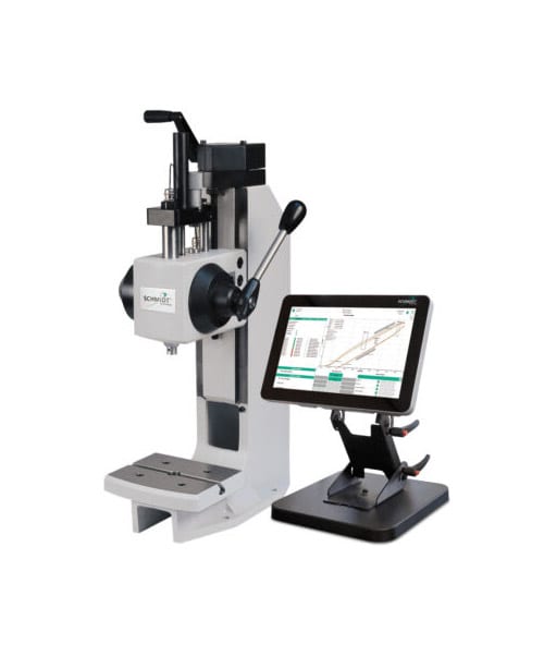

Manual presses can be equipped with fully integrated force and distance monitoring capabilities. Photo courtesy Schmidt Technology Corp.
“This product came about because we noticed that customers were asking for hand presses that feature more force capability and longer strokes,” explains Zabrosky. “The duplex press combines two different technologies.
“It has 140 millimeters of ram stroke,” says Zabrosky. “The left handle offers low force and high speed, while the right handle is designed to generate high forces with as much stroke as you want. It offers the best of two worlds.

This duplex press features a left handle for low force and a right handle that generates high forces. Photo courtesy Schmidt Technology Corp.

Traditionally, manual presses have been limited by force. However, recent advancements have increased their output-force capacity. For instance, Tox Pressotechnik’s PHFL series of products are equipped with pneumatic assist, which shortens cycle time and reduces strain on operators.
“With the right press selection, you can have as much control as pneumatic or servo presses, and almost to the level of programmable servo based presses,” adds Zabrosky. “That’s why we offer manual presses with integrated control packages that prevent a cycle start if a specific condition is not met. Systems with fully integrated process monitoring and control elements ensure every part was produced with a specified tolerance.

“In addition, we can add load cells, position sensors and monitoring screens to manual presses so that engineers can get signature curves,” says Waldherr. “Plus, the monitoring screen enables operators to use it as a target so that when they pull down the handle, they don’t let go until they hit the target window.
