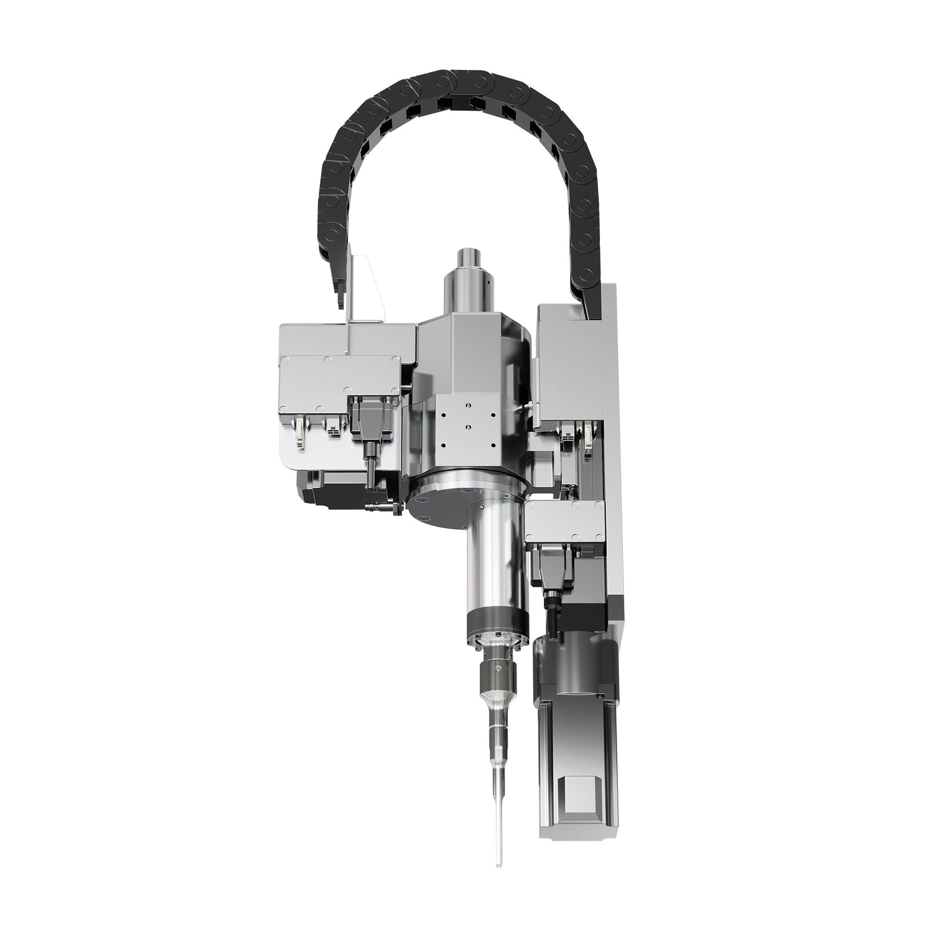

Thin-Wall Ultrasonic Welding for Painted Parts
Dukane has developed a new technology for thin-wall ultrasonic welding. The technology is being used in the automotive industry to weld painted polypropylene parts for bumpers, spoilers, rocker panels and wheel arches. The technology produces strong connections that can endure pull-out forces of up to 350 newtons.
It also produces good cosmetic results. The technology welds painted surfaces, eliminating concerns about inner bumper paint affecting the welding process. Extensive testing confirms zero marking on painted surfaces, even with sensor holes or thicker paint layers.
The technology uses a high-gain full-wave or 1.5-wave horn with an iQ Auto-Plus ultrasonic generator and 600-watt probe for optimal weld strength and precision. “Trigger-by-power” technology ensures controlled speed throughout the weld, reducing the risk of surface imperfections. The technology ensures a smaller collapse distance than the part’s thickness, ensuring a seamless finish.
Complete servo module options (rotary linear servo or linear servo) are available for streamlined integration into assembly processes.

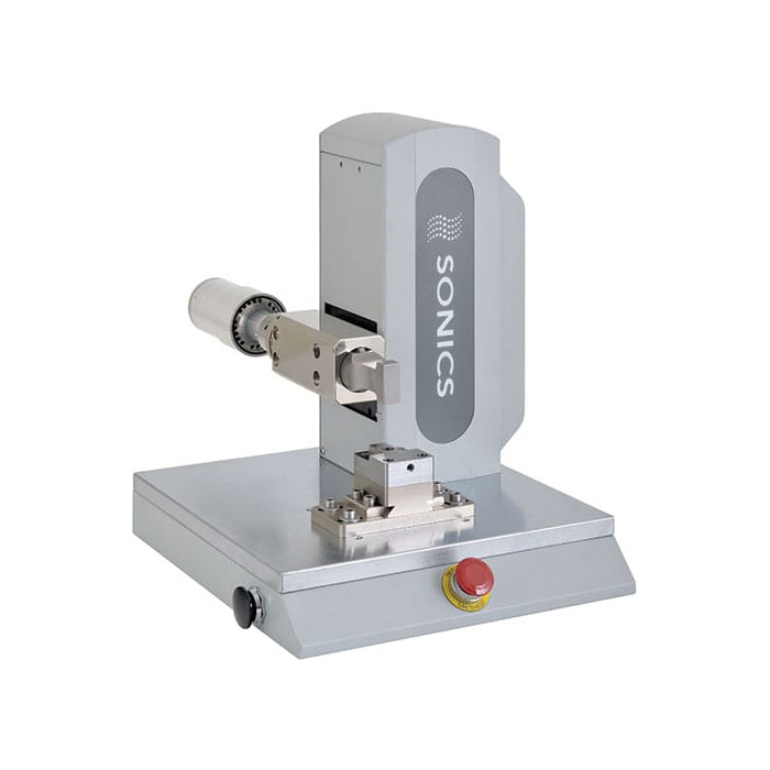

Ultrasonic Spot Welding System
These 15-, 20- and 40-kilohertz ultrasonic spot welding systems deliver unique advantages due to their nodal mounting systems. The welders are available in a wide range of configurations, each optimized for R&D, manual operation, specialized machines or full automation. Standard versions are available for foil welding and wire processing. The 40-kilohertz model is ideal for smaller, more delicate applications.
Using the full-color touch-screen, the operator can intuitively enter weld parameters with job storage and recall capabilities. Weld results are viewable as numerical values or time-based graphs. Data logging to an external PC is useful for quality analysis. The controller can interface with a bar code reader for parameter selection.
