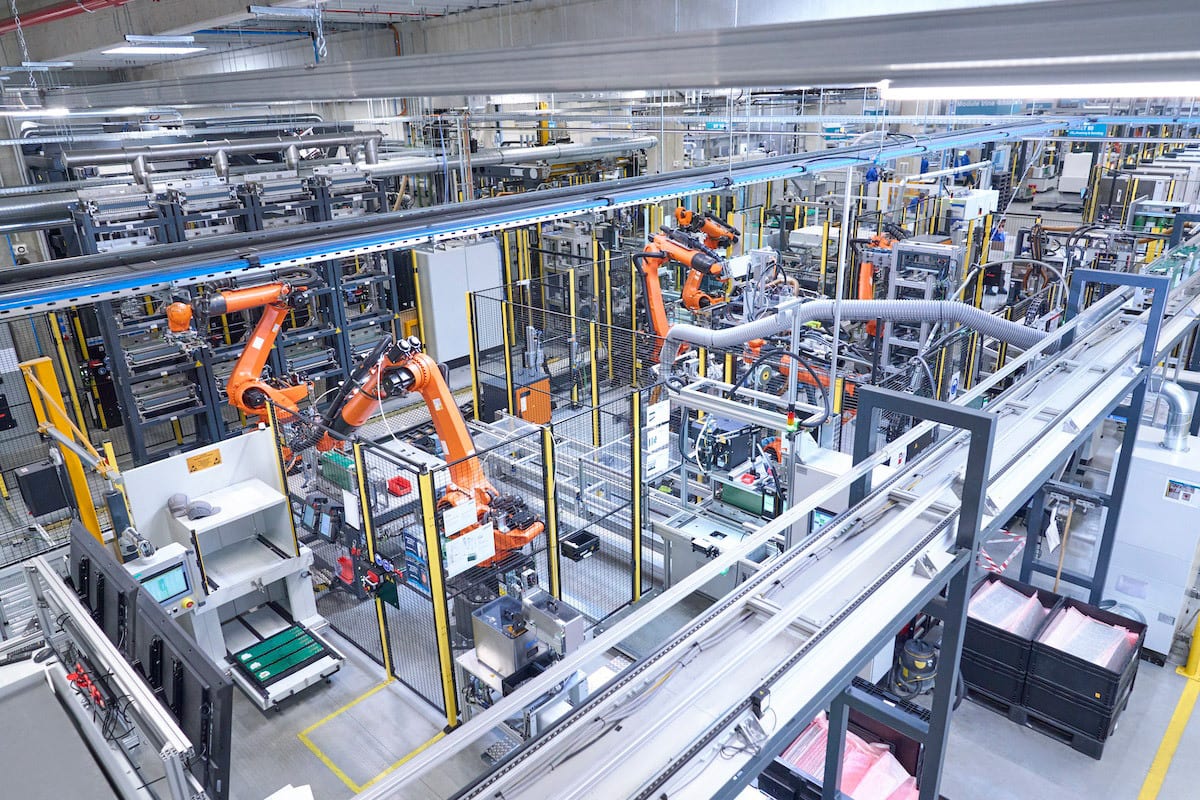

BorgWarner is one of the 25 largest automotive suppliers in the world. The company was formed in 1928 from the merger of several smaller manufacturers that made timing chains, radiators, transmissions and springs for gas-powered vehicles.
Today, BorgWarner still makes products for gas-powered vehicles, but the company’s main focus is on power train products for hybrid and electric vehicles. Its portfolio includes controls, power electronics, inverters, battery chargers, and DC-DC and DC-AC converters. Operating 92 manufacturing facilities in 24 locations worldwide, BorgWarner tallied sales of more than $14 billion in 2024 and employs some 38,000 people.

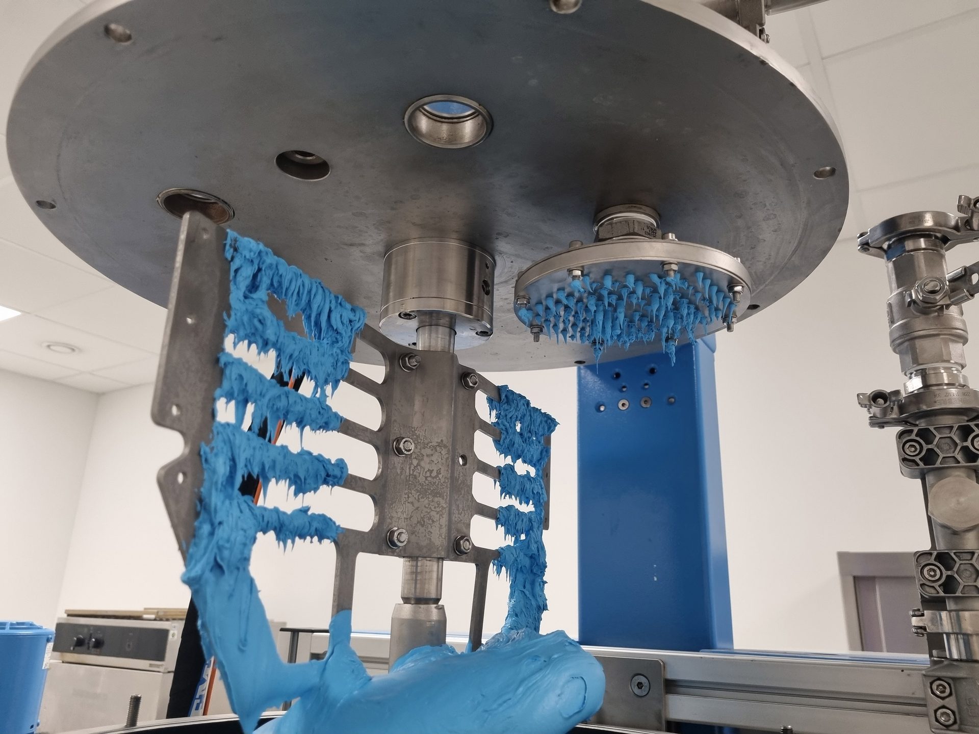

Industrial mixer with blue, viscous material on a large stirrer and a spiky disc.
Inside the ViscoTreat-I, a stirring mechanism ensures even distribution of conductive particles and gets rid of any air bubbles. Photo courtesy ViscoTec

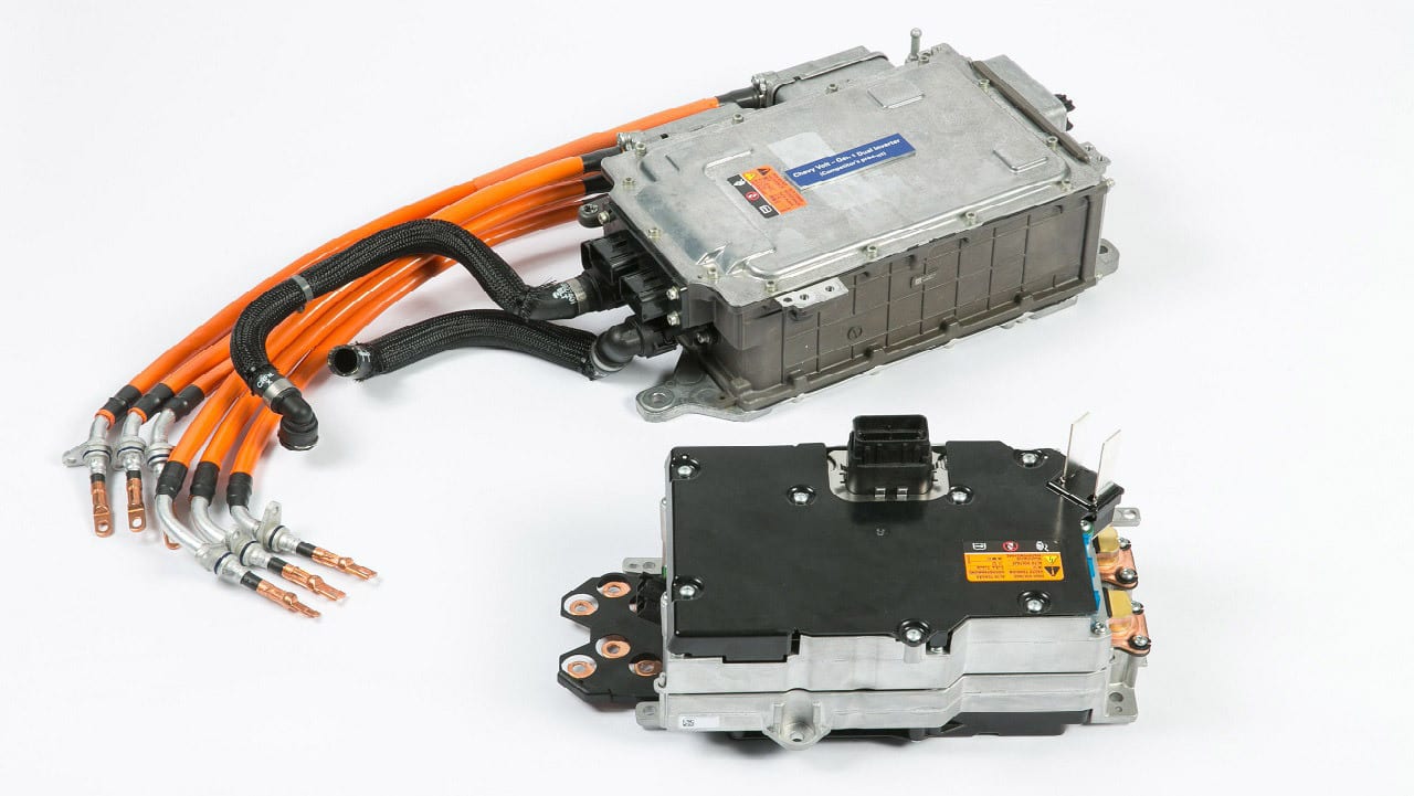

A key challenge of manufacturing EV components, particularly power electronics, is how to keep them cool. For many applications, BorgWarner uses thermal paste.

Automated factory with multiple orange robotic arms and extensive conveyor systems.
Operating 92 manufacturing facilities in 24 locations worldwide, BorgWarner tallied sales of more than $14 billion in 2024. Photo courtesy BorgWarner

Two automotive power electronics units with attached orange high-voltage cables on a white background.
A key challenge of manufacturing EV components, particularly power electronics, is how to keep them cool. Photo courtesy BorgWarner

The ViscoMT-XS feeds the paste from the hobbock to the ViscoTreat-I, which stirs and degasses the material. The paste enters the ViscoTreat-I via a media distributor, a nozzle resembling a showerhead. Inside the ViscoTreat-I, a stirring mechanism ensures even distribution of the conductive particles and gets rid of any air bubbles.
Once it is bubble-free and well-mixed, the paste is smoothly delivered to the dispensing valve.
