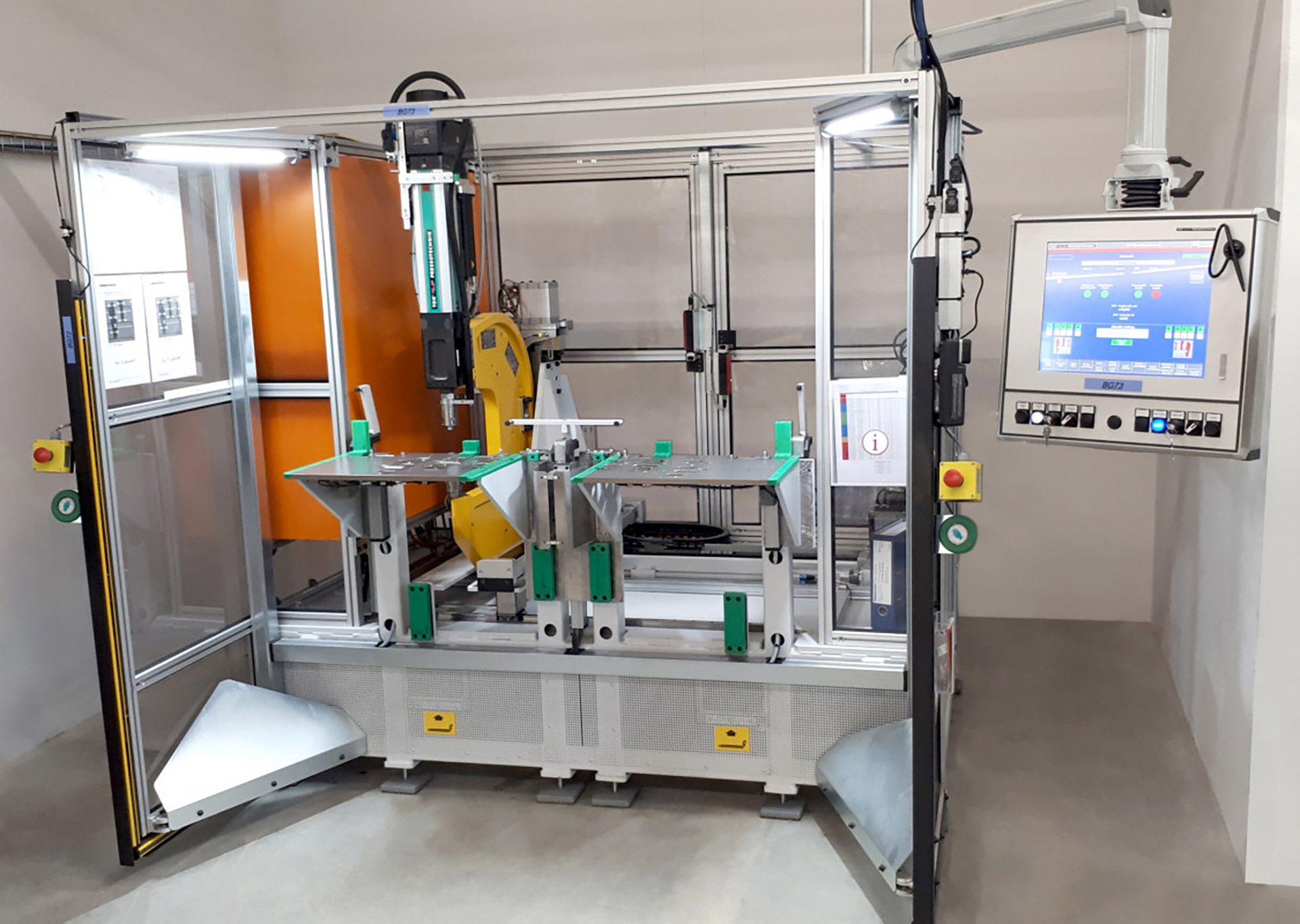

Tox developed a semiautomated system that allows two casing walls to be clinched in a single operation. The centerpiece is a single-point C-frame press powered by a compact Tox ElectricDrive electromechanical drive. The maximum tool opening is 73 millimeters, which is sufficient for V-Zug project.
The press drive is installed on the die side and applies a nominal force of 80 kilonewtons. Sensors monitor force and displacement. The precision force sensor is accurate to ±1 percent of the end value. The piston operates dynamically at a speed of up to 200 millimeters per second.

The press is mounted on two linear slides, so it can automatically position itself at each clinching point.

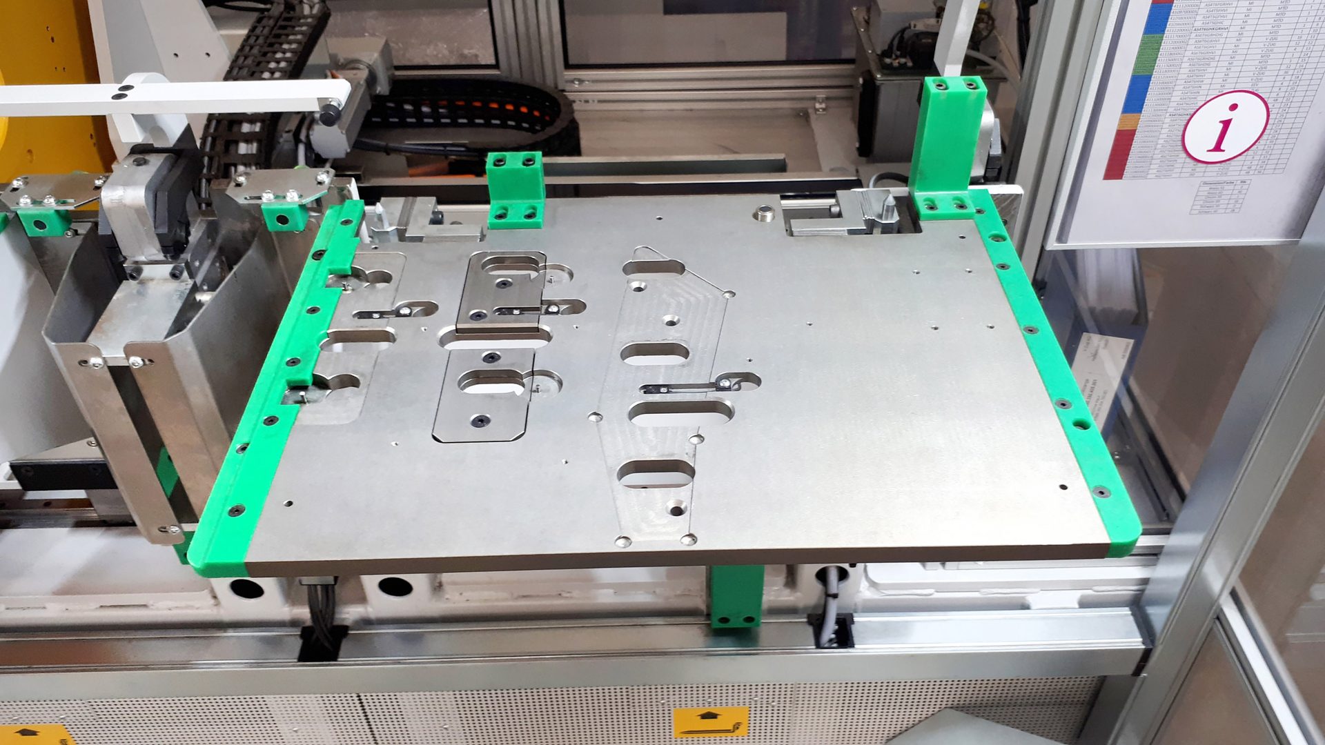

To start the assembly process, a worker loads three sheets onto a worktable. He then places a 60-liter large-capacity tub on top. Mix-ups and incorrect assembly are ruled out thanks to fixtures that act as templates.
The surface of each sheet is moistened before each clinching point is set. This reduces friction and protects the tools and sheet metal surfaces. Tox added a spraying device to the system for this purpose.
With the parts loaded, the operator activates the system with a single-hand control. The parts are clamped in place, and the clinching process starts. The press moves on back-and-forth and side-to-side to process the two side walls one after the other. Each wall receives 15 clinch points.

There are two programs: one for clinching three trays per side and one for clinching two trays per side. “This allows us to produce the housings for dishwashers with and without the comfort slide function for the cutlery drawer on one system,” explains Christoph Fässler, project manager for system planning at V-Zug.
As soon as the process is complete, the control system automatically opens the clamps. The operator then removes the housing, reloads the worktable and places the vat, which has been rotated 180 degrees, back down to repeat the process on the second side wall.
Engineers can create movement sequences and operating modes via a touchscreen and view evaluation results. The screen is connected to the axis controller via an Ethernet connection.
To prevent errors or injuries, Tox equipped the system with several safety features. For example, sensors check whether the parts have been inserted and the vat has been placed in position. The system is only accessible from the front, with light protection grids monitoring access during the process. The other sides are sealed off by clear polycarbonate panes. This allows workers to keep a safe eye on the joining process.
The control system can be expanded at a later date to accommodate additional dishwasher variants. All fixtures are designed as interchangeable parts and can be swapped out whenever necessary.
The system arrived at V-Zug ready to use and only had to be connected to electricity and compressed air. “Everything went smoothly,” recalls Fässler. “For us, the system was not about maximizing output, but about ensuring quality.”
